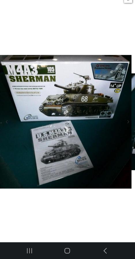

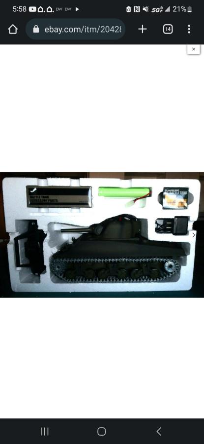

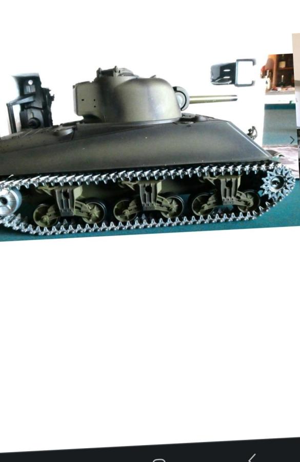

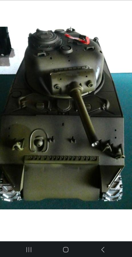

    What version HL Sherman is this?
    Is there a way to know version Sherman this is I bought it on ebay and the seller listed it a 7.0.

    It should say on the controller or bottom of the tank, But prob a 6.0?

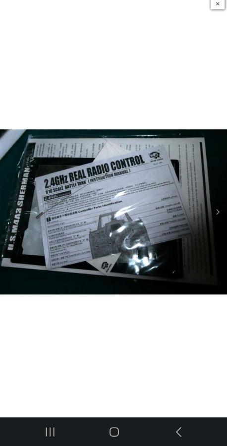

      The controller is the newer 2.4 version. Not the one on the remote pictured on the box.

        Most likely you have a 5.2 or 5.3 Sherman based on that battery shown. HL stopped using those just about the same time the 6.0 series came out. Also I do not see the IR receiver which usually is visible in a storage slot in the foam packing with the newer 6 series and up.

          You are correct in that the box does not portray what you have. The 6.0 and 7.0 series are both 2.4ghz. As A said, there will probably be a sticker on the bottom of the hull or inside the battery compartment. Sometimes HL didn't do this for the 6.0's but they do so for the 7.0's. Also, if it is a 7.0, there usually is an addendum sheet in the instruction packet.

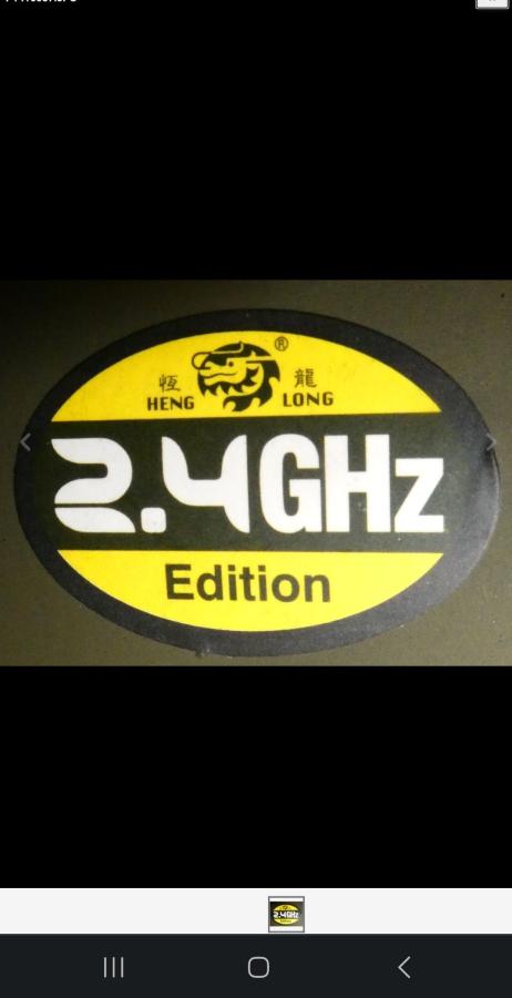

            I asked for a picture of the sticker on the bottom of the hull to find out what series it was and this was what they sent me. I'm just hoping it's at least a 6.0

              It most likely NOT a 6.0.

                    That looks like a v5.3 2.4Ghz sticker. They can be upgraded to a newer standard, but it might require a little rewiring of plugs, a new control board and a new radio. If it is truly a 5.3, the transmitter won't be compatible with the 6.0 or the 7.0. If the control board has a gold colored sticker on it like this one when you get it, it is a v5.3:

                        it does appear to be a 5.3.

                          I guess as @Rubicon99​ that you get a HL version 5.3 2.4 GHz Sherman based on the sticker you posted.

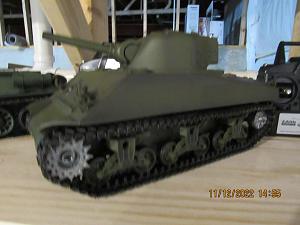

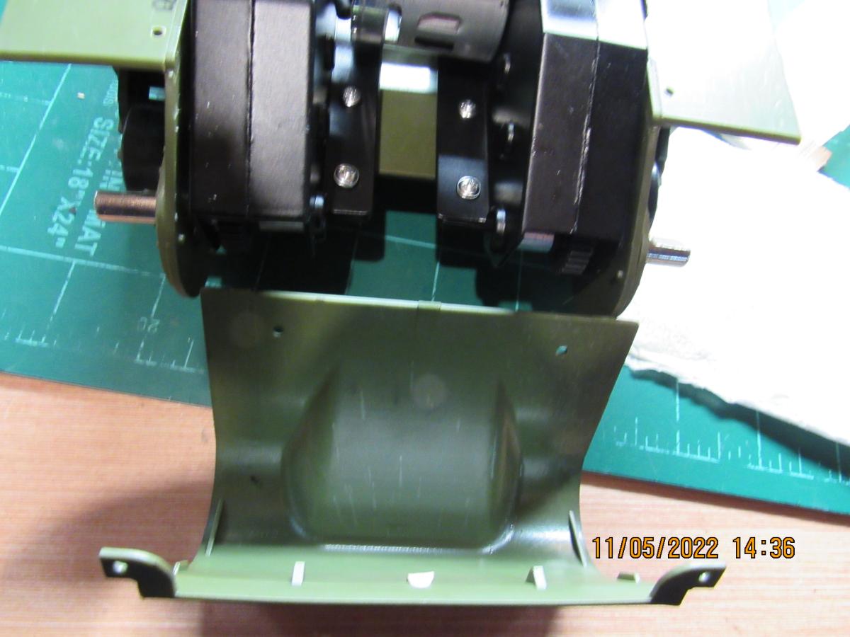

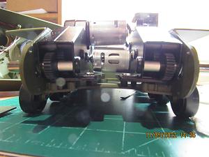

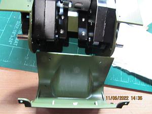

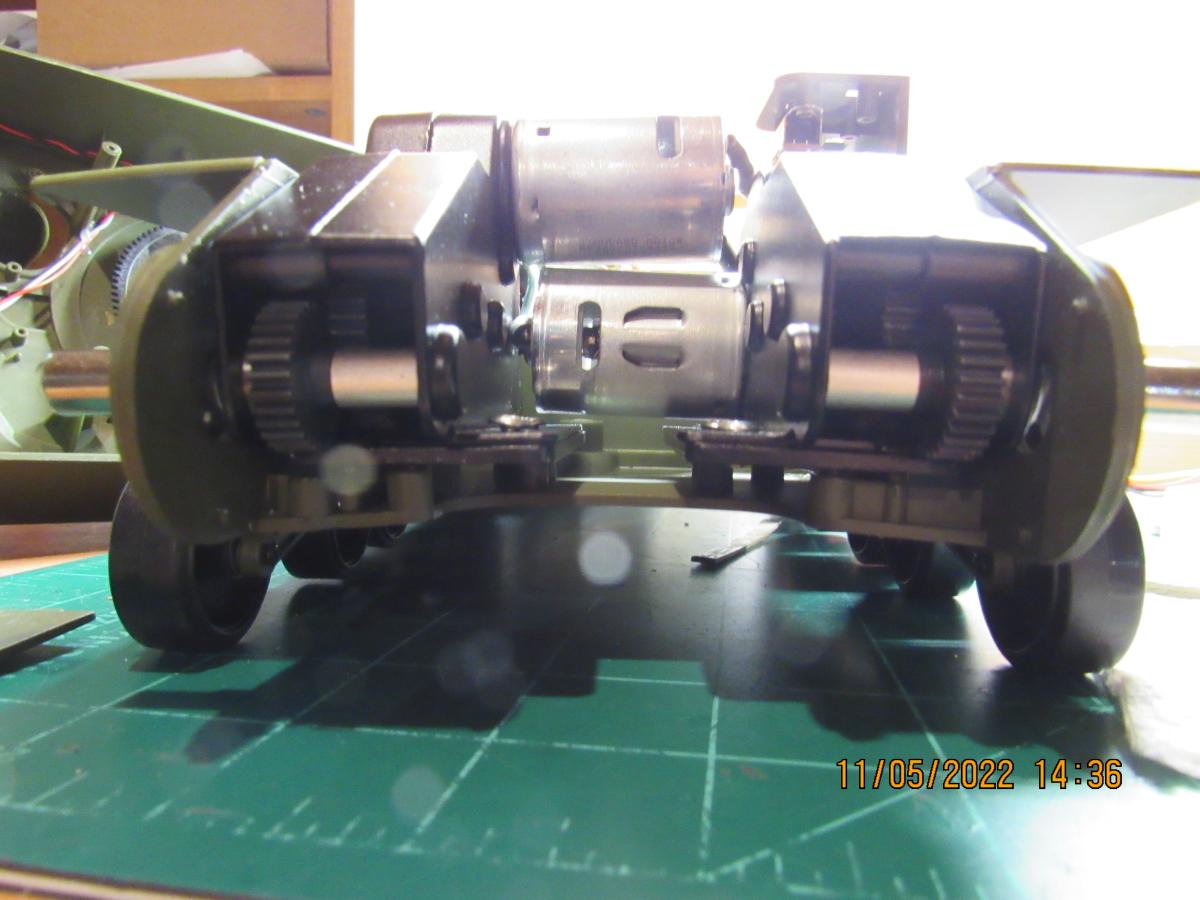

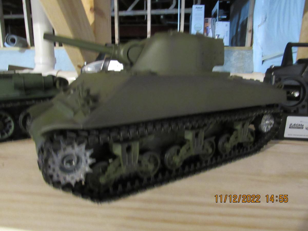

                            I purchased a plastic version of Sherman with 7.0 radio from one of the Toucan seller at less than $130. They can afford to sell cheap because they build inventory in US. The RTR tank was shipped from New Jersey. I upgraded the Sherman to metal using a Heng Xin gearbox and Mato T74 track. I gave Heng Long credit for making their tanks so easily upgradeable.
ID:	374800Click image for larger version
ID:	374801Click image for larger version
                            I magnetized the upper/lower half mounting. The tight fit of the mold makes the magnets working very well. I am not finishing dressing the Sherman yet.

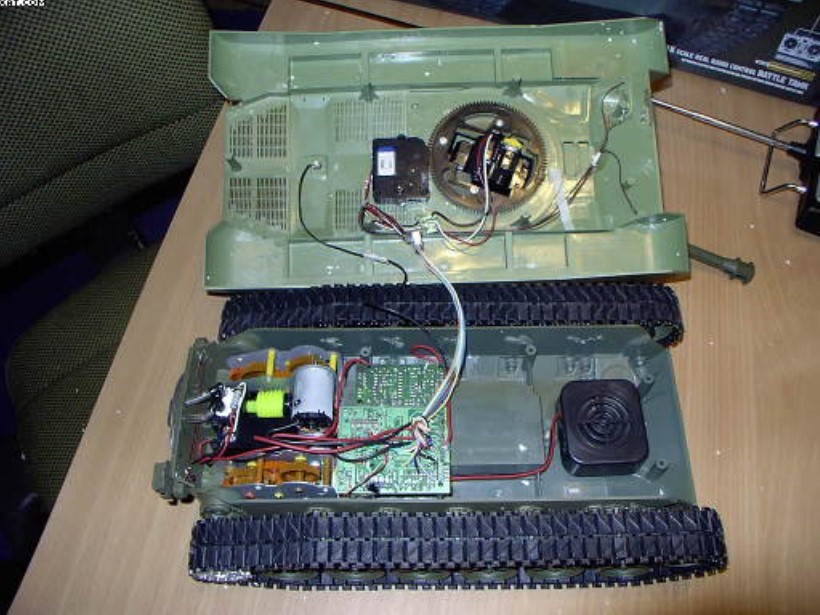

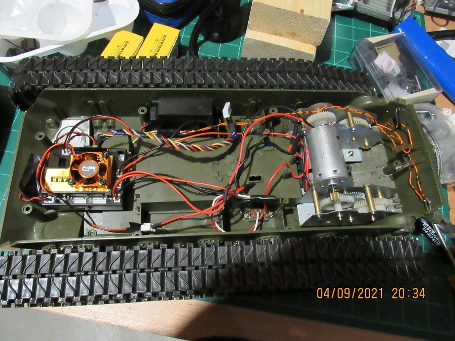

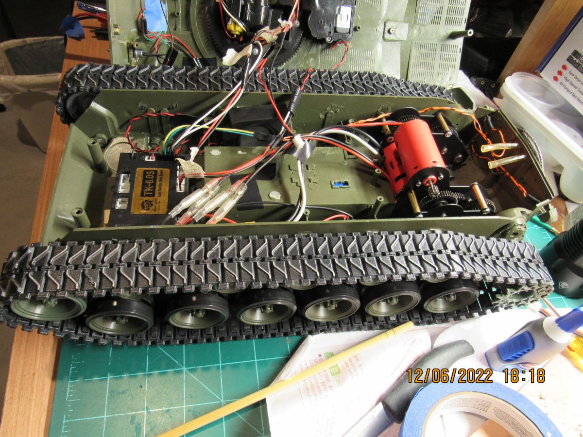

                                For most tanker, the 6.0 radio system is a much better deal than the 7.0 at almost half the price. Upgrading from 5.3 to 6 or 7 is not difficult electrically. But it is not a direct swaped out. It needs trivia bookkeeping of the corresponding ports. The pictures show how my Pershing transitioned from TK27 (27 MHz) to v5.3 2.4G to v6.0 2.4G.
ID:	374814Click image for larger version
ID:	374815Click image for larger version
                                The Version 6.0 radio runs on Taigen version2 ball bearings gearbox with 390 red motors. This Pershing is a 2005 HL Snow Leopard metalized.
