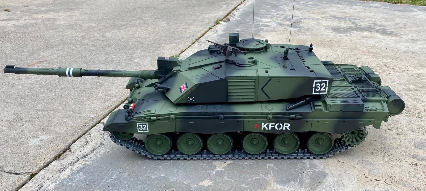

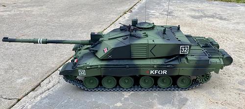

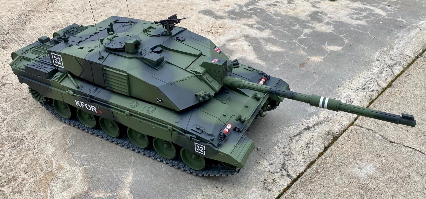

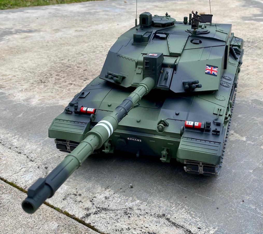

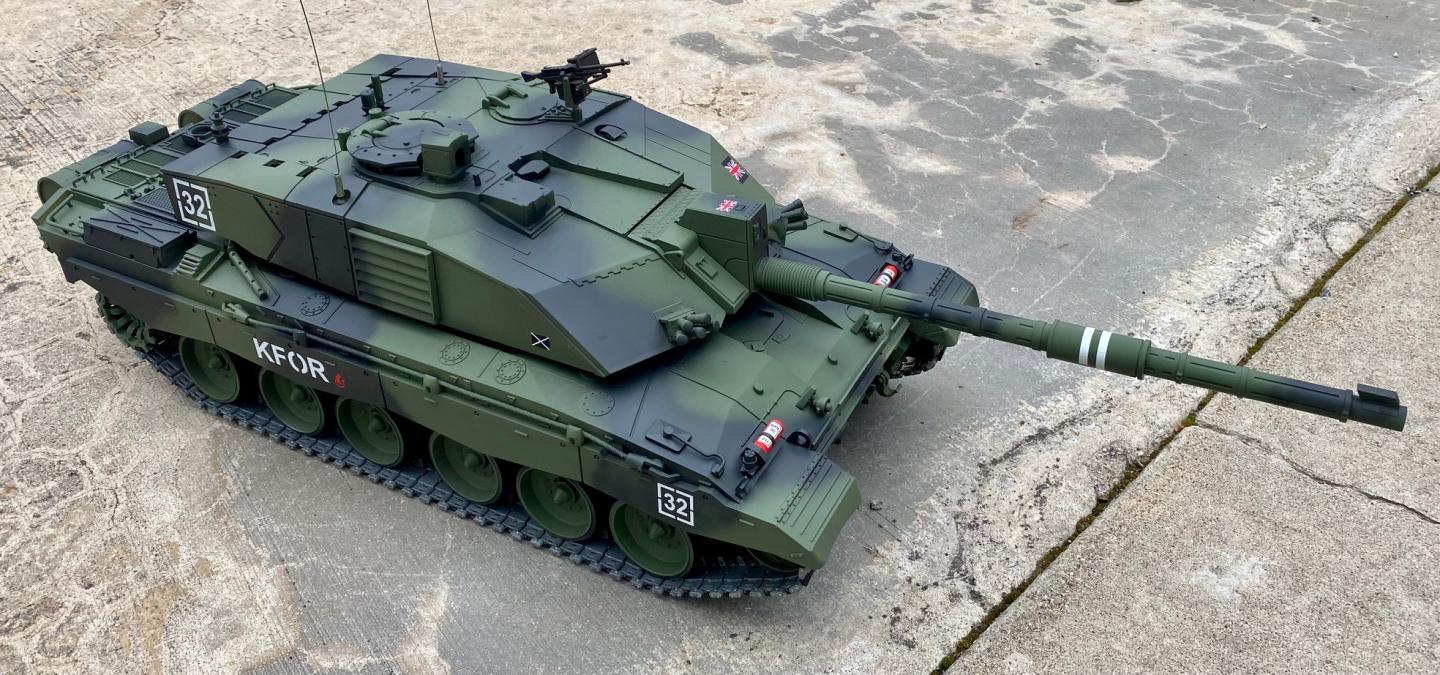

      Seems that other thread is indeed corrupted. Even some member images are absent. So, here are my latest; painted and decaled, not weathered.
Name:	Challenger II 13.jpg
ID:	375138Click image for larger version
Name:	Challenger II 14.jpg
Name:	Challenger II 12.jpg

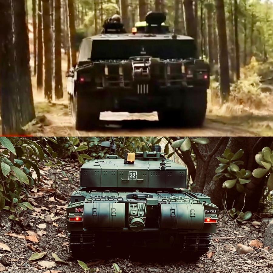

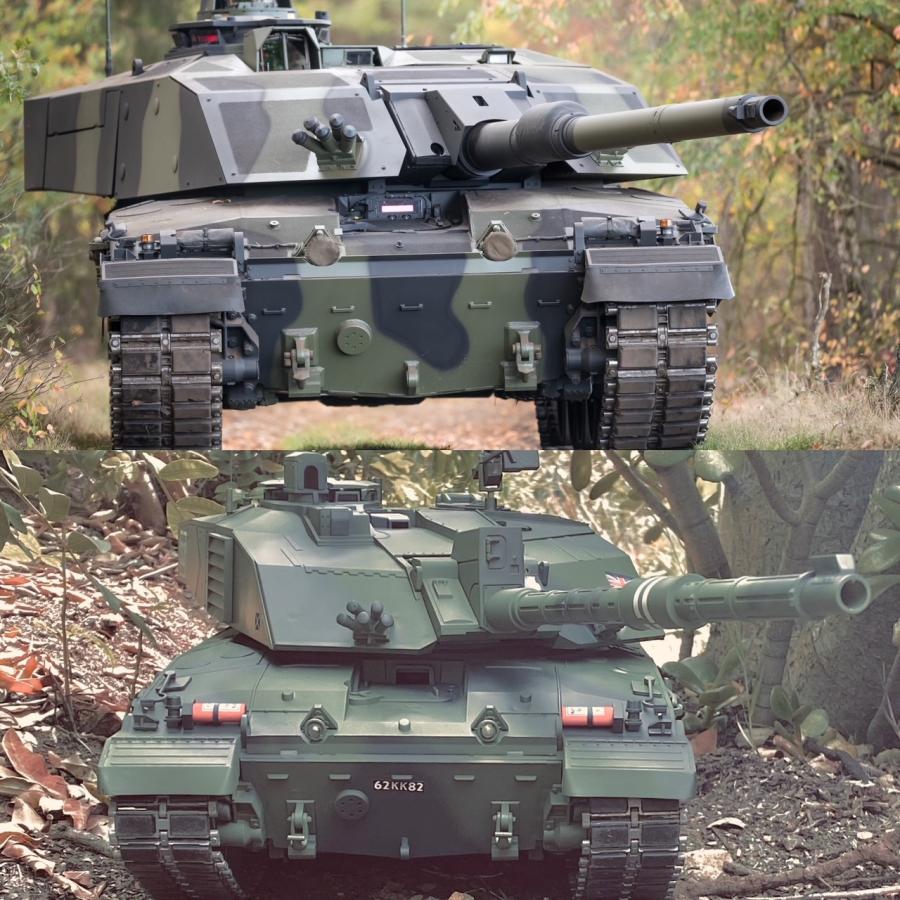

      • #4
        I added a yellow flashing light on top. Not sure why they're there, but if they do, I do!

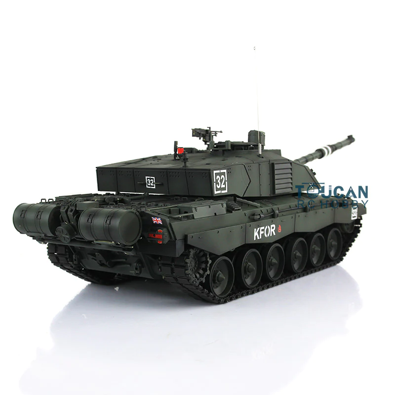

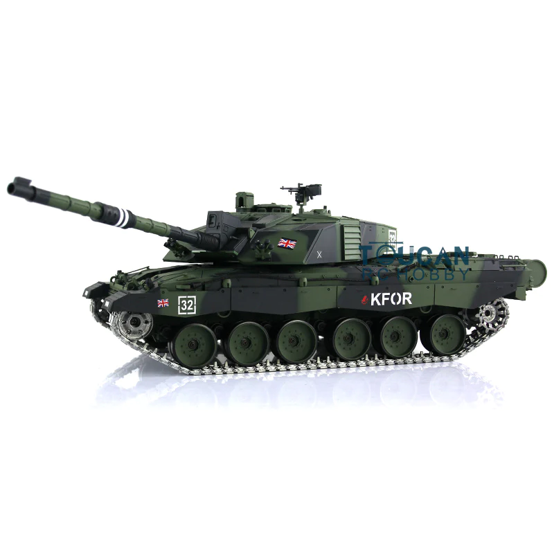

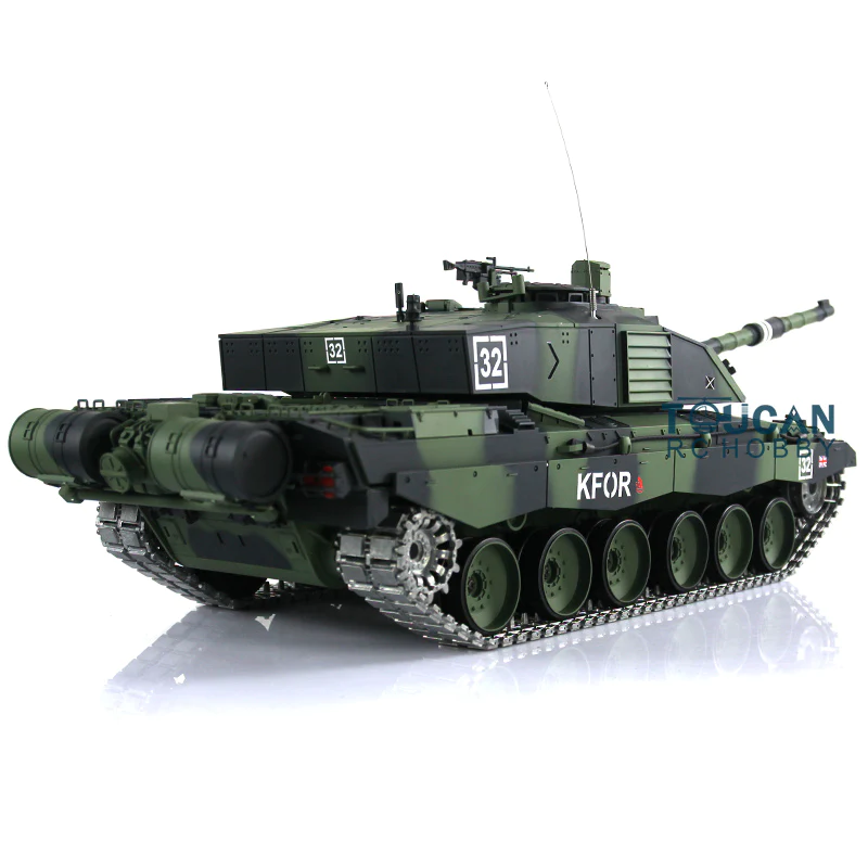

          For those who don't have the time to convert their tanks from the yellow color, Toucan Hobby has 2 green versions of the Challengers for you to purchase. But please remember that they are not as nice as Bob's Challenger :-)
          • #6
            Blackish green....

            • #7
              Green...
ID:	376440Click image for larger version
ID:	376441Click image for larger version

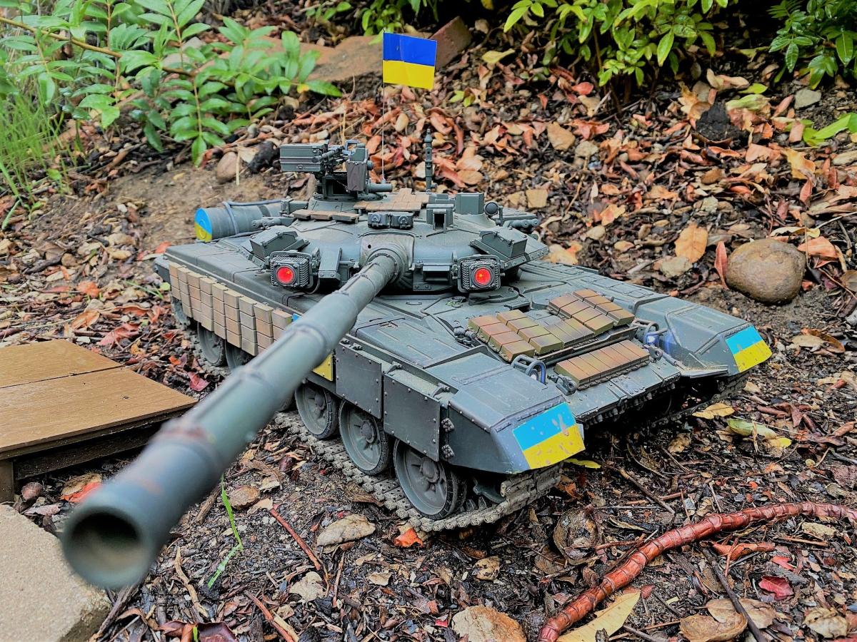

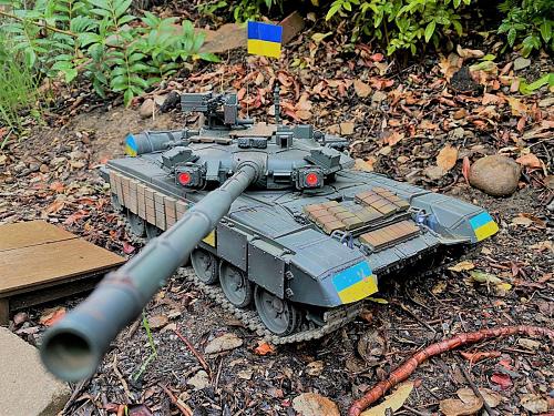

                  HL also offers the T-90 in "blackish green", a pretty cool color. Funny how it looks lighter in natural light.
