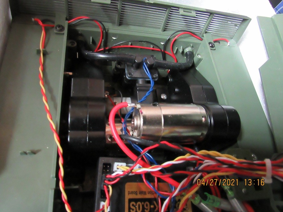

    YES! But I will recommend AGAINST it. Reasons:
    1. If you run it with 3S battery, the 380 motors run really hot.
    2. If you run it with 3S battery and the 390 motors, the scale speed will be too fast to be realistic.
    A large capacity 2S Lithium battery with a good 390 motors will run cool with the correct top scale speed.
    Disclaimer: I do not have an Abrams. I did the test on a German Leopard 2A6 6,0S. The Leopard is highly modified with Heng Xin gearbox, MxFans390 motors, ball bearing drive shaft cover and on a Tamiya track. The battery is a home built 2S2P lithium ion pack using imported 3500 mAh cells.
