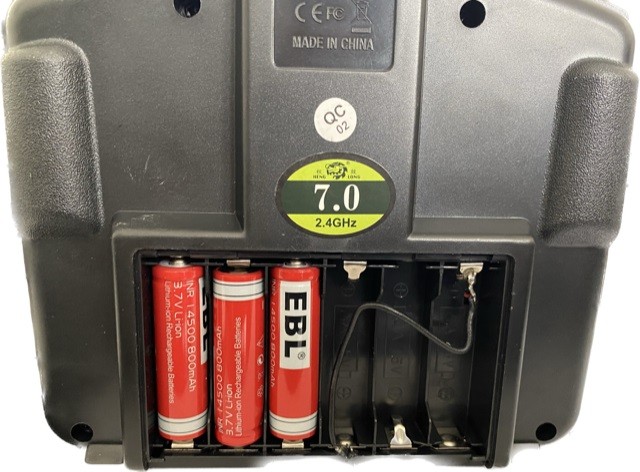

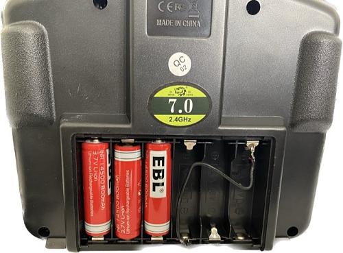

            6x1.2V is low for the radio transmitter. NiMH rechargeable is not ideal since its voltage drops rapidly. Any regular non-rechargeable AA battery of 1.5V each is required. Yes, I tried.
            Alternatively, you can use 3 pieces of Lithium Ion 14500 rechargeable. You will need to modify the transmitter battery compartment to bypass the last 3 slots. (You don't need to open the transmitter.)
            Click image for larger version  Name:	HL radio mod.jpg Views:	0 Size:	83.9 KB ID:	377743
            I did that to all my radios. The 11-12 volts total is safe and works very well, but no higher. Use only name brand Li-Ion. Many of the cheap off-brand Li-Ion does not have protection PCB and are unsafe to use.

                          14500 are 3.7V rechargeables, don't use more than 3 at any one time. 4S 14500 will be more than 16 volts and can damage the transmitter.
                          HL transmitter needs 9 volts to work properly, is spec to have 12 volts capacity. I use a intelligent charger for the 14500 which terminates charging at 4.1 volts. I actually cheat a little with 12.3 volts when cells are fully charged. I have not get into trouble yet.
