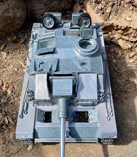

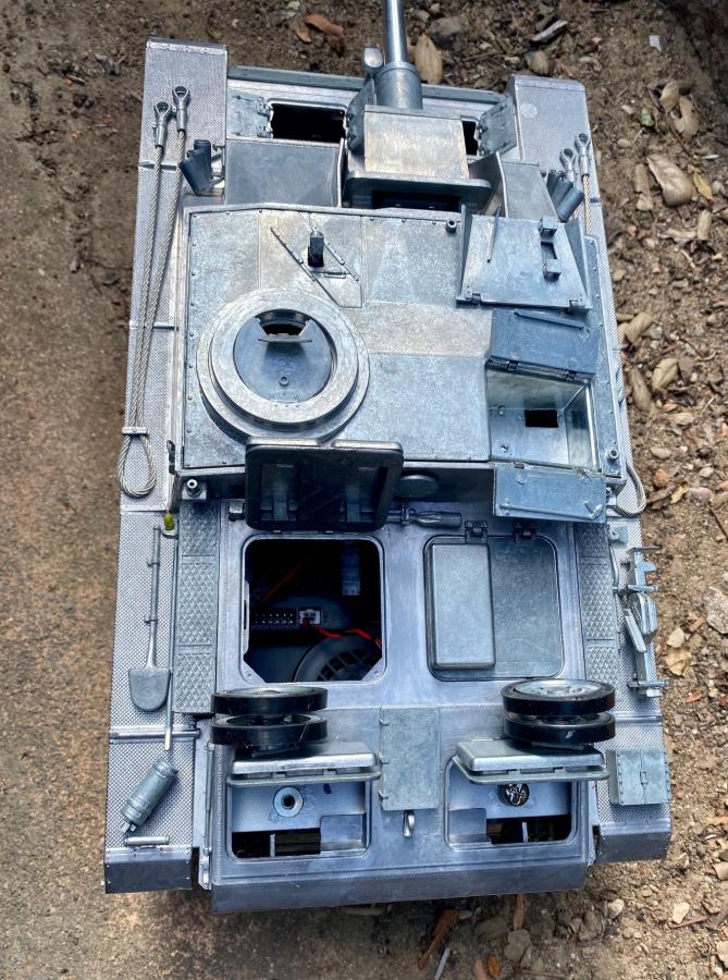

          I just received and unboxed my Mato StuG III, "static IR unpainted" version. For anyone contemplating this purchase, here are some details. I own, and am contemplating selling, my Heng Long version. Nothing wrong with the HL, it's just that the Mato has more details.
          - All metal, from top to bottom, although much of the top hull is cast metal, but supposedly not zinc..
          - Recoil and elevation are both servo operated, servos and linkages installed. I'll be using a HL 7.1 board to run these.
          - Hatches: transmission covers, commanders hatch, crew hatch, all four engine deck hatches and the gunner's MG shield are hinged. Even the periscope port in the commander's hatch is hinged separately.
          - Gearboxes & gears are metal; steel. 5:1 gear ratio, for slower speed but more torque.
          - Torsion bar suspension.
          - All wheels have bearings.
          - Metal tracks.
          - Rubber tires.
          - The moldings are crisper and more detailed.
          In the static version, there is no speaker, board, battery & charger or smoke generator (see Z's posts). Wiring plugs need to be soldered to match your equipment.
          As of today, Matomart has it on sale, but Toucan beat the price by about $10 if you negotiate, both including shipping. For comparison this kit was $450, a RTR Heng Long with fewer features is ~$200. You pays yer money and you makes yer choice!

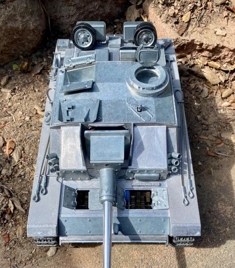

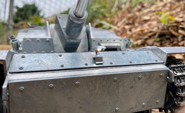

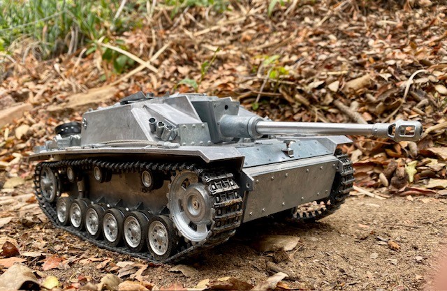

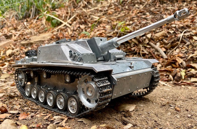

              Some detail shots. You can see the hole in the mantlet for Mato's IR bulb, but I'll be installing my bulb in the barrel.
              Range of elevation:

              Notek light:

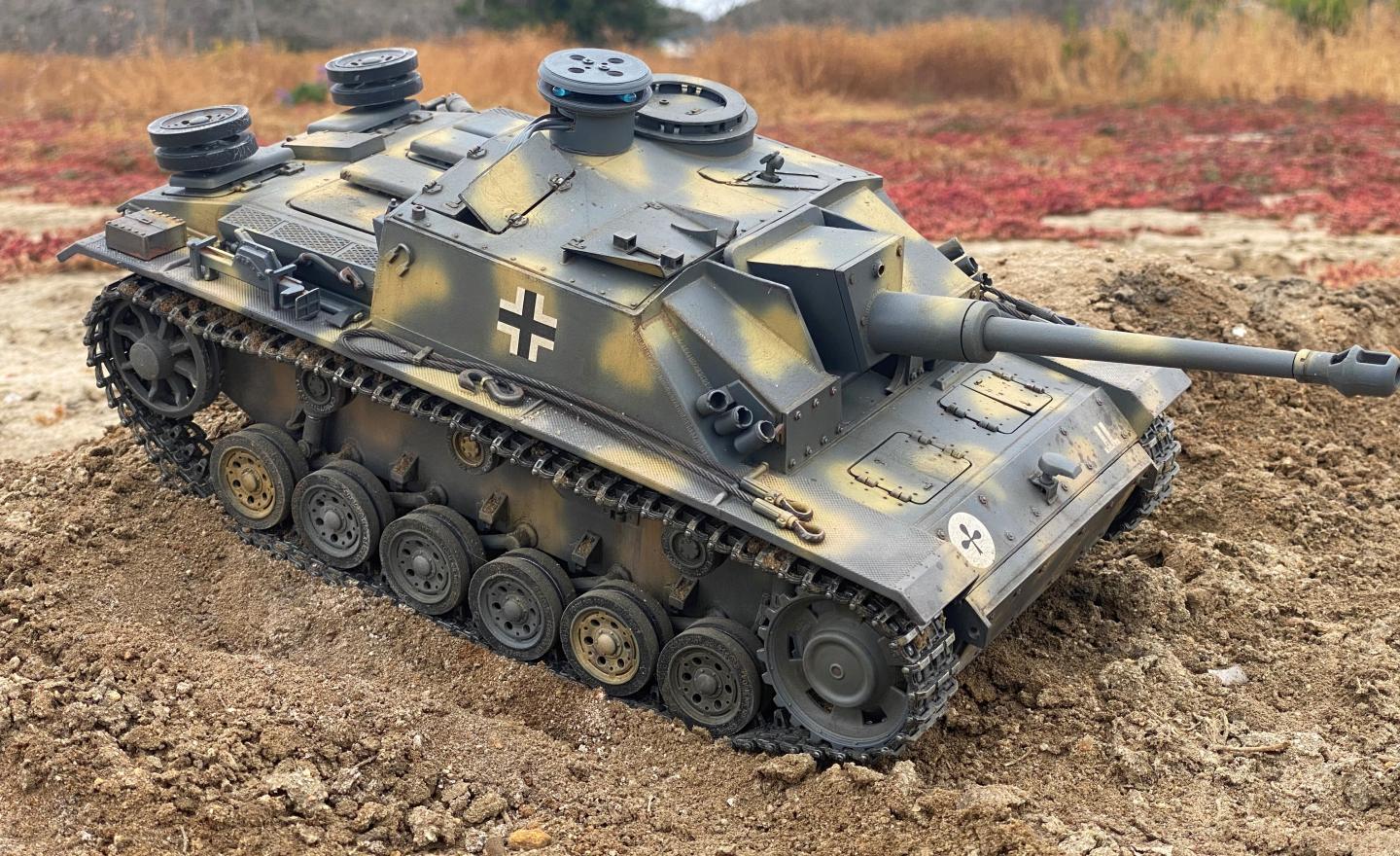

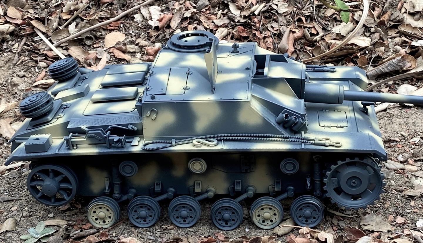

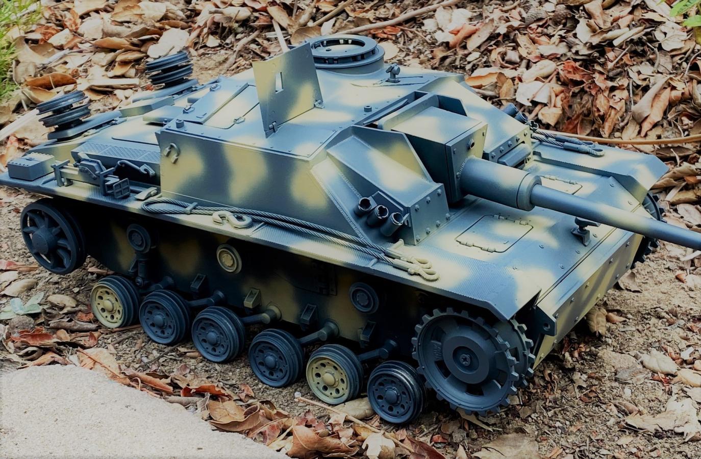

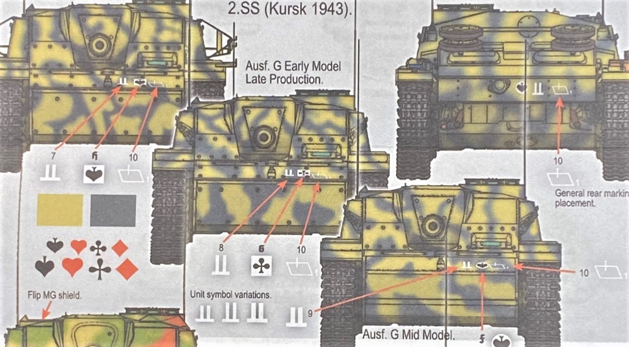

                Progress report:
                I finally installed the battle electronics and got my airbrush working (sorta). So, basic paint, no decals or detailing. I found an unusual camo scheme, most likely the original grey and field addition of dark yellow.

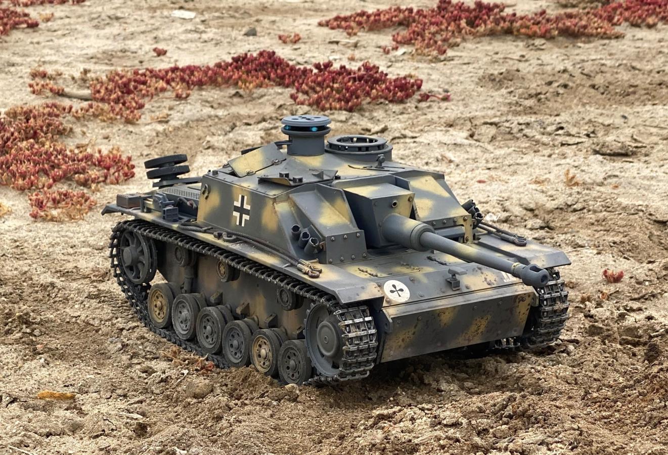

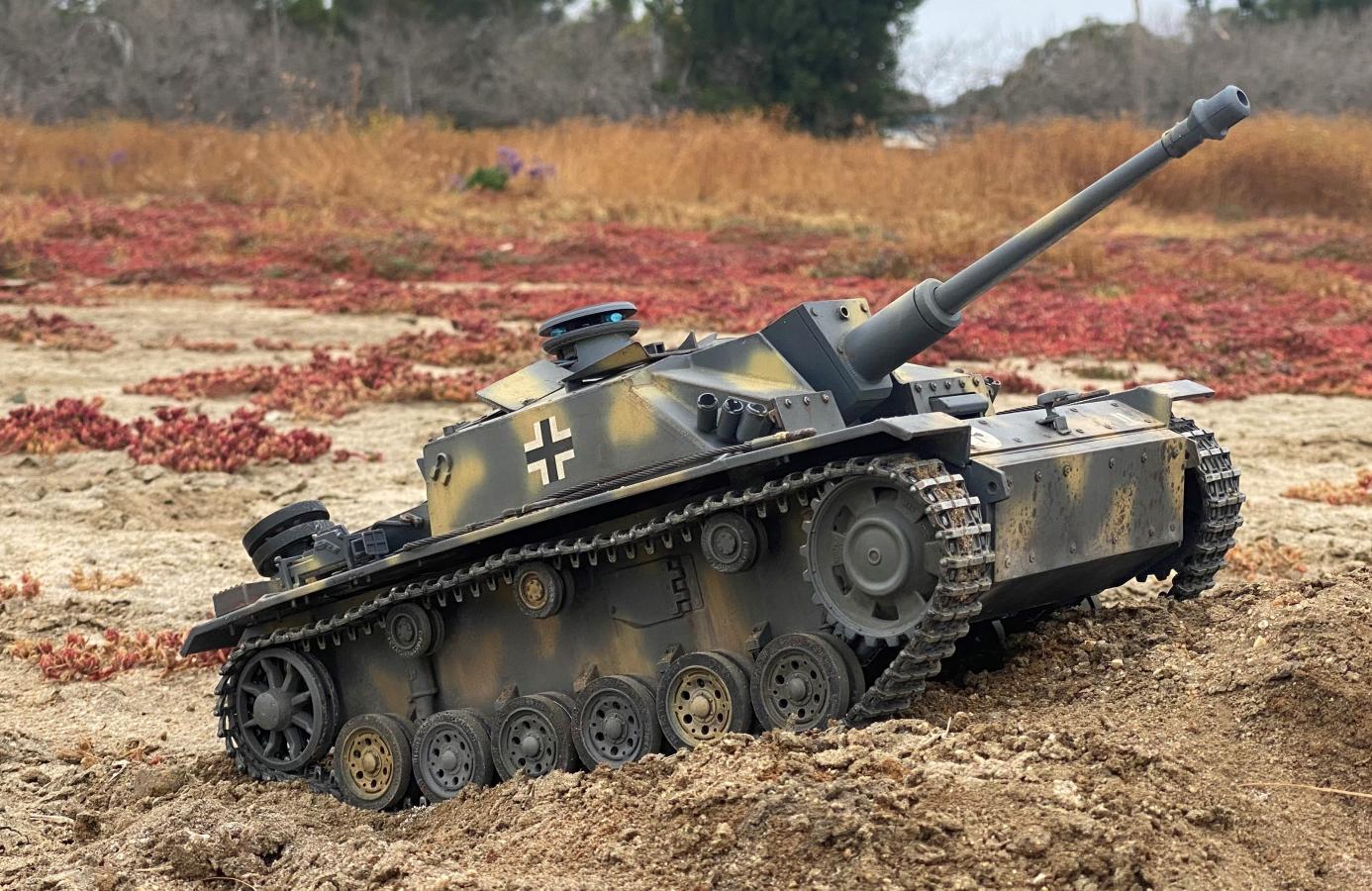

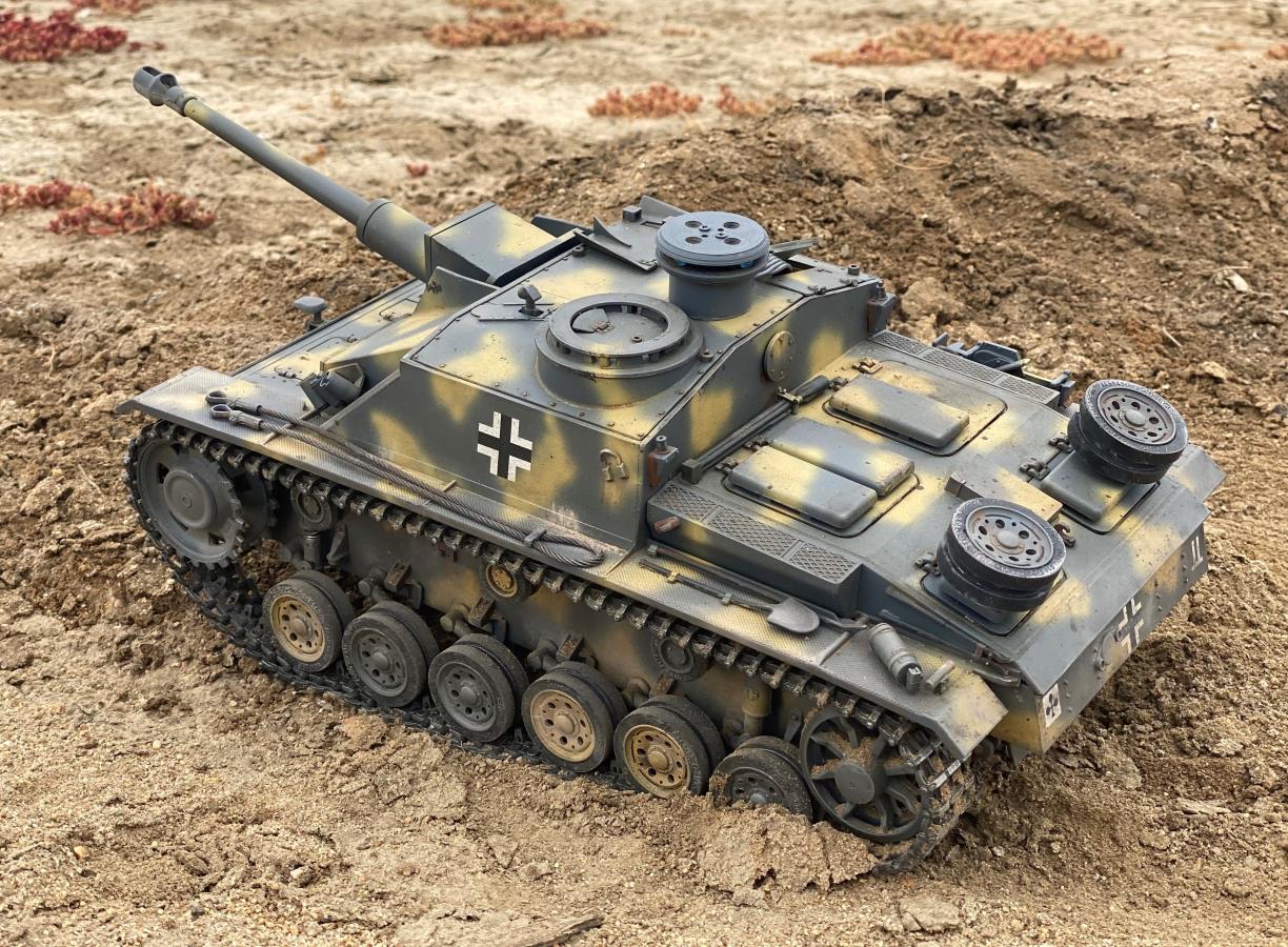

                  This guy played with the big boys at June's San Diego Tank Day. It ran great!

                      The tank is fine. Working parts are steel, it's the hatches and detail parts that are cast metal. The suspension is torsion bar with extra spring cylinders on the first and last road wheels. Gearboxes are all steel. Barrel is steel. There are bearings on all wheels, including the return rollers. By all means use a Clark board if that's your preference. Their RTR come with TK22's which are unprogrammable. I have a Mato M-36 with a Clark TK-50 system. My recommendation is to get their "static" versions and install your own electronics. That's what I've done.
                      I ran mine hard and it performed well. I de-tracked twice because of dirt & rocks clogging the idler, but that was actually better than par for that course.
                      I also ran a Mato Sherman on that same surface. Its quirk was to have dirt and pebbles clog the track as it went over the rear idler, causing a motor stall. But like I said, I was in good company during some hard use.
