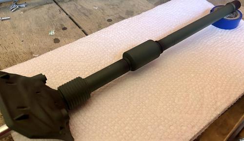

    Since I have been asked a number of times I though I would just go ahead and post this short "how to" modified the M60 mantle.
    The TongDe M60 does not currently come with an option for barrel servo recoil or even a HL type BB system recoil as the tanks mantle is not designed to accommodate either. If you are interested in adding a servo recoil the following modification or one similar to it must be done.

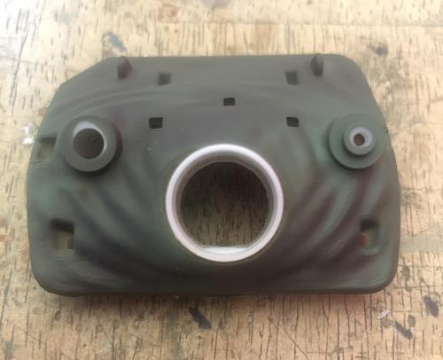

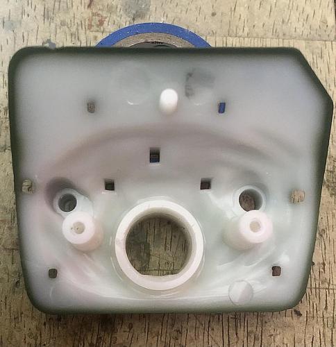

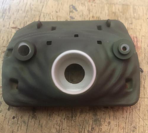

    The M60 mantle has a barrel "stop / support" molded in that needs to be removed. It is the smaller ring opening shown here in the first two photos.
    Click image for larger version  Name:	35950574-20AF-43D8-9C4E-A55261803852.jpg Views:	0 Size:	60.4 KB ID:	377983Click image for larger version  Name:	480FDA37-2E6E-40F3-81AC-1A031E6BD918.jpg Views:	0 Size:	103.2 KB ID:	377984

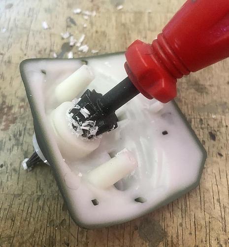

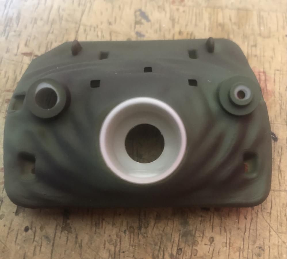

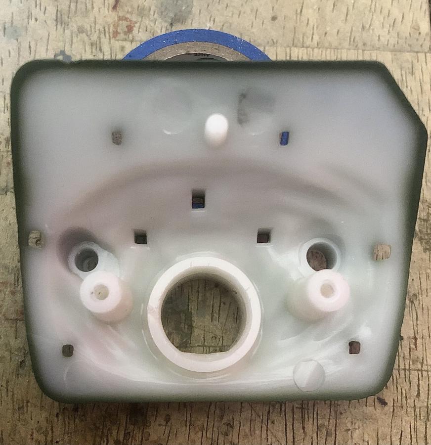

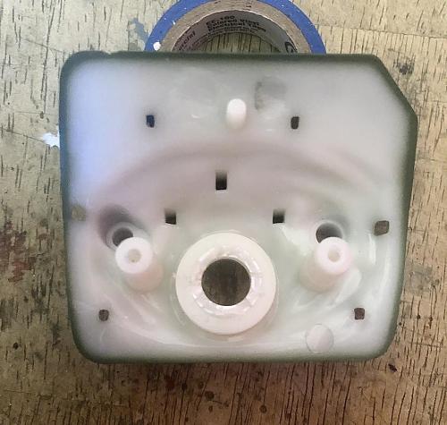

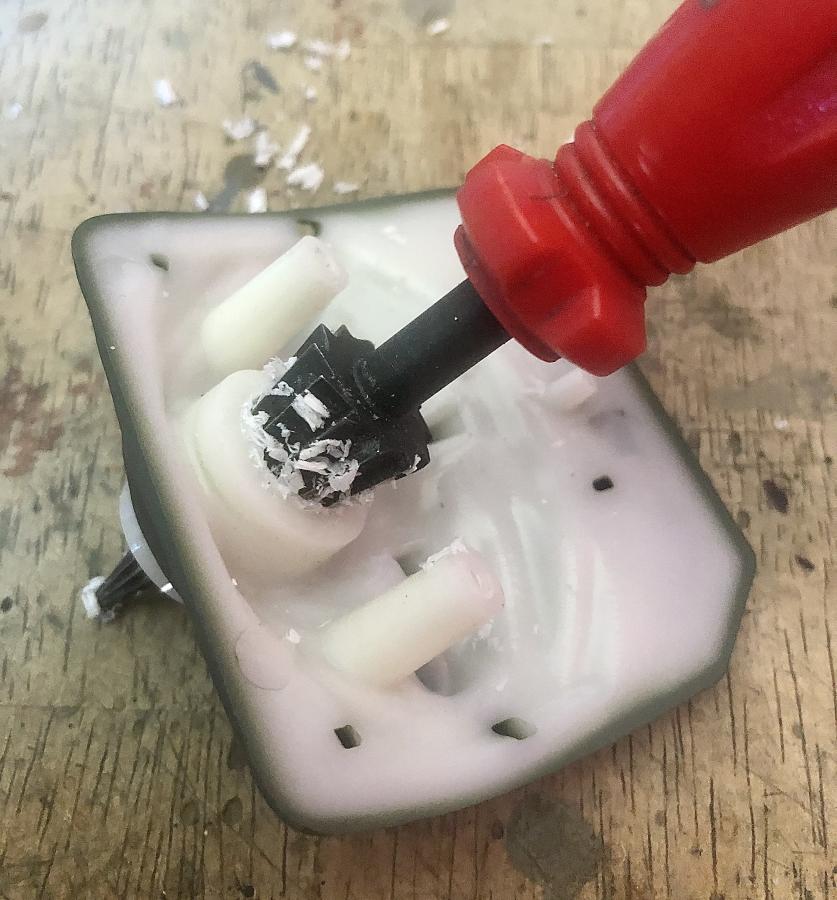

    A simple way to remove the "stop" is by use of a reaming tool as show below. This process takes only a few minutes.
    Click image for larger version  Name:	DEA8BA4A-CFD0-435F-AB8F-7B89CA77B4E5.jpg Views:	0 Size:	89.9 KB ID:	377985

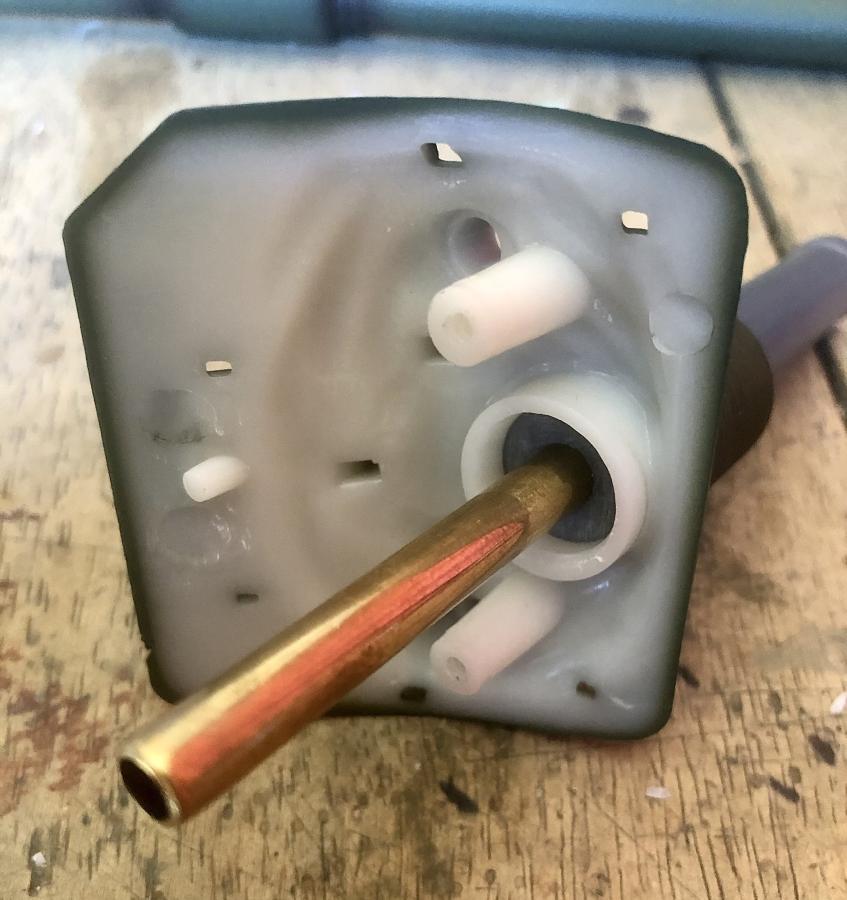

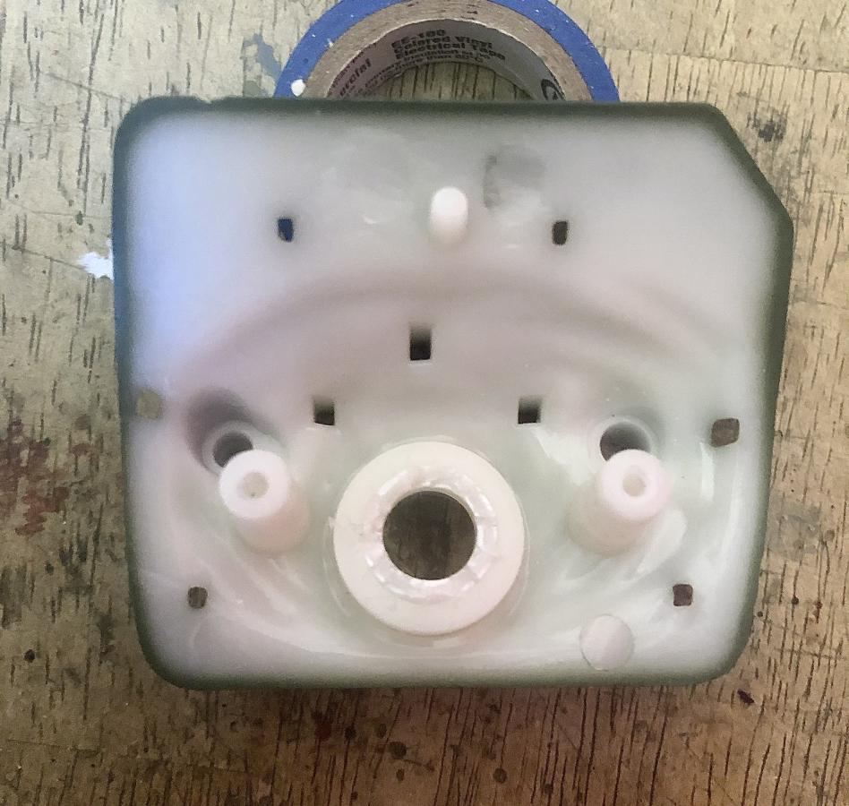

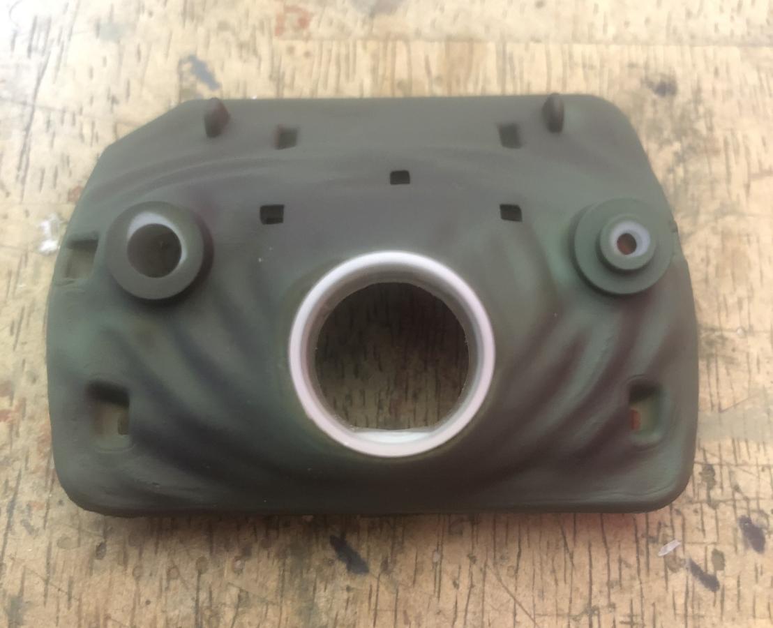

    This is how the mantle hole looks after the "stop" is removed. The barrel can now move deeper into the mantle during the recoil cycle.
    Click image for larger version  Name:	9A9F7262-C0C4-4DC8-B96C-2E12DD0415E9.jpg Views:	0 Size:	75.0 KB ID:	377986Click image for larger version  Name:	D9FE8A12-DA0F-4F47-93EA-A250C0097F8B.jpg Views:	0 Size:	96.9 KB ID:	377987

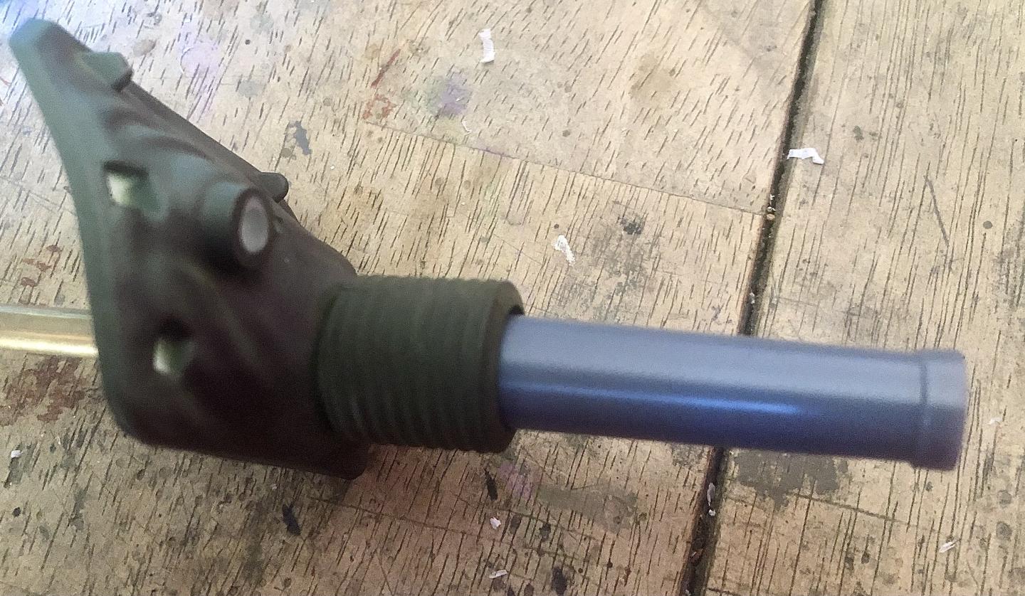

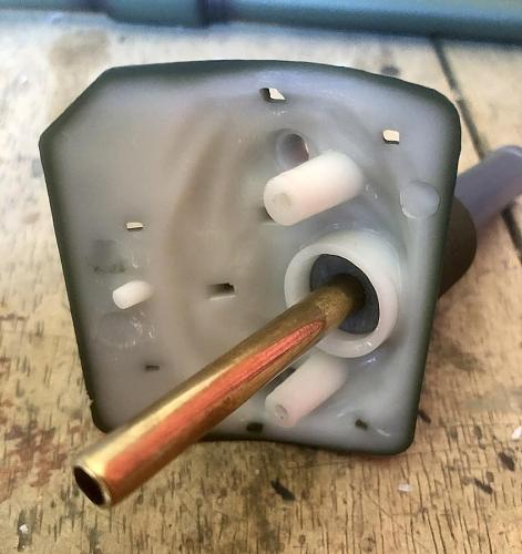

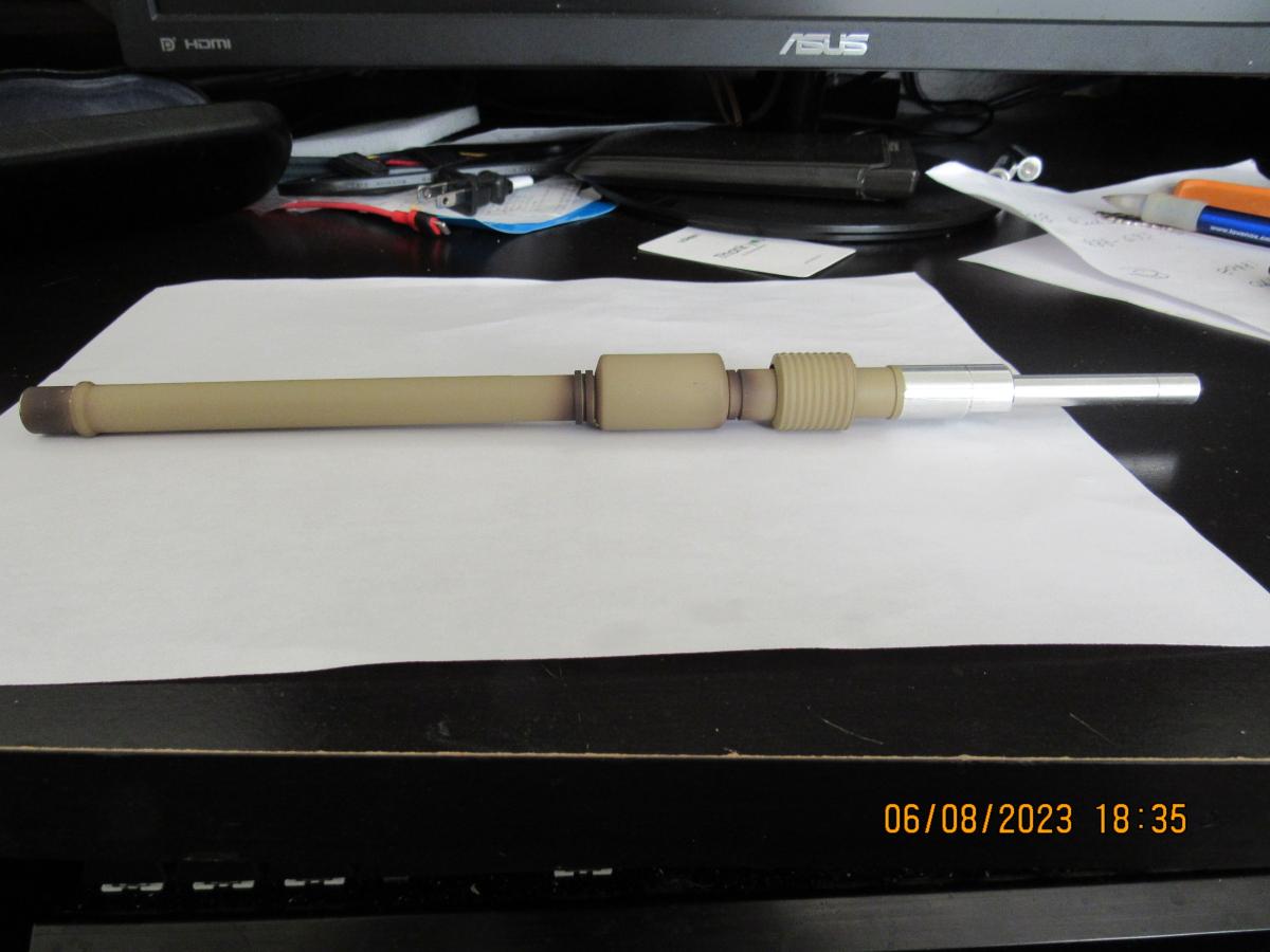

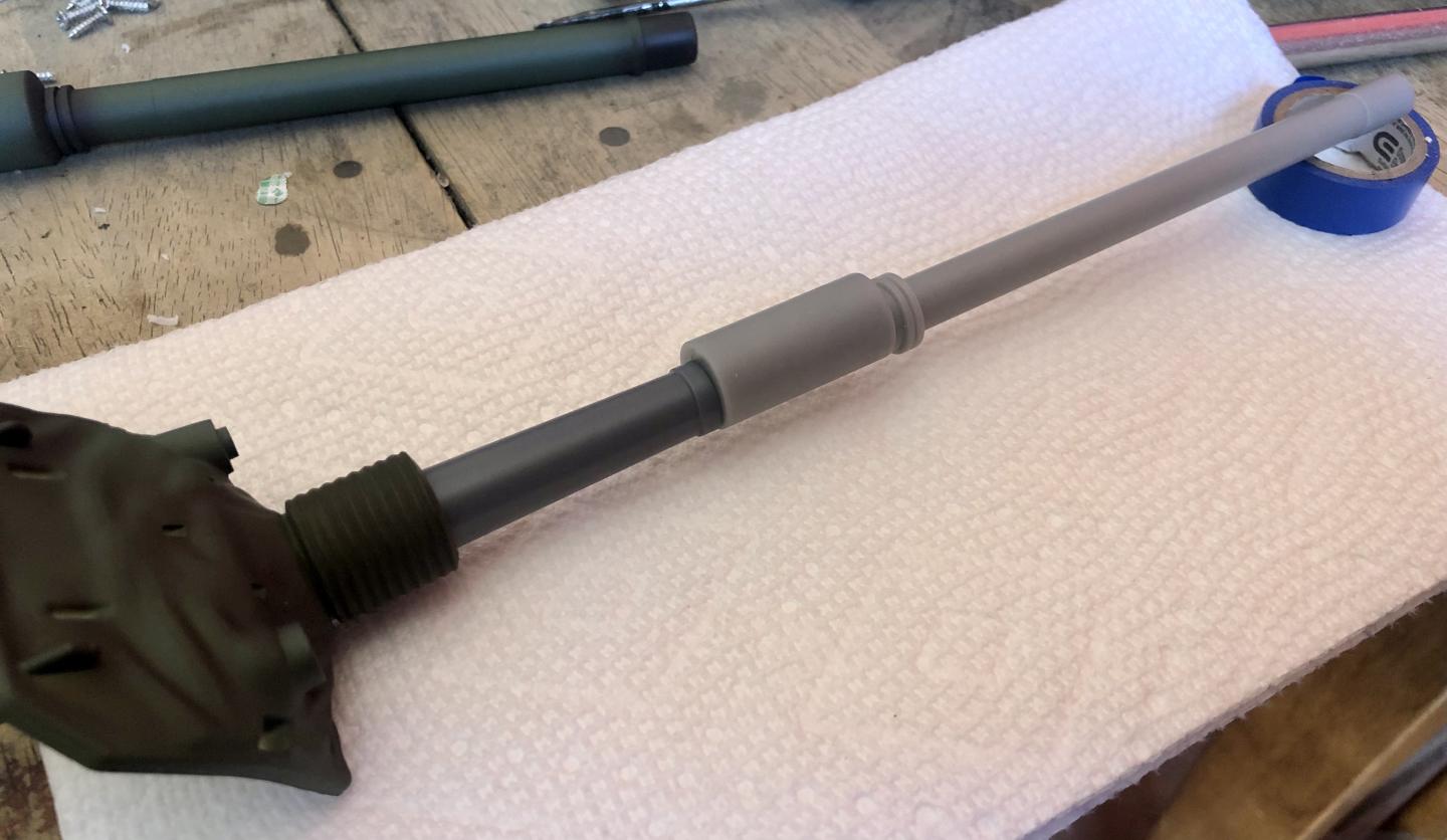

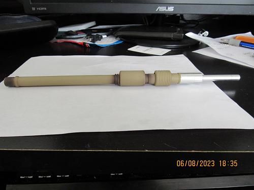

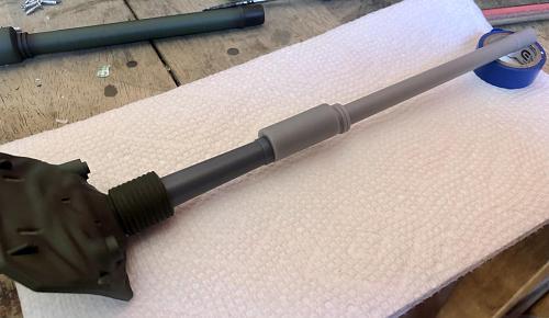

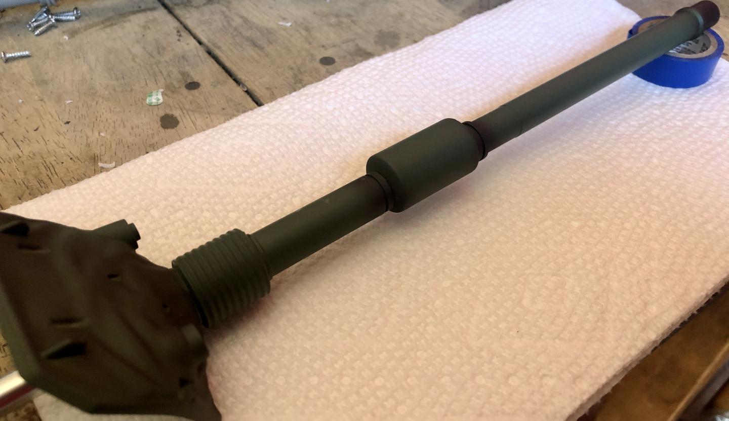

    Show here is a more accurate M68 150mm aftermarket barrel being installed, but the stock TD barrel can also be used.
    Click image for larger version  Name:	36032576-530F-4C36-9746-B2EE5D2946BF.jpg Views:	0 Size:	76.7 KB ID:	377988Click image for larger version  Name:	E5C68697-8094-45CD-A5A1-7F57BEED402F.jpg Views:	0 Size:	239.6 KB ID:	377989

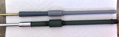

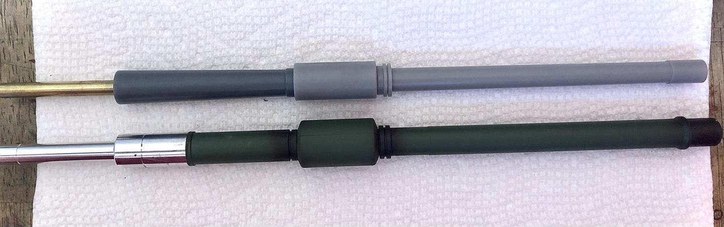

    Shown below with a correct more accurate scale aftermarket barrel and with the stock TD oversized barrel.
    Click image for larger version  Name:	47856F1A-C02C-4836-AFE4-16BF00D11205.jpg Views:	0 Size:	112.8 KB ID:	377990Click image for larger version  Name:	EF9AD8E9-EEE2-4A03-B619-D6707C5685C9.jpg Views:	0 Size:	106.9 KB ID:	377992

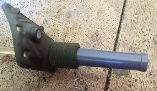

    Barrels side by side in case you were interested in seeing the difference.
    Click image for larger version  Name:	800D33D8-1827-4B41-B475-D5FB1416BA0F.jpg Views:	0 Size:	85.2 KB ID:	377991
    So as you can see the modification to the mantle is very simple and will allow you to easily install an aftermarket servo recoil system.

                I chickened out. Put the M60A1 back to original state. I hope to get back to adding recoil when I have better understanding of the TD turret configuration. I hope to see more post from people who follow Rubicon99 on the recoil mod.
                I used a step drill bit to remove the stop/support ring in the M60 per Rubicon99​ shown in Post Home

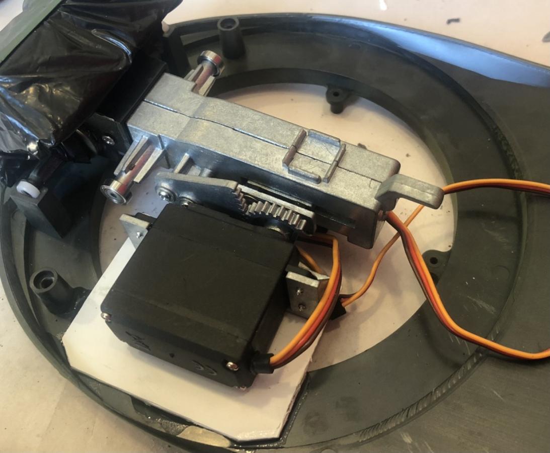

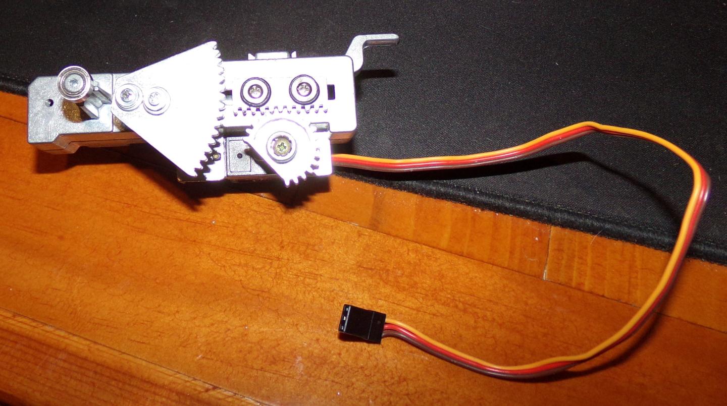

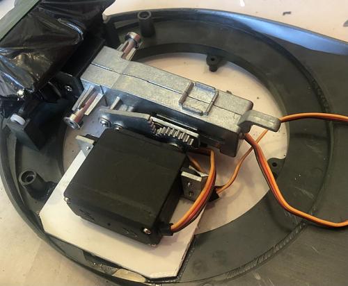

                  If someone wants servo recoil and flash it's not very complicated. Servo recoil and elevation are supported on the stock TongDe system. RichJohnson discovered this and I double checked it on the two TD systems I removed.
                  I understand there are those that want to retain the airsoft features and have barrel recoil, but honestly TDs airsoft mechanism although a copy of HL is not even as close to robust so using it for recoil is not something that will be a long term reliable function. I have been told that there will be some ungraded parts being added but not when that will happen.

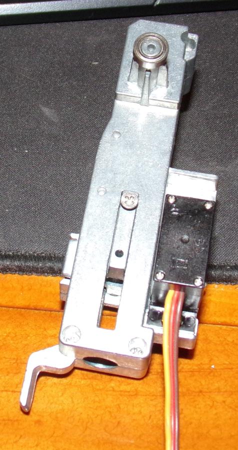

                  Servo recoil and elevation such as the one shown below are available through Toucan Hobbies on EBay.

                      This does not use the CN slots. It uses the servo slots on the 7.1 or other aftermarket systems. The TD system has two slots for servos which bypass the BB system. This unit does not fire BBS.
                      The recoil is gear driven by servo and mounted on the underside.
                        I am perfectly fine with no BB shooting. How is the barrel linked to the recoil gear/motor? I understand that I will have to drill out the mantle stop ring. Do I need any other hardware to use this dual servo unit? What modification is needed to the TD turret?
                        I am keeping the TD main board which does have 3-pin servo connections.

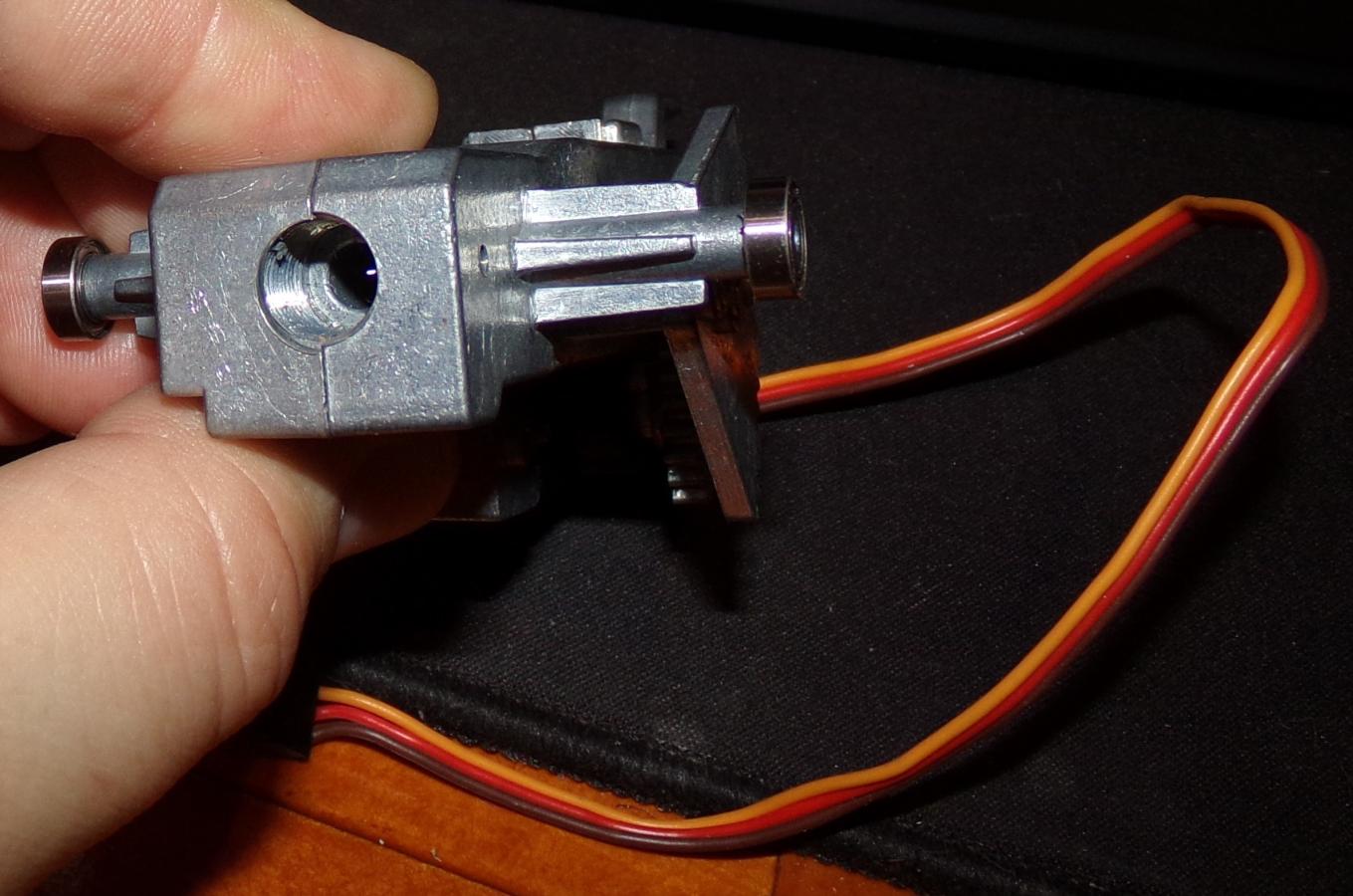

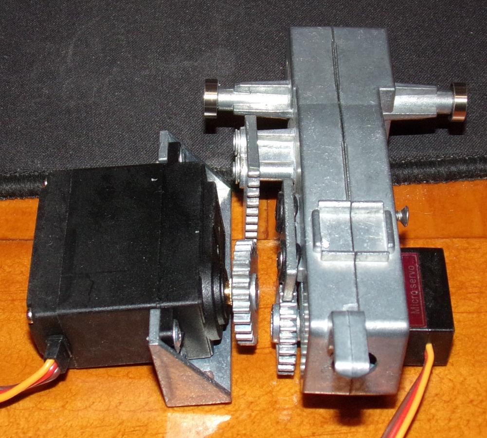

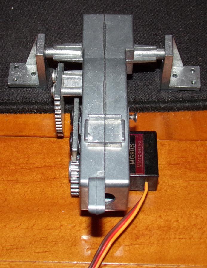

                          There is a "shuttle" inside the unit the barrel connects to. The shuttle is actuated by a servo connected to a linear gear the same way a Clark unit operates, but the whole thing is metal and not 3D printed. The barrel can be slide into the shuttle and secured using glue or a small screw/grub screw. You can see from the pics what the hole looks like in the front, what it looks like without the elevation servo in the way, how the elevation servo interacts with the unit, and how you can attach the included "feet" to mount it to any application.
                          The openings inside the shuttle may not fit your barrel diameter. In cases like that, I will cut the original barrel end shorter and insert a smaller tube either glued or secured with a grub screw inside the original to make the diameter smaller so it will fit inside the shuttle. The tail of my IS-2 barrel didn't reach the shuttle of the unit I installed in that so I used some brass tubing to extend the "tail" of the barrel to fit into the shuttle. This is the very reason I keep a dozen different sizes of brass tubing on hand in my hobby room.
