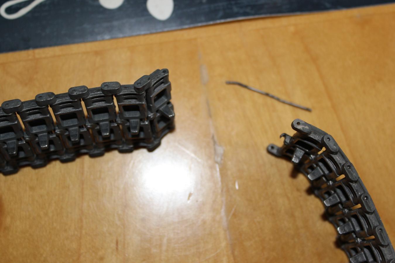

                    My M1 metal track went de-track with broken pin. I didn't run it that hard just on cement path and one of the track pin broke. Is this common and issue with metal track. And what are recommend way of having this occur again. Should I epoxy glue that pin back when I slide it back to the track. Thanks.
                    • #11
                      That pin looks pretty tweaked, I'd look at the track tension first? Was that track pretty tight? Or did the pin just start walking out and then got to the point where it caused a problem and got tweaked that way maybe?
                      ON reassembly a spot of glue on the end probably won't hurt anything, just to hold the pin in place. And a spare set of tracks :) I actually used the spare track links in the box (with my plastic tracked Abrams) as added detail and used tiny zip ties to attach to the side of the turret on the rack.
