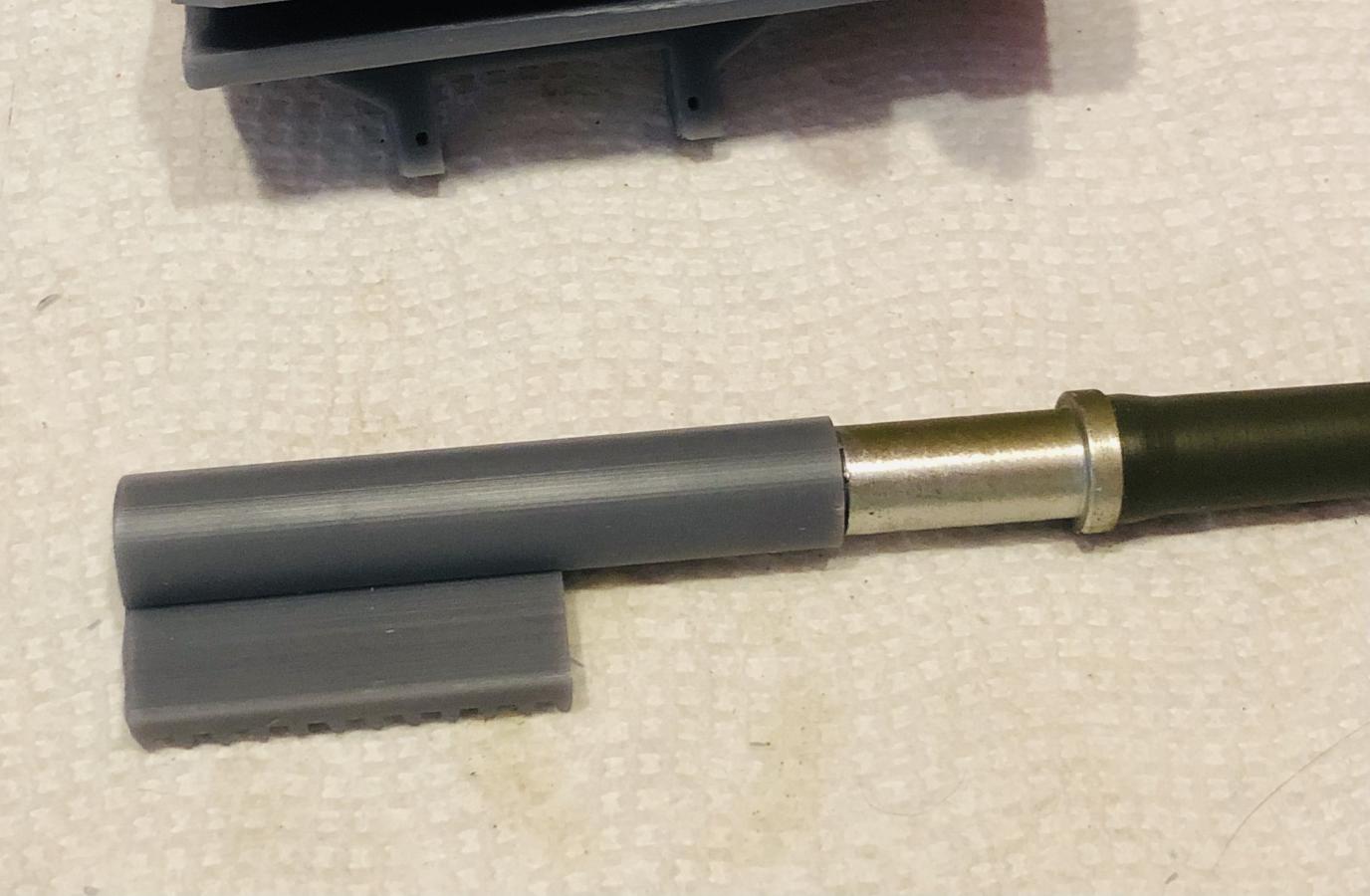

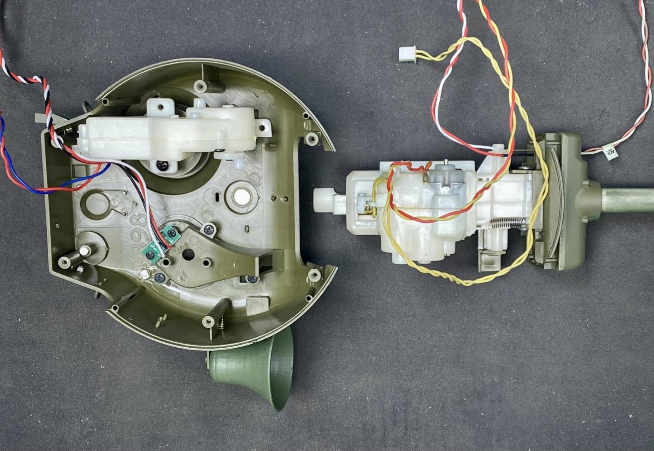

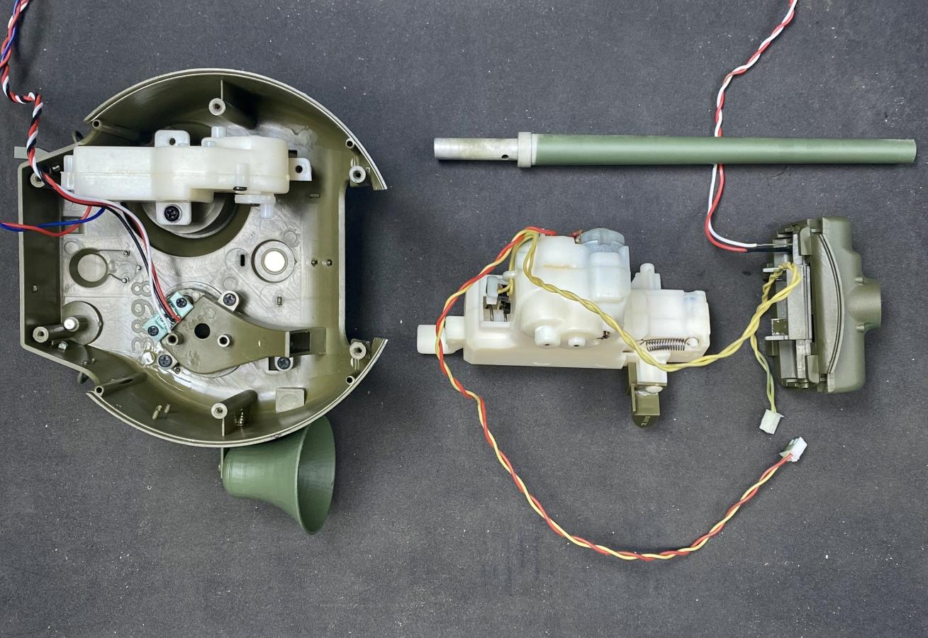

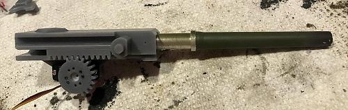

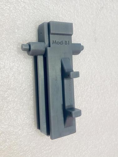

    Recently I was given the opportunity to test and review a servo operated barrel recoil unit by a local company, the "Recoiler Mod B-1" by JVM3Dconcepts. It's a 3DP item, made of high strength resin, designed to fit in Heng Long tank turrets. It allows the barrel to snap back upon firing and to slowly return to battery. It replaces the stock Airsoft gun, so one can't fire pellets anymore.

    Interesting.
    Are the dimensions similar, smaller or larger than the current Heng long units?
    Is there a spot to mod or cutout in the unit to fit a flash and smoke unit or LED for IR battle?

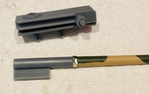

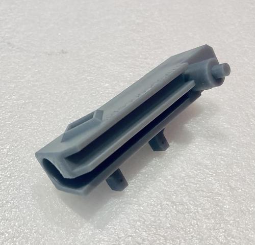

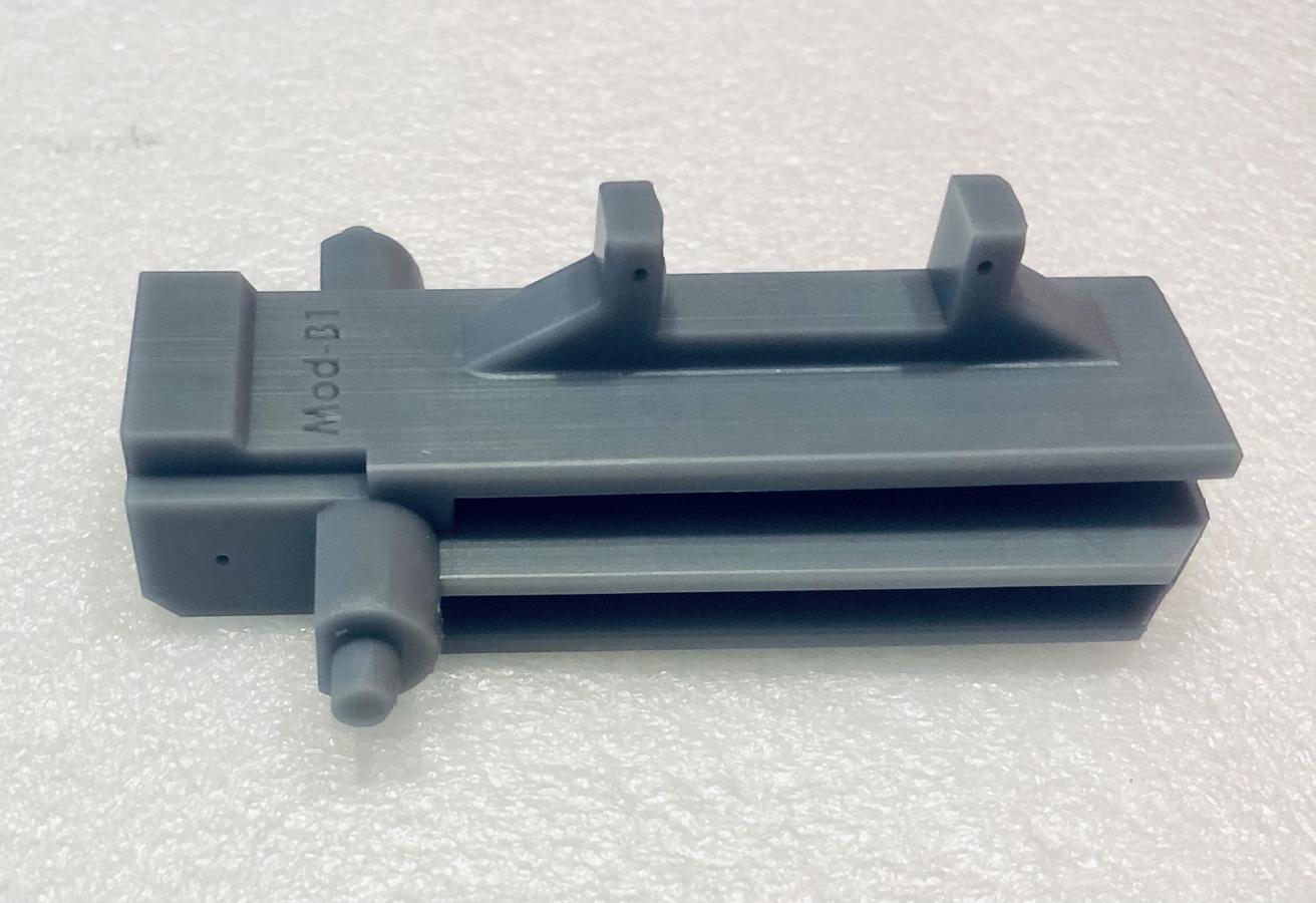

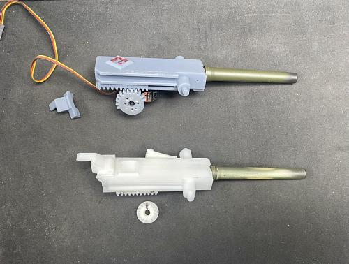

      Form follows Function:

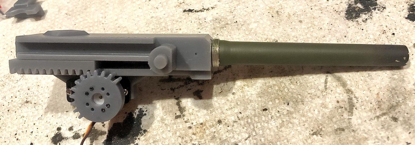

      The Mod B-1 is similar to the Clark recoil unit, which makes sense as it has to fit into the same space. The Mod B-1 handles the recoil, while the tank's elevation function is retained by the motor system. It can be run by the side type motor that connects to the side groove, or the rear type motor that pushes the tab sticking out of the back of the unit. On the B-1, this can be omitted if not needed. A positive feature of the B-1 is the versatility of the servo mount. The servo can be mounted with the gear towards the front or rear as desired, and the gear wheel can be mounted in different ways to the servo. This was helpful when I had to change servos at one point. Each brand has a slightly different shape!

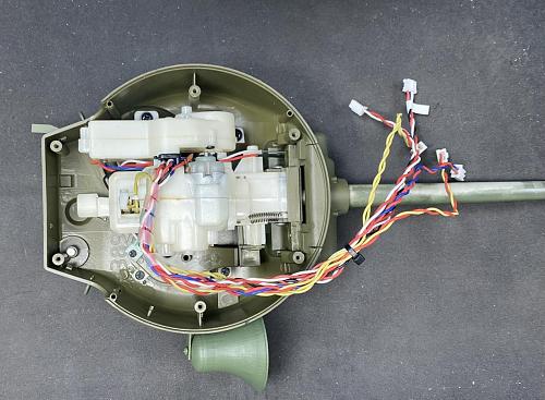

        How to put it in:

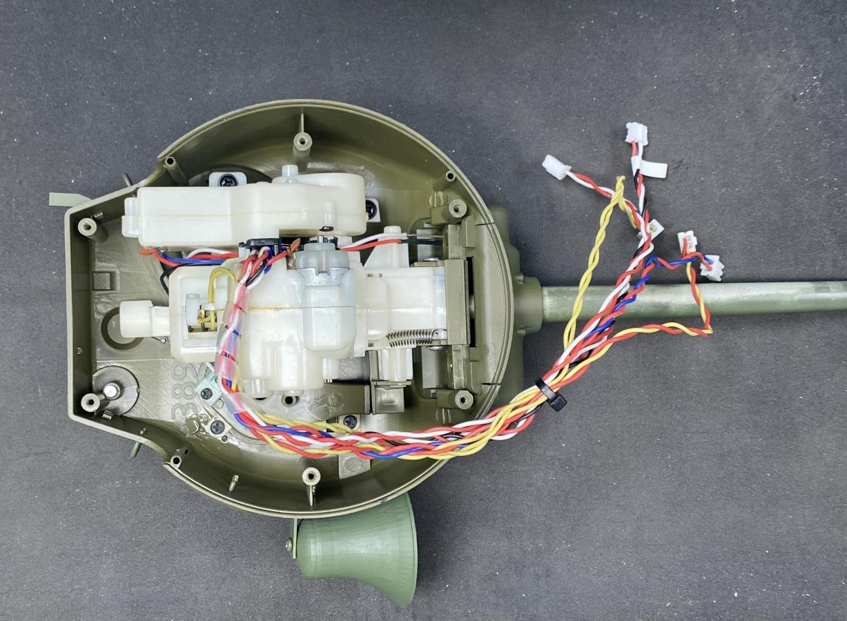

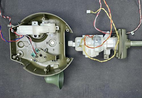

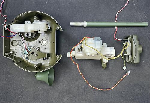

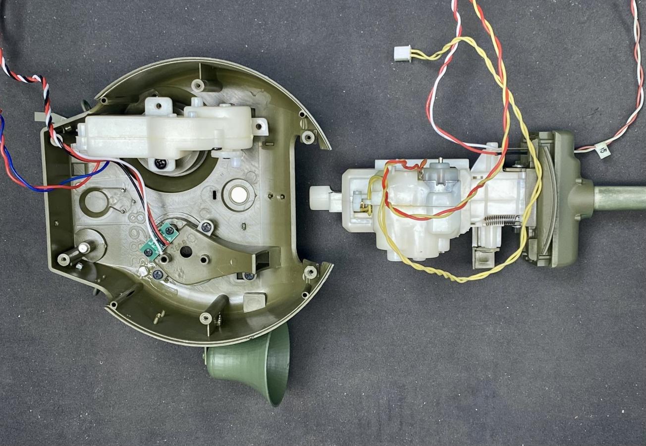

        So how easy is it? If you've installed units like this before you can skip over the next. I put mine in a Sherman turret that will eventually be part of a Kelly's Heroes Sherman modification. (JVM has tested it in a number of HL and TD tanks.)

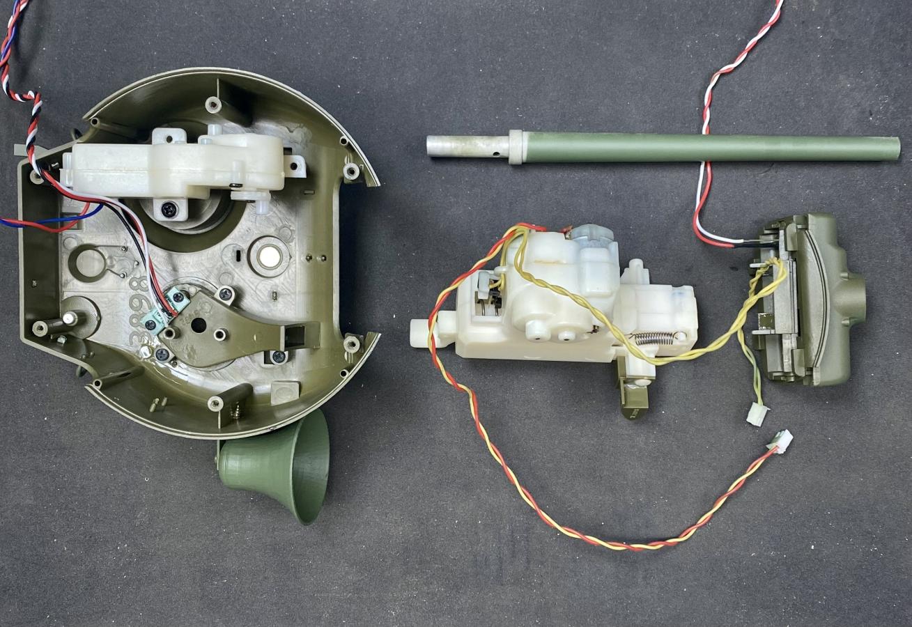

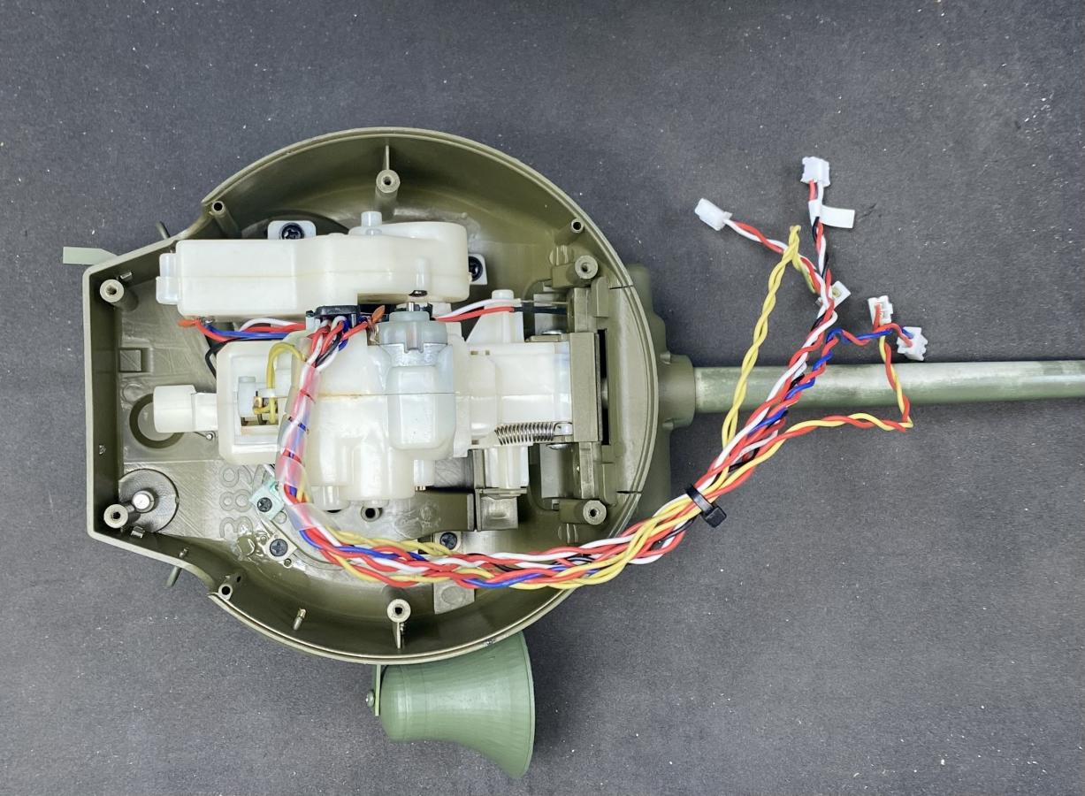

        Here's the starting point, with the turret bottom removed showing the Airsoft unit and the side motor I mentioned earlier.

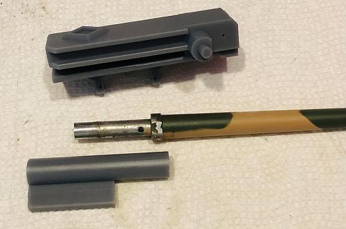

        I've removed the gun/mantlet/barrel assembly from the turret.
        Remove the mantlet from the airsoft gun. The barrel will then slide out from the back of the mantlet.

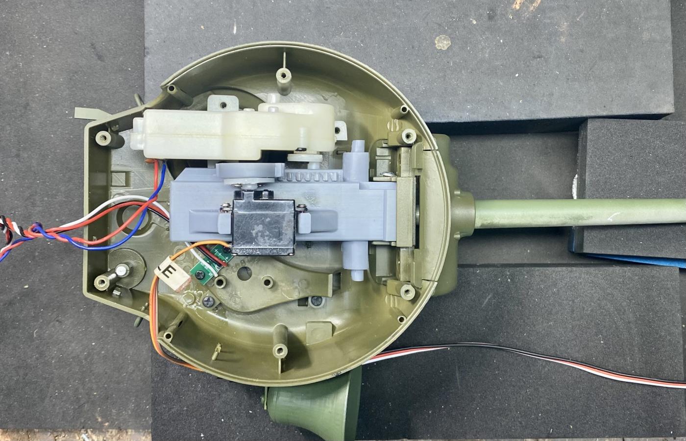

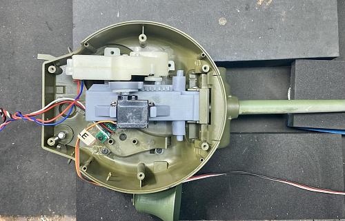

        Put the barrel back in the mantlet, attach the B-1 to the mantlet, and snap the unit beck into the turret. Make sure the side motor is mated correctly to the B-1.

          My opinion? Very positive. This is a prototype and based on some suggestions will have a couple of changes in the next version. This one fits well and works as desired. JVM3Dconcepts is a small batch enterprise run by experienced hobbyists. When the final version of this unit is ready, it will available on Rich Johnson's website, RichardSJohnson.net.
          A closeup view of the installation:
          Click image for larger version  Name:	IMG_E3605.jpg Views:	0 Size:	109.3 KB ID:	380670

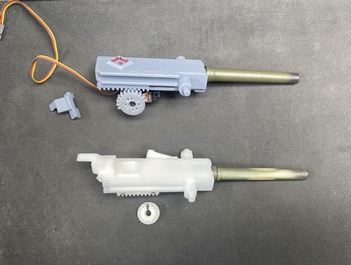

            Originally posted by MrChef
            Interesting.
            Follow-on photos show relative sizes. The slide is hollow, so running wires through it is very easy. Whatever fits in the barrel, fits in the recoiler.

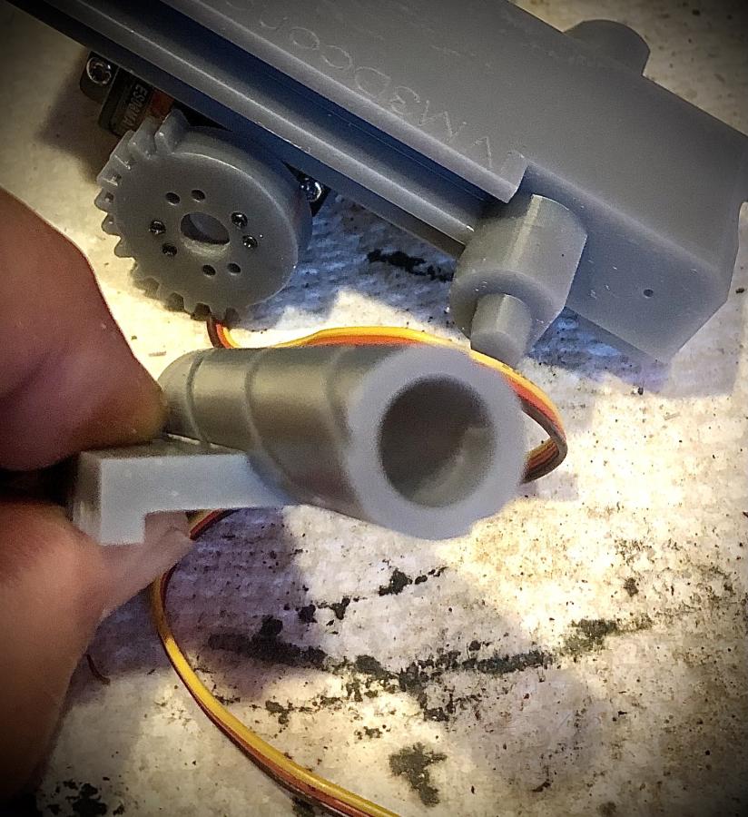

                      • Zippersnapper
                        Insane Unknown
                        • Mar 2021
                        • 502
                        • SW Texas

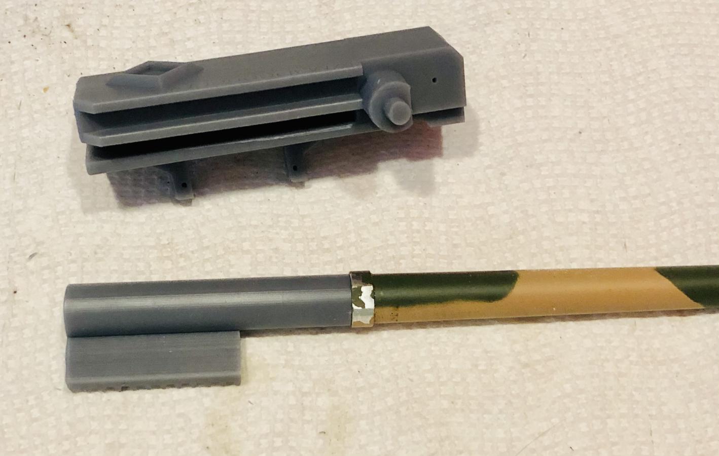

                        The Mod B1 is designed with a full length shuttle and internal "bore" larger then the stock HL barrels bore so adding flash and the associated wires is super easy because there is more room. Much more then on any other servo recoil of this type.
                        As we know the HL recoiling barrel assembly has a smaller diameter "shuttle" that the actual barrel slides on. Is it safe to assume this universal recoiling assembly would allow ANY tank barrel to ride on it, if it were removed from a stock mantlet ? In other words, tanks that dont come with a BB recoiling unit ? You say the "bore" is bigger, but will any tank barrel fit over the shuttle?
                          inquiring minds want to know.....more....

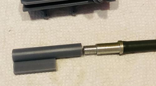

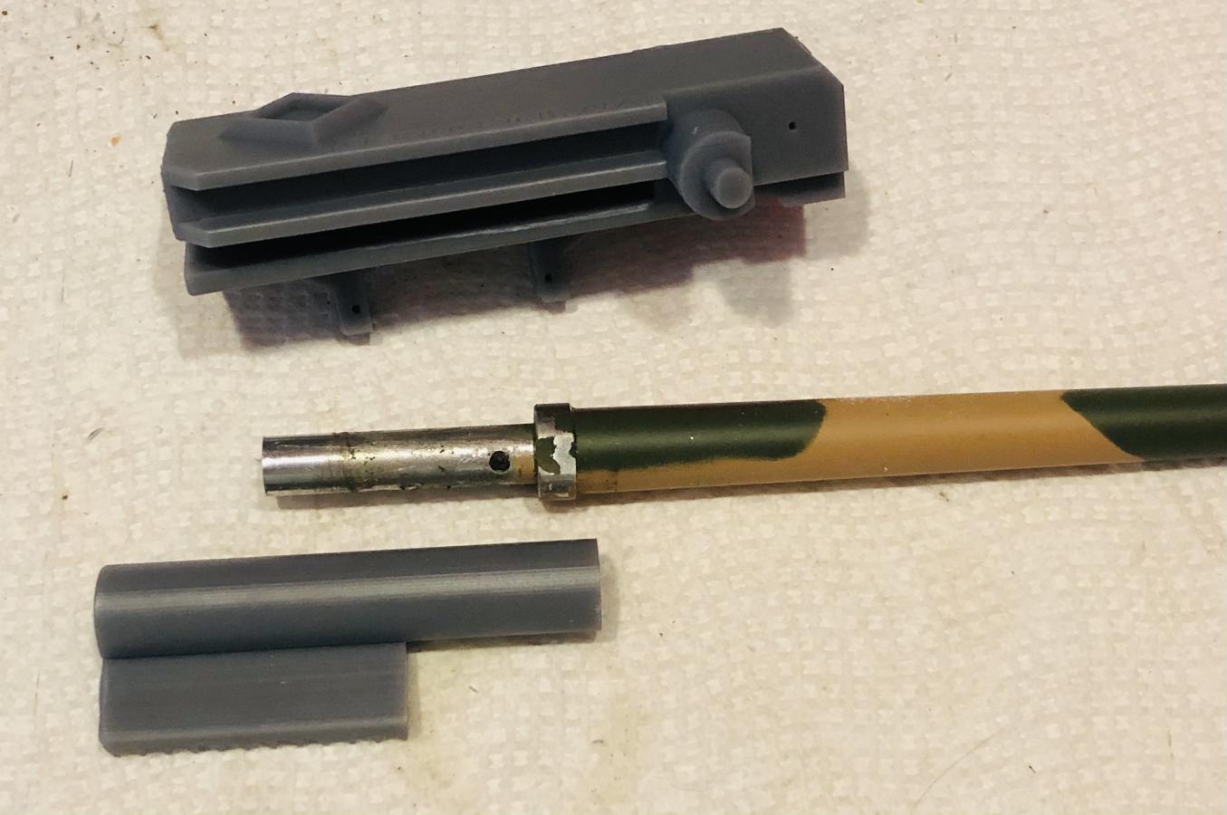

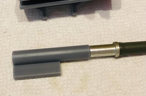

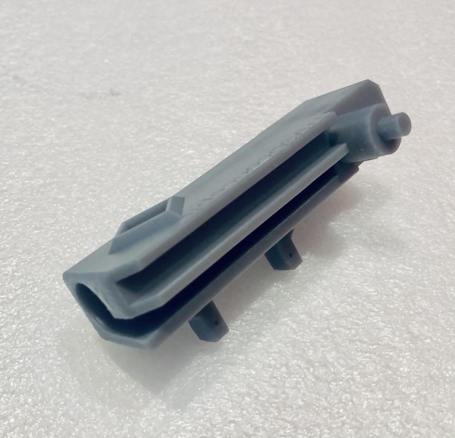

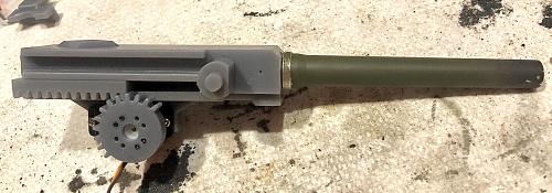

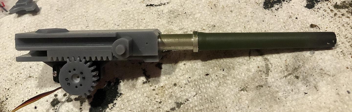

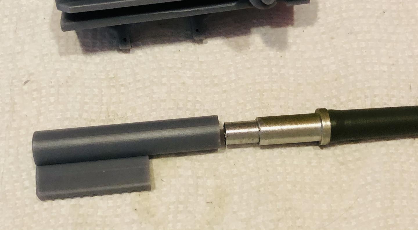

                          Only HL and TD barrels are direct drop in. BUT other aftermarket barrels can be modified to fit. For instants a Tamiya Pershing barrel is not a direct drop in, but with a simple brass extension tube attached to its rear it can be made to fit. No different then what other types of aftermarket recoil systems need done to fit a variety of aftermarket barrels.
                          Shown below is a HL Panther barrel laying between the Mod B1 and recoil "barrel shuttle" and then installed in the shuttle.
                          Click image for larger version  Name:	8AEC6F9D-13E3-4618-B56B-D854CD07E42D.jpg Views:	0 Size:	107.0 KB ID:	380889Click image for larger version  Name:	D69EAE5B-8E3F-4B55-BE84-A55587C8E059.jpg Views:	0 Size:	111.8 KB ID:	380886
                          This photo is of a HL M4 barrel.
                          Click image for larger version  Name:	6FF01FCF-2C85-4C65-A9A8-9CDE81A2CC11.jpg Views:	0 Size:	90.2 KB ID:	380888Click image for larger version  Name:	6A14B7CD-2CB9-4344-B529-B7FA6448656D.jpg Views:	0 Size:	105.4 KB ID:	380887
                          Click image for larger version  Name:	EBA37543-C8EE-4EBA-8F40-A5C94D33A1A2.jpg Views:	0 Size:	125.3 KB ID:	380899
                          HL M4 barrel "in battery"
                          Click image for larger version  Name:	E777B9FC-481F-4B41-99CA-61D658A47BDF.jpg Views:	0 Size:	131.7 KB ID:	380898 HL M4 barrel "out of battery" aka max recoil position. This is just an exaggerated example not how it should actually recoils in the tank.

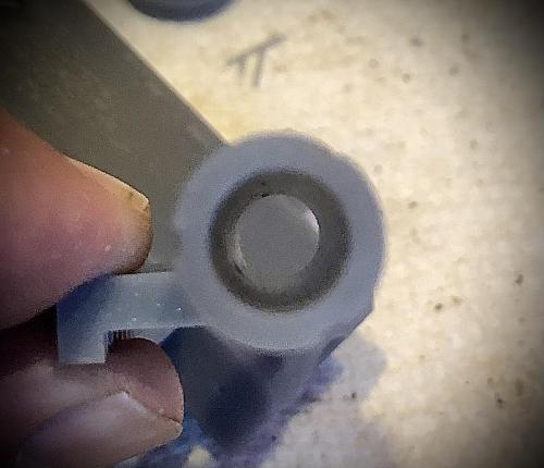

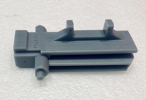

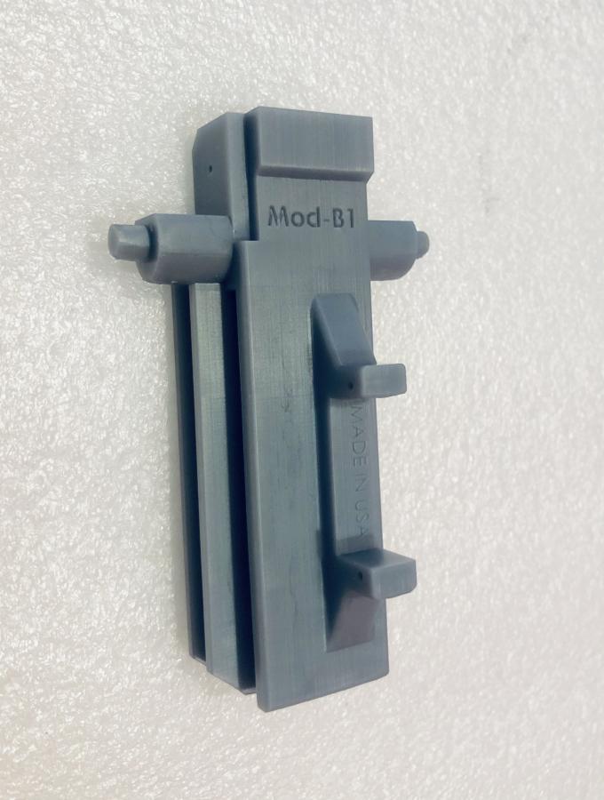

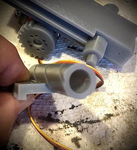

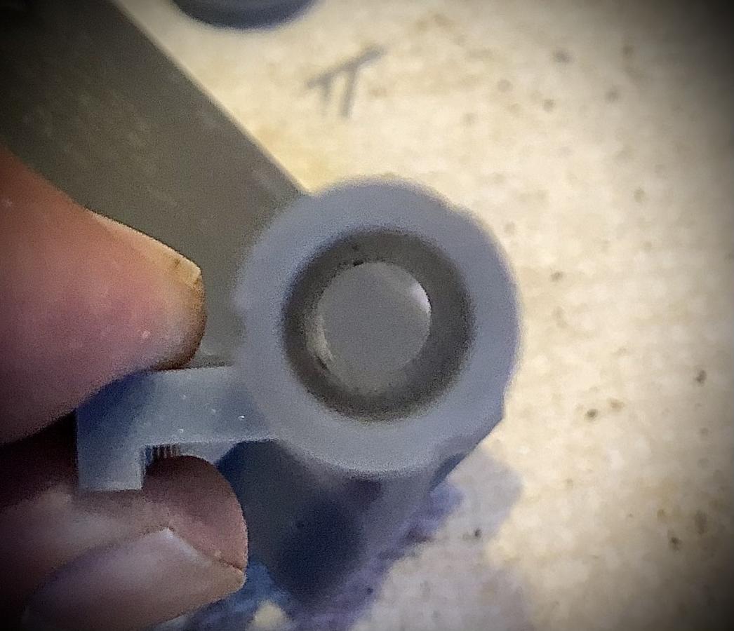

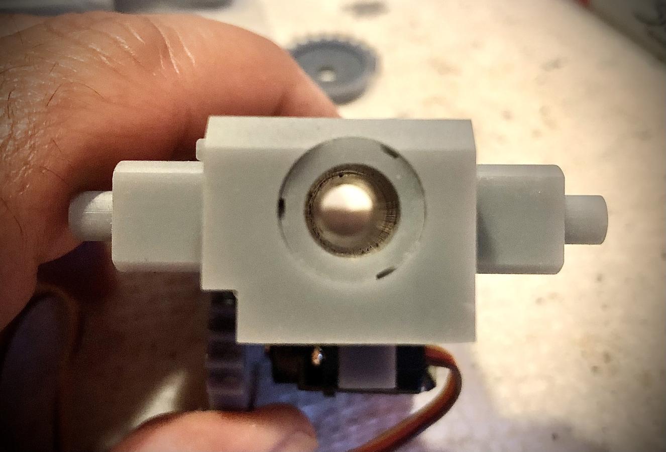

                          Here are a few of the "breach" section of the Mod-B1 recoil unit. Click image for larger version  Name:	A458B63D-F922-495D-8B44-ABA2A7808EBF.jpg Views:	0 Size:	110.9 KB ID:	380890Click image for larger version  Name:	C78FA38B-E3D5-4845-9B65-DB2F7FED45A7.jpg Views:	0 Size:	63.8 KB ID:	380891Click image for larger version  Name:	65833AA0-A101-4D5E-8DBB-CB9FB2EC57A4.jpg Views:	0 Size:	78.4 KB ID:	380892
                          "Shuttle" bore is 8.44mm wide and runs the entire length of the shuttle. Mine is the "extreme duty" version note the spiral cuts on the shuttle. These are added for self cleaning if you run the unit dry or can be used to hold extra ceramic grease or other lube for those that want to run the shuttle "wet". I will be running the unit dry because it is rather slick already and the added cleaning benefits are useful to me given the dusty conditions I drive my tanks in often.
                          Click image for larger version  Name:	1CE10EB4-453E-4C07-AB95-AE7BC258D9A1.jpg Views:	0 Size:	114.4 KB ID:	380895Click image for larger version  Name:	DCAA7628-8DAB-4ED4-8589-94CA6EAE04D0.jpg Views:	0 Size:	121.2 KB ID:	380893Click image for larger version  Name:	2E82DD3C-7231-405F-AC51-BDA97D1C09C1.jpg Views:	0 Size:	97.9 KB ID:	380894

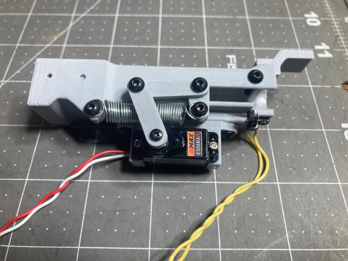

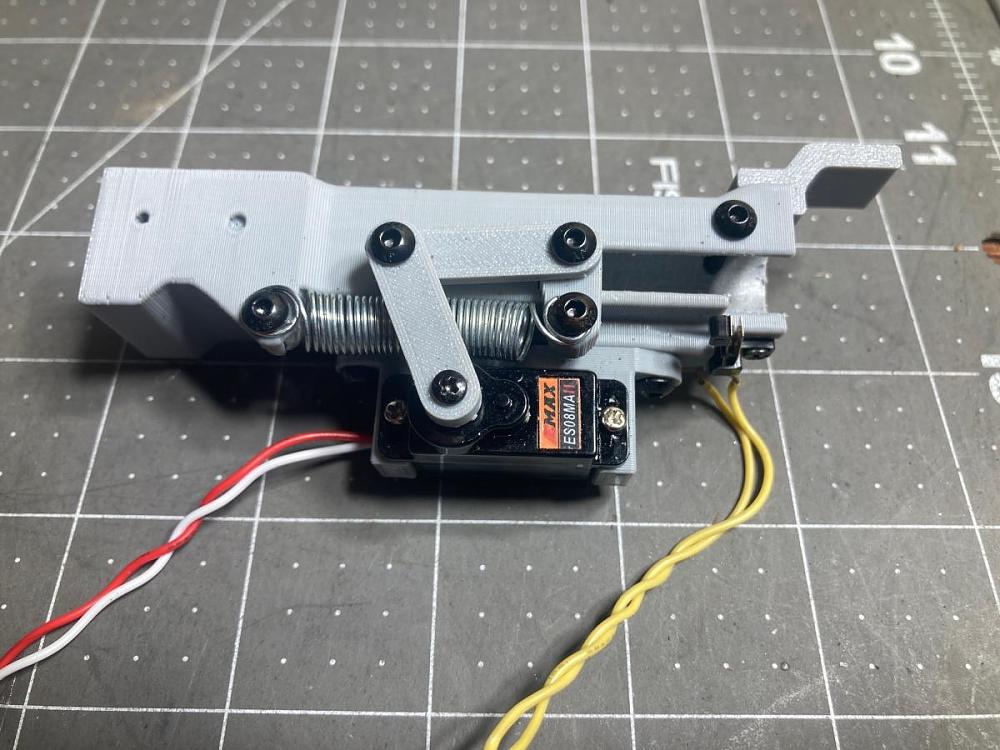

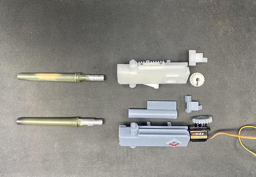

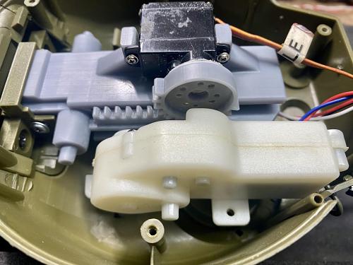

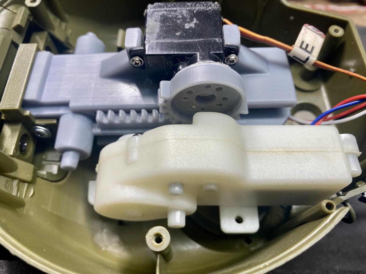

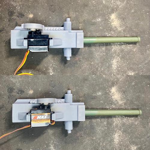

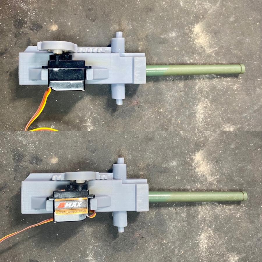

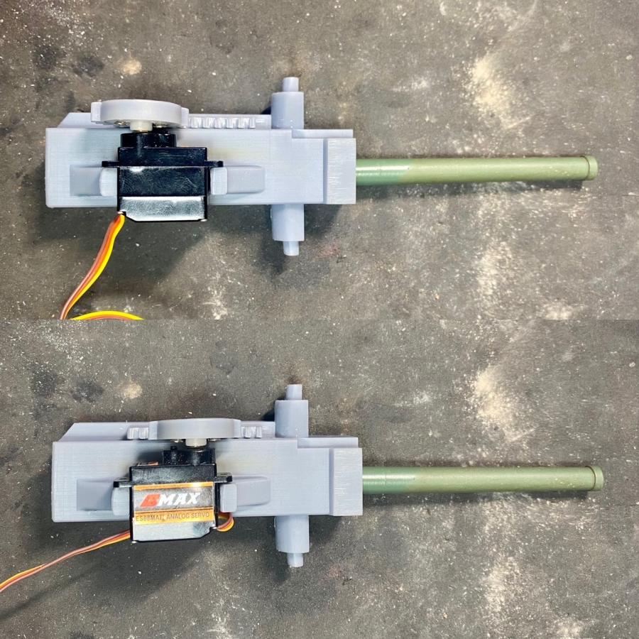

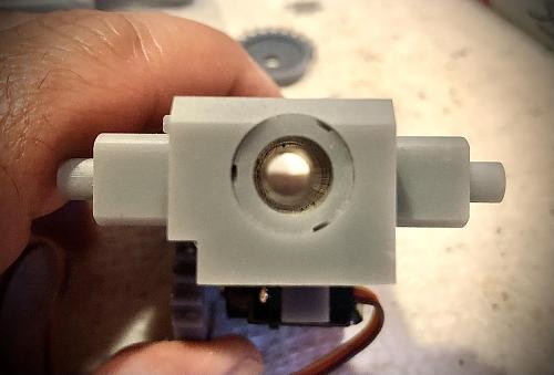

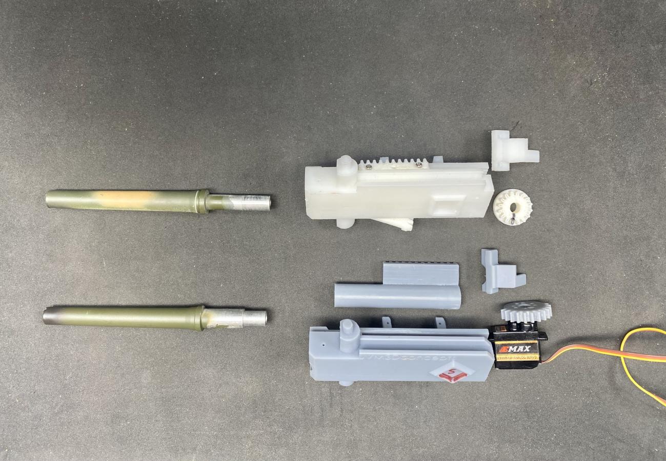

                                      My friend in the RC Irvine Tank Club made this unit. I gave me 1 to test-run it. It works. We will be able to keep our HL 7.0 boards after all and have the barrel recoil units for our tanks. I haven't tried on the 6.0 board yet. I will install this unit into a tank this week to see the result.
                                        Click image for larger version  Name:	IMG_3413.jpg Views:	8 Size:	130.5 KB ID:	385343
                                        That is a complex design for a servo recoil. The small eMax servos are not known for handling torque loads well. So pulling against a spring and moving the weight and friction of the barrel repeatedly is asking a lot of a small servo. It also looks like he modified the servo wires from three to two. Not sure that will go over well with the Emax servo or other servos over time and use. Is it going to be supplied with the modified servo?
                                        If you are trying to achieve servo recoil with the 7.0 MFU you may not know this, but there is a product made that allows the 7.0 MFU to be used with a servo. There is a thread about it somewhere on this forum. From what I remember it's cheap and largely plug and play simple and does not require modifications to the servo lines.
