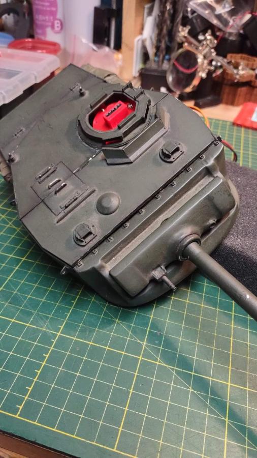

    A fellow RC Tanker asked me to fix his old worn out Comet with broken recoil system and old HL IR receiver mount.

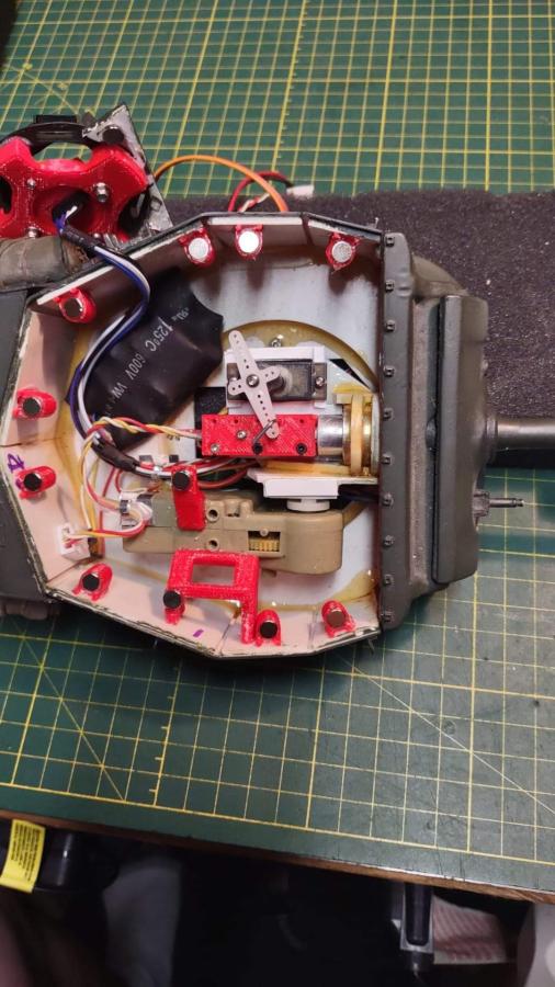

    Since the entire turret was from a Styrene kit and epoxied together, I decided to scrape the upper turret panels off (cause they had broken off previously...)
    And put in a bunch of magnets that would hold the upper turret panels securely, but also take the pressure of installing a Tamiya style apple.
    The red box on the bottom of the image will hold the main power On/Off switch, accessible from the turret hatch.
    With the upper panels installed. Again, I'm not a modeler and I am not correcting the sag of the turret's front "casting" that mounts the mantlet. IR emitter will be via a barrel clamped setup from a tamiya kit.
