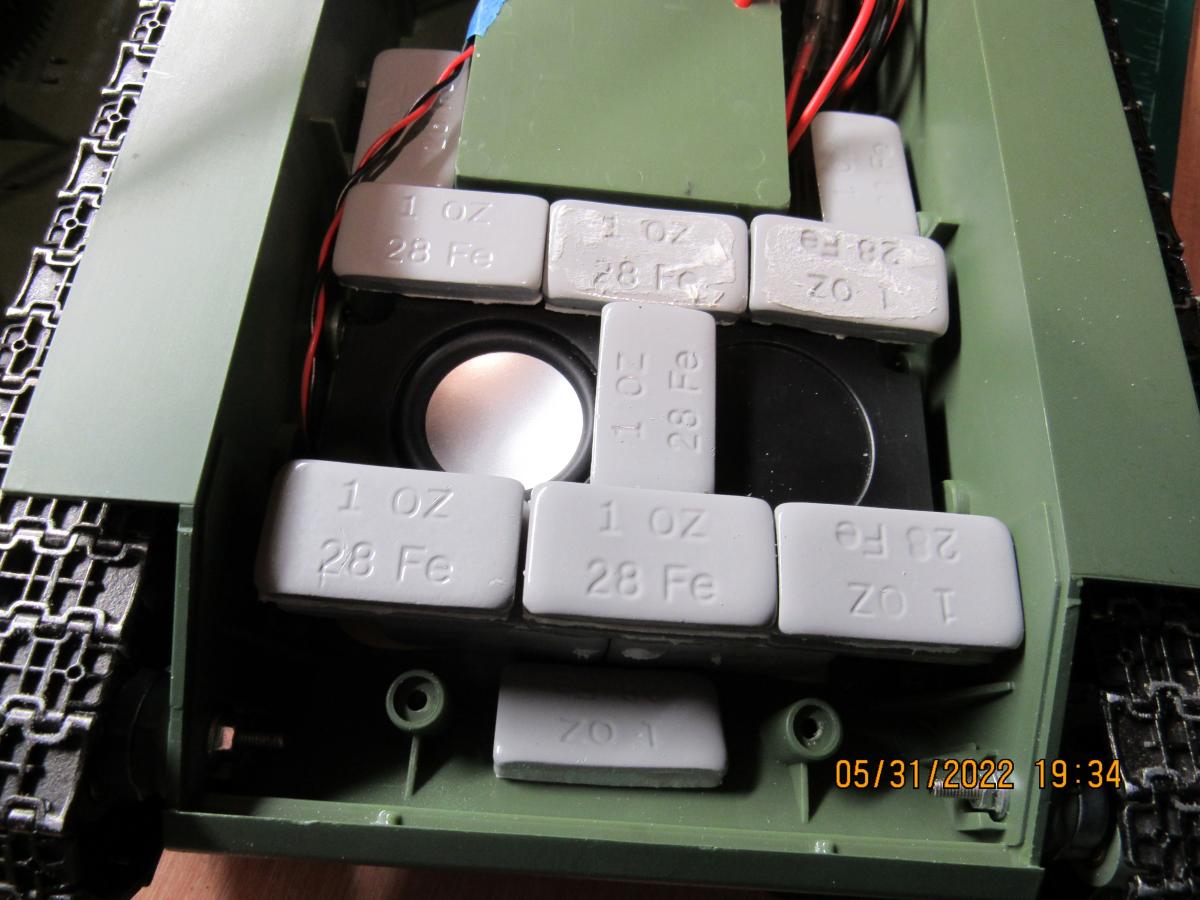

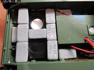

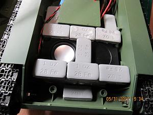

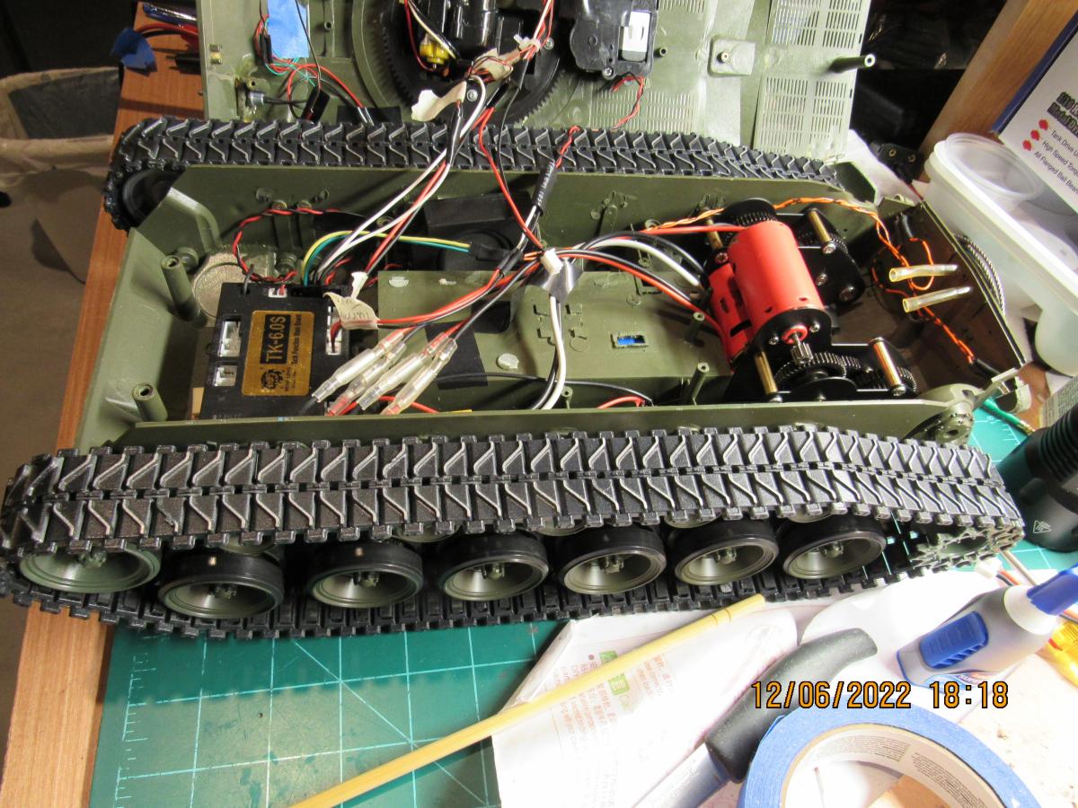

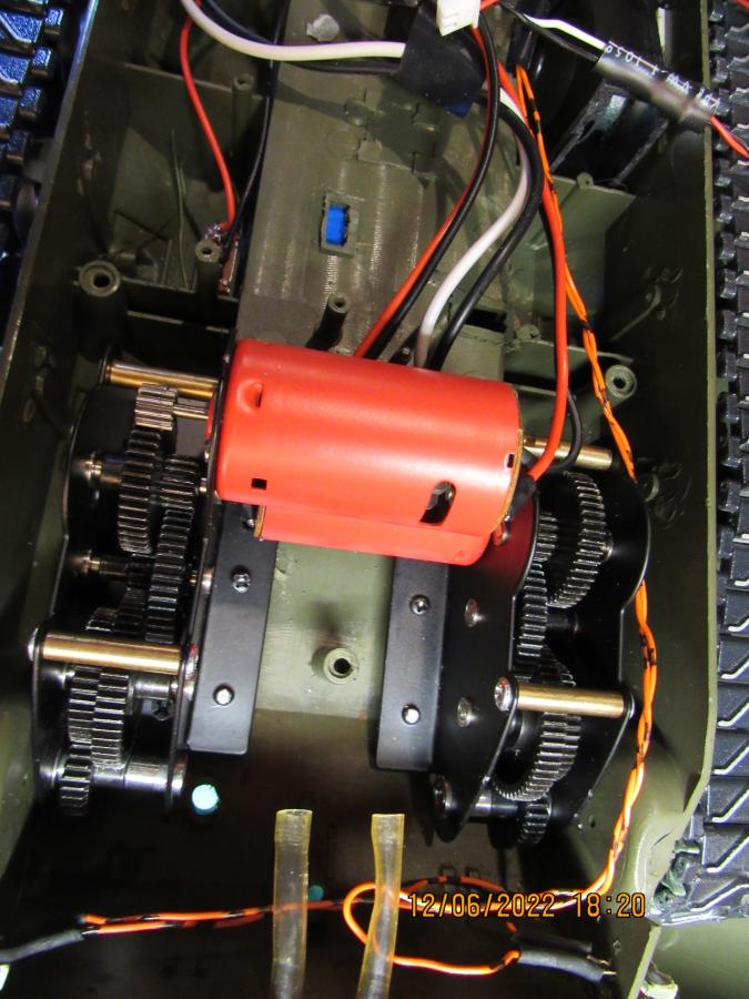

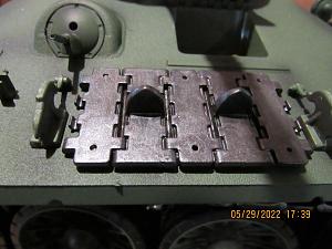

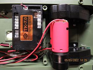

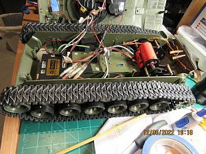

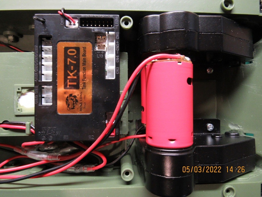

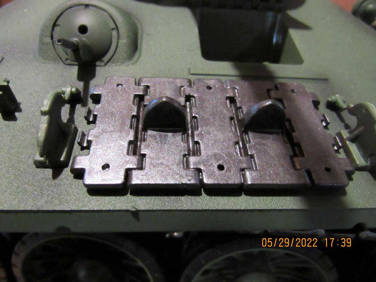

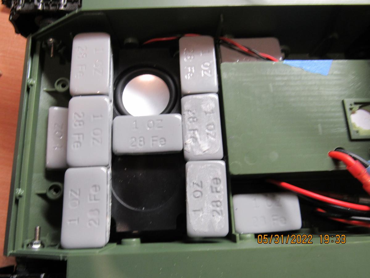

          I second both Rubicon99 and tank_me. I have not yet run into a case that a 1:16 scale RC tank gets too heavy. On the contrarily, I added 2 pounds of lead weight to a HL T-34/85 to make it run more realistically.
          The Pershing balances itself very well and has good total weight with all the metal parts. For all metal upgrade, it is very beneficial to get ball bearings for all moving parts, gearbox, sprocket and wheels. Replacing the HL stock grey 380 with a 390 motor helps too.

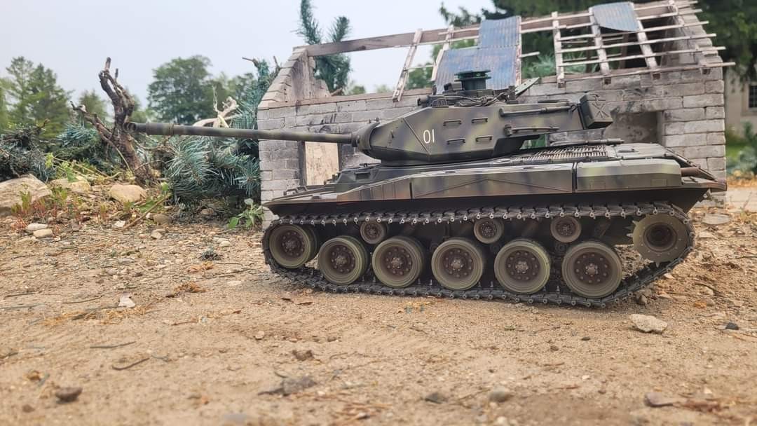

            I have a few ounces of mass attached to the front lower hull for balance.
            I have metal sprockets and tracks on my Bulldog. Plastic arms and roadwheels currently. On ground the tank drives excellent and has no issues with tracks what so ever, tracks off and the roadwheels are SLOPPY due to the plastic on plastic with dust & debris eating away at the axles/hubs.
            When one fails, I'll upgrade the arms, roadwheels and idlers and install a Henntec Idler system, but not before then.
            Love my Bulldog!

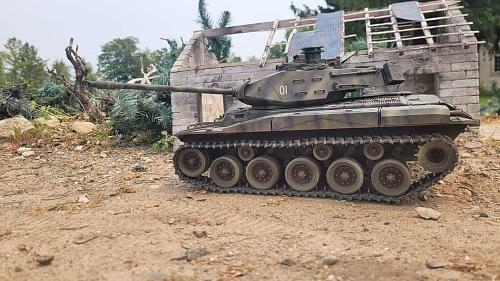

                    It depends on many things. Suspension spring strength, battery placement, gearboxes, etc...
                    An example of an unbalanced Bulldog, albeit this is soft suspension springs in the front.

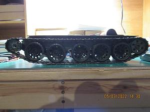

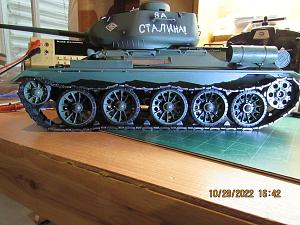

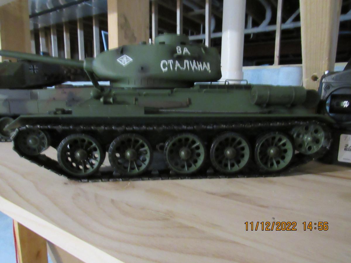

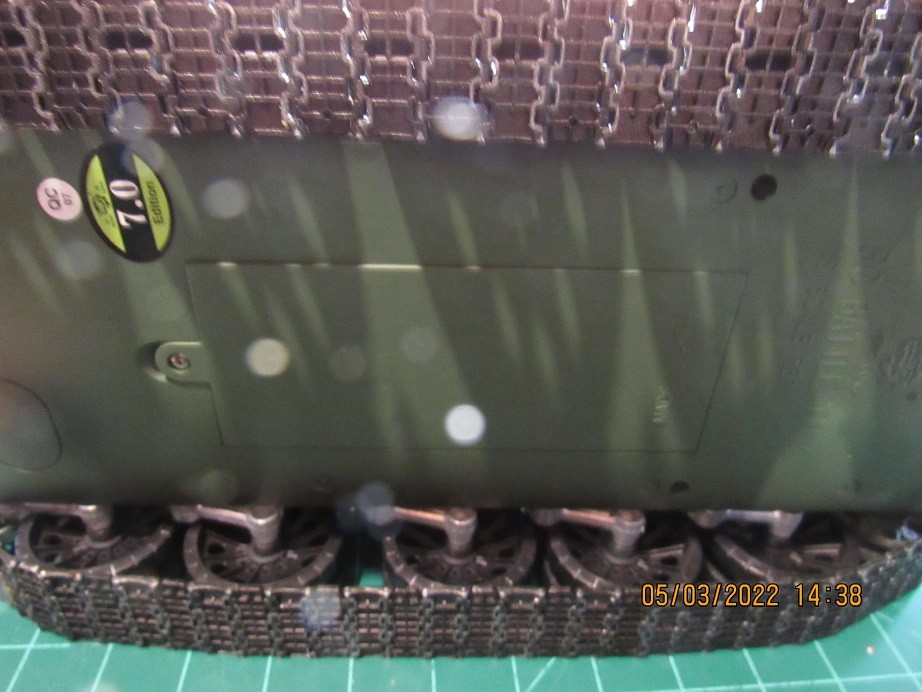

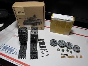

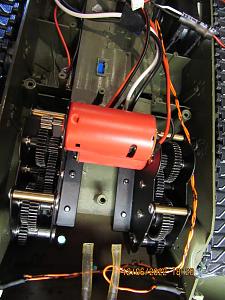

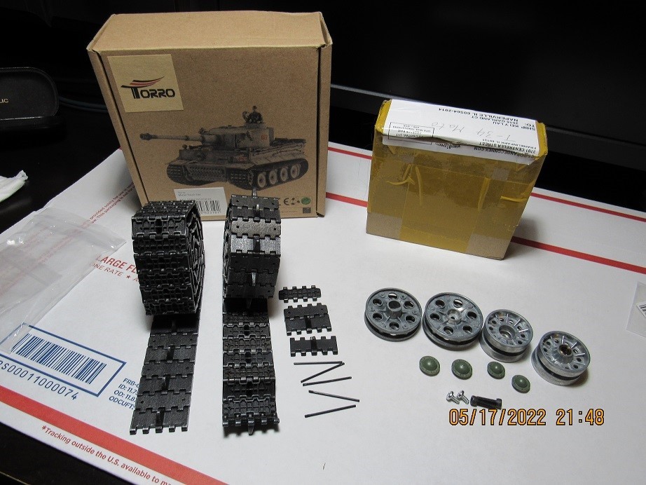

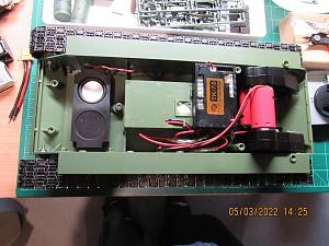

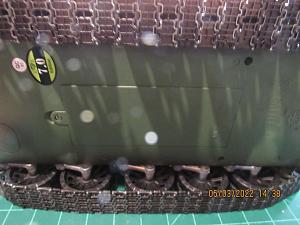

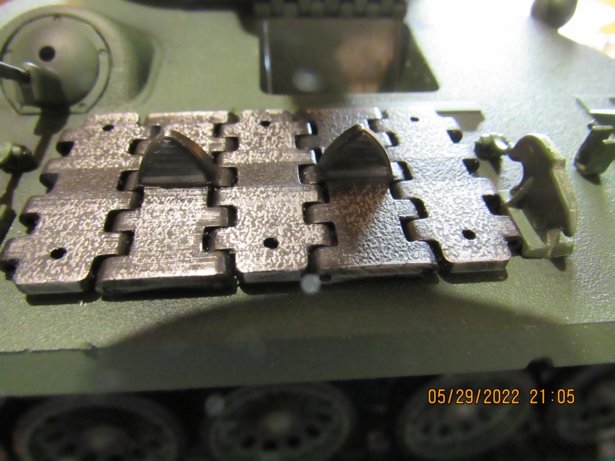

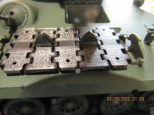

                            I purchased a plastic version of Heng Long T-34/85 with the intension to do my own metal upgrade. While the HL metal version works ok and is robust, but it left a lot to be desired in appearance. For example, the open pin design of the HL metal track looks very bad to me.
                            Click image for larger version  Name:	IMG_5103.jpg Views:	0 Size:	112.0 KB ID:	382892Click image for larger version  Name:	IMG_5104.jpg Views:	0 Size:	120.0 KB ID:	382893

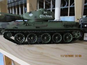

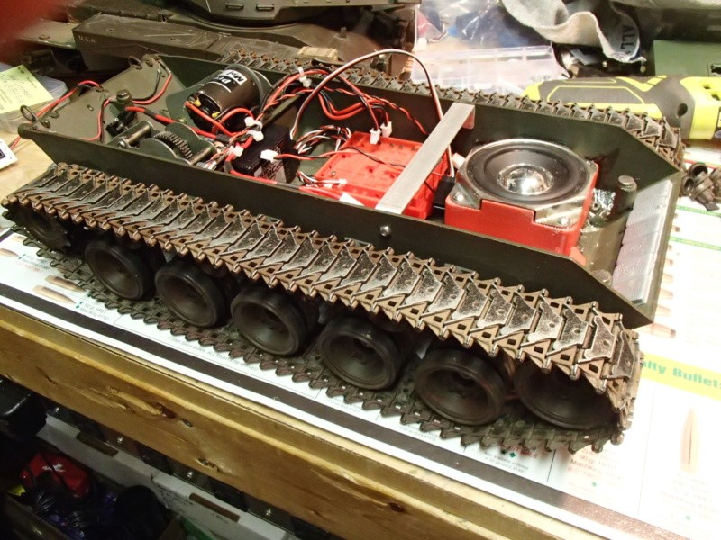

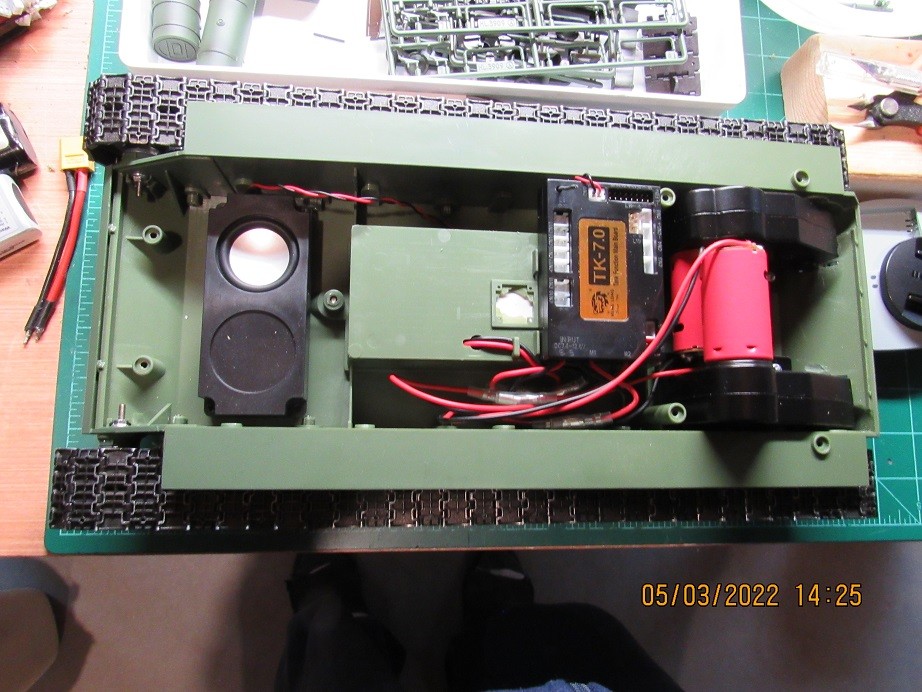

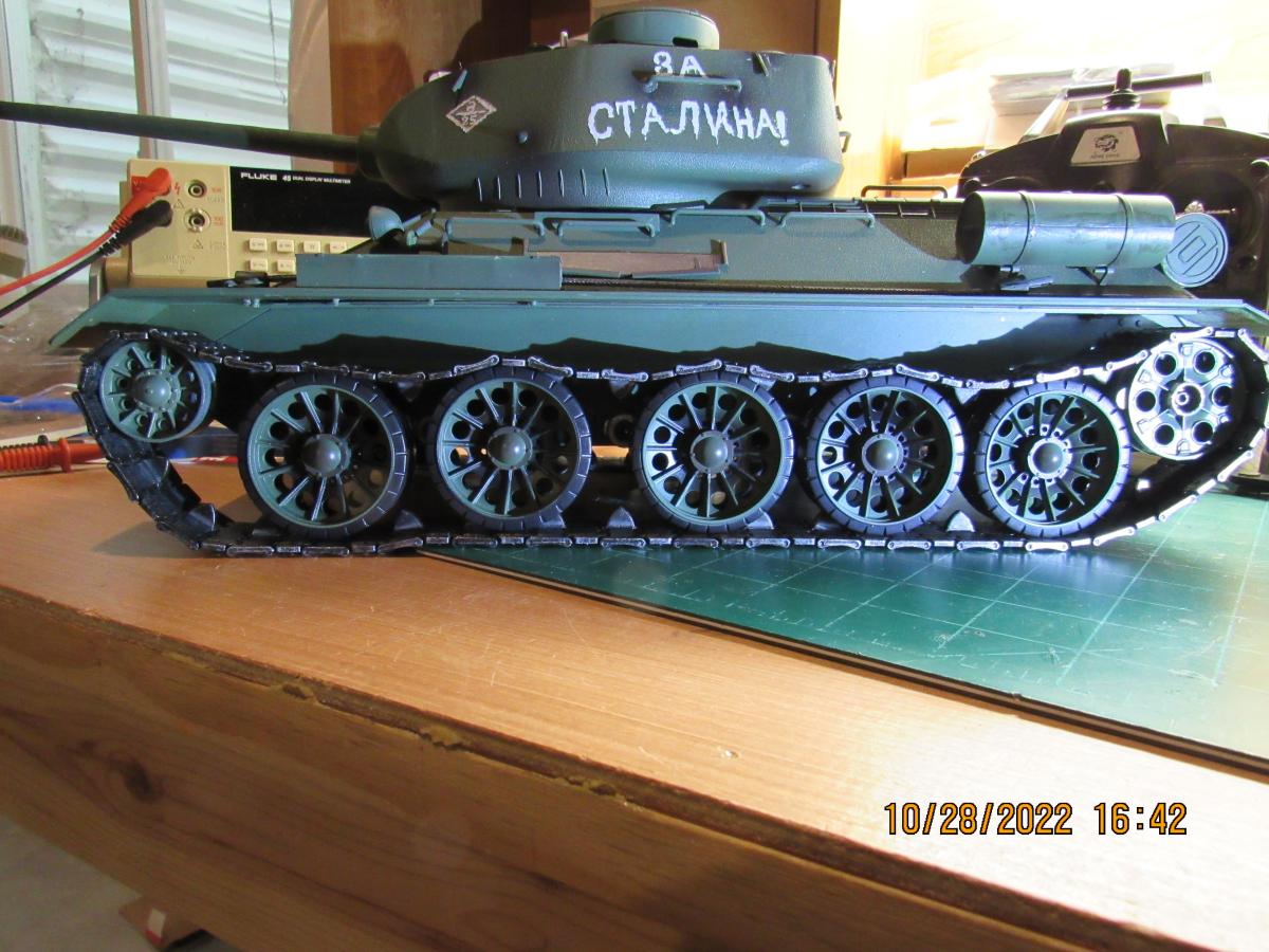

                            The HL T-34 comes with metal swing arms, but weak suspension spring that was designed for the HL plastic track. The word BALANCE means proper and even tension of the track to make it look good and run well on rough ground. My metal upgrade include Heng Xin gearbox, 390 motor, Torro metal track and Mato sprocket and idler.
                            Click image for larger version  Name:	IMG_5096.jpg Views:	0 Size:	173.4 KB ID:	382895Click image for larger version  Name:	IMG_5100a.jpg Views:	0 Size:	154.6 KB ID:	382897Click image for larger version  Name:	IMG_5098.jpg Views:	0 Size:	149.7 KB ID:	382896Click image for larger version  Name:	IMG_5099.jpg Views:	0 Size:	164.7 KB ID:	382894

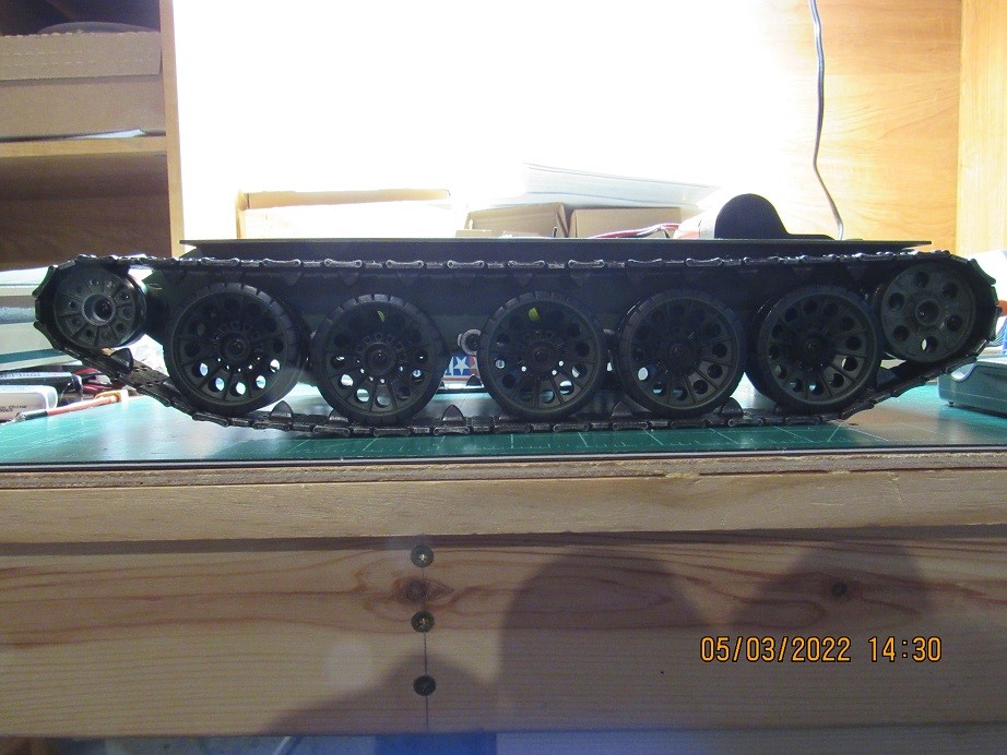

                            The Torro metal track is slightly shorter than the HL plastic track. As a result, it pulls up the first and last road wheel off the ground. I added 2 pieces of track and it turns out to be too long with too much shacking.
                            Click image for larger version  Name:	IMG_5110.jpg Views:	0 Size:	151.8 KB ID:	382898
                            I removed the extra links and went back to the original Torro length. Then the weight balance I described earlier. The T-34 looks ok and runs well. I still have to fine tune the track tension.
