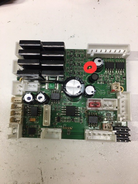

                    Finally heard back from Clark They said to check the voltage at the red mark and let them know what I got. I got 0. I also didn't get any connectivity across the capacitor next to it when I checked the Ohms. Click image for larger version
Name:	Clark TK40-S top- voltage check point.jpg
ID:	383278 Perhaps I should check some other way. I didn't have the motors plugged into the board, I will try again today.

                      Stanlley is selling Clark again, but I don't think he deals with any of the warranty stuff. A TK40SP I got from him finally gave up after 3 years, the amp blew. I sent it back to Clark and he fixed it for free, the whole process took about 2 months though. The TK50 is the way to go these days, much more robust amplifier. I still run some 40's in things I don't use much and I still run some TK60's.

                        Clark has my board now. They are repairing it. I know it will take time. The weird thing is that board never really worked good in the first place. All my TK 50 s like you alluded to work fine. TK 50 and above are the way to go.

                                I want to thank Clark and Stian for getting my board repaired and helping me get my tank back up and running. All is good now. I chose to upgrade to a TK50 instead of getting my TK 40 back which had always had problems. Do yourself a favor and never buy any Clark board other then the TK50 and above. The 22 and 40 are old tech. I am really happy with my TK 50 boards. I now bought a sound programmer to change tank noise as well. I haven't used it but the new board came with a different Panzer III sound that gets rid of most of the squeaks and has some minor backfire noise or muffler pops. Sounds cool.
