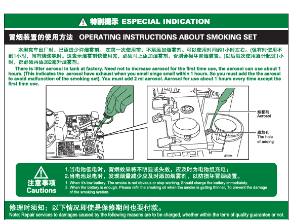

    We just got a heng long Tiger1 and no manual in the box, found one online but didnt say were to put in the smoke fluid, we took out the screws and removed the top found the smoke pump but still no opening to put in the fluid, all thee is a small hole in the battery box that lines up with the smoke unit, surely thats not it?

    From Heng Long Tiger I manual.....​

        click on the "support" tab, there you'll find the downloadable manuals that pertain to this item. Have a great day!
