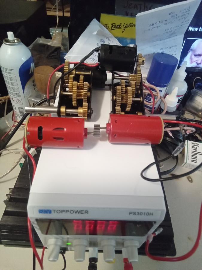

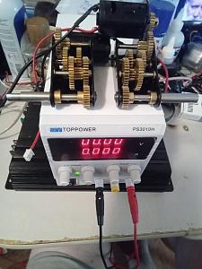

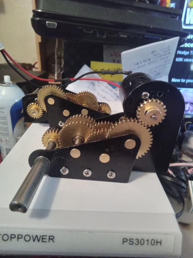

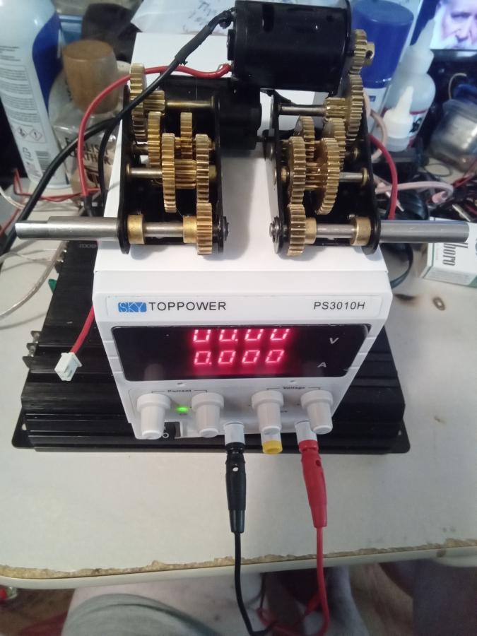

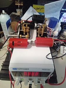

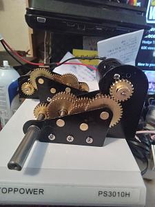

                    In case some of you have never seen these or heard of them before these are walterson's Transmissions supposed to have heavy duty magnets and windings in the motors and they're all brass gears anyhow I'm going to try and put these hen long red motors on them ought to be interesting. Click image for larger version

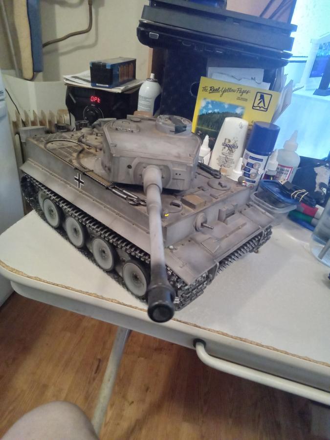

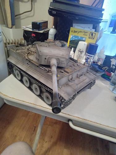

                      Oh and I'm going to try them out in this full metal henlong tiger one. Click image for larger version

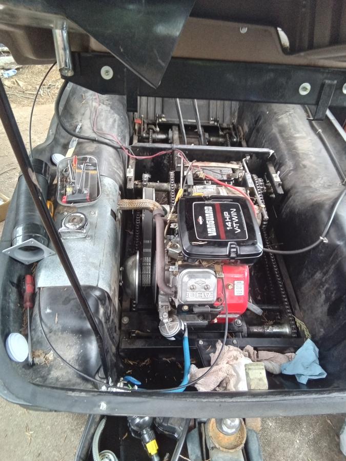

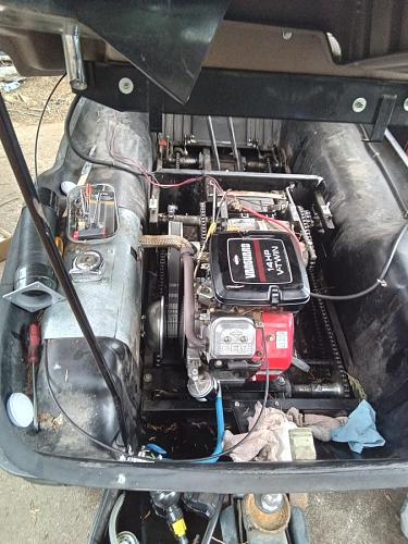

                        Just for fun can anybody tell me what this drivetrain is? Click image for larger version

                          Centrifugal pulley drive-belt system. (ATV?)

                              Aatv?

                                Looks like an Argo interior?

                                  In case some of you have never seen these or heard of them before these are walterson's Transmissions supposed to have heavy duty magnets and windings in the motors and they're all brass gears anyhow I'm going to try and put these hen long red motors on them ought to be interesting. Click image for larger version  Name:	20230824_125430.jpg Views:	0 Size:	61.1 KB ID:	384947 Click image for larger version  Name:	20230824_125118.jpg Views:	0 Size:	71.3 KB ID:	384948 Click image for larger version  Name:	20230824_125250.jpg Views:	0 Size:	73.2 KB ID:	384949
                                  Are the waltson motor 540 motors? What motivates you change them to HL red390 motors? The Red390 is a good upgrade from HL Grey380, but will be a step down from 540. The waltson motor has much larger drive gear than the HL 380/390 series. The red 390 does not look like a dropin replacement.
                                  I use 3 pairs of the HL Red390 and one pair MaxFan390. The internal fan and axial ball bearings keep them running much more stable, quieter and cooler than the HL grey380. All 4 pairs of 390 have consistent performance on the bench. However, some forum members reported melt down (physically) of their Red390. They never identified the source of the problem. I suspect that those may be low quality imitator of the HL Red390, but I cannot rule out completely a quality control issue by HL.
                                  After I install the 390 motors on my tank, I run the motor at full speed. The motor case temperature stablize in about 10 minutes and does not exceed 20 degrees F above ambient. Then, I know for sure I get a good motor.

                                    Looks like the Wathersons have the black 380s, not 540/550s.
                                      If so, the internally fan cooled Red390 will be a good move.
                                      In the picture, the black motors seem to have a larger diameter than the Red390. A measurement of the OD of the Walterson motor case can easily clarify that. The large motor drive gear also makes me suspect the Walterson motor were low rpm motors.

                                        The waltersen's motors on these transmission kits are 380, and yes you are right they are low RPM. I'm disabled and on days when I'm not out messing around with things like those 6x6s I can sit around and mess around with different things like this I really don't know if those red Motors are going to work or not what's real nice is the waltersens comes with the tool kit that has pulley pullers on it and stuff I don't know if they'll work or not I was just going to give it a shot just for the heck of it this is an old set of Transmissions and they're kind of noisy. As far as breaking on the red Motors that power source that they're sitting on top of by the way that makes those red Motors look really big it's just cuz they're forward of the Boston's Transmissions when I took that picture, I break them in and water real slowly and then I'll bring the RPMs up and down and put them in reverse and do them equally that way and but I've always broke my brush motors in in water. Then I clean them out with electrical contact cleaner then WD-40 to get any water out of it and then a dielectric silicone spray for the bearings. It's just one of those things I'm playing around with, and all the input I get from you guys helps also cuz you guys have been doing this a lot longer than I have been!
