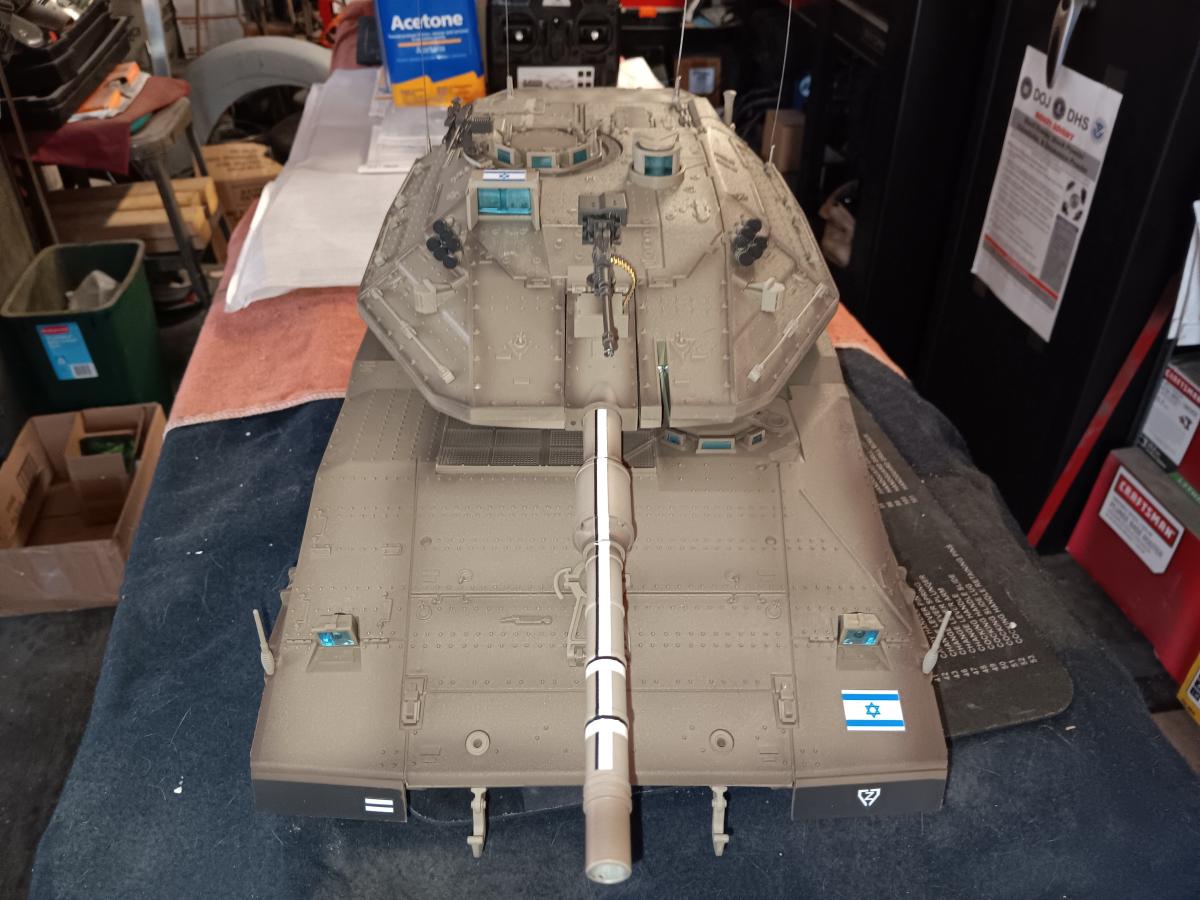

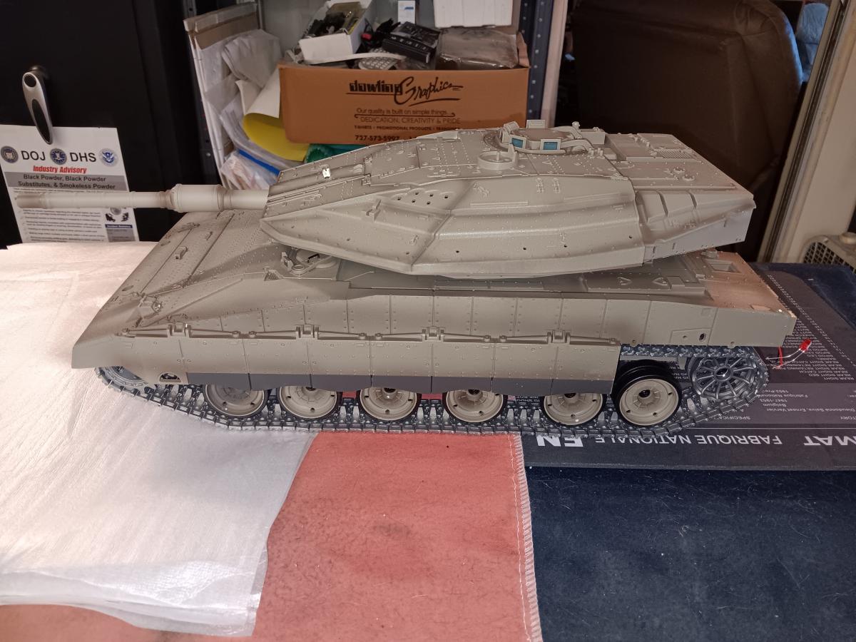

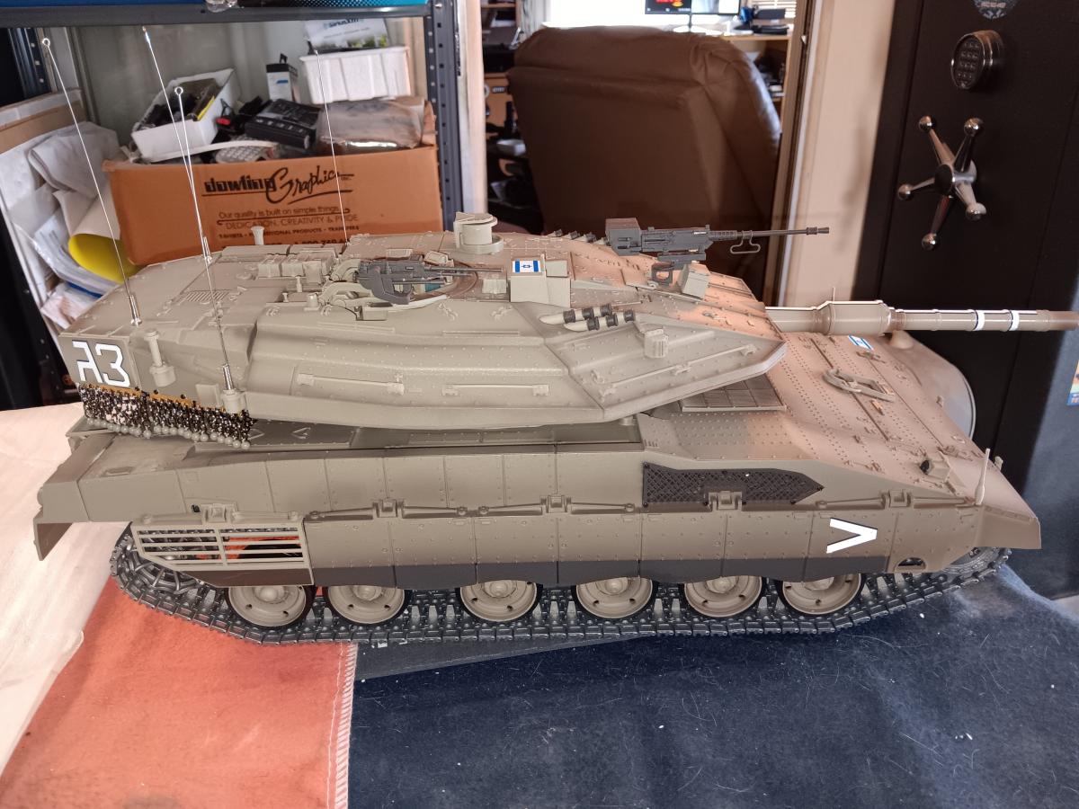

                                It arrived yesterday and I unboxed it this morning. WOW!, This has the largest turret I've seen in all the HL 1/16 RC tanks. Be aware that the instructions don't show the little latch you need to move to remove the battery hatch (In photo painted red). The turret motor/gear assembly is the smoothest of all the HL tanks. It doesn't make a bunch of clicking noises like the other do by the gear skipping on the turret gear ring. Which is nice because the turret needs to be moved to a 90 degree location to access both the power switch under the driver's hatch and to remove the battery cover. Will start today to install the add-on parts.
                                ​​​​ Click image for larger version
ID:	392024 Click image for larger version
ID:	392025 Click image for larger version
ID:	392026 Click image for larger version

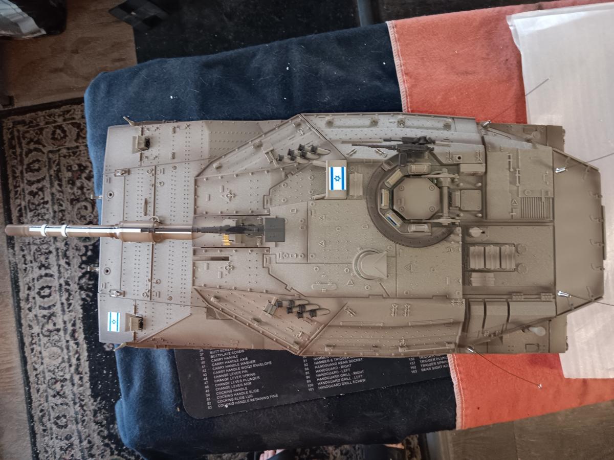

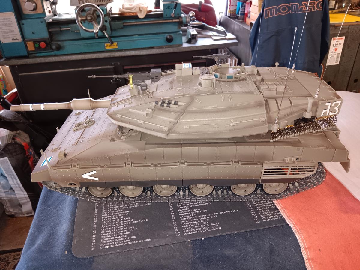

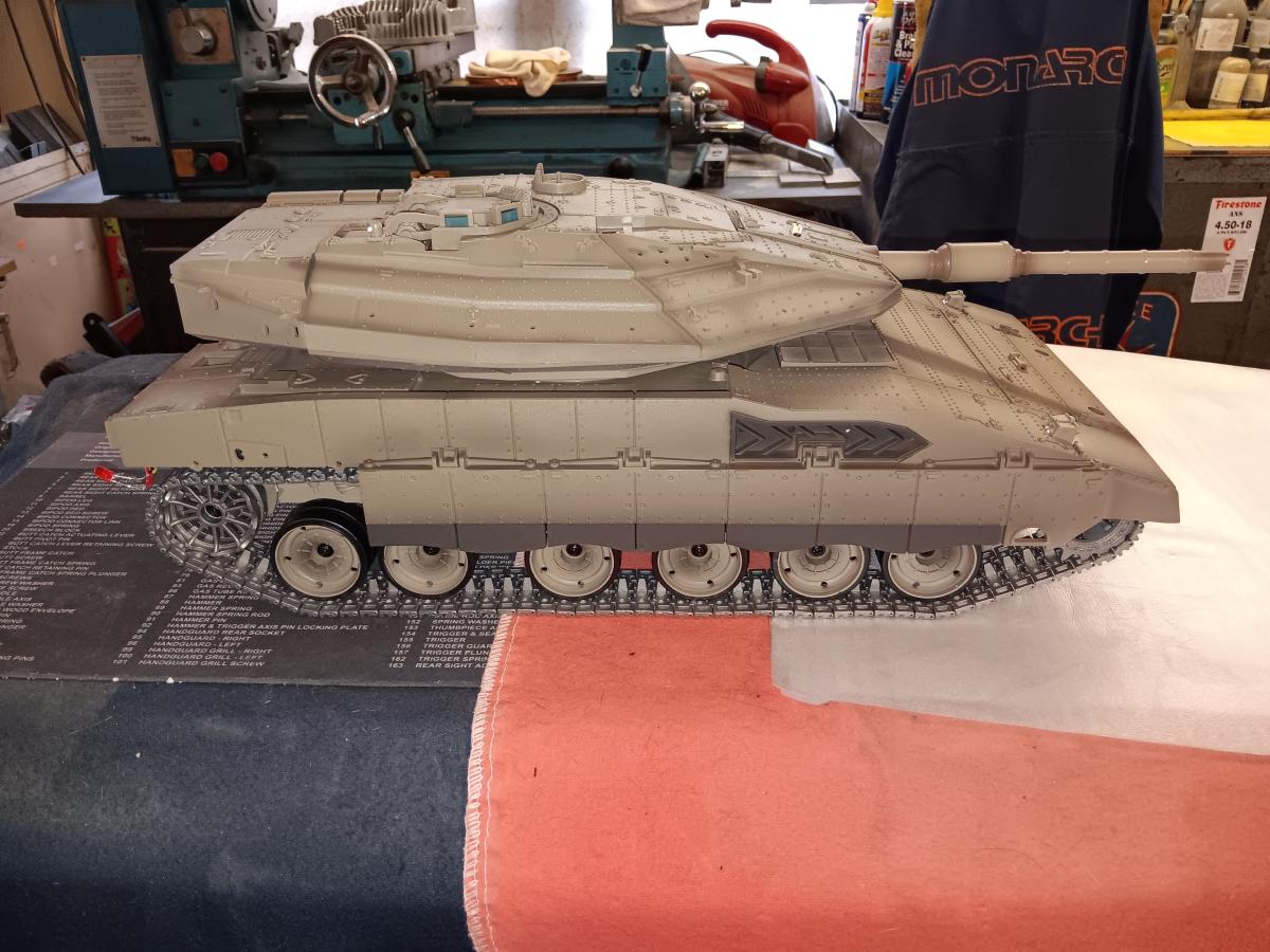

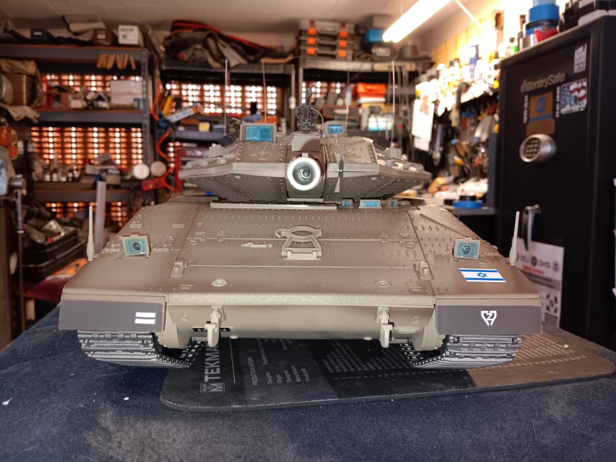

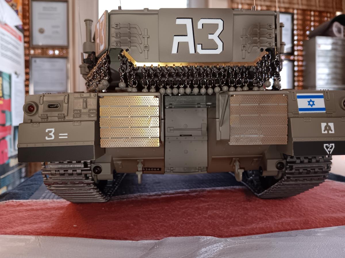

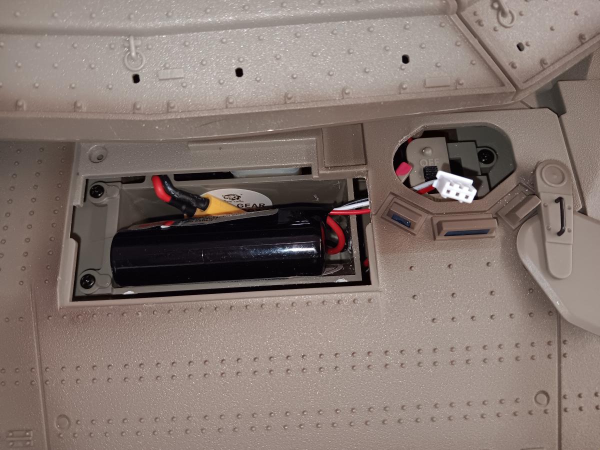

                                  Okay, I've got it done to the point where it's ready to put in the field. There was one appendant part missing and I also want to install the optional machine gun w/flash in place of the non-functional machine gun above the barrel. Contacted Toucan about the missing part and getting the flashing machine gun. They replied back very quickly and those parts are on the way to me. Great customer service from Toucan!
                                  ​​​​​​ Click image for larger version
ID:	392091 Click image for larger version
ID:	392092 Click image for larger version
ID:	392093 Click image for larger version
ID:	392094 Click image for larger version
ID:	392095 Click image for larger version

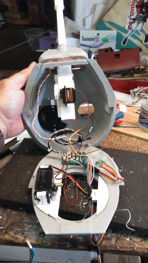

                                          PART 3: Turret mechanical rework has begun.
                                          Since I am upgrading the Merkava to a 7.1 system I decided to ad in a servo recoil system. I am using a JVM3Dconcepts servo recoil system (available through RichJohnson who can be reached via a PM on this site) but will be maintaining the HL stock elevation system for now.
