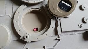

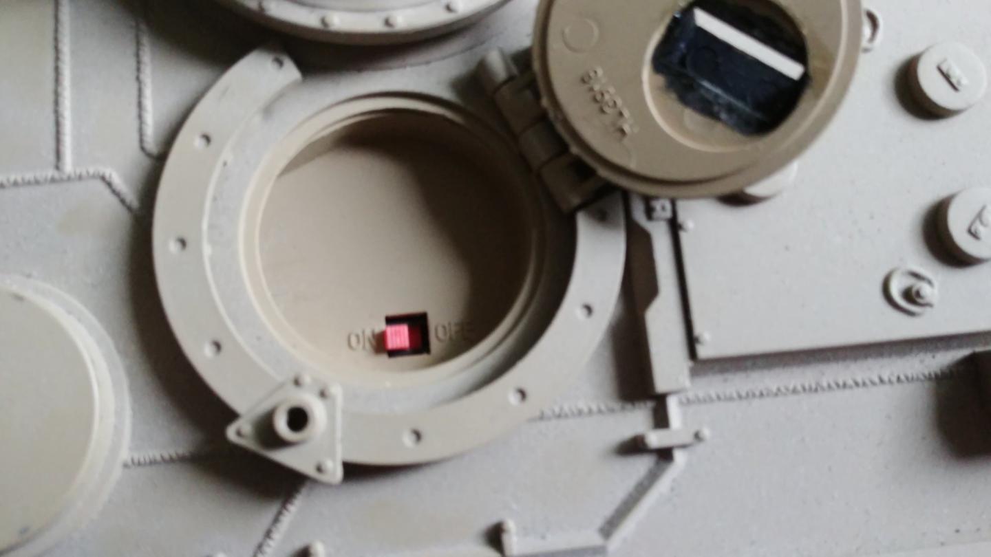

          If you look into the hatch that you are supposed to pour BB's into, does it have an on/off switch present? If not, it maybe an IR/Recoil only version?
            From HL MFU 6.0 and above, the BB shooting on-off is controlled by software. You will not find any switch near the BB input port.
