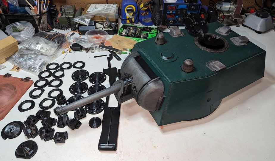

        Further work on the turret. The entire turret ring has been printed and assembled, some of the turret details installed, a base coat has been applied to some of it, the recoil/elevation has been installed, and the barrel/mantlet printed/installed. I know the color is wrong, but it's what I had on hand in a spray can. I will adjust it with my airbrush when the build is ready for final paint.
        The commander's hatch is opens and rotates. The periscopes both rotate. Still need to print and install the rain shield over the gun.

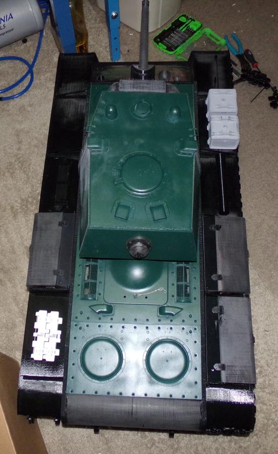

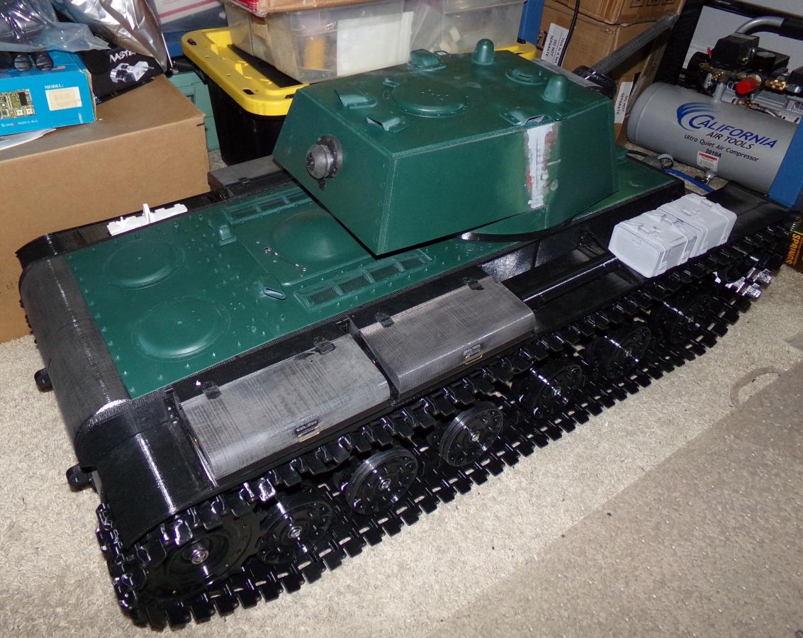

                  Got a bit more printing done and a bit more assembly. I still have over a week of printing tracks before I will have a full set, but they are looking good. Need to source some pins though. Right now they are just friction fit.
                  Finished up assembly of the sprocket mud scrapers, assembled the bore cleaning kit, got the saw assembled (minus the metal latches), assembled the horn, and got the turnbuckle hardware sorted.
                  Got the track fenders printed and mocked up. I also mounted the tool boxes (minus the covers). The fenders and boxes are not permanently installed at this point. I just wanted to do a test fit. I got the driver's hatch detailed and functional. I also got the engine hatches detailed and functional. The driver's hatch and the engine hatches weren't designed to work so I took parts from the KV-2 turret, cut them in the slicer, and added them to the engine hatches. I then printed the KV-2 hatch assembly and installed it on the KV-1. The KV-1 turret hatch couldn't be used for the driver's hatch or the engine hatches as it has the machine gun mount arms on it.

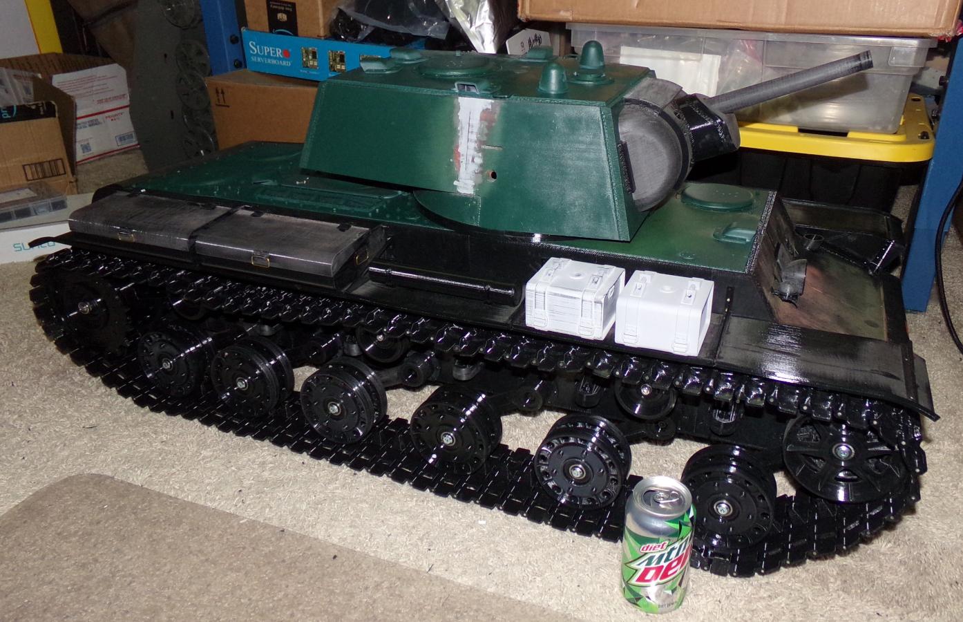

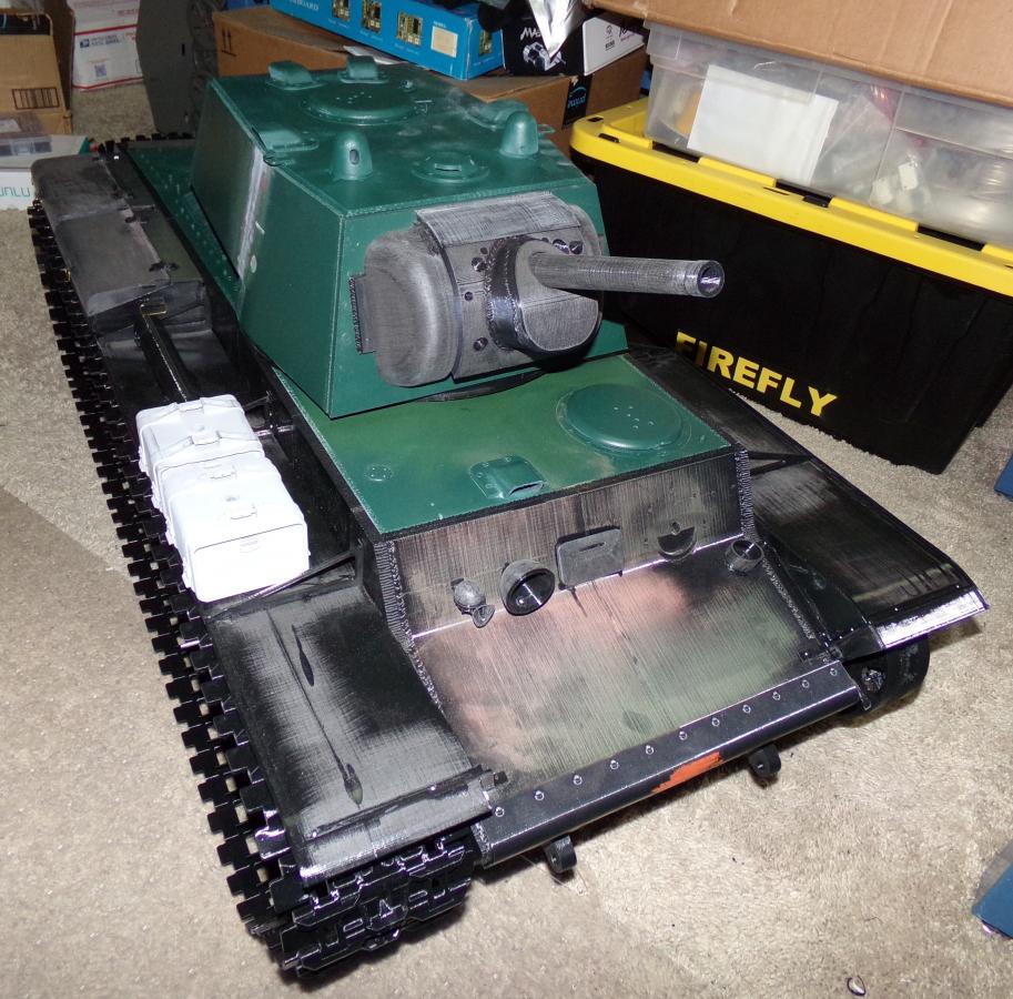

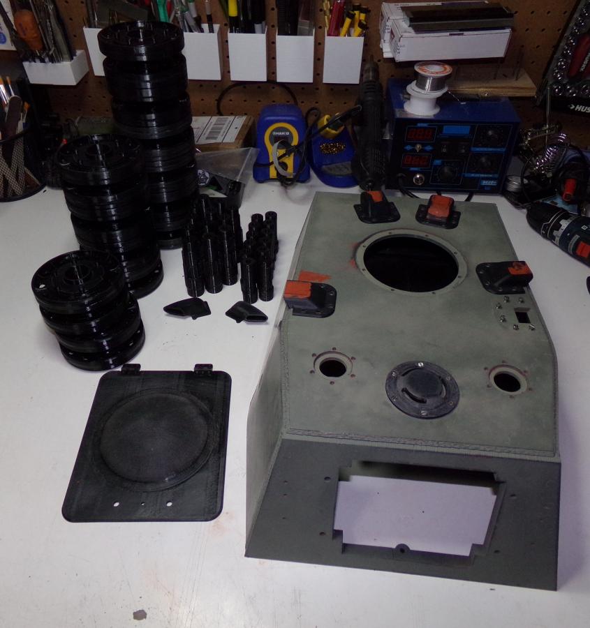

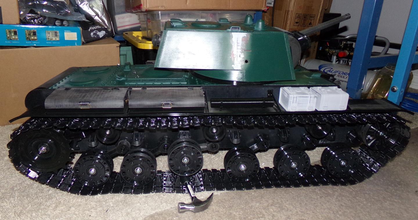

                      Lots of work since the last update to this. Still need to install the motors and electronics and lots of body work to do. All the printing with the exception of some clear parts is complete. I might be time to move it to the garage to finish the rest of the work...
