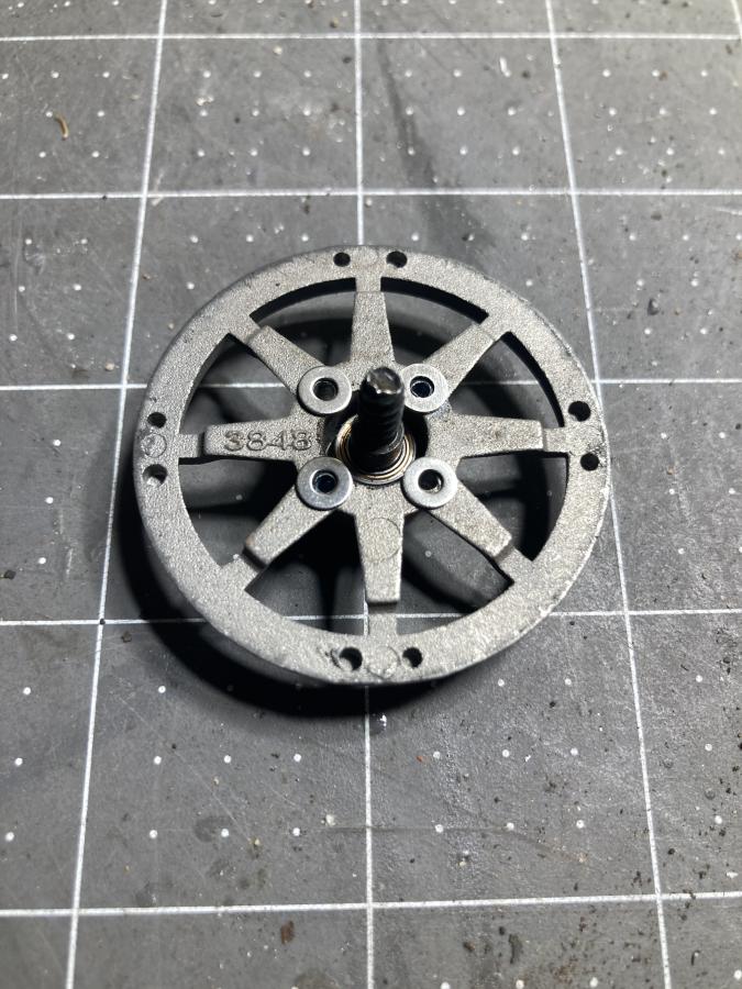

    Don't know if this was done and posted before; here is how I approach the de-tracking problem on my Panzer III and Stug III. I put these 4 washers between the 2 piece idlers to widen the space for the teeth of the track to slide through better. Hope this helps :-)

    Normally the de-tracking issue is due to the idler wheel axis leaning in towards the front of the tank. Or when you turn hard enough that the track guide teeth start to hit on the edge of the idler wheel and climb up and out.
    Tracks always put tension on the drive sprocket and the idler, even when sitting still. The mass of the tracks and tension applied by the suspension pulls both towards each other.
    The problem usually occurs with plastic hull tanks over time. The screw holding the idler gets loose, or the idler mount at the hull cracks/flexes causing the idler to lean forwards.
    Track tension systems (Henntec, or others), replace the older idler mounts with more rigid versions and in some cases install a torque bar between the left and right sides helping to reduce flex on the hull mounts that the idler in installed on.
    For the Panzer III & Stug III, there is an aftermarket idler adjuster available that is meant for non-threaded idler mounting axles.
    Mato 1:16 Panzer III / Stug III Tank Metal Track Tensioners - Welcome to Mato Toys (matotanks.com)
    I actually think that adding more space between the inner edges of the idler will make it worse for throwing tracks. But I would love to be proved wrong. (I have not put anything into my PZ III or my Stug III yet...)
