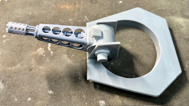

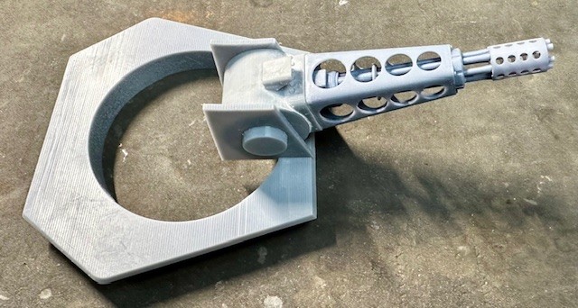

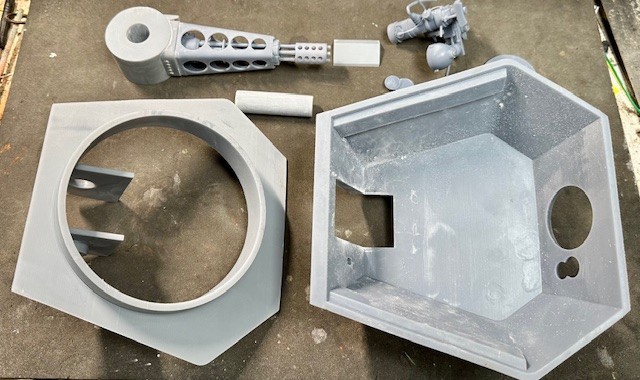

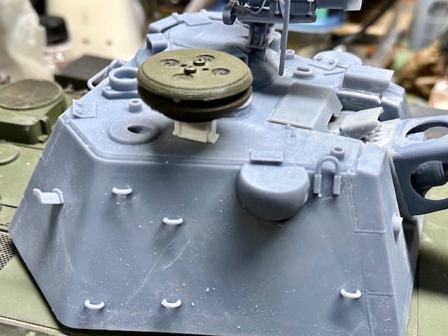

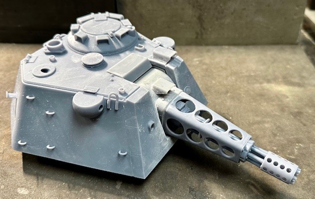

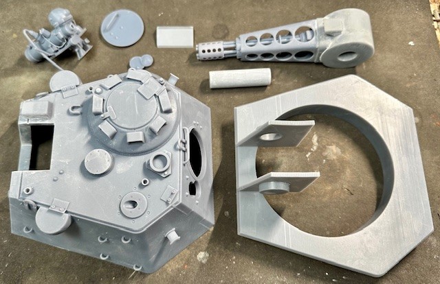

                Here are the parts; turret top, turret base, gun barrel and rotation drum, rotation pin, night vision module, two hatches and a mantlet cover.

                  • 2736

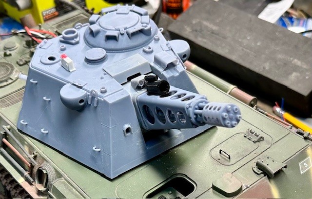

                  The first task is to sand and grind the rotation drum, pin and mounts on the turret base to get a smooth movement. This took a couple of hours. As mentioned before, this was not designed to be operational. Variations in actual material were not taken into account, hence the need for my fitting work.
                  Click image for larger version  Name:	Panther Gatling Build 11.jpg Views:	0 Size:	77.7 KB ID:	390801
                  Click image for larger version  Name:	Panther Gatling Build 12.jpg Views:	0 Size:	71.3 KB ID:	390802

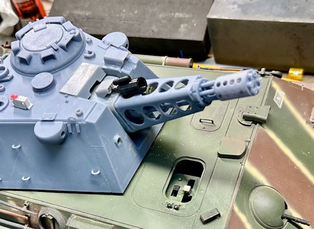

                  Two teasers again, showing the potential range of elevation:
                  Click image for larger version  Name:	Panther Gatling Build 14.jpg Views:	0 Size:	64.2 KB ID:	390804 Click image for larger version  Name:	Panther Gatling Build 13.jpg Views:	0 Size:	74.8 KB ID:	390805

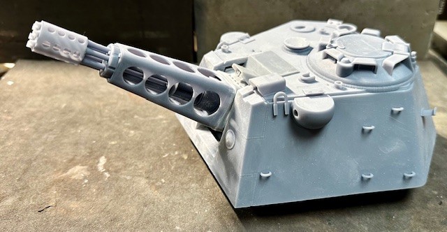

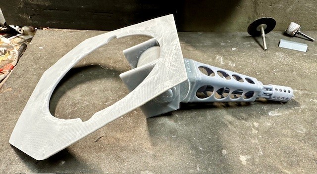

                    • 2736

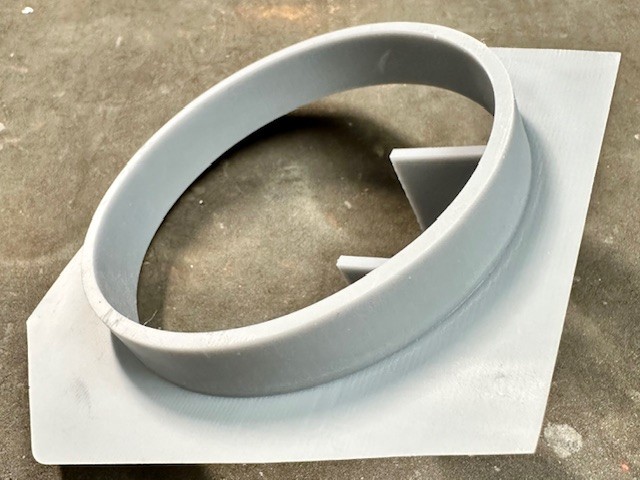

                    Biggest modification. This is the critical milestone, had to be done before anything else. The underside of the turret base had this ring which was too big for the well in my tank so it had to be removed.
                    Click image for larger version  Name:	Panther Gatling Build 07.jpg Views:	0 Size:	72.6 KB ID:	390815
                    I used a Ryobi rotary cutter, essentially a Dremel in steroids. So far I have about 4-5 hours of grinding, sanding and fitting, but the gross segments are done.
                    Click image for larger version  Name:	Panther Gatling Build 15.jpg Views:	0 Size:	84.0 KB ID:	390814

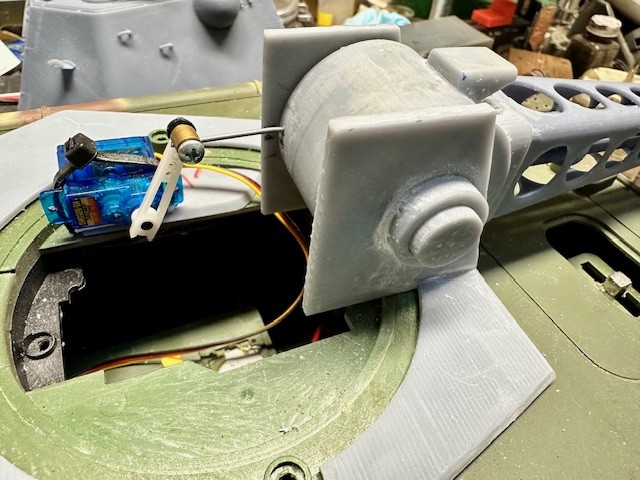

                              • 2736

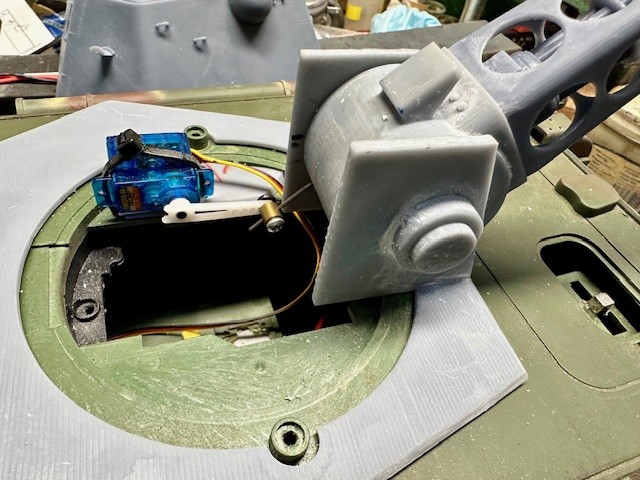

                              Progress last night. Motor actuated elevation wasn't feasible, so I grabbed an old HL 6.1S and made a linkage. The advantage is a high angle of elevation. Useless for IR battles, but cool nevertheless.
Name:	Panther Gatling Build 19.jpg
Name:	Panther Gatling Build 18.jpg
                              The turret base plate is glued onto a Sherman base, to facilitate rotation via ring gear.

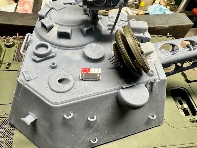

                                One more step. I mounted Tang's five pin socket & cable product for the LegoDEI IR receiver. When painted, it'll bled into all the other protrusions.

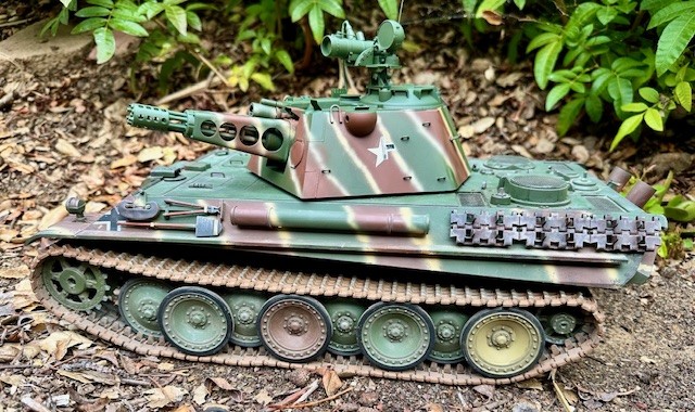

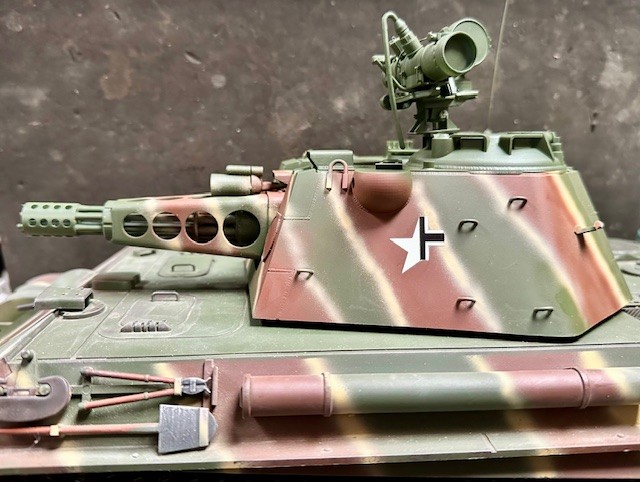

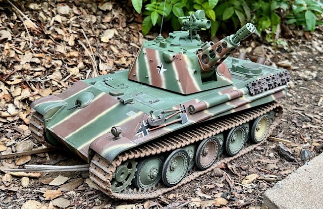

                                      1946...
                                      The Panther is 90% done, needs weathering and some detailing. Here's how it looks now.
                                      So, what's that marking on the turret? Well, after a stinging defeat in the winter of 1944 and a successful assassination and coup, the German Army capitulated on the Western Front. However, the Soviets on the Eastern Front continued their assault, moving past Berlin into what was then Western Germany. By 1946 it was apparent the USSR planned to overrun all of Europe. It was evident reconstructing Germany and the other European countries were in no condition to resist. Pragmatically, the Allies began to unify, using war material from all sources. As the USSR's air assets were heavy in ground support with limited high altitude bombers, low level anti aircraft weapons were deemed effective. 20mm Gatling guns were mounted on existing chassis, in this case the Panther G.
                                      Or at least that's my story!
                                      Click image for larger version  Name:	Panther Gatling Build 22.jpg Views:	0 Size:	85.4 KB ID:	391199
                                      Click image for larger version  Name:	Panther Gatling Build 23.jpg Views:	0 Size:	143.3 KB ID:	391200
                                      Click image for larger version  Name:	Panther Gatling Build 24.jpg Views:	0 Size:	125.2 KB ID:	391201

                                        I dig it. I like your backstory and your build is cool and creative. Reminds me of Jnewboys 1946 Panther.
