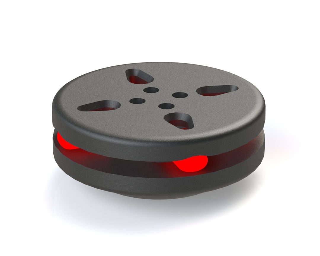

                            • #15
                              You can get either one of these to upgrade the HL IR system. Be sure to research each one carefully.
                              This Electronic Toys item by LegoDEI has 36 favorites from Etsy shoppers. Ships from Los Angeles, CA. Listed on Feb 19, 2024
                              Impact Upgrades are Tamiya OEM supplier for Tamiya metal tracks, gearboxes and more. So it's no surprise that Impact has this IR Battle receiver that looks exactly like Tamiya's. Built to Tamiya's exacting standards, over-engineered by the Japanese,
                              P.S. I am waiting for Dean from DGS Promotions to get back to me as he used to sell a really nice HL IR Upgrade kit that I have installed in mt HL RC tanks.
                              I'll post more information about his IR kit once he gets back to me.
                              Here is his website: https://dgsselkirk.wixsite.com/dgsmilitaryhobby
                              Please note you will have to change to a different wire connector on his wire harness to plug into the CN16 on either of the HL TK-7.0/7.1 motherboards.
                              I bought these to make the connector change: https://www.amazon.com/Crimping-AWG2.../dp/B09Q5QN9L2
                              and: https://www.amazon.com/Taiss-Connect.../dp/B0BHT1FQGY
                              • #16
