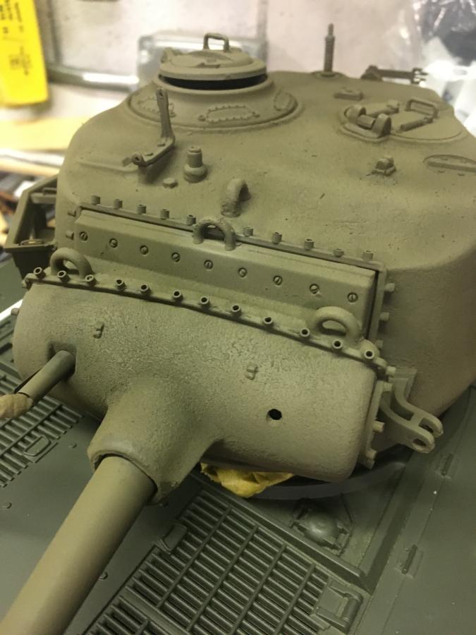

ID:	391934 Here is an example of my Pershing. The tube didn't end up this long in the final product, but it is basically a straw cut to size.

            That's essentially what I ended up doing. I'll make tubes similar to yours out of tubing that fits the IR emitter hole. That's a beautiful paint job.

              Thank you I basically follow this video https://www.youtube.com/watch?v=vmp0QSJ7VeE&t=1022s I spent about $70 on all the paint supplies, but It was very satisfying to finish and I still admire her on the shelf. Like all projects I still need to finish the tarps.
