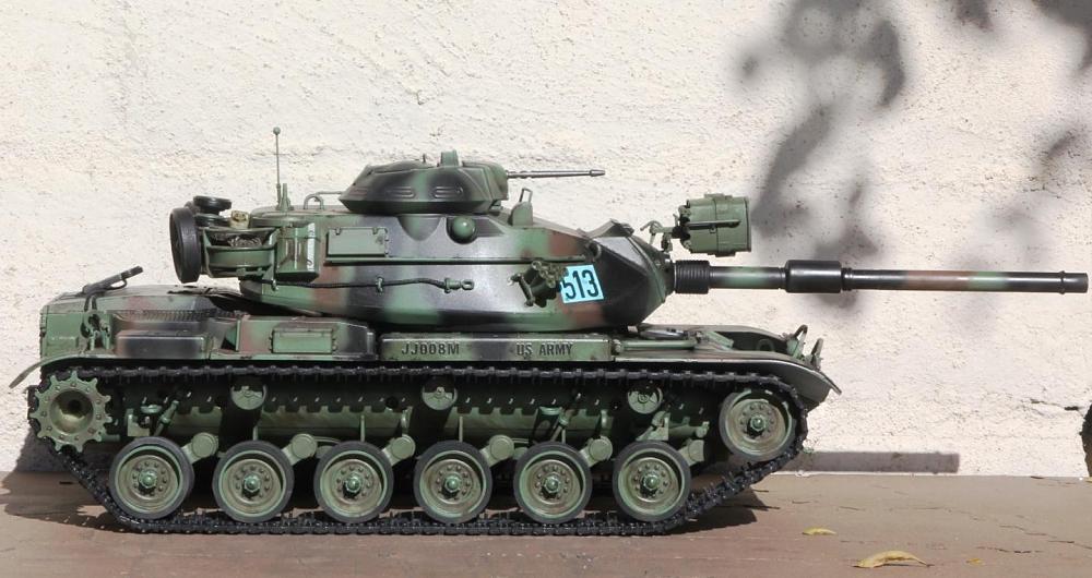

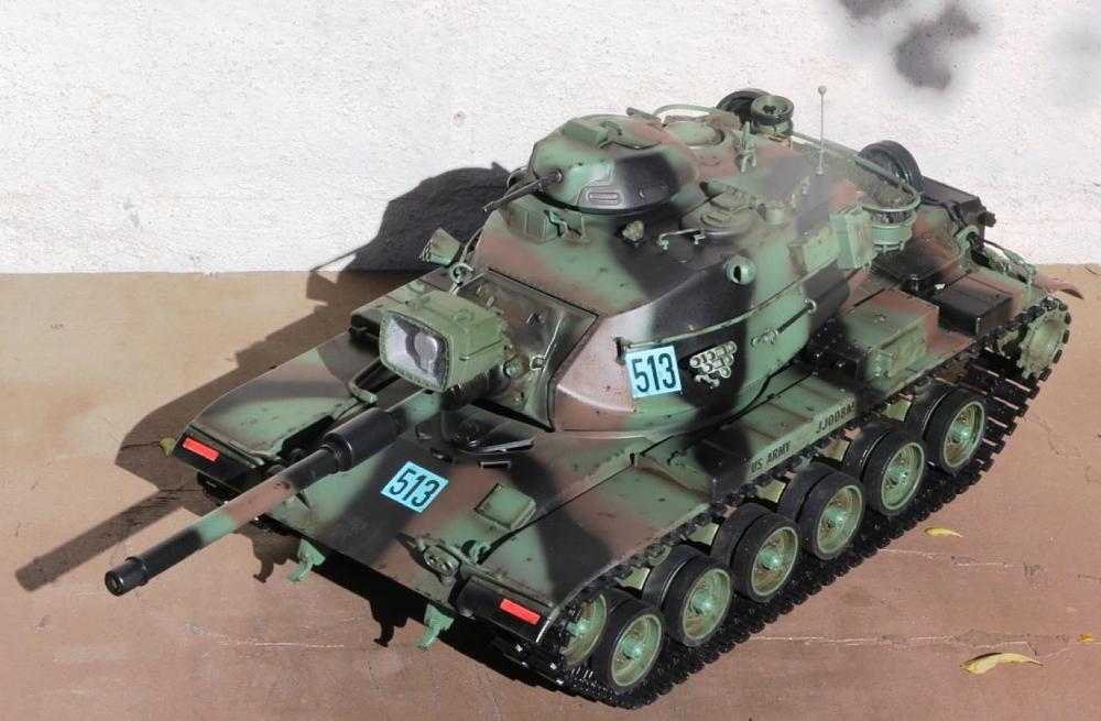

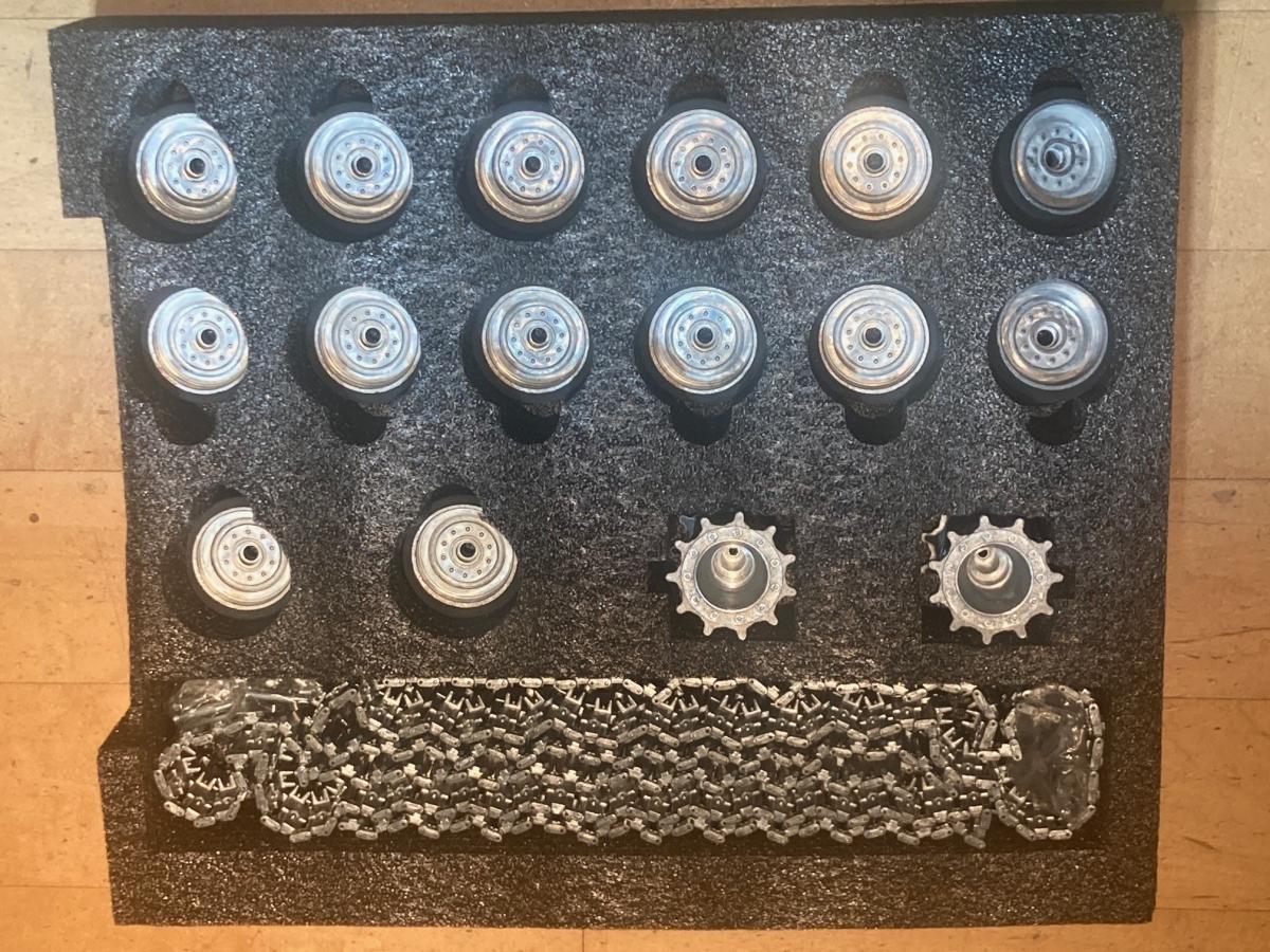

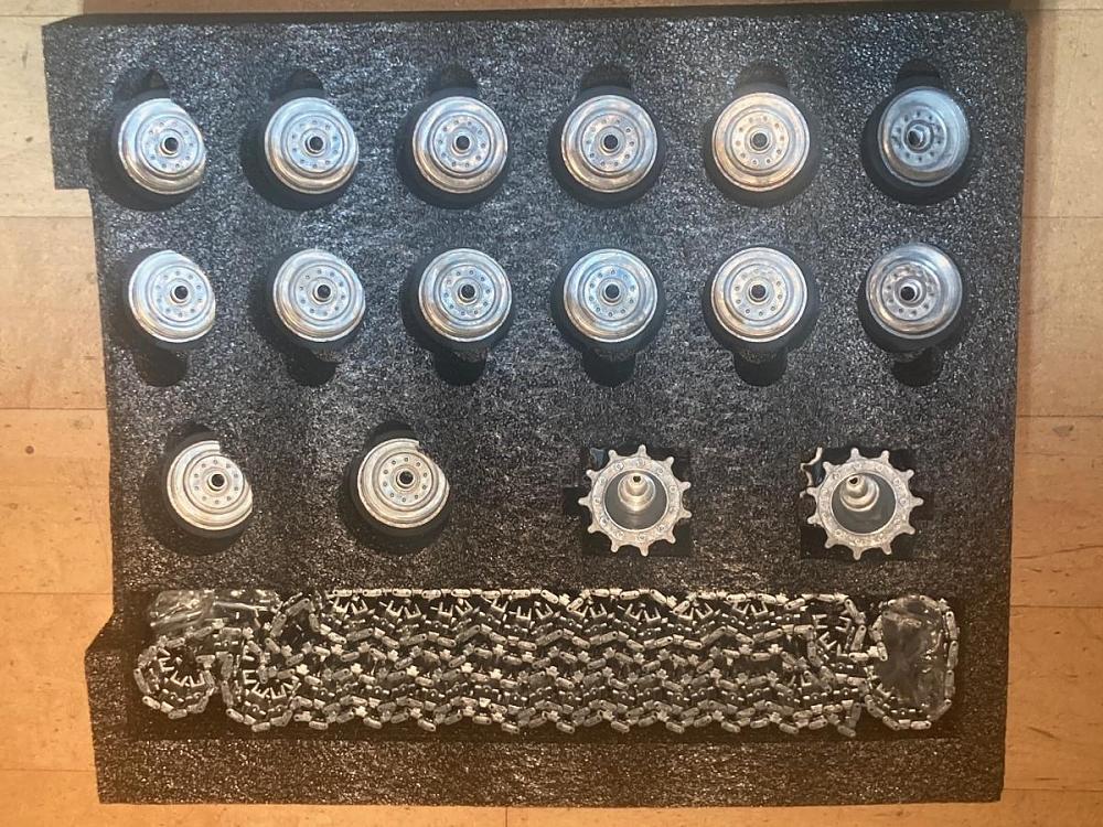

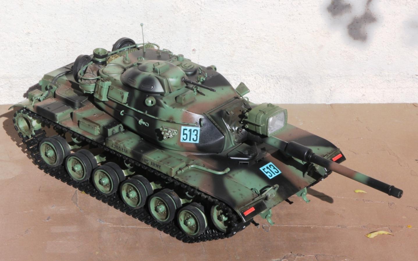

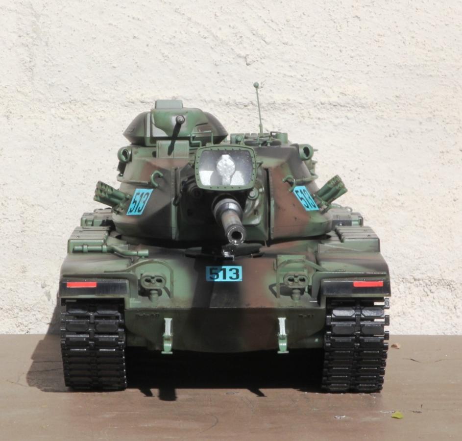

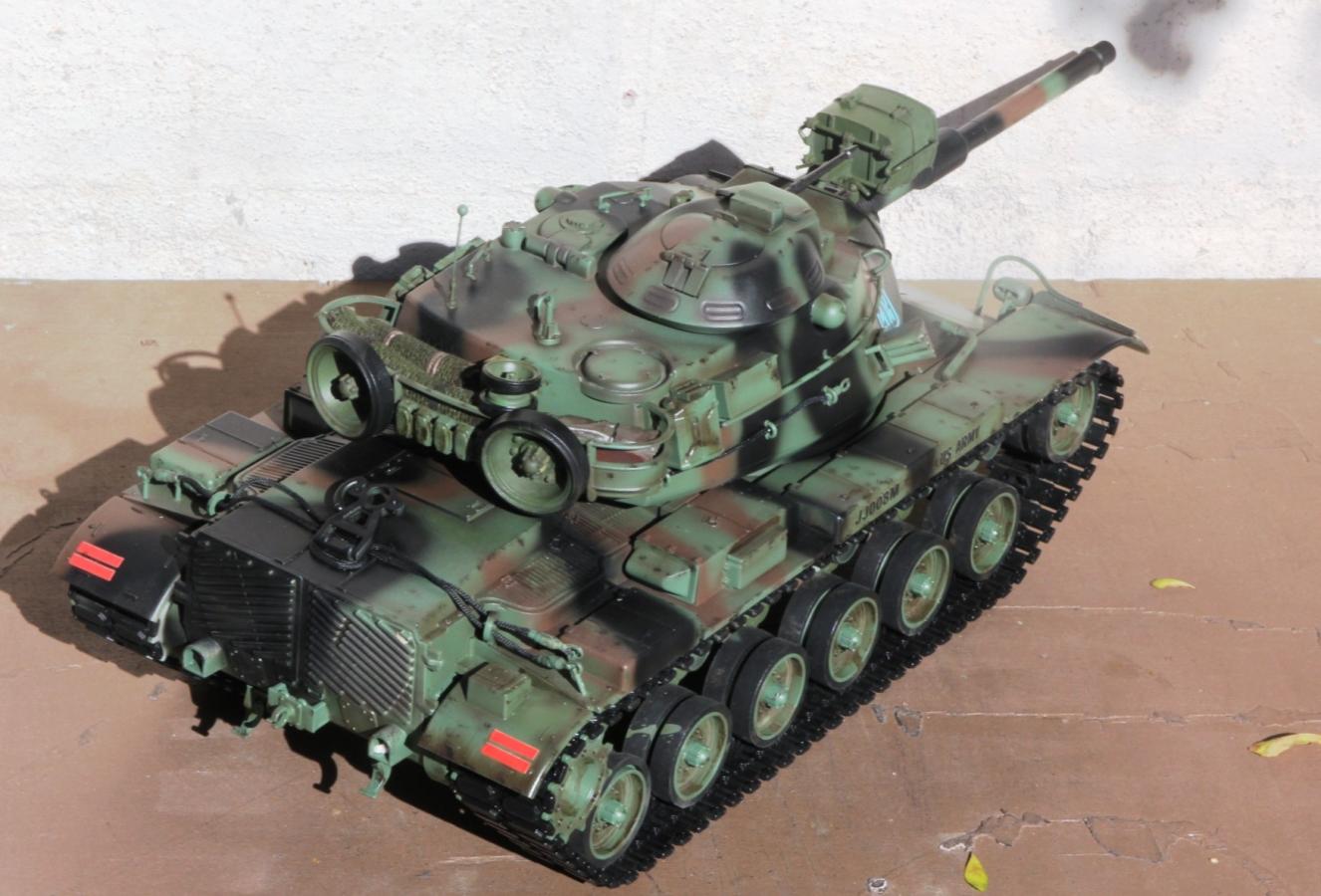

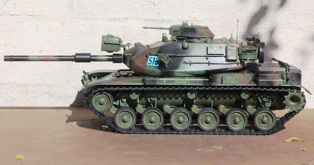

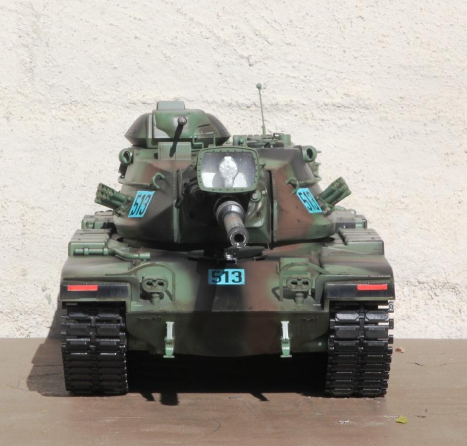

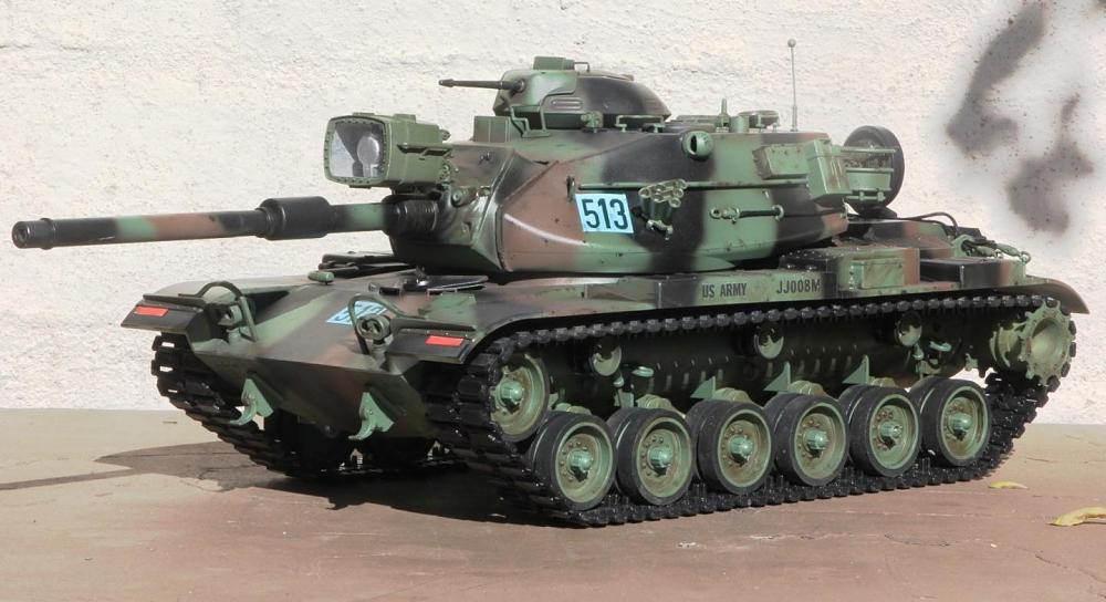

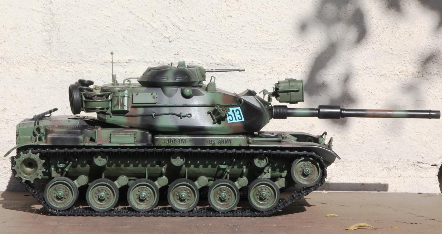

My M60 from TongDe
  • DavidN
    • May 2021
    • 3200
    • Los Angeles, CA
    My M60 from TongDe

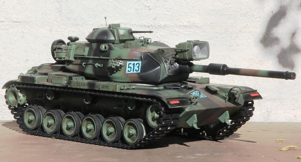

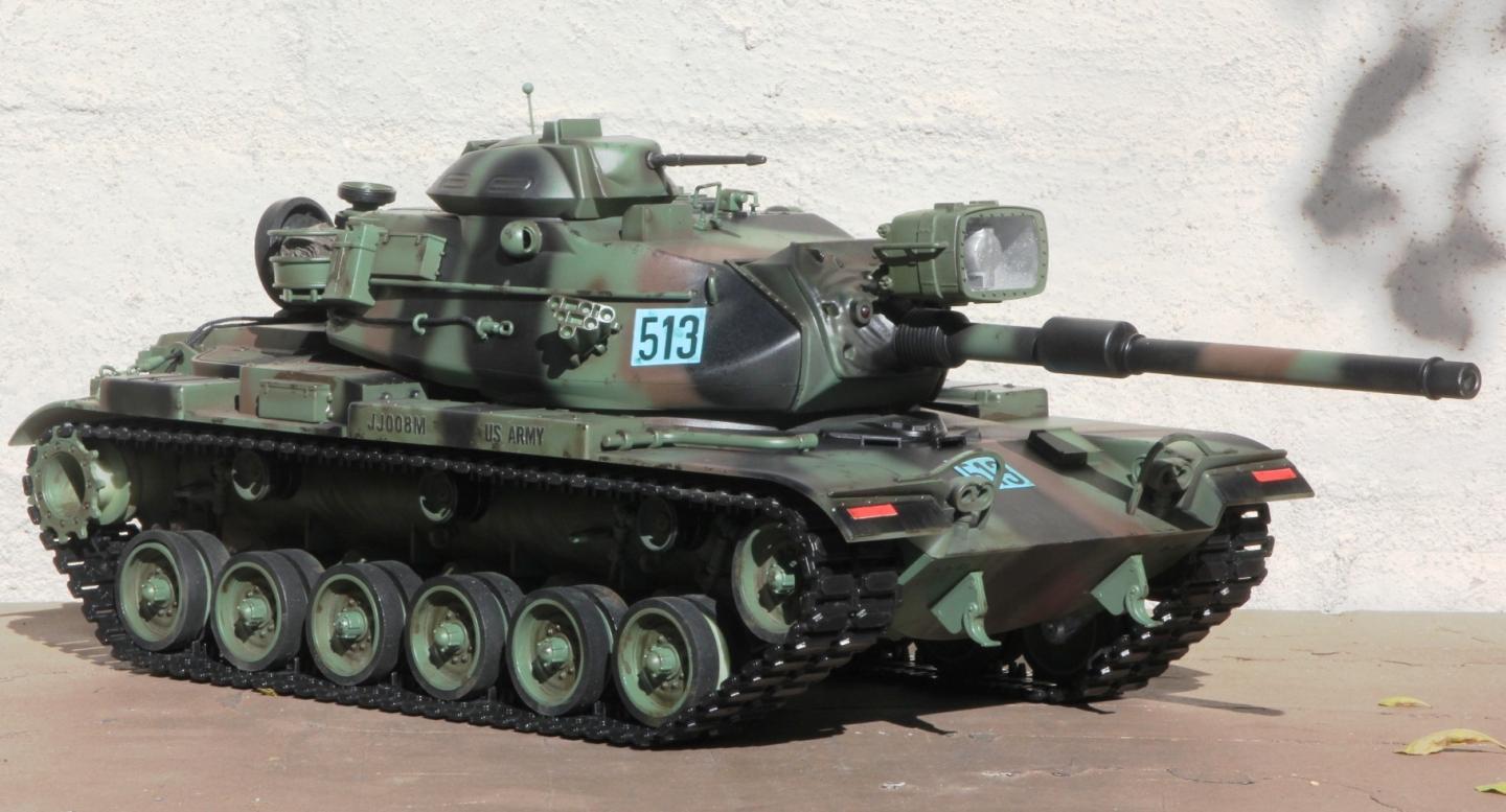

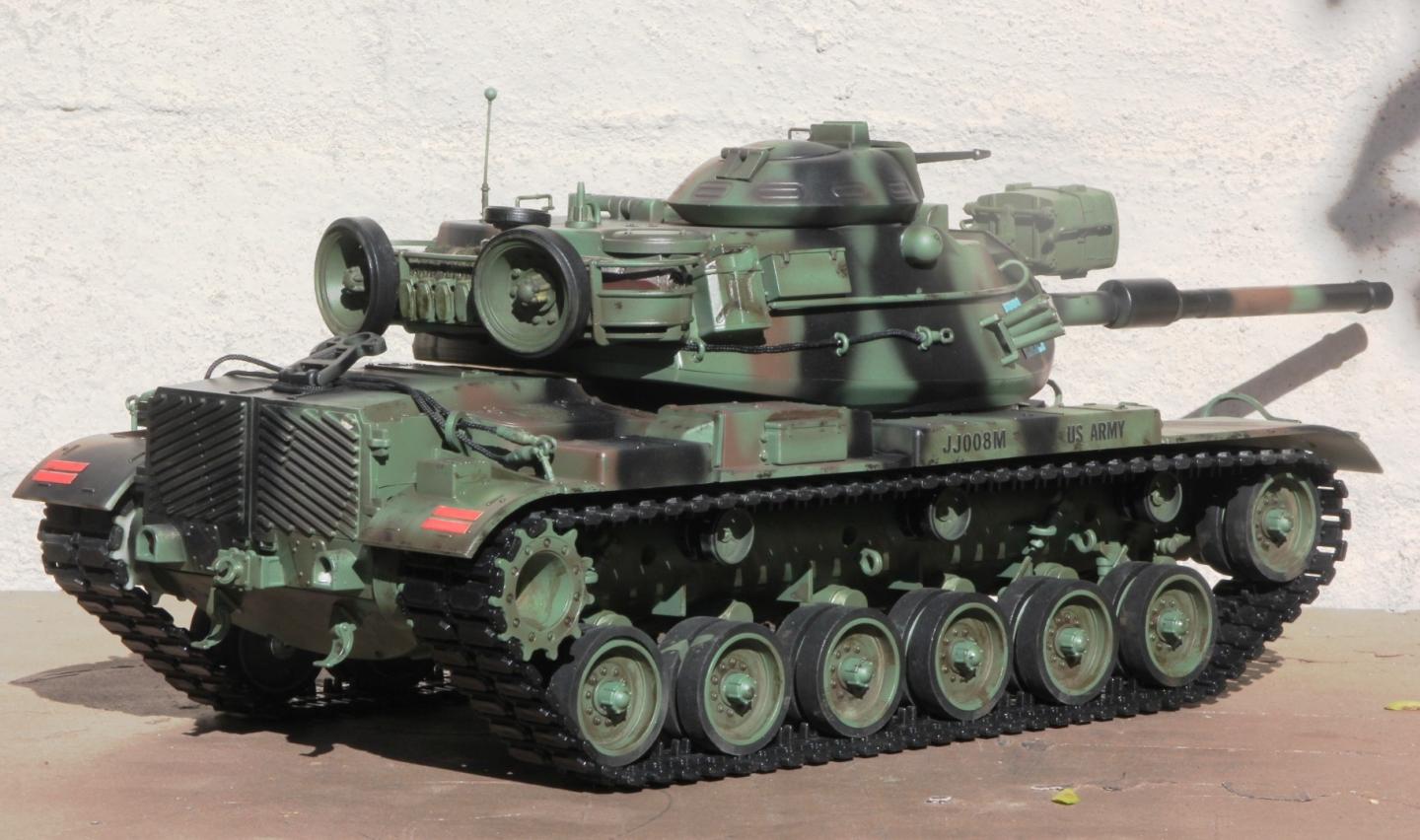

    I ordered the metal version; however, the retailer only had the plastic version. They sent me the metal upgraded parts on the side. So I kinda gained all the plastic parts, heheh. I play with the plastic parts for now. When the parts get used up, I will switch over the the metal parts.

        • keilau
          • Mar 2021
          • 1838
          • Windy City

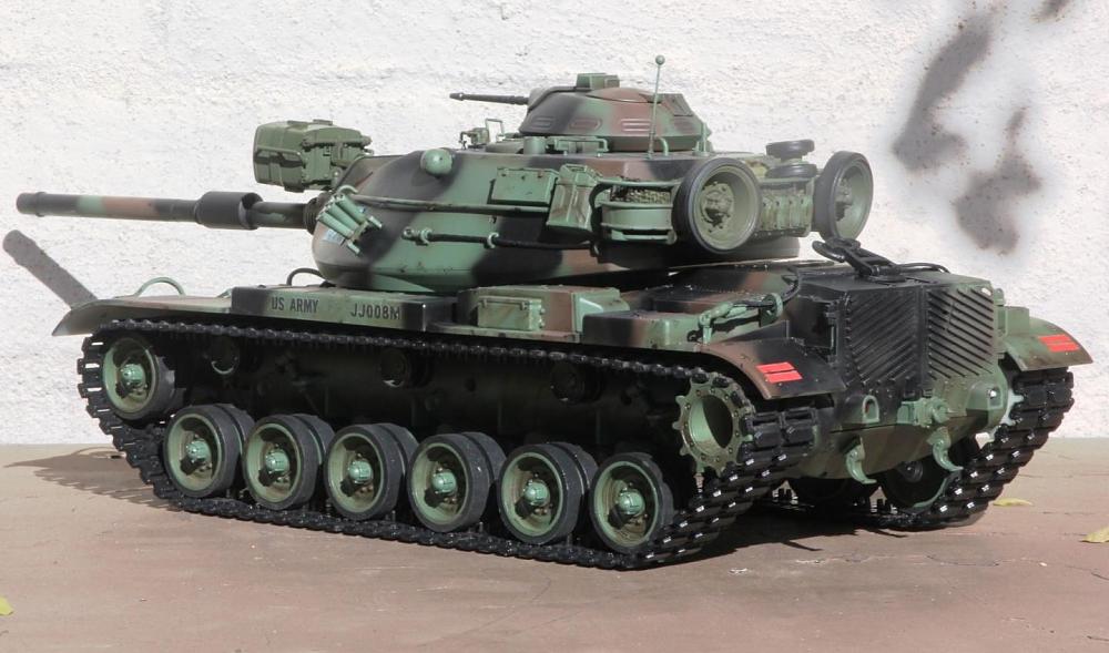

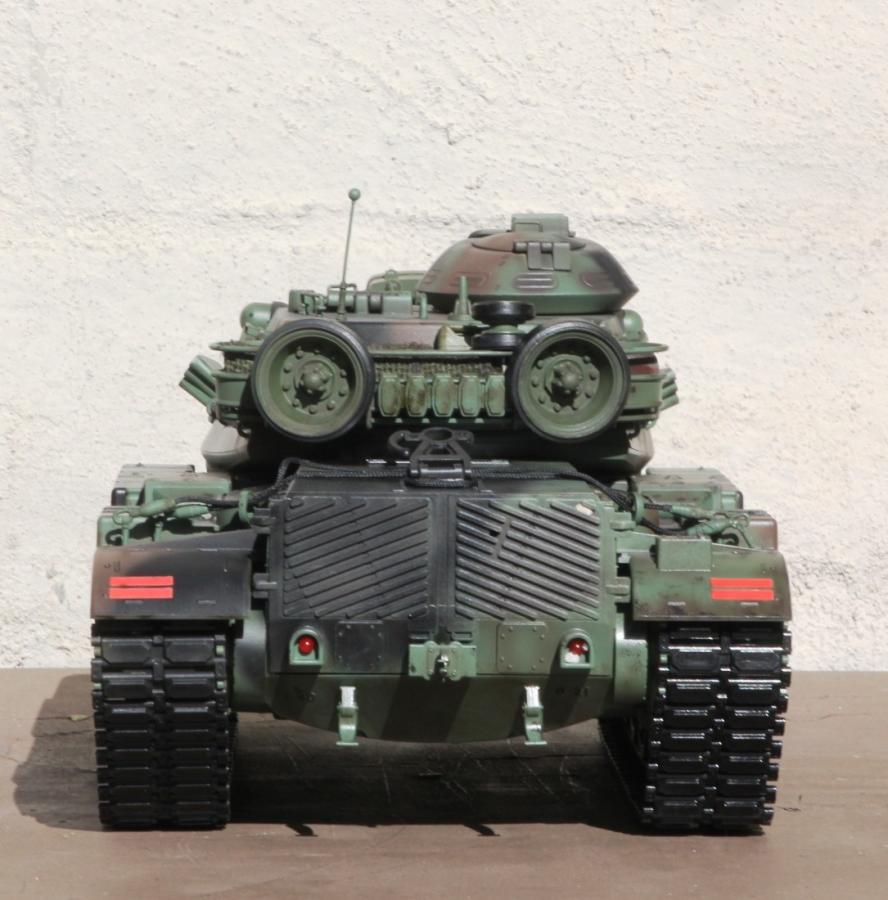

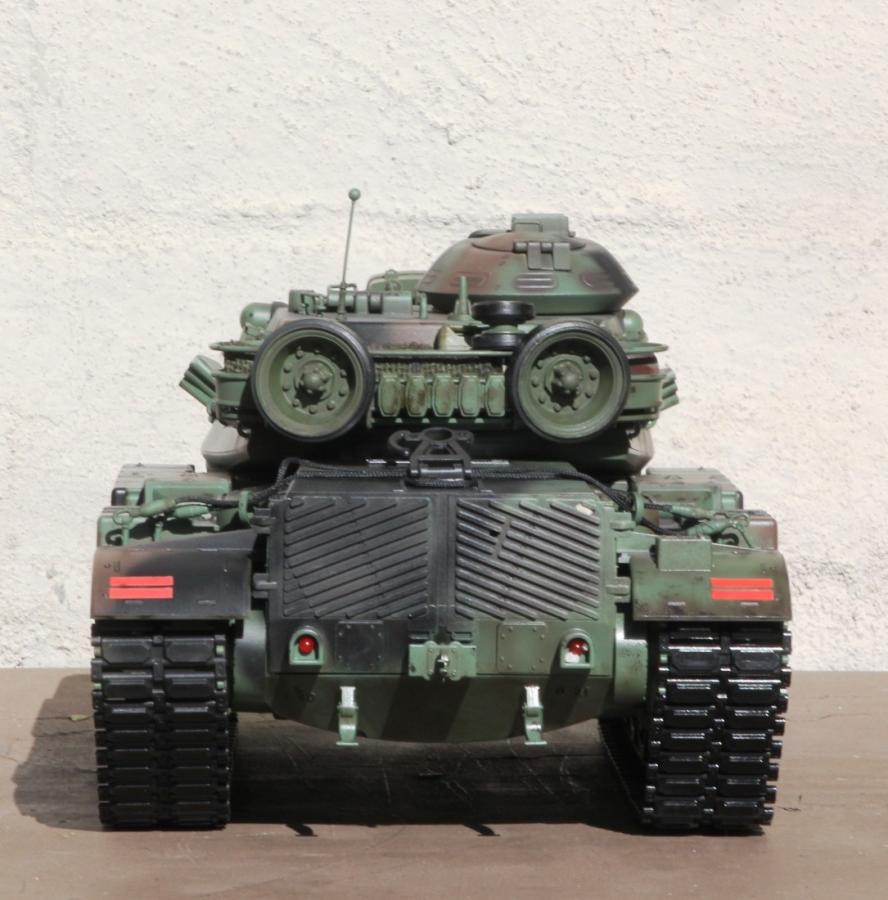

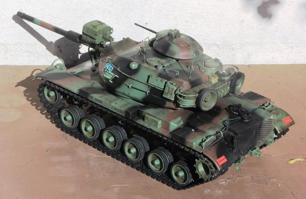

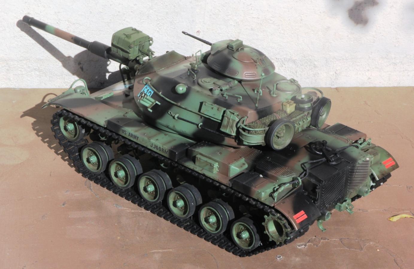

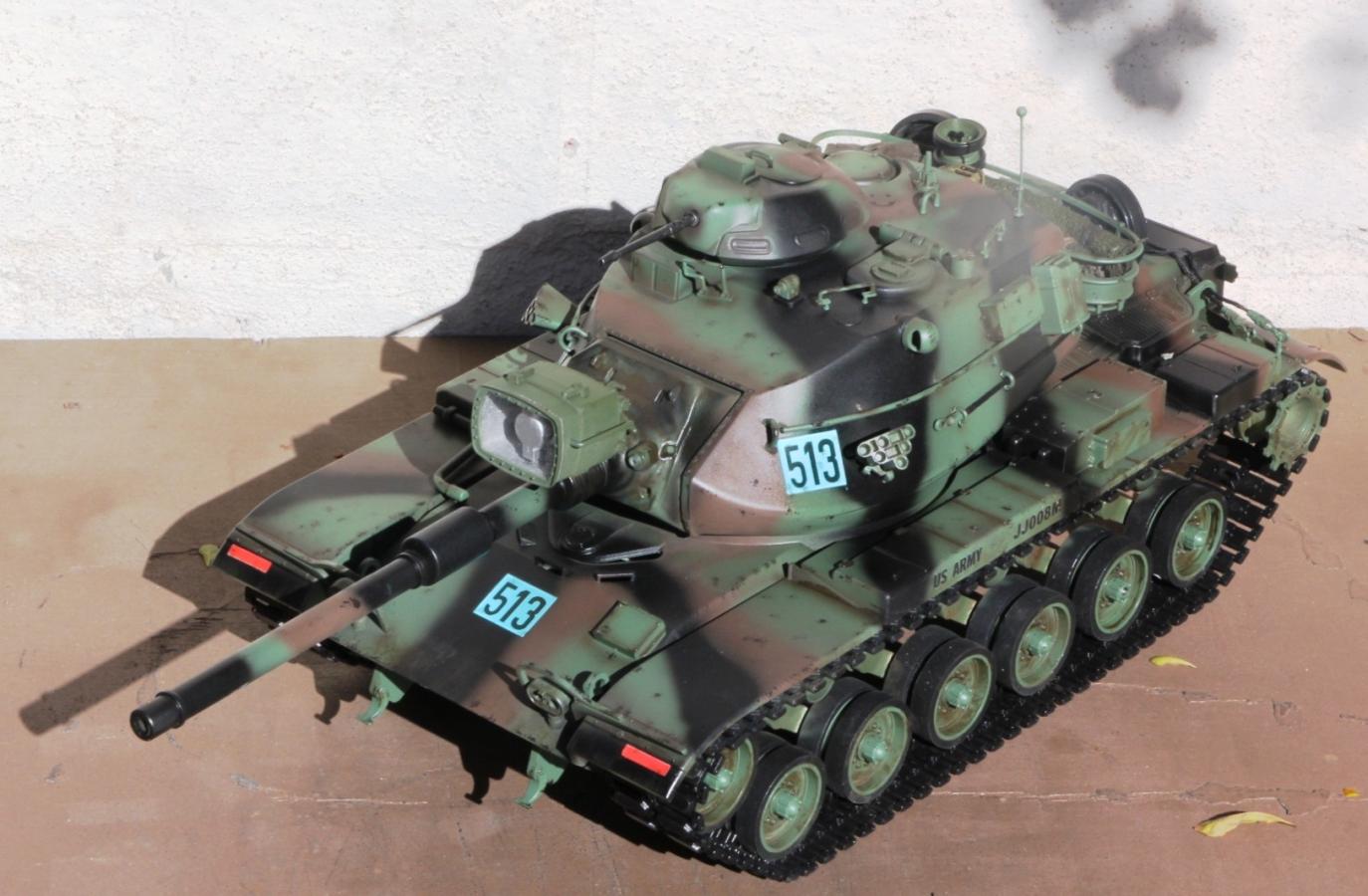

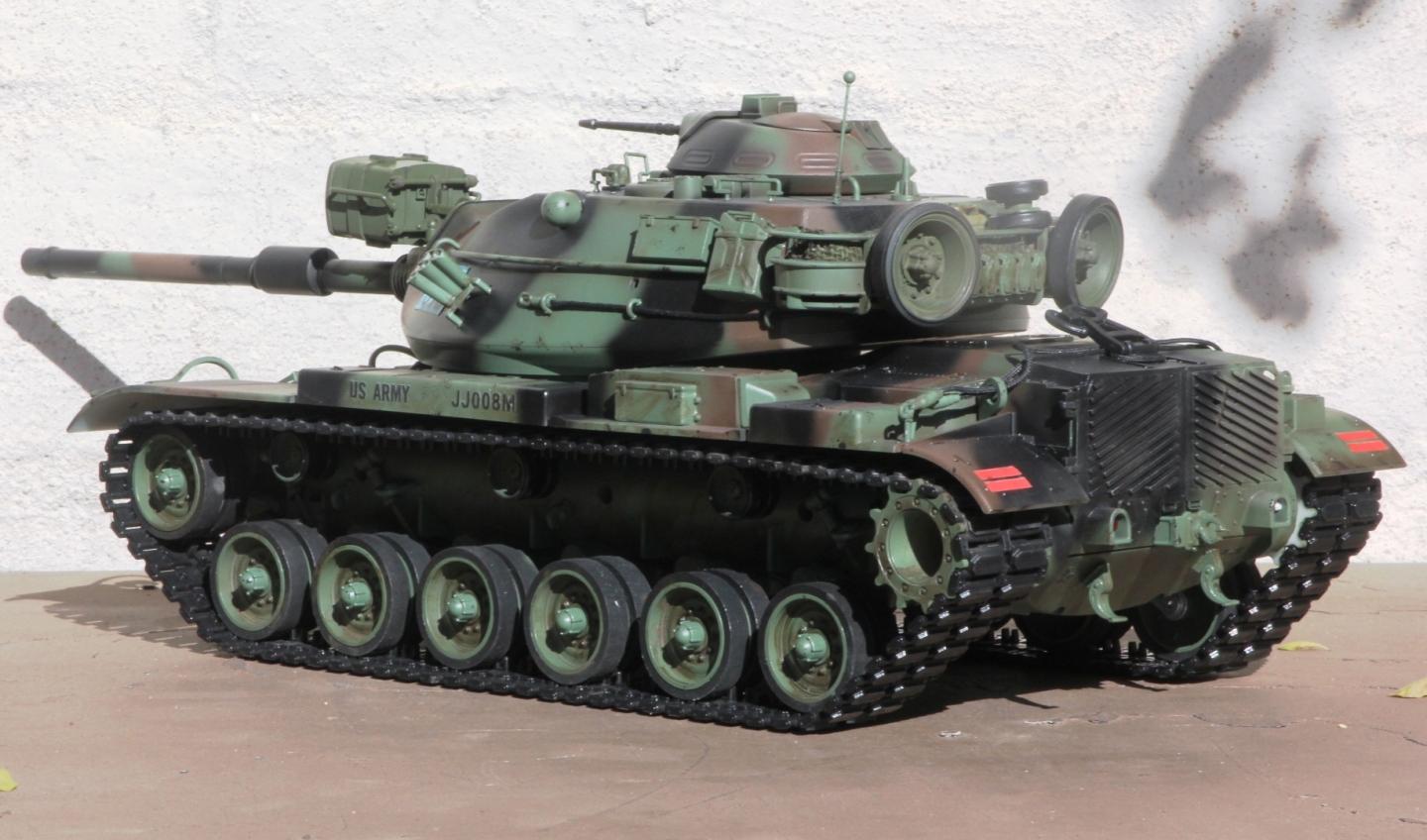

          This is the M60A3. Its towing cables are wrapped around the turret. The extra towing cables at the back should not be there.
          • DavidN
            • May 2021
            • 3200
            • Los Angeles, CA
            Thank you for letting me know. I am not into post WWII tanks much. I bought this one just to have it. Those extra towing cables you mentioned came with the tank and was shown in the manual. If I don't put them on, there will be 4 holes unused at the rear of my tank :-) Oh well! I don't mind having them there.

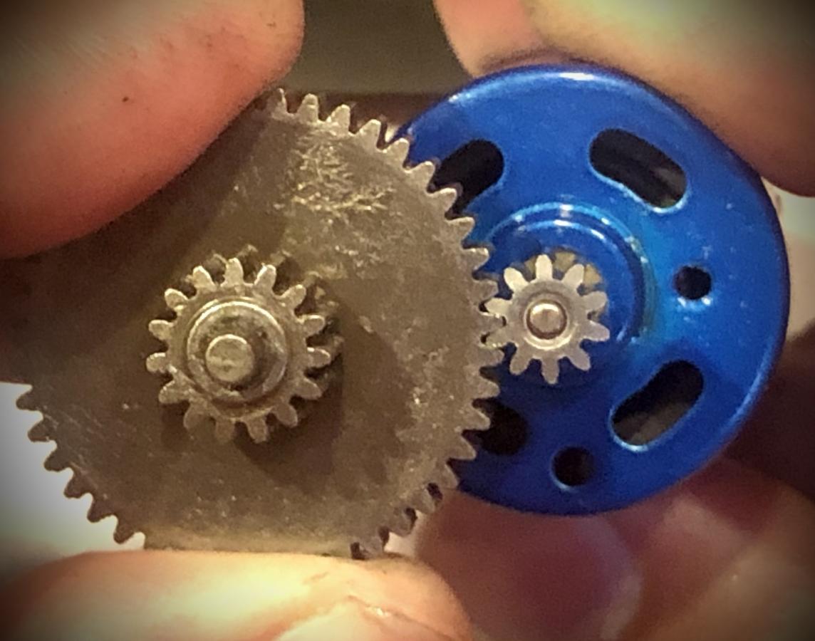

              I had an early production M60A1 that came with many problems. Rubicon99 review and upgrade of the M60A3 was a wonderful roadmap for my metal upgrade. One of the biggest problem is the pinion gear of the TD drive motor. I replaced them with Tamiya 380 standard motor from e-Tamiya.com, better than the HL Blue 380 and cheaper.
              Removed the left gearbox and found the reason for the jamming. The motors pinion gear has "flat" gear teeth that are not able to fully and smooth mesh with its corresponding gear. I replaced the stock 380 motors with HL blue 380 motors as these have more torque and a much smoother fit/mesh. See photos below.
              TD stock 380 motor pinion gear mesh up. As you can see the mesh is not very good and as such would "catch" and cause the motor to stop turning.

              Heng Long blue 380 motor. You can see how much better the pinion meshes with its corresponding gear. Click image for larger version Name:	93130B61-AFCD-4895-80FB-B50DC8BE1E36.jpg Views:	0 Size:	93.4 KB ID:	375127
