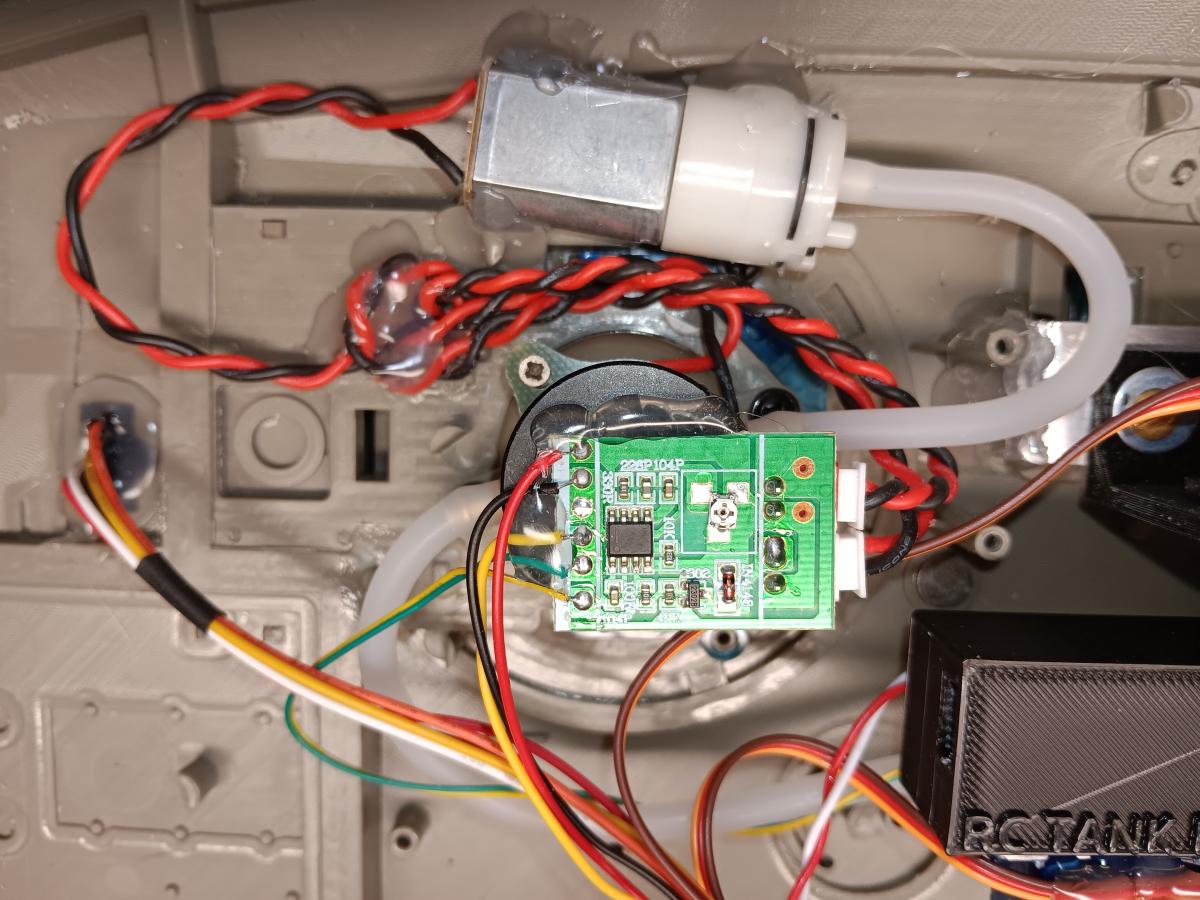

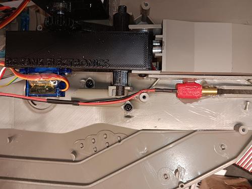

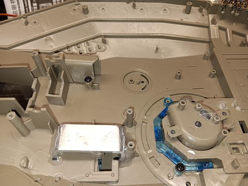

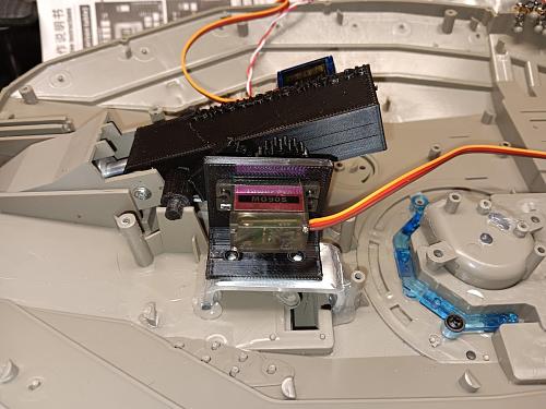

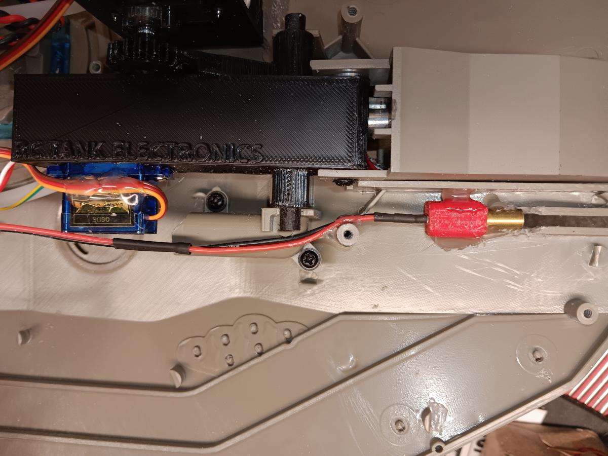

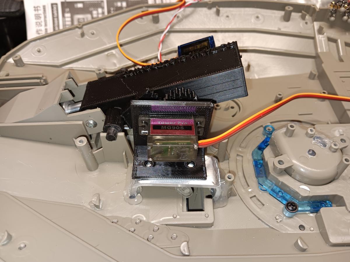

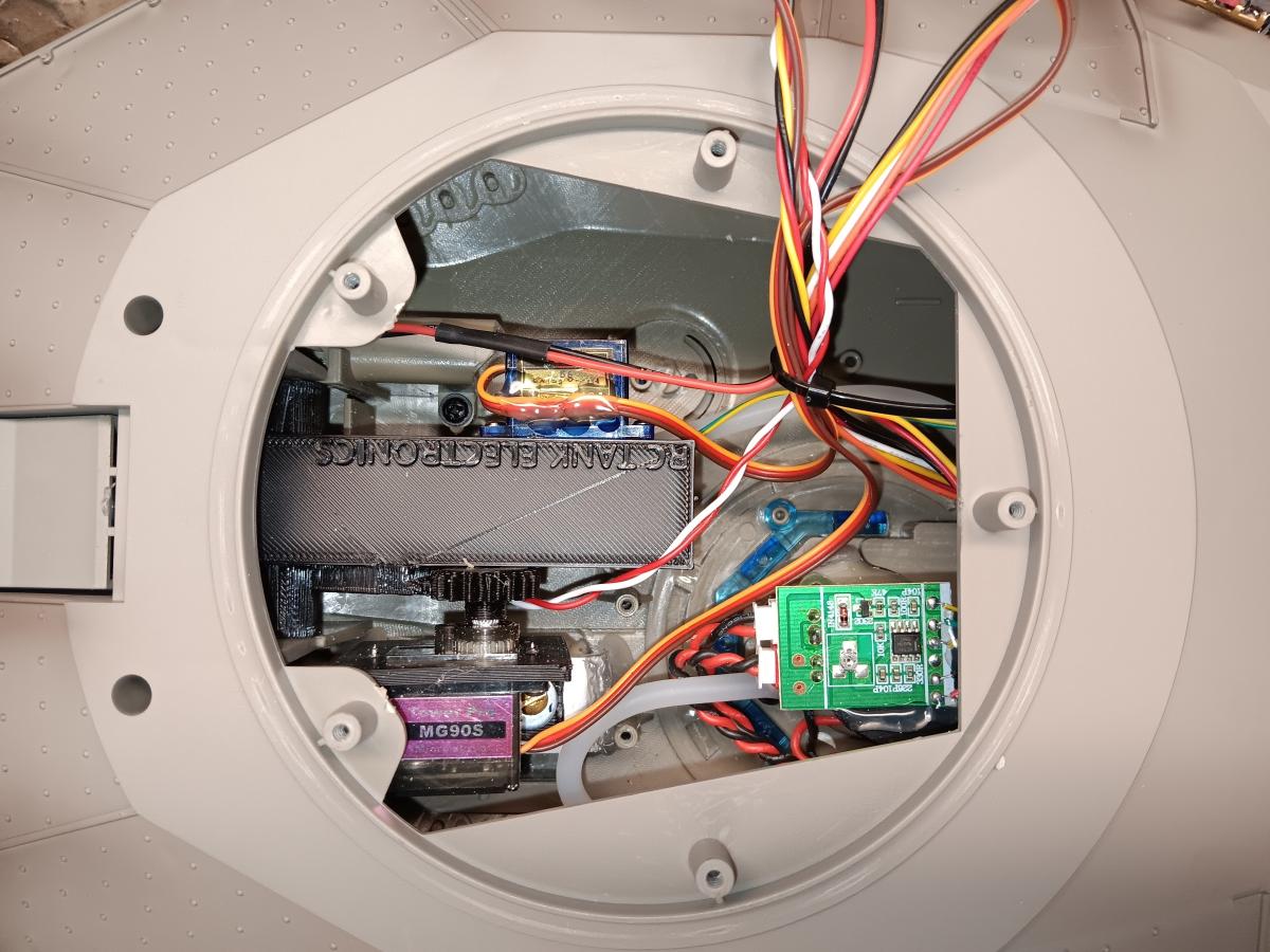

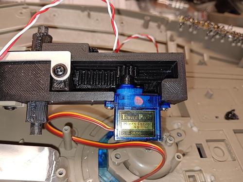

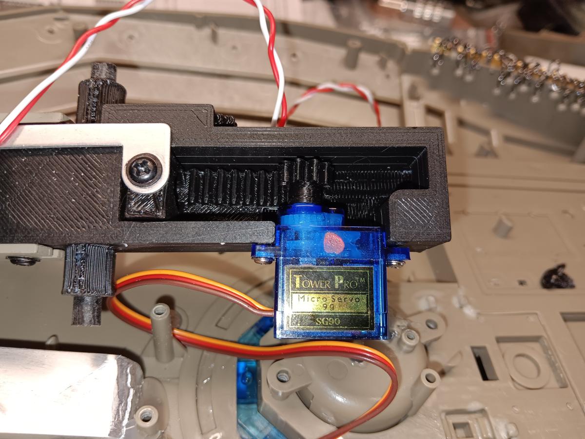

    I am converting my HL Merkava MK IV over to using the TK7.1 electronics to install the RC Tank Electronics servos for the barrel recoil and elevation. Also installing a barrel flash w/smoke system, the DGS Promotions HL IR Upgrade kit and the Heng Xin gearbox w/red motors.
    RC Tank Electronics servo kit install
    Click image for larger version  Name:	20231223_111241.jpg Views:	0 Size:	109.7 KB ID:	393358
    Click image for larger version  Name:	20231223_111326.jpg Views:	0 Size:	143.4 KB ID:	393359
    Click image for larger version  Name:	20231223_111507.jpg Views:	0 Size:	127.2 KB ID:	393360

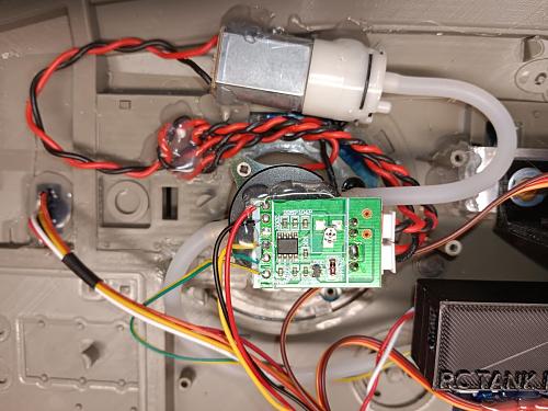

    Barrel flash and smoke unit. IR receiver plug on far left in center.

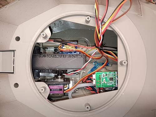

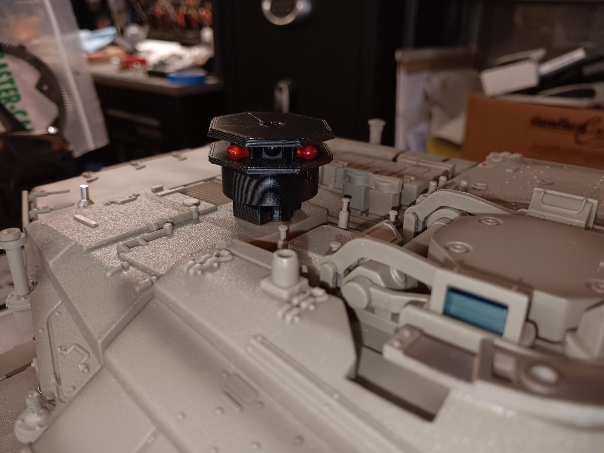

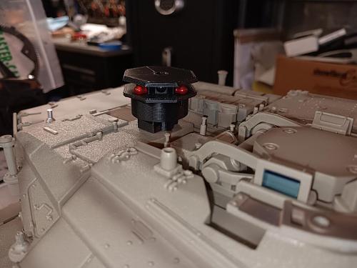

    DGS Promotions HL IR emitter
    Click image for larger version  Name:	20231223_155006.jpg Views:	0 Size:	123.9 KB ID:	393362

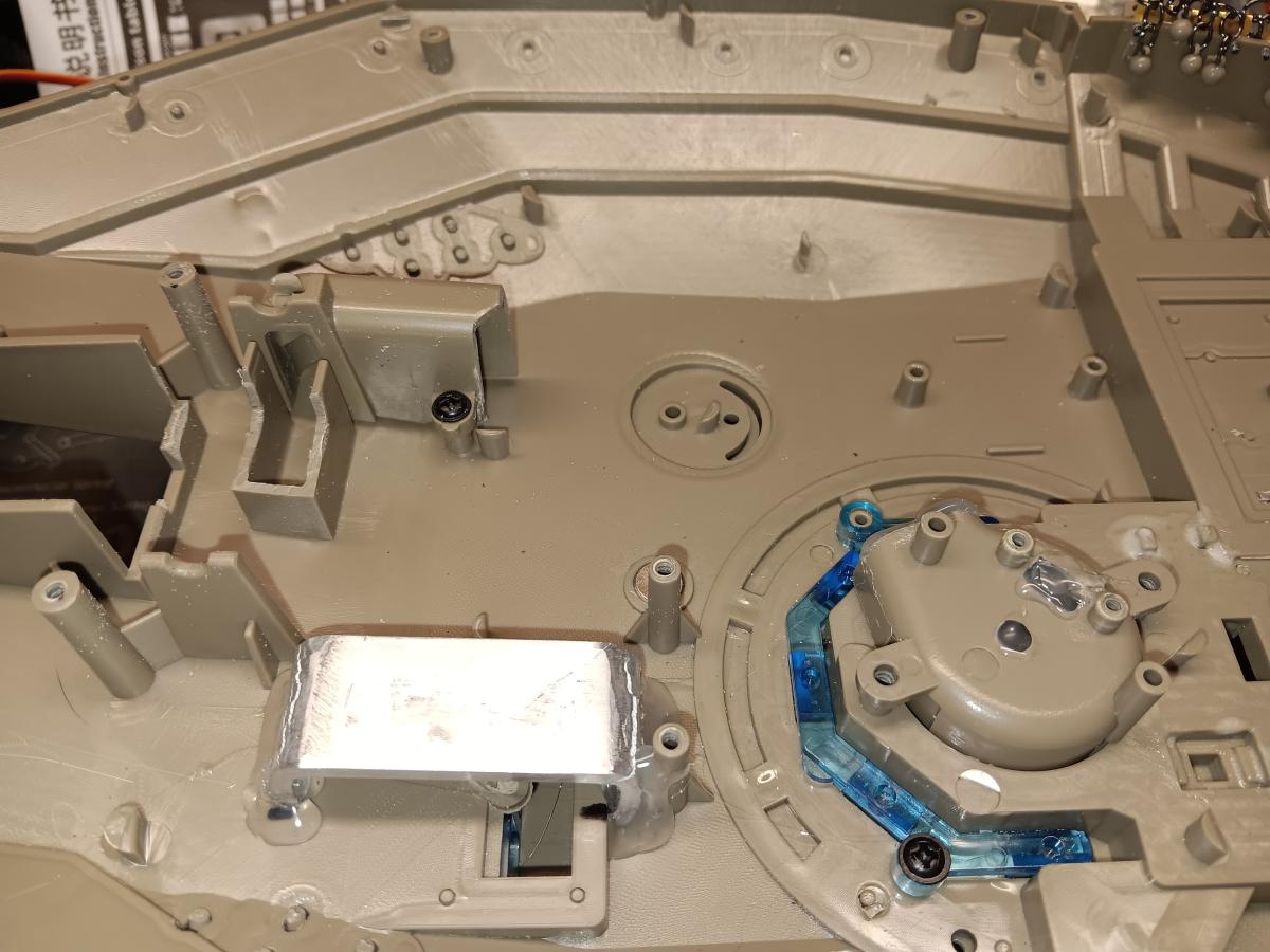

    View through turret bottom cover
    Click image for larger version  Name:	20231223_155225.jpg Views:	0 Size:	136.4 KB ID:	393363
    DGS Promotions HL IR receiver

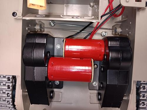

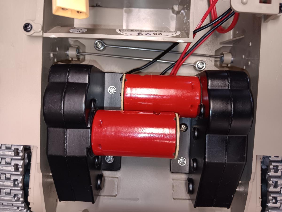

    Click image for larger version  Name:	20231222_161130.jpg Views:	0 Size:	109.2 KB ID:	393366

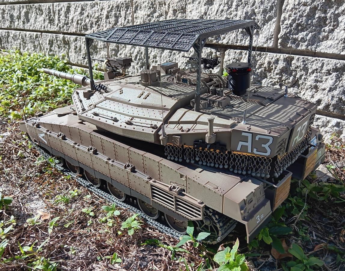

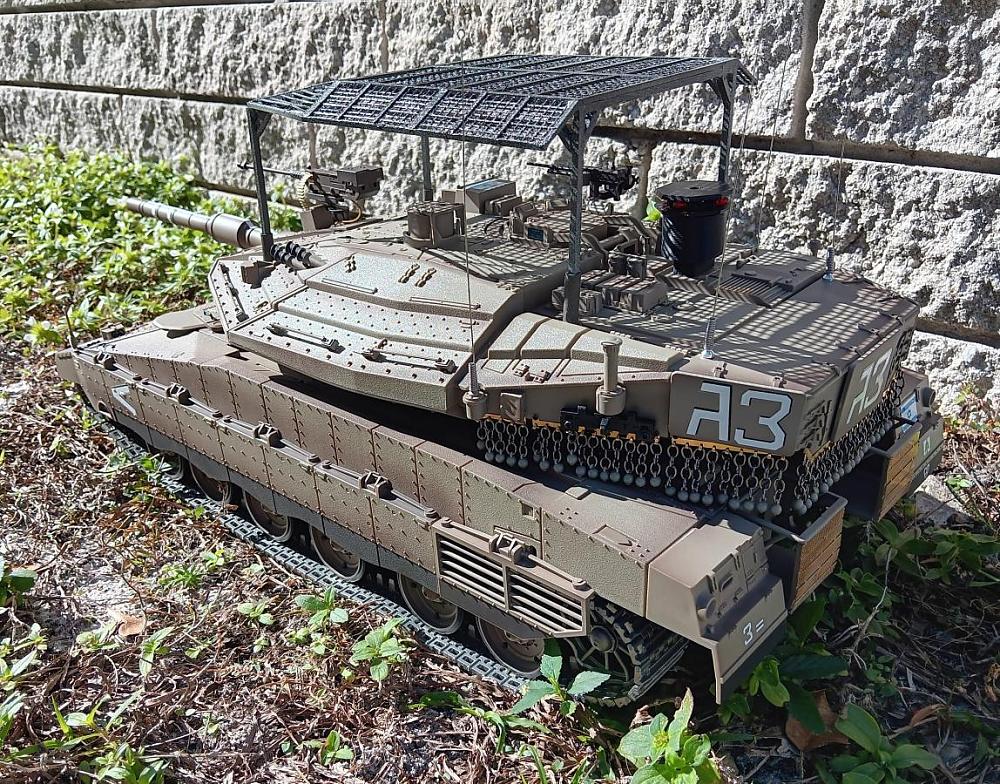

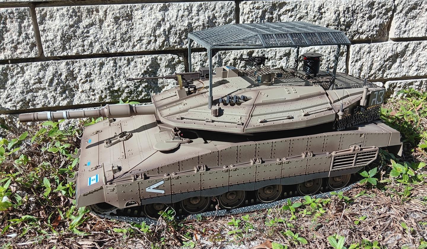

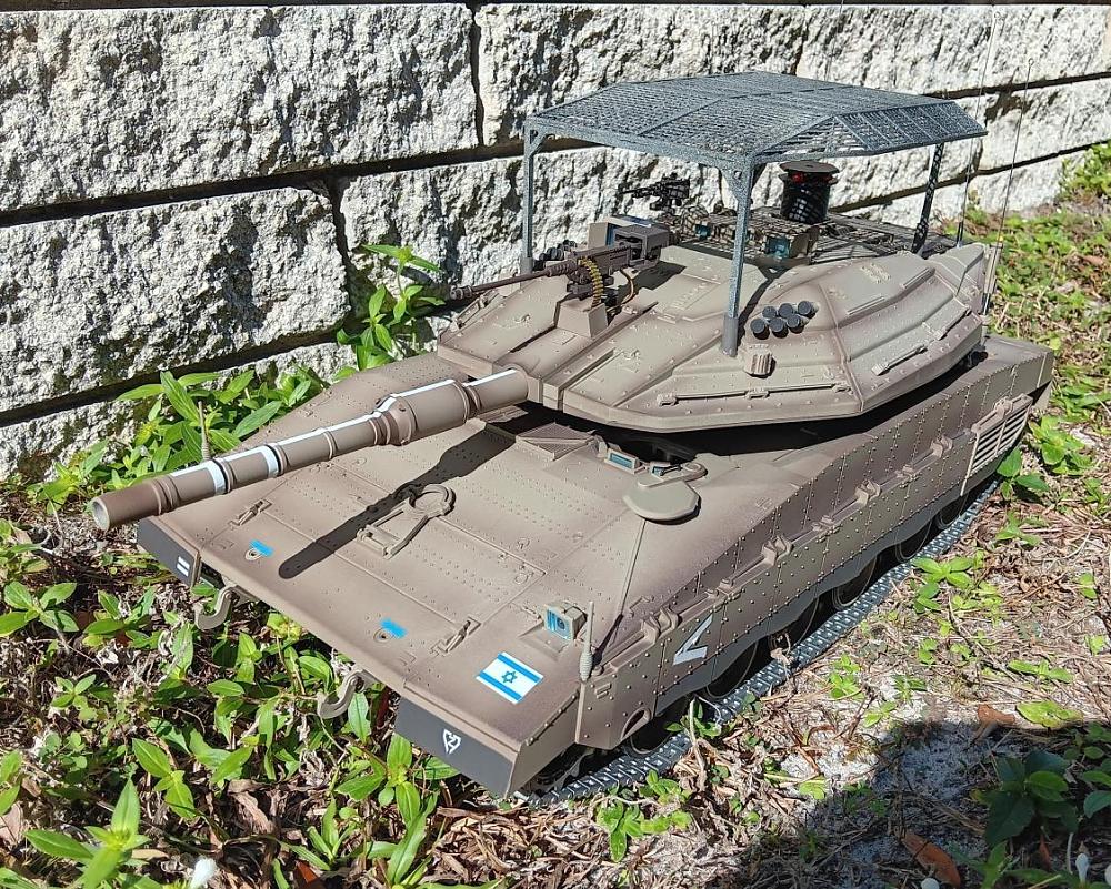

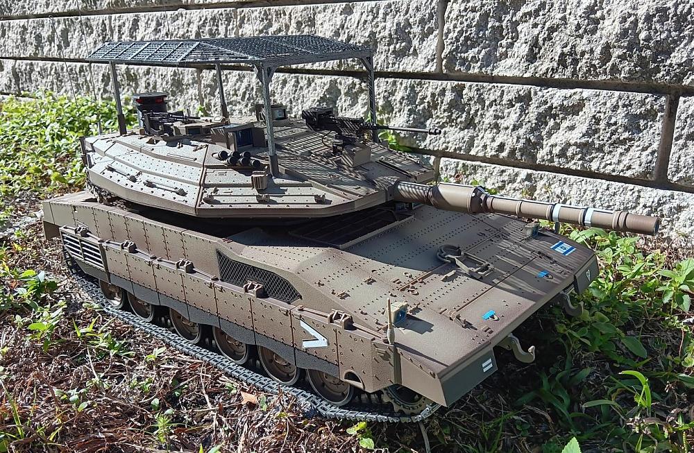

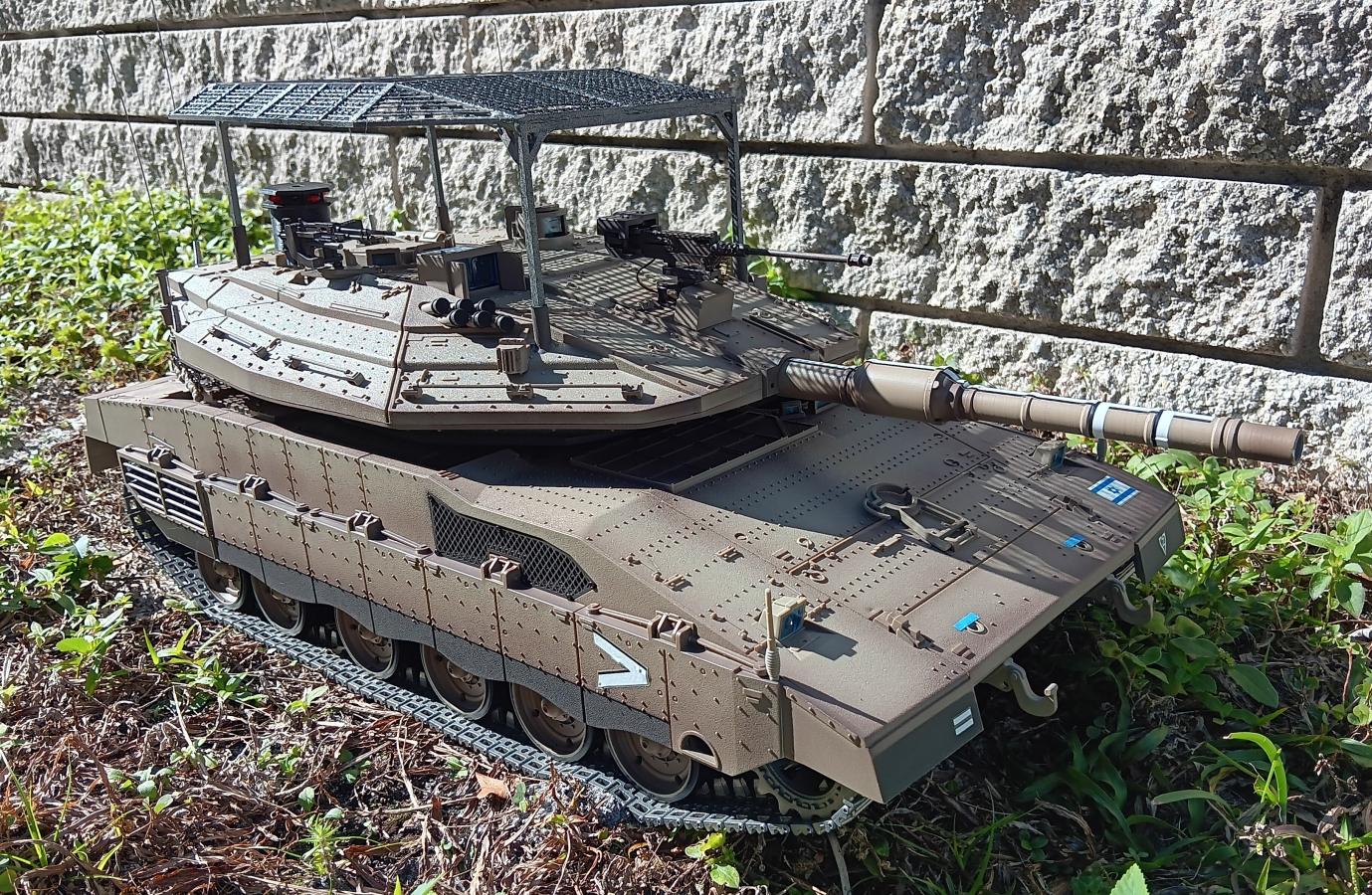

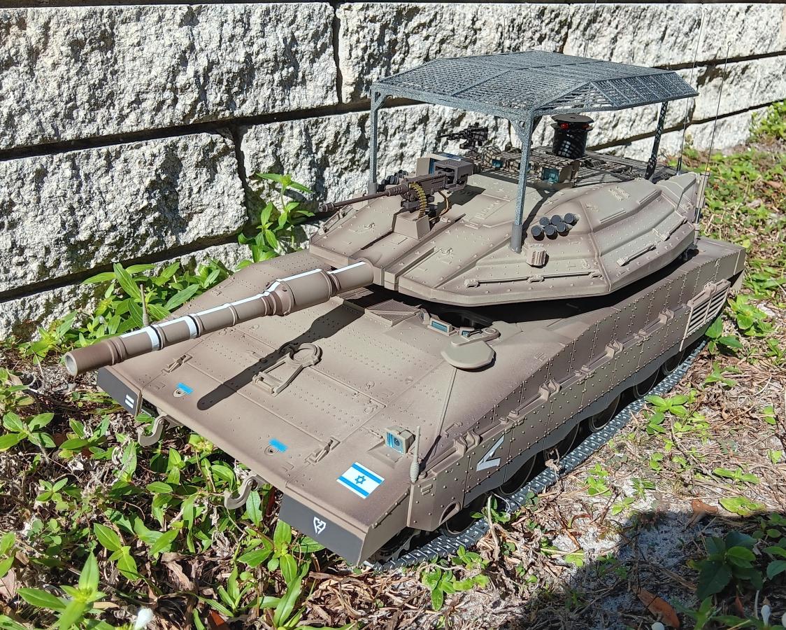

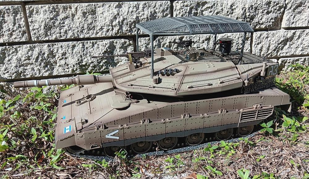

            Click image for larger version  Name:	20240101_112558.jpg Views:	0 Size:	427.2 KB ID:	393894​I received the replacement for the defective HL TK7.1 motherboard last Friday from Toucan's US warehouse with the TK7.1 transmitter/radio I ordered 12/21/2023.
            Got everything rewired in the tank wiring harness to connect to the new HL TK7.1 motherboard and reassembled the Merkava MK IV.
            Also, thanks to Rich Johnson for printing me the "Cope Cage" to complete a near exact replica of the Merkava MK IV on the battlefield in their latest ongoing conflict in Israel.
            I really like the servo functions on both the elevation and recoil of the barrel. I've got 100% of movement range on barrel elevation and good control of movement. And the barrel now has slowed movement on the recoil, normal movement upon firing and the barrel moves through a reloading elevation change that returns to the barrels last elevation position. Really more realistic.
            Added the wired 50cal machine gun to the barrel plate for light flashing when shooting. And the HL IR Upgrade kit from DGS Military Hobby (Dean Godin) for battles.
            Click image for larger version  Name:	20240101_112424.jpg Views:	0 Size:	433.0 KB ID:	393890 Click image for larger version  Name:	20240101_112437.jpg Views:	0 Size:	338.7 KB ID:	393891 Click image for larger version  Name:	20240101_112452.jpg Views:	0 Size:	359.5 KB ID:	393892
            • RichJohnson
              • 1274
              That came out really good.
              • tank_me
                • Feb 2022
                • 1180
                Makes me wish I bought a Merkava....one day...one day.
                • MGTbrOdiE
                  • Jun 2024
                  • 5
                  • Michigan

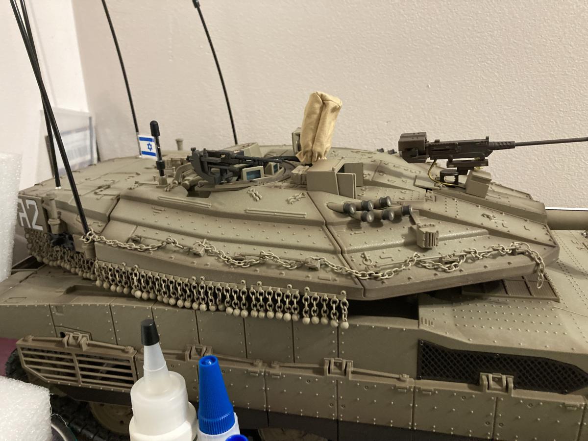

                  That cope cage is sweet, nice way of mounting with the tubing, did you magnetize the connection mount to tank at base? Or is that a permanent install, looks sweet either way found the 3d print file for it just been trying to find someone to 3d print it, I contacted some local places waiting to hear back. I bet it helps as a sun shade for the ir receiver! I’m currently extending the chain and ball feature up to the front.
