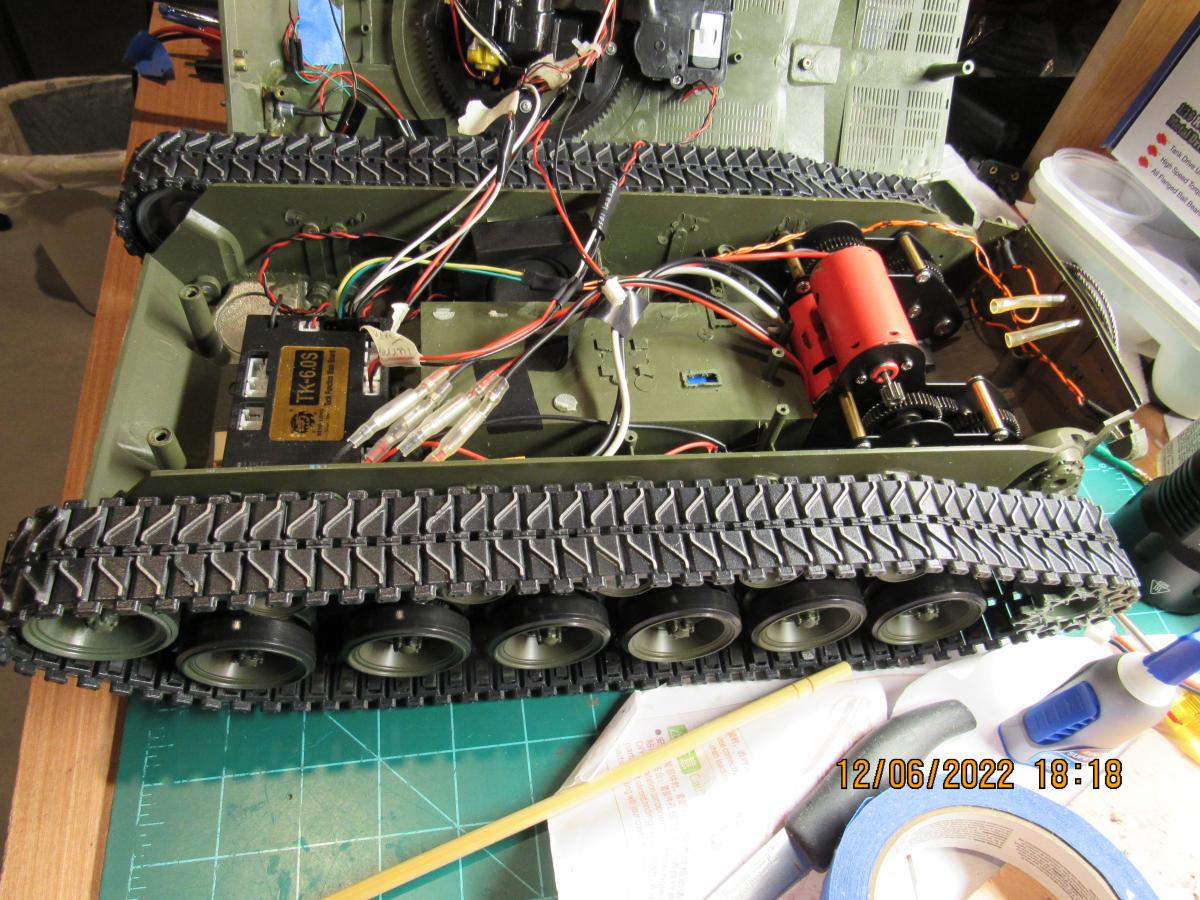

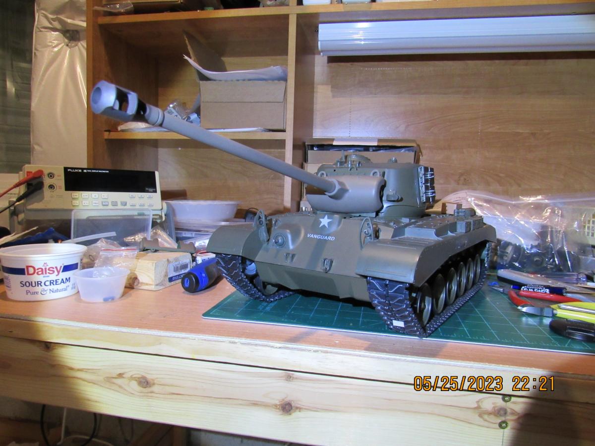

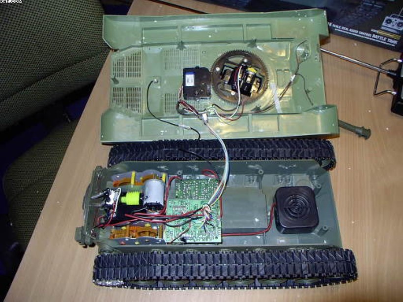

                I have gone through upgrading a 2005 Snow Leopard (TK27 radio) to a 2020 Pershing with the TK6.0S radio. It is a fun and rewarding process. I received lots of help from other forum members.

                • #9
                  Originally posted by keilau View Post
                  RonV , You can find this information at the TK-7.0/7.1 4pages manual. It is not in the Walker Bulldog RC tank manual.
                  Click image for larger version  Name:	HLpershing_TK27inside.jpg Views:	0 Size:	127.3 KB ID:	394596 Click image for larger version  Name:	IMG_5122.jpg Views:	0 Size:	194.3 KB ID:	394597 Click image for larger version  Name:	IMG_5176.jpg Views:	0 Size:	133.4 KB ID:	394598
                  Yeah, My Pershing is next.
