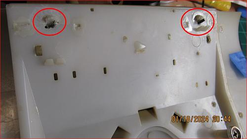

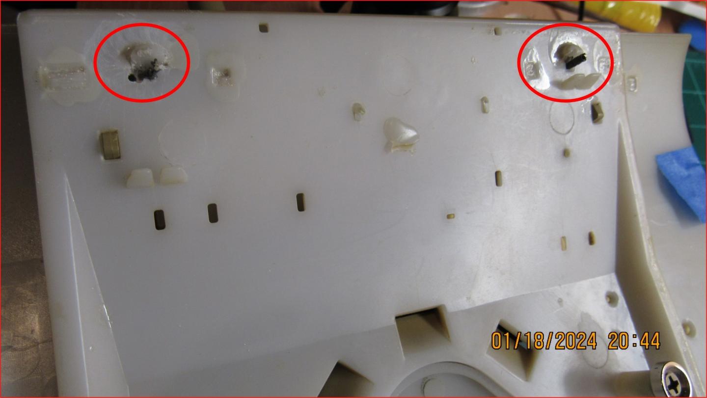

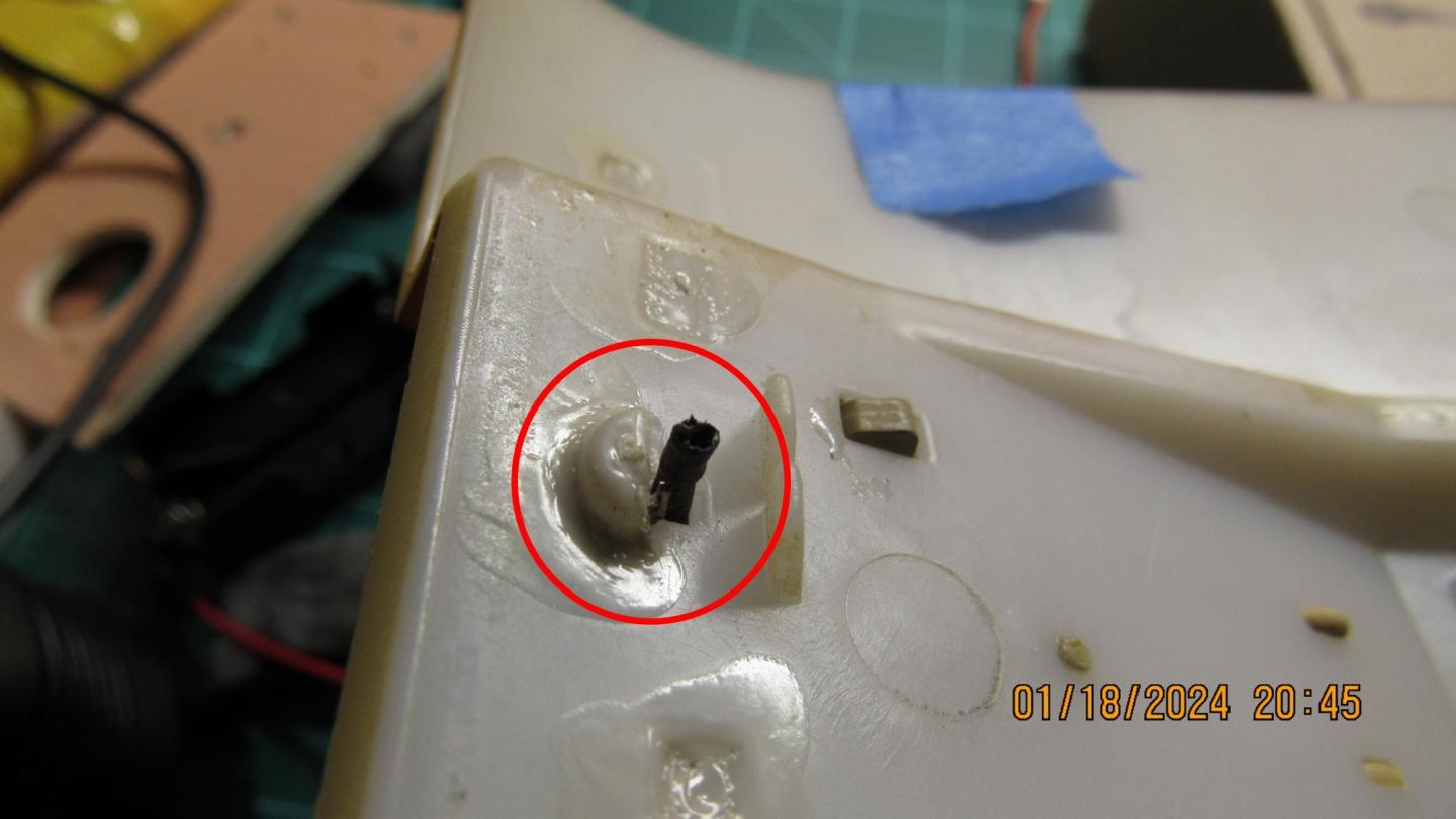

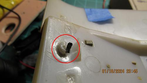

    I broke off the M60 head light LED connections when I did the metal upgrade. Everything else are working fine except the head lights. TongDe used extra fine gauge 26 wires for the LEDs. It would be much less prone to breakage if they use gauge 22 wires like HL do. If you have done this repair, I will appreciate any tip or suggestion on how to access the LED wires.
ID:	395142 Click image for larger version
    My only tip is that the glue they use can be debonded with CA debonder. Caution, the debonder will also remove the paint, use with care!
    Twenty six tanks, and not done yet!
    • #3
      I am using a very fine grid sander to remove the CA glue layer. It takes a long time, but more controllable than the debonder. This is not the fun part of RC tank upgrade.
