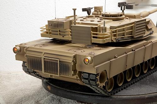

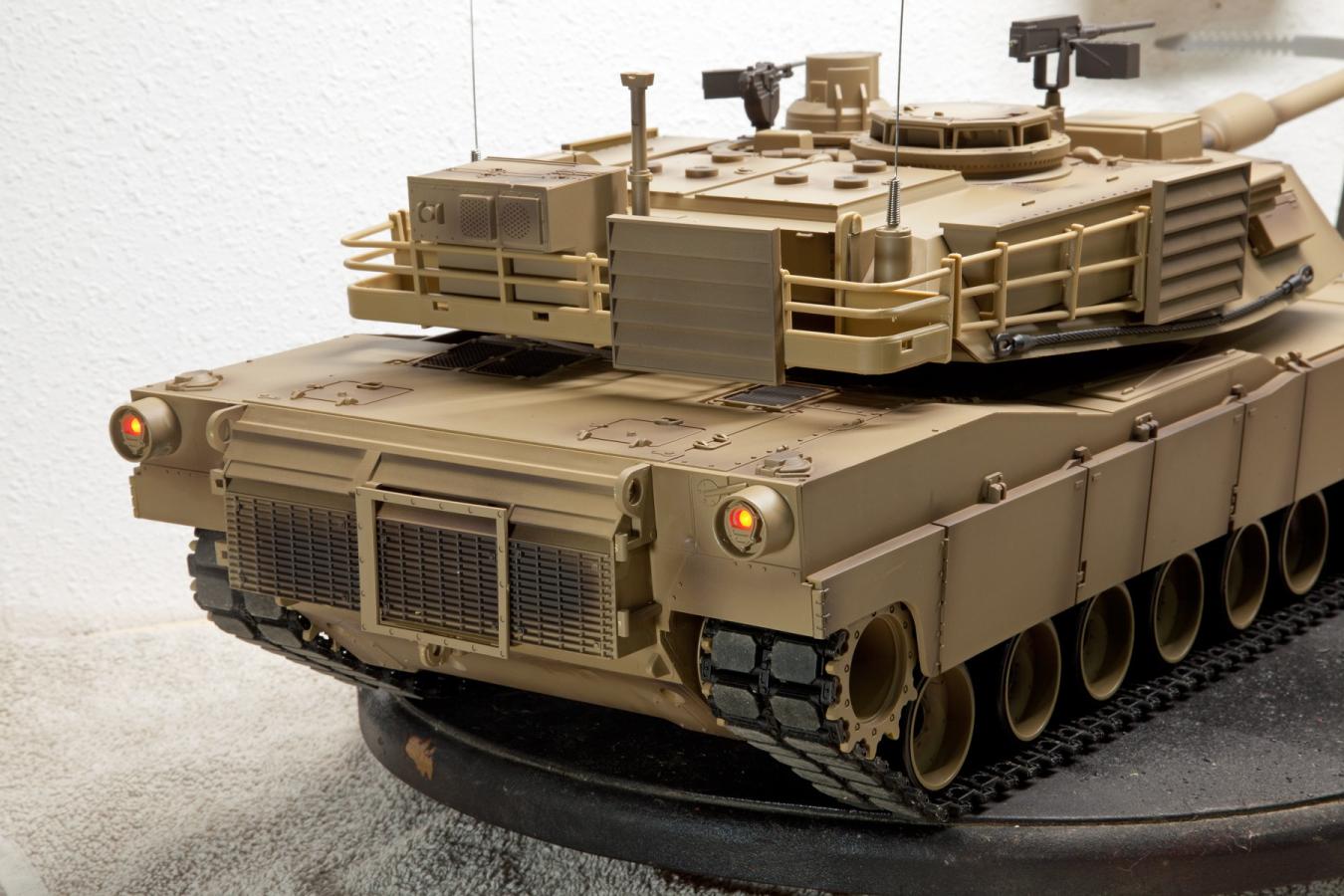

    Got my Abrams from MRC today, the good news is it came with with correct controller with the turbine sound, the bad news is it didn't even get halfway across the floor before the track track threw a pin and came apart... totally not impressed. The pin was found, if I had to guess I'd say someone tried to CA it, because there a little blob of it on the end, cleaned that off and the pin was a loose fit, nothing to hold it in, got the bag with spare links/pins, different pin completely, dark colored and a well defined knurled end, got it back together and moved on, metal tracks are on the list anyway.
    Got through everything else fine, although of the 4 tanks I have now including the plastic track Pershing, this gets the worst traction in snow, there's more track on the ground, but the track design doesn't have a lot of grab it seems. The Pershing is even lighter but the tracks are a more aggressive design, and I'm sure weight help too, I plan on changing the battery connector to a Tamiya so I can use an NiMH pack and get a weight advantage their, future plans include a full bearing gear box and full metal suspension/wheels, preferably with bearings where ever available. Click image for larger version

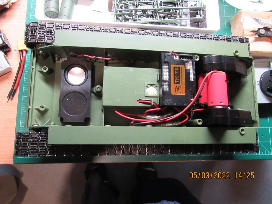

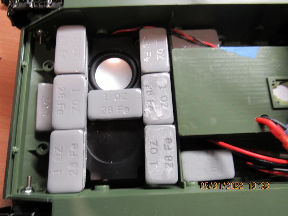

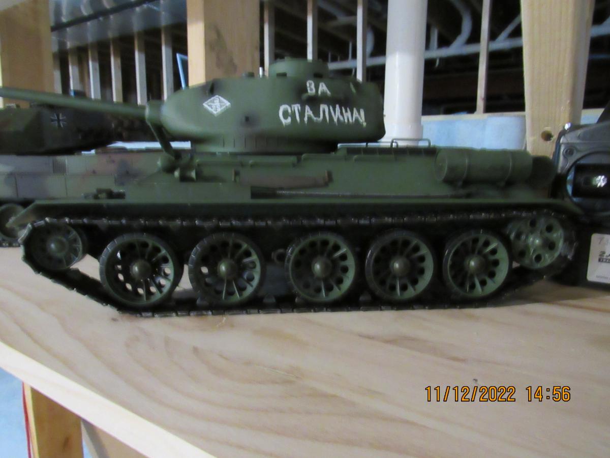

        Click image for larger version  Name:	IMG_5095.jpg Views:	24 Size:	176.7 KB ID:	395435 Click image for larger version  Name:	IMG_5105.jpg Views:	23 Size:	84.0 KB ID:	395436 Click image for larger version  Name:	IMG_5118.jpg Views:	20 Size:	89.7 KB ID:	395437
        On my T-34, the Heng Xin gearbox and the Mato metal track have enough weight for the rear. I added lead weights to balance the front of the tank.

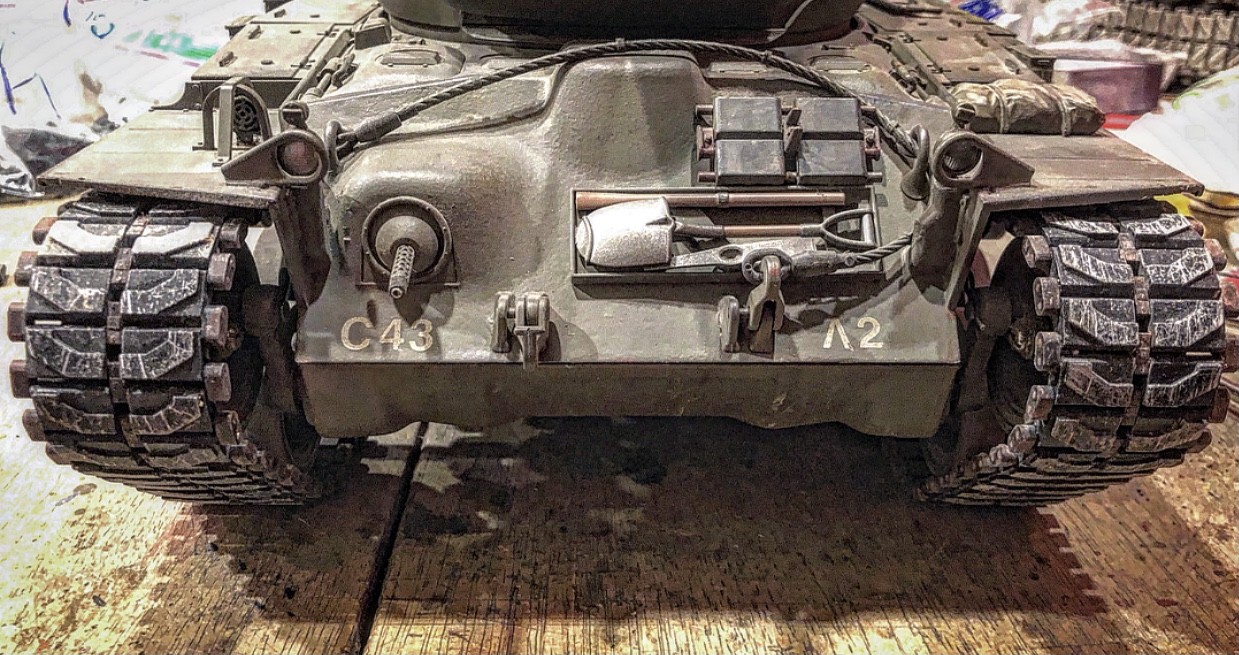

          Chevron tracks for the Abrams are hard to find. This set of dual pin T84 tracks for my M26 I had made by JVM3Dconcepts. Huge improvement over stock or all metal tracks.
          An option you might want to consider are Tamiya Leopard 2 or Tamiya Abrams tracks. Both are hands down the best all around tracks one can put on any Abrams. Strong, reliable and excellent grip. Price range between $100 - $250 .
          Like has been said already weight is your best friend when it comes to tanks. Even the best tracks need heavy weighted tanks to get the most out of them.

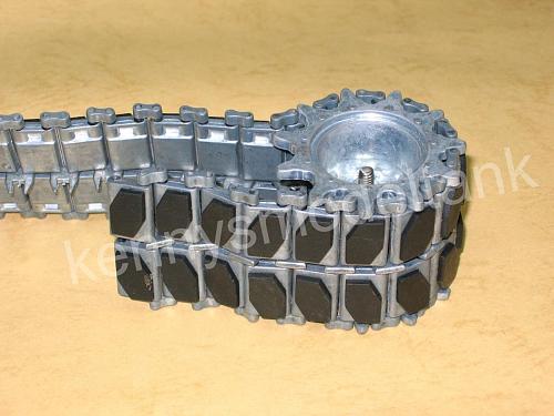

            I think Kenny Kong did a new run of the Abrams chevron T156 tracks as I've seen them at the Hobby Summit site on Ebay recently. T156 tracks were used on the original M1s, M1IPs, M1E1s and early M1A1s.
            Yeah, just found them on Ebay from Hobby Summit, but they were pretty expensive. They have them listed for $178 plus $48 shipping... Auction title is "1/16 U.S M1A1 Abrams MBT Metal Tracks Set w/sprockets re R/C tank".

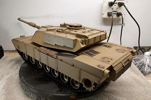

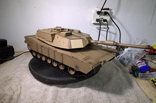

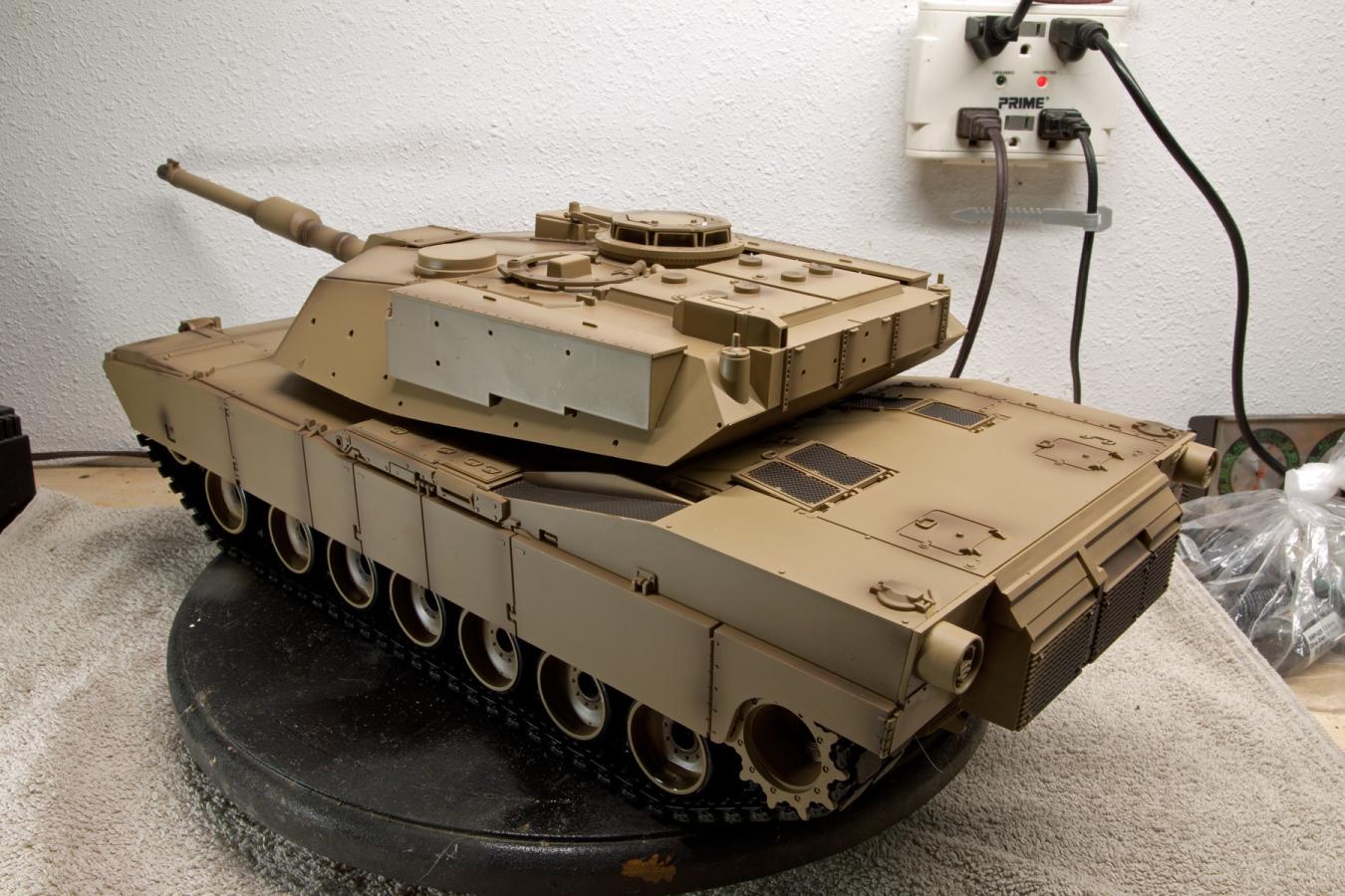

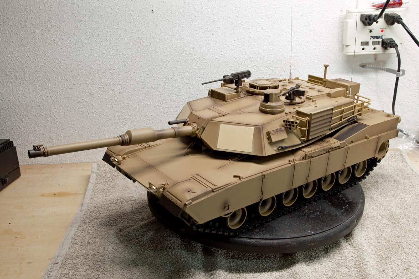

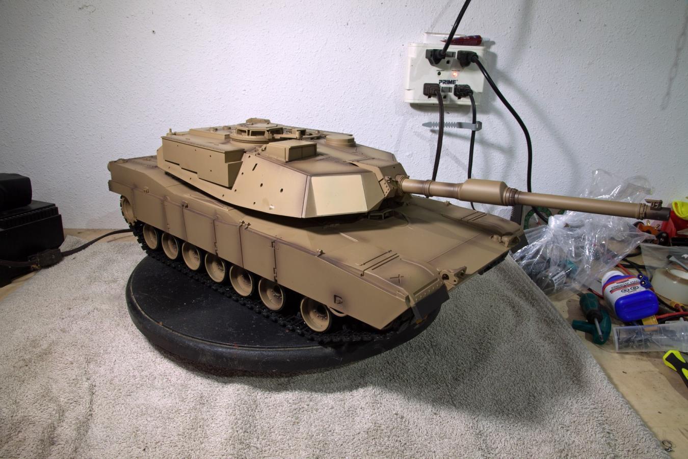

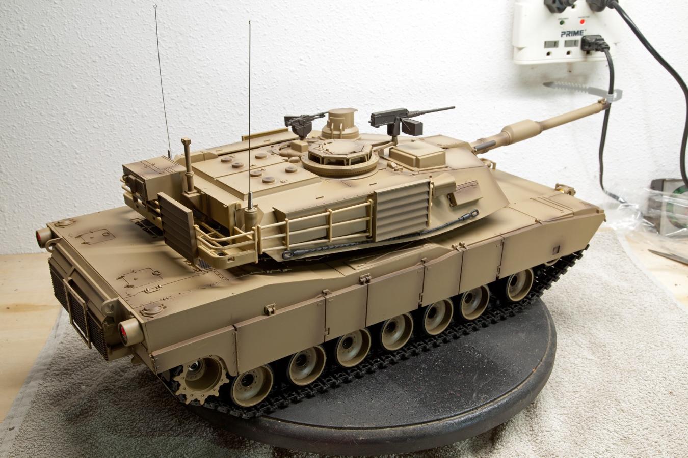

ID:	395459 progress...

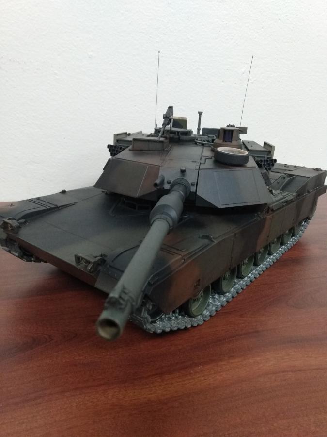

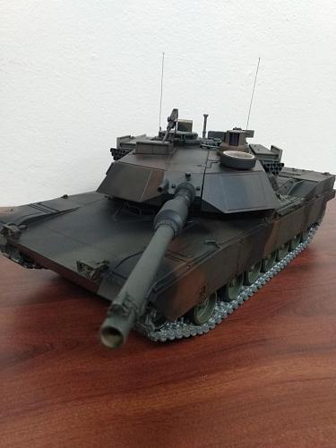

                    This is my second Abrams and decided to paint it OD green camo scheme. First time using an airbrush for the camo.
                    • #11
                      Looks the part. The NATO scheme has always been a bit soft so it's great for a person who is learning to use an airbrush.

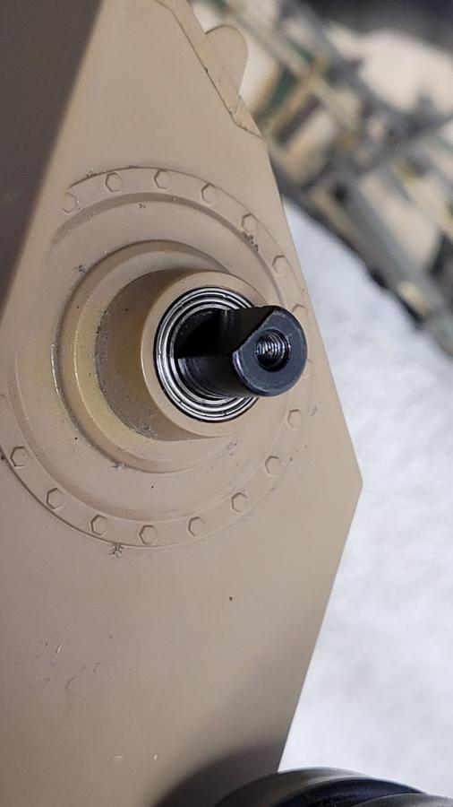

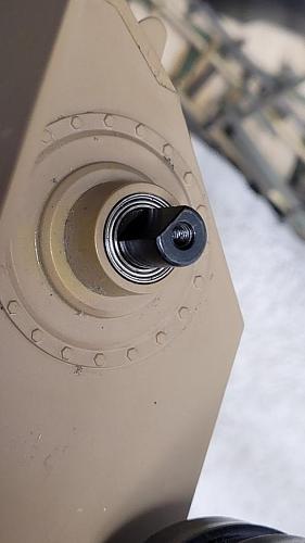

ID:	395863 Click image for larger version

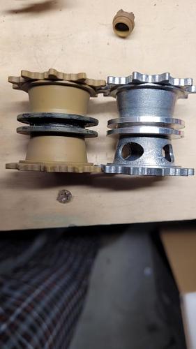

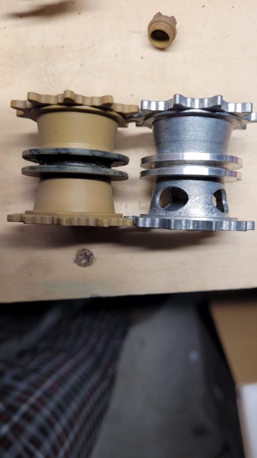

ID:	395864 So we got the sprocket and idler wheels, and the drive axle bearing kit. I over paid for the bearing kit because it had two metal hubs I didn't realize weren't needed, could have bought a dozen bearings locally for that price, my bad.
                                  The sprocket and idler wheel (from Toucan) were listed for the Mato and Heng Long Abrams, the idler fits OK, wobbles as much as the factory plastic wheel because with the bushing provided, the bushing and bearings have enough room to slide end to end almost 1/16", nush need to find something suitable to use as shim between the bushing and the screw head to fix that I think, the sprocket on the other wasn't right, the center guide was way to narrow, contacted Toucan and they confirmed the sprocket was for Mato only and are sending the correct one hopefully soon. Gearbox is coming from China so by the time it gets here, I've probably have metal tracks in hand too ready to go to.

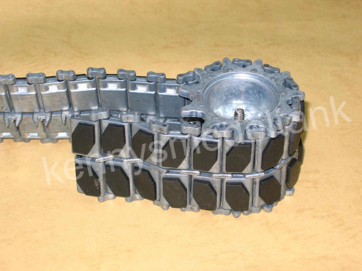

                                        At Kenny's website, the direct price is $150. I expect you would be quoted the same shipping for a $28 saving.
