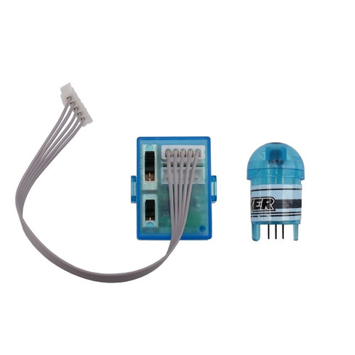

              Keep in mind, Heng Long has used two different protocols over the years. They have their HL protocol which is on the 5.3 and earlier tanks, and then they use the Tamiya protocol on the 6.x and newer. I've never used one, but there is indeed a converter to allow them to play with HL tanks using the Tamiya protocol:
              Shop large variety of RC hobbies and games at a low price Heng Long, Taigen, Torro, Mato, Redcat, Traxxas, RC Truck, RC Tank, RC Car, RC Plane, RC Boat, RC Helicopter, RC toys
              I should pick on up to test as I post this every time a person says they can't play together and everyone still says they can't play together. Actually...I just ordered one. Now I hope I have a complete Taigen system at home to test it with... :)
              • tank_me
                • Feb 2022
                • 1182
                Thinking about this, I'm wondering if this converter could be used to convert something like a Beier system. It seems to only have a 5-pin in and a 5-pin out connection. It would make sense to me that it is installed inline and literally just detects the IR pulse and then sends the Tamiya IR pulse in it's place. Only 3 pins are used for the apple and the other two are the hit LEDs. The hit LEDs are probably just passed through the board uninterrupted. I don't have a Beier system to test it with though. I supposed I could test my theory by connecting it to a Clark board. If the Clark triggered it to fire, then it probably is just detecting the pulse and doesn't care what kind it is.
                Food for thought...

                  There is one other option, if you can find one, The Mako board from RC tanks Australia is made to do exactly that, make different systems work together. I just happen to have one here, so tankme, if you want to play with it, I'll send it to you. And I won't even tease you too much about the 87 cents postage it will cost me to send it.
