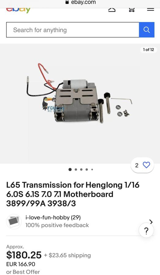

What is the meaning of L65MM vs. H65MM? Will this one work with the TD M60?Originally posted by Rubicon99 View Post

I suspect the L is for low speed gearing and H is for high speed gearing?Originally posted by keilau View PostWhat is the meaning of L65MM vs. H65MM? Will this one work with the TD M60?

The shafts length needs to be between 63mm and 65mm to be able to aline the HL Abrams sprockets accordingly on the M60.
The mounting plate takes a little thought to install, but is rather forgiving with unconventional mounting methods. If you don't overthink the install method it is actually very easy to achieve a solid installation.

That is interesting to learn. But does the motor placement also corresponds with the gear ratio? Because it does not change the overall size of the unit so I agree why the use of the lower motor position is interesting. I have a few DC units all "high speed" versions with the 540 motor on top. No one local has the lower motor arrangement, but then they also all have the "high speed" gear ratios too.Originally posted by tank_me View PostActually the L is for Low motor position and the H is for high motor position of the main 500 series drive motor. Not sure why they needed two positions. If you look at the pic above, it is at a sharp angle up. The other one which is the low version looks like this:

As far as I can see, the high or low doesn't affect the gear ratio as it's shown on the Toucan site on both the High and Low versions as the same ratio like this:Originally posted by Rubicon99 View Post

The all metal (metal gear, metal case) dual current gearbox is priced at more than another tank as the link above. The metal gear, plastic case version is about half the price. ($234 vs. $133) Any reason not to go for it?Originally posted by tank_me View PostAs far as I can see, the high or low doesn't affect the gear ratio as it's shown on the Toucan site on both the High and Low versions as the same ratio like this:

All of mine are metal gears with plastic cases. So are all the others people in the local clubs. Never seen any issues with them. Its the plastic gear version that is questionable the case doesn't seem to matter.Originally posted by keilau View PostThe all metal (metal gear, metal case) dual current gearbox is priced at more than another tank as the link above. The metal gear, plastic case version is about half the price. ($234 vs. $133) Any reason not to go for it?
