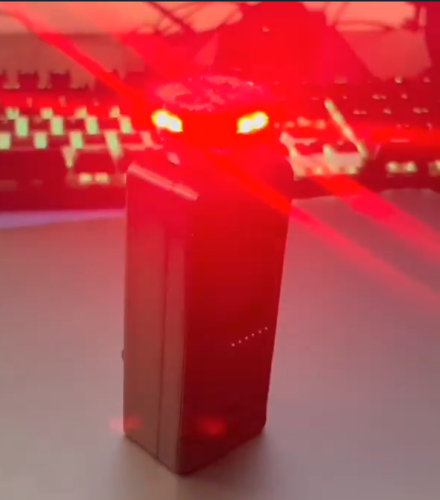

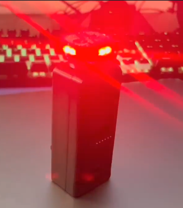

messing around with a new receiver variant, half the height of the normal ones, less prone to receiving reflected shots (at the cost of ~20% range).
so far prelim testing shows that the range reduction doesn't significantly affect gameplay as long as you have an upgraded ir bulb, under noon sun we're going from ~150ft down to ~120ft.

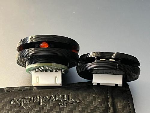

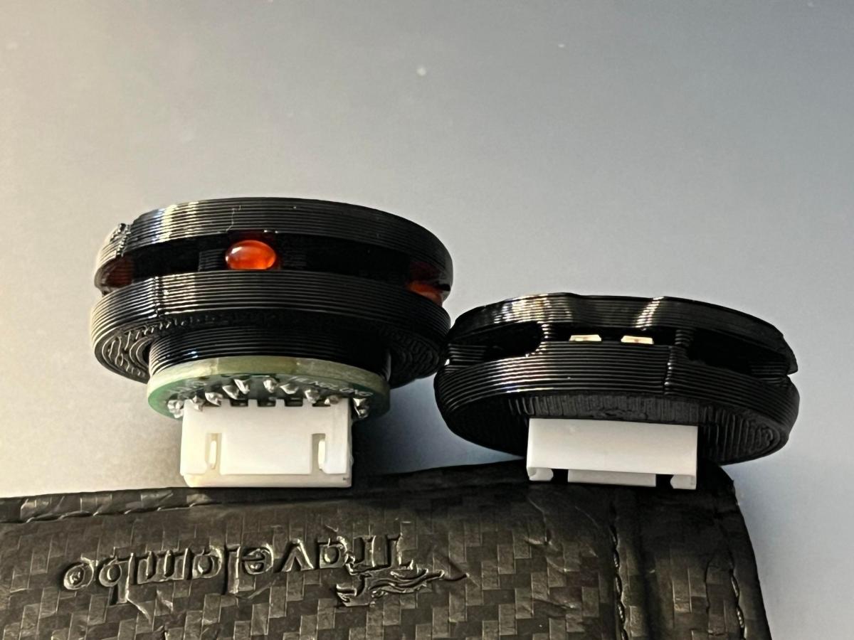

left normal variant, right new variant. notice height difference
lights are a little blinding...
