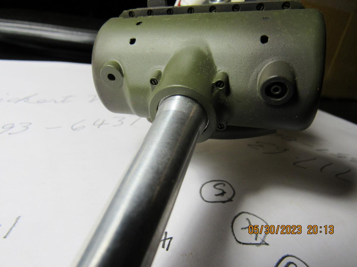

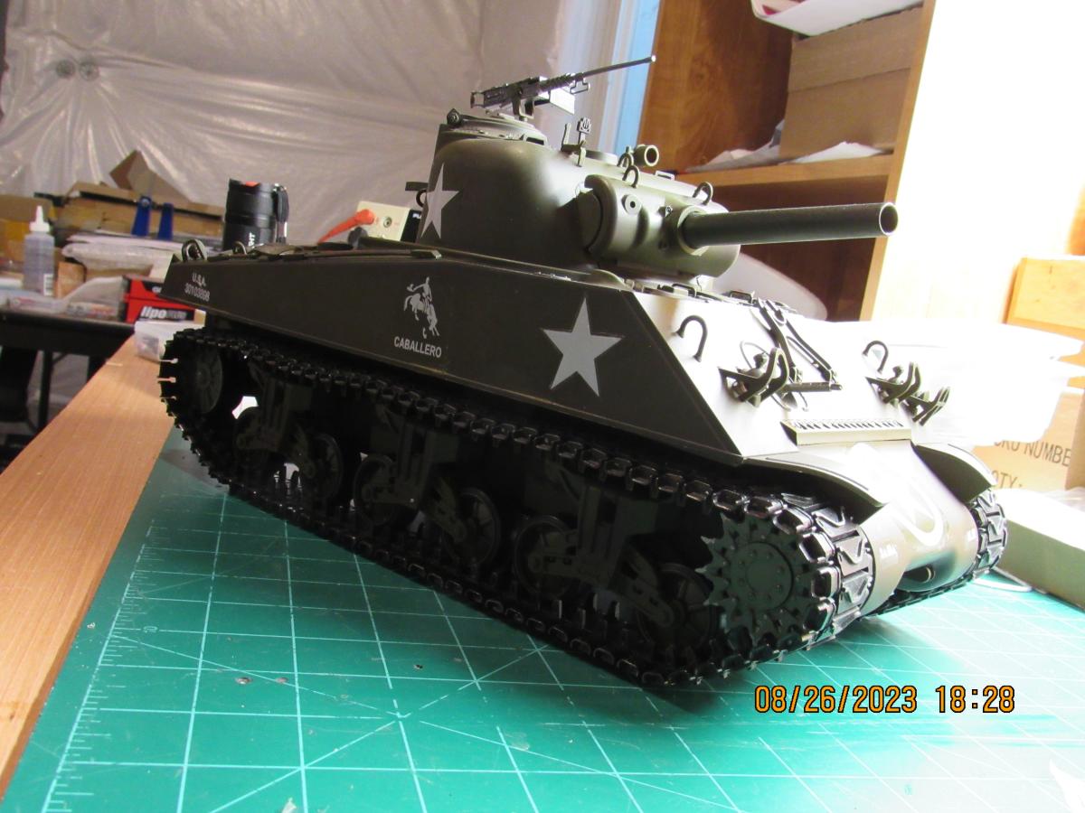

I added barrel recoil feature to a M26 Pershing and a M4A3 Sherman, both of which have the plastic barrel molded as part of the mantle. I used Heng Long tank specific "metal barrel recoil BB shooting kits". It is easier than building my DIY servo recoil and the result is pretty good. The Pershing metal barrel is painted in a brownish olive drab which is different from the dark green olive drab on the 2005 Pershing. The Sherman barrel is bare tuned aluminum. My last step is to get both painted to the matching Heng Long tank color.
I applied 3 coats of Kryton Colormax Italian Olive. Don't apply model paint to aluminum directly because of poor adhesion. Then, I brushed on a layer of Tamiya Xf-58 Olive Green. It is still more greenish than I would like, but the flat finish is much more flat than the Kryton spray paint. Thus, a better match to the HL olive green color.
