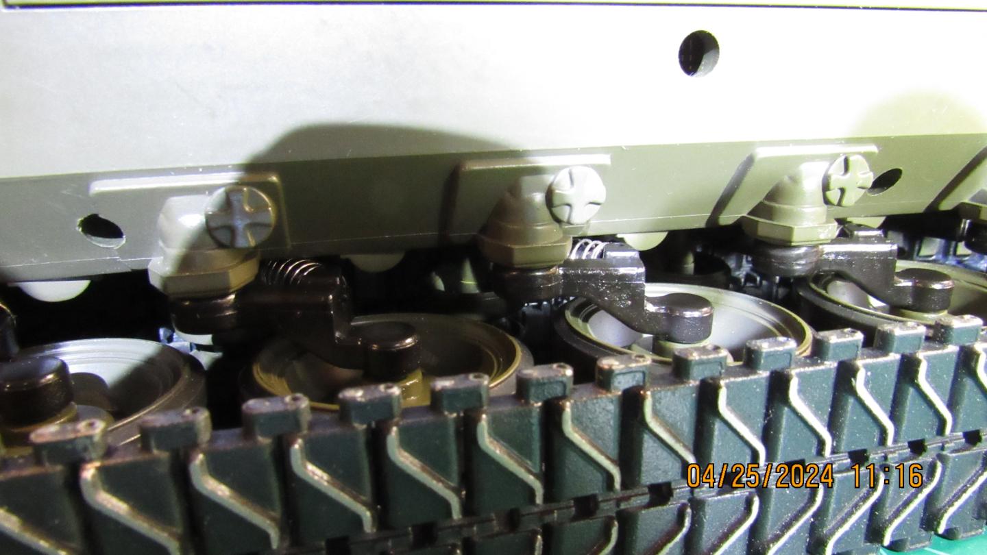

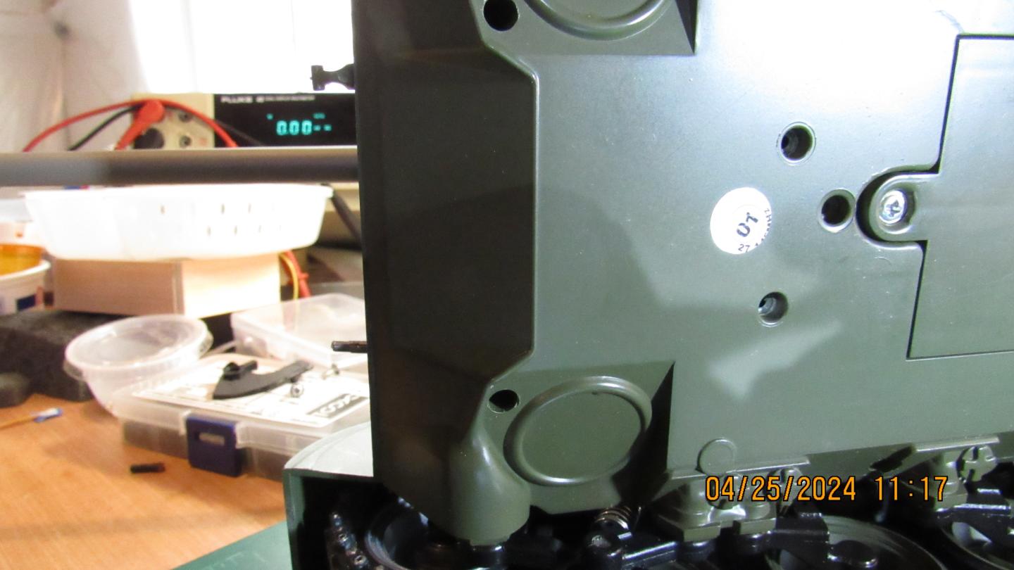

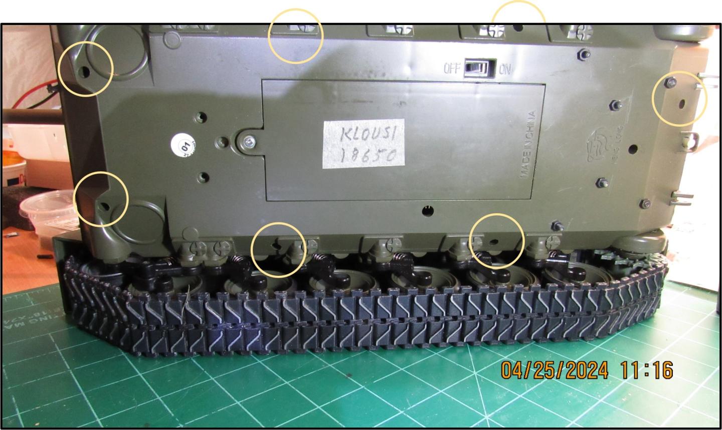

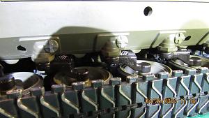

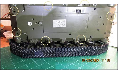

        I have a 2005 Snow Leopard which is officially the US Army Pershing. You must have a fairly old model because Heng Long changed the package label to Pershing in later release. The Snow Leopard has 7 lower/upper half screws. 4 of the screw holes are hidden at the slope side of the bottom, 2 in the front and one at the rear middle. Use only high quality Philips head screw driver and make sure to secure the screw head before turning.

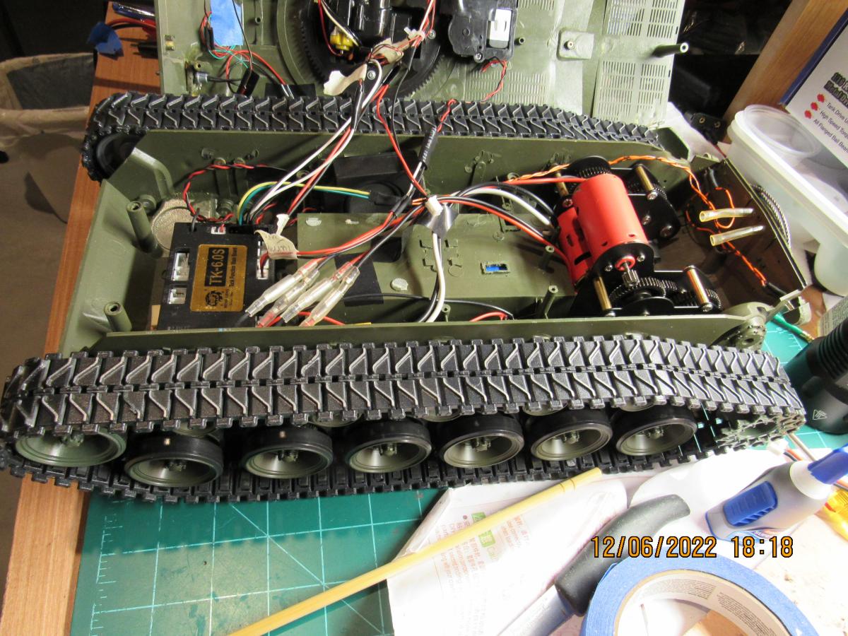

        I do not recommend 390 motor upgrade without the TK-6.0 or higher motherboard MFU. You can see the motor upgrade I did in Post 26 of thus thread.
        A quick diversion from my other projects. I'd seen Rubicon99's Tamiya Pershing and I liked it's look, specifically the lack of "skirts". Toucan was selling a Heng Long static kit, and fortunately I have a buddy who is upgrading his MFU's so I have a line on HL 6.0's. I don't know this for a fact, but I don't think HL
