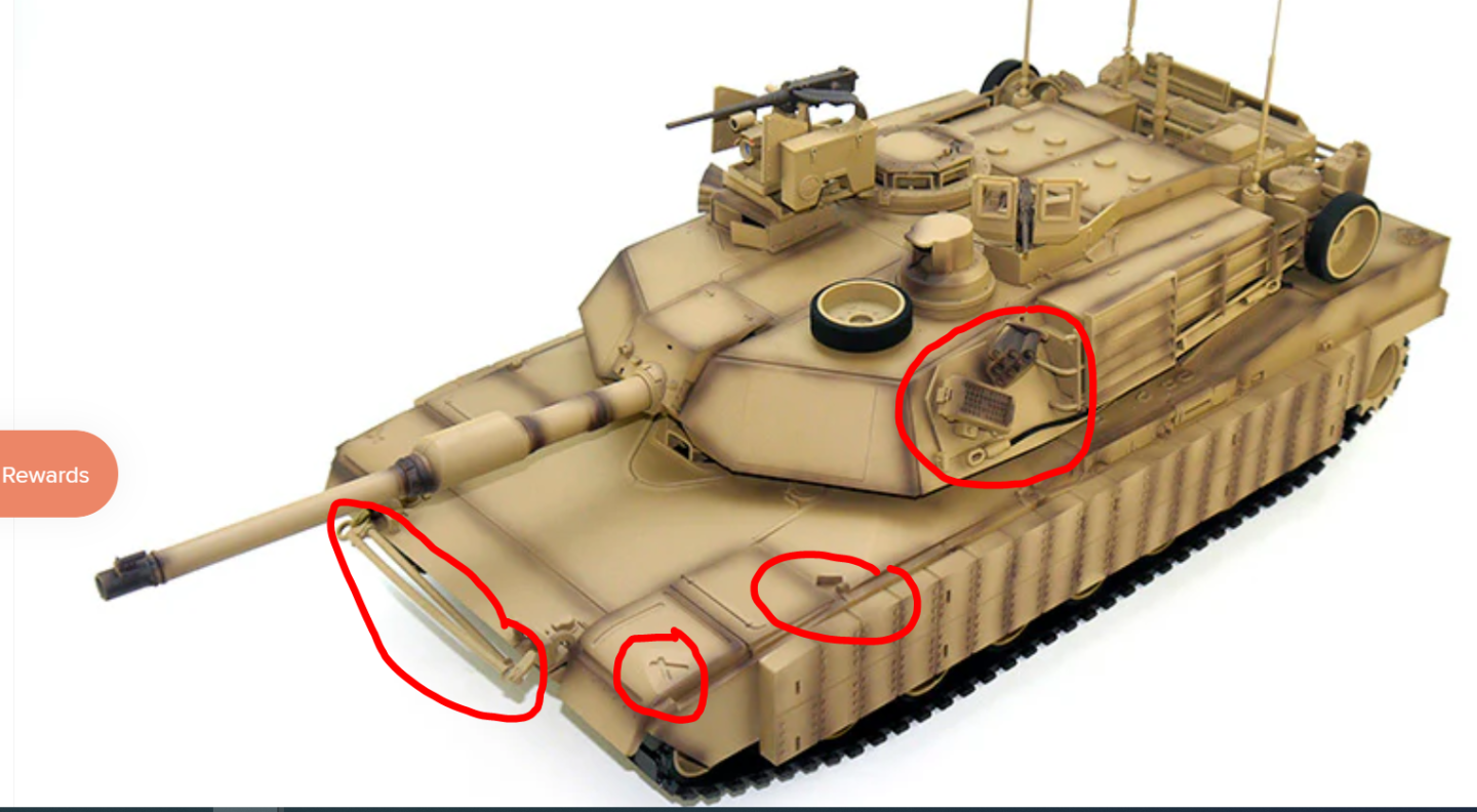

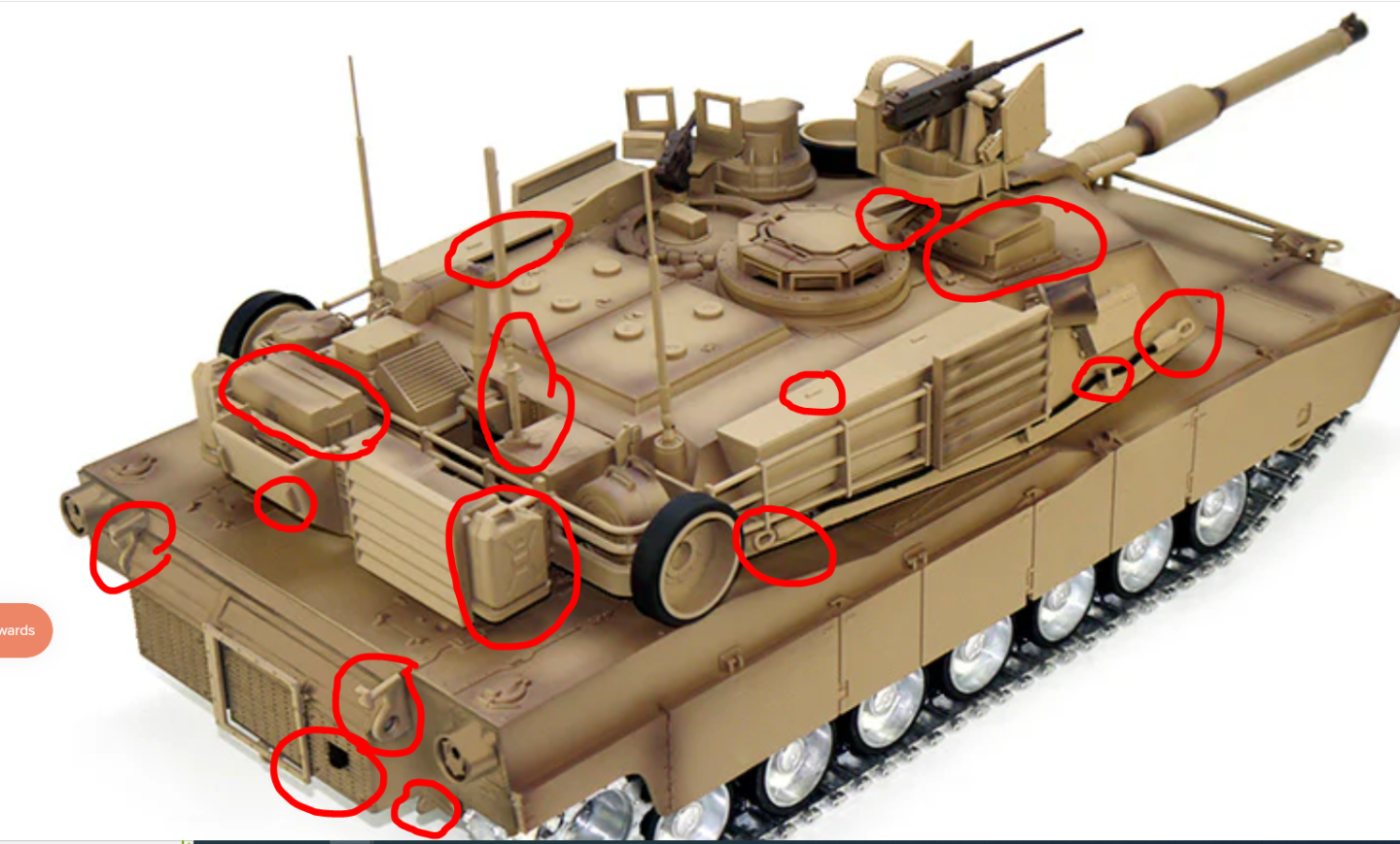

  • tank_me
    Honestly, looks like a bad HL clone. Did you see the external power button coming through the rear grill? All of the red stuff is either poorly molded, completely wrong details, or missing detail. I watched the video from Toucan and it didn't have the Abrams turbine engine sound either. The CROWs is worse than the HL upgrade version, it's missing the actual towing eyes by the headlights, it's missing the footman's loop on the front of the tank sides, both the extended bustle and the regular bustle look really bad, the rear grill is less detailed than the HL, and the side bars behind the smoke dischargers are screwy. This is just what I notice from a few minutes looking at the pics. I've never seen any internal pics of it as I don't know of anyone that has bought it.
