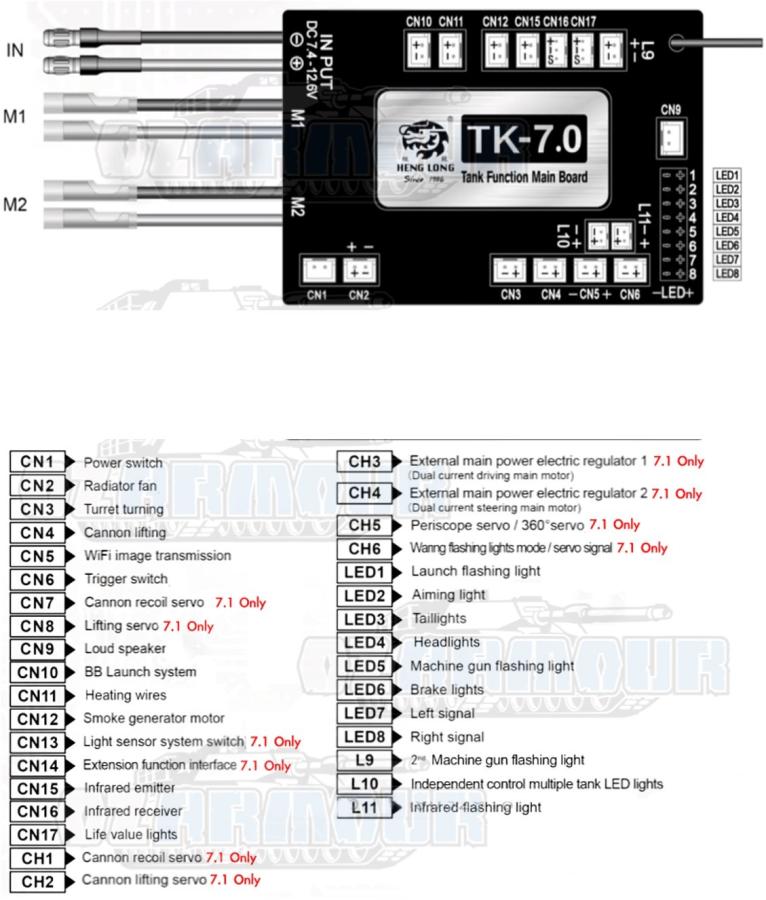

        The HL TK-7.0 manual page.

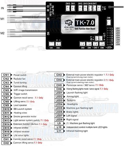

        • keilau
          • Mar 2021
          • 1815
          • Windy City
          CH17 is for an IR receiver similar if not the same as the Hooben IR receiver. It was a slot intended for an upgraded capability that HL has been holding back on.
          CH16 and CH17 are the only two 3 ports CH connectors on the TK-7.0 MFU. It is logical to assume that they serve similar function of IR receiving. The question is whether the CH17 function is alive on the TK-7.0 MFU?
