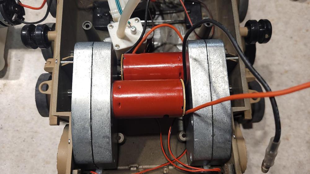

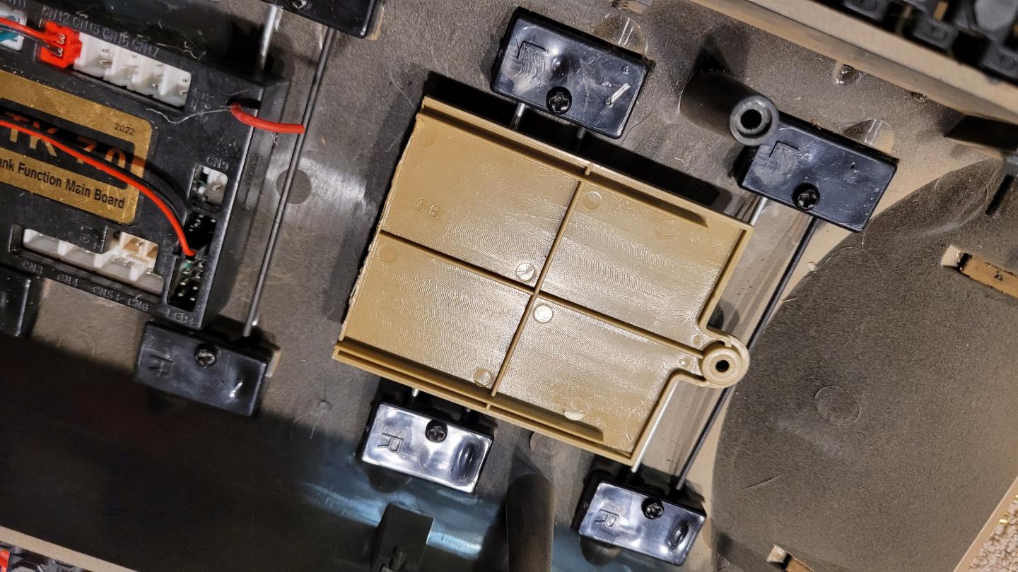

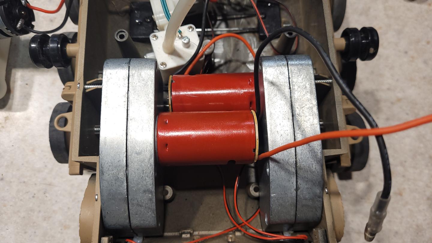

                          Got the metal gearboxes and red motors installed, plenty of room... Click image for larger version

                            That's a lot of power for an M60. It's going to be fast...really fast!!

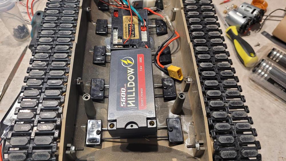

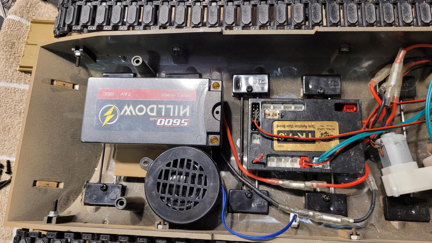

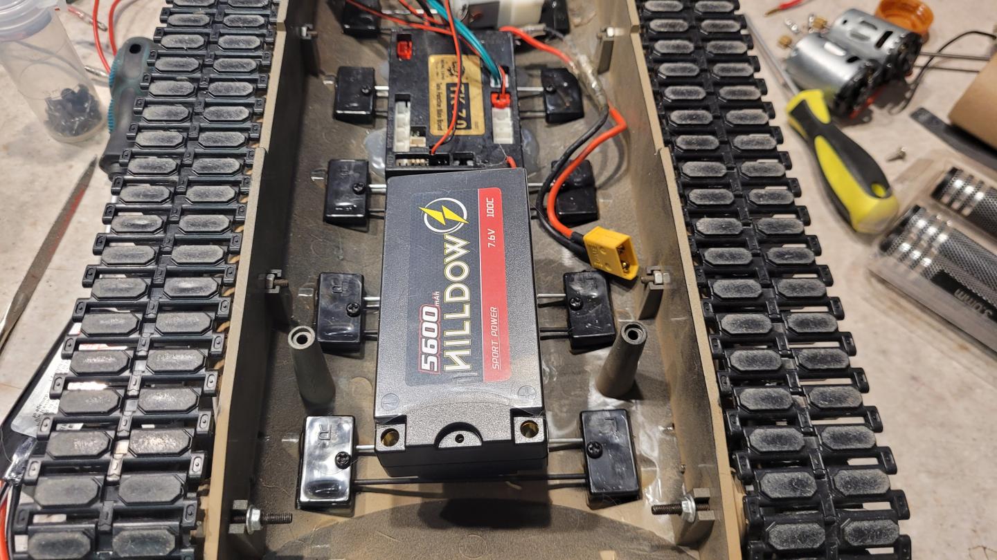

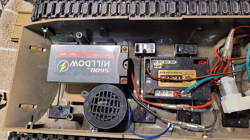

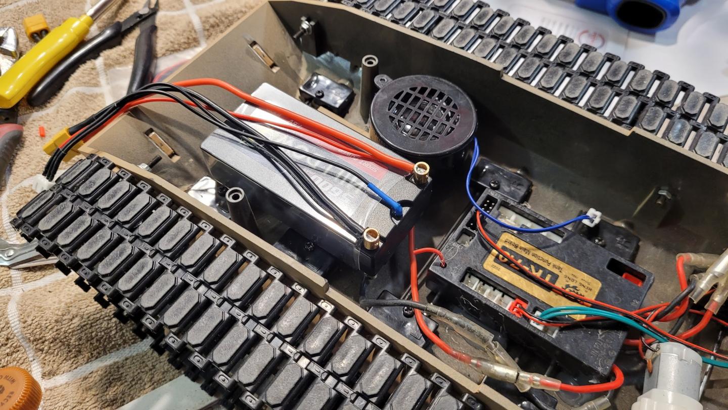

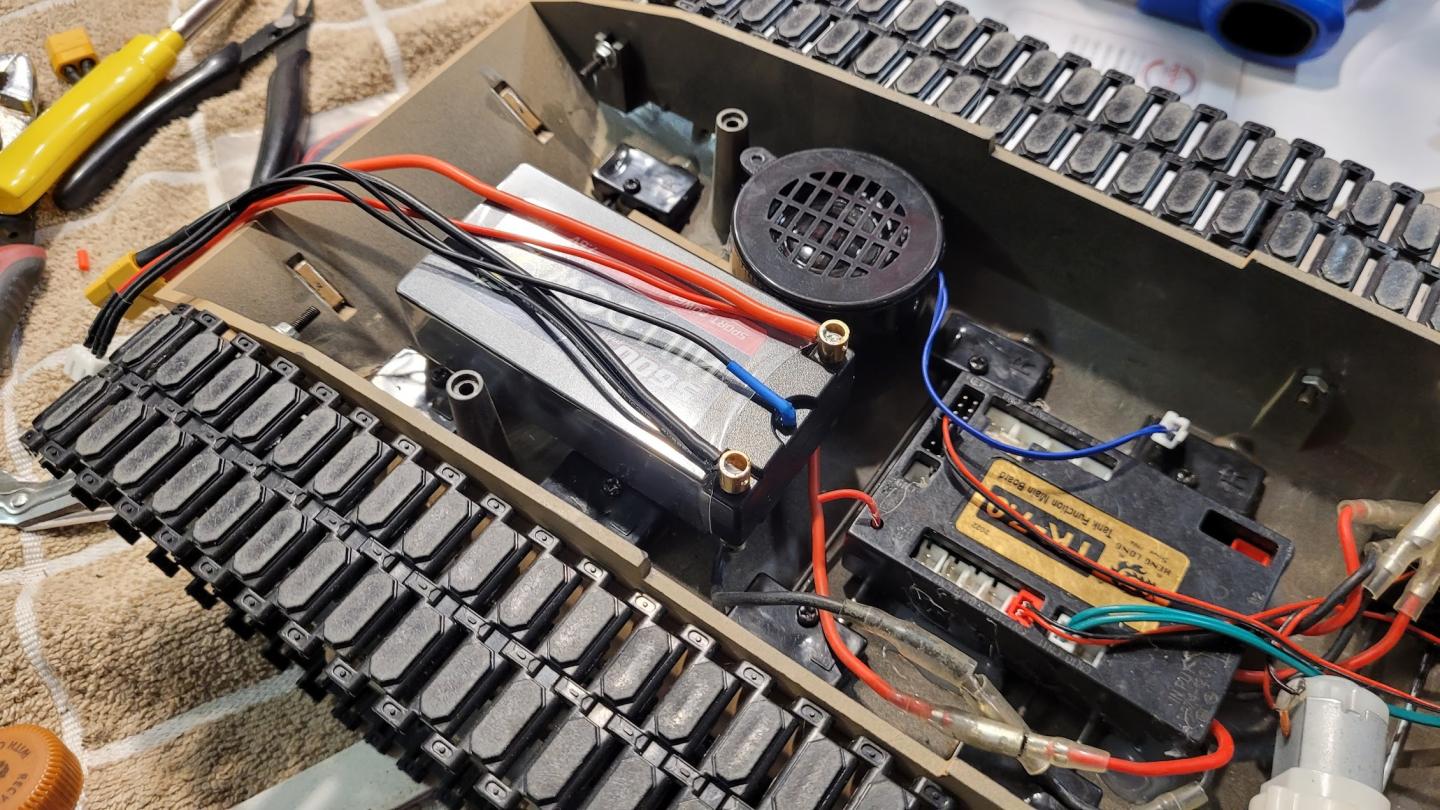

                              This is the 2S battery I plan to use, if all goes according to plan I'll run the power leads to the controller from the bottom and the charging lead from the top, it uses 5mm bullet connector I can shorten so that two will fit in one socket coming in from either side.
                              I did run the tank with the battery and new motors/gearbox, definitely quieter,more than happy with the speed

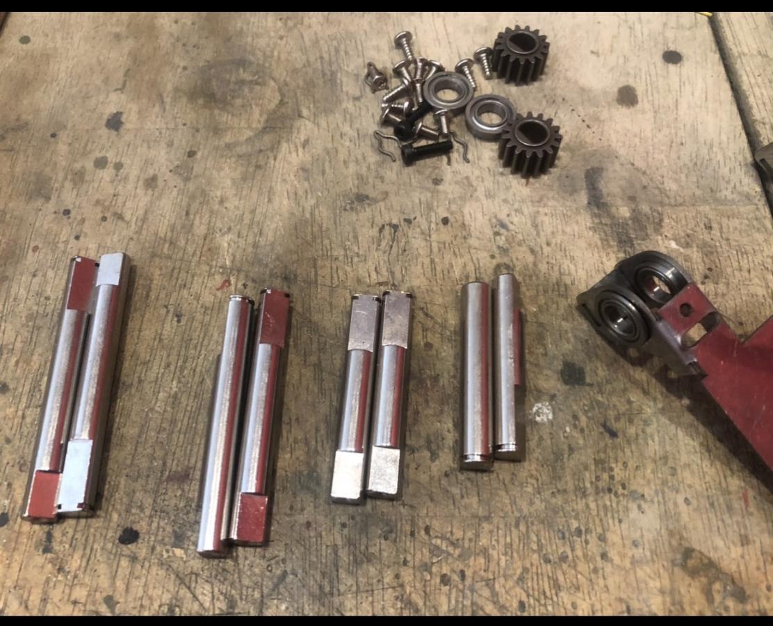

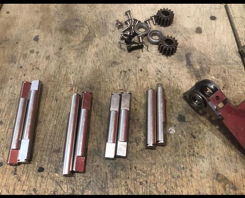

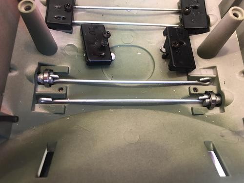

                                I know it's been some time ago, but where did you find the bearings?,
                                • keilau
                                  • Mar 2021
                                  • 1816
                                  • Windy City
                                  #56

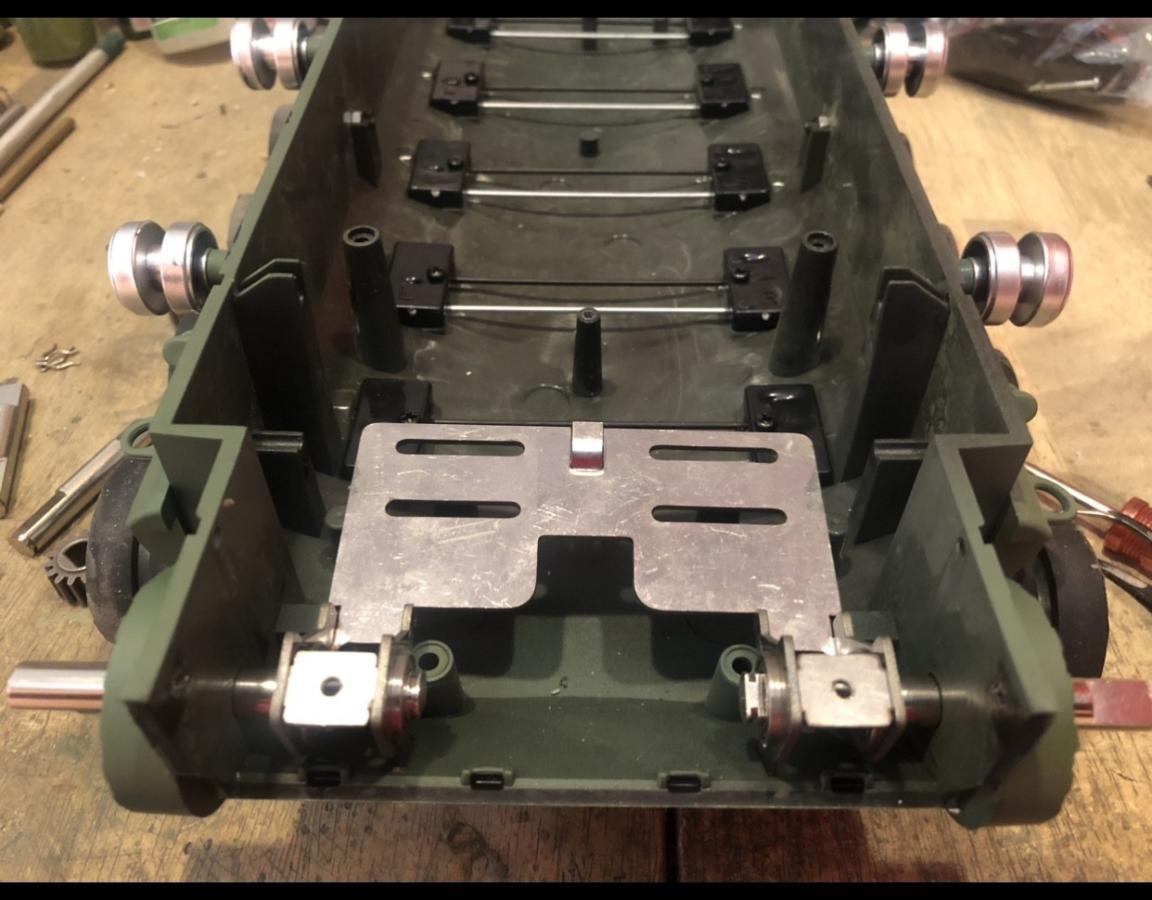

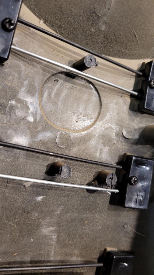

                                  I ordered the ball bearings at Amazon which are name brand, good quality, but more expensive. When you need 48 bearings of 2 different sizes per M60 tank, it can add up. You can also find no name ball bearings on ebay at much lower price.

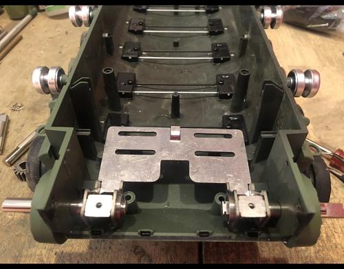

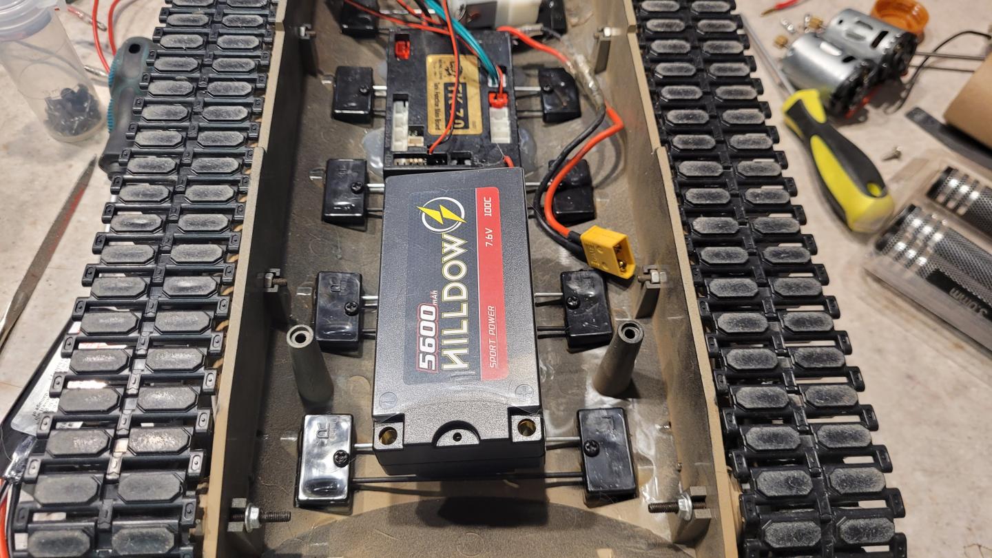

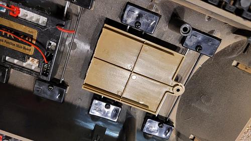

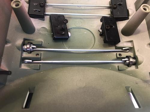

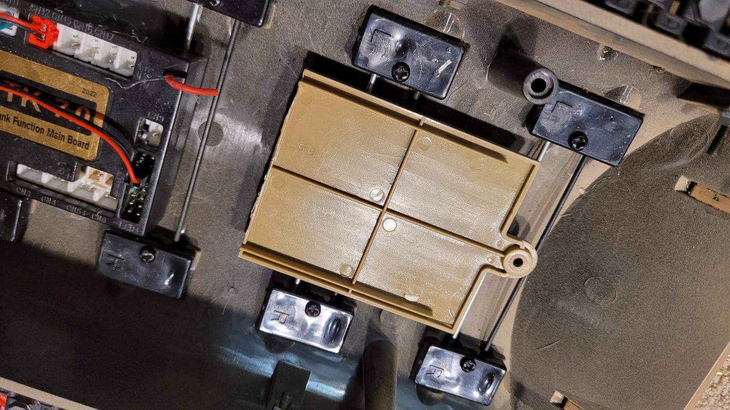

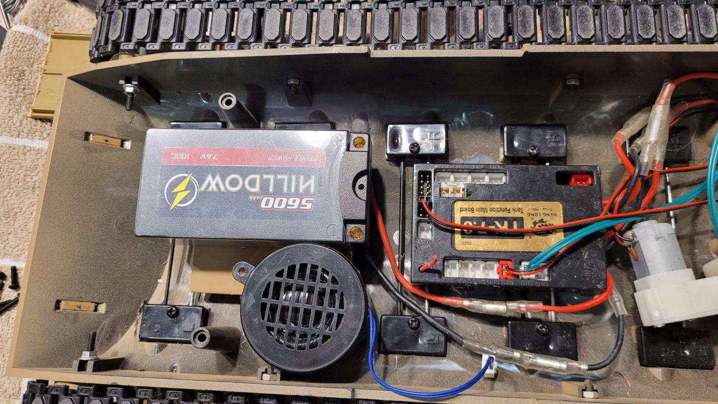

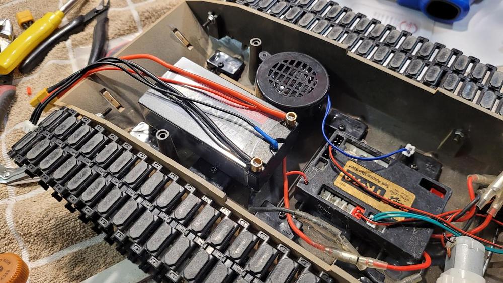

                                      So I cut down the battery and speaker mounting posts, fashioned a platform fron old battery box cover to hold the new battery and speaker, and replaced the XT60 connector on the controller with 5mm bullet connectors so I can power to controller from underneath the battery and a charge lead connected on top. Once I get the charge lead made, I'll tack everything down with a dab of hot glue to make nothing interferes with the turret but I'm pretty sure we're god.
ID:	418343 Click image for larger version
ID:	418344 Click image for larger version

                                        charge lead made, if it goes according to plan, I'll access it through the front hatch, wasn't enough room in the regular hatch for the plug to fit through, but down the road I might fit a coax plug back there

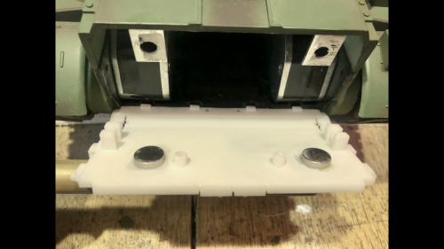

                                          Many of use simply used the rear exhaust panel with extended battery leads that are accessible through the rear of the tank. The panel is secured with magnets to keep it closed. Works great and does not affect the structure of the tank.
