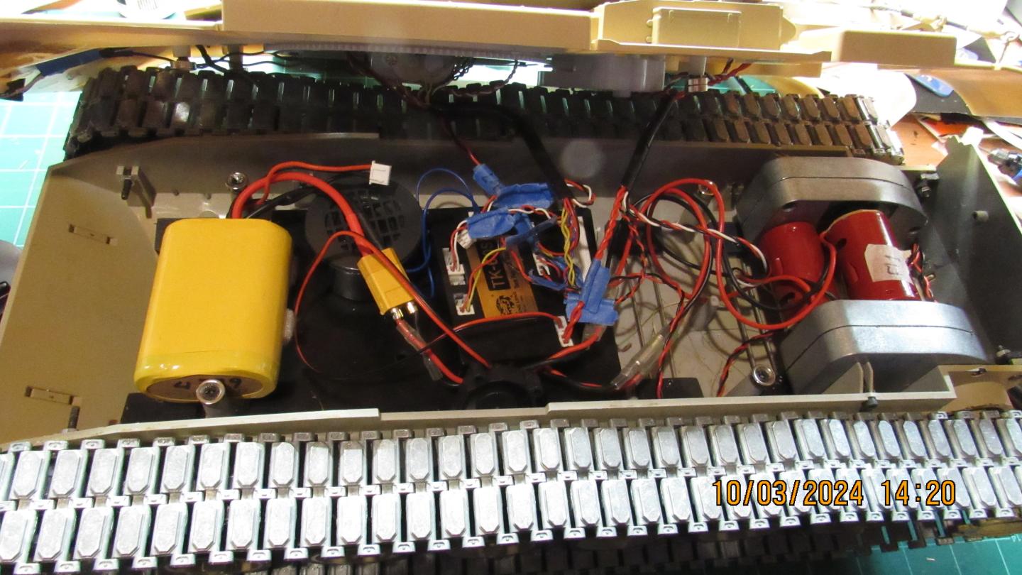

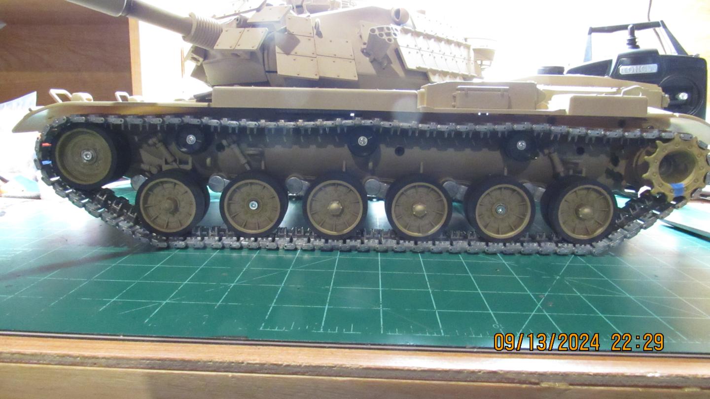

            My major concern is the tuning of the suspension spring or torsion bar to the total RC tank weight.
            I have an early production M60A1. The torsion bar steel is relatively weak and not a good match for a 16 pounds tank. It works very well with an 11 pounds chassis. The Heng Long coil springs are flimsy too, but a good match to their tank weight over all versions, including the professional version. HL makes their metal tracks as light as possible to tailor to the suspension.
            Most early Heng Long plastic chassis tank were only 3-5 pounds, way to light to run on rough terrain. For the HL T-34, I have to add 2.5 pounds dry weight after upgrading with the Heng Xin steel gearbox and Torro metal tracks. The T-34 runs much, much better at an 8 pounds total weight.
            This is simple engineering with a few factors and can be easily adjusted in the field.
            • keilau
              • Mar 2021
              • 1844
              • Windy City
              #26
              Originally posted by tank_me
              I like my tanks heavy...I want them to crush little kids toes when they run them over... :) Seriously though, I like them heavy. Modern batteries don't have an issue with decent run time and the weight eliminates the bouncing over rough terrain. Sounds like a perfect tank for me.

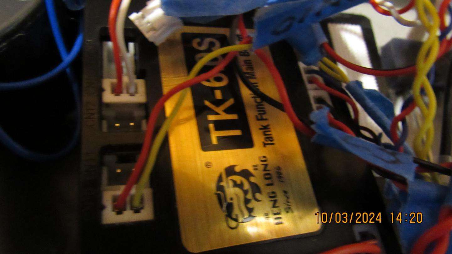

              I use high capacity Lithium Ion battery packs. (DIY 2S26650 or 2S2P18650 with 5000mAh or 3500mAh cells.) I use a SkyRC iMAX B6 charger for capacity measurements. The battery easily supports a full day's run (6-8 hrs) without recharging.
              Yes, a heavier tank with dual current gearbox and 500 series motors should drive much more realistically over rough terrain, grass or hard dirt. I have not yet, but may try that one of this days!! For now, I am very happy with the metal track TD M60A1 as my best all purpose runner.
