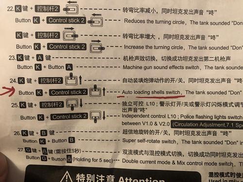

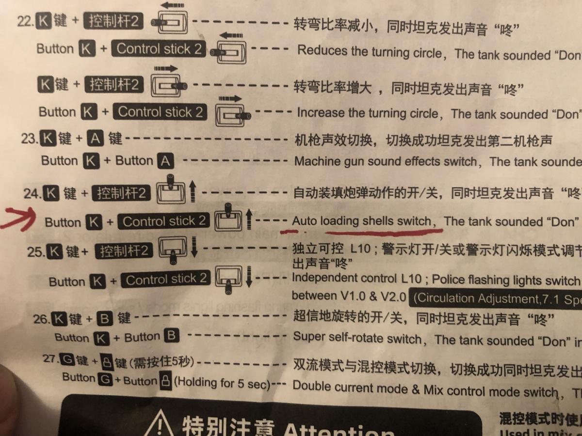

    My friend installed his barrel elevation using the servo that connects to CH2 on the HL 7.1 board. After he fires the gun, the barrel moves up and down similar to the barrel movement of the modern tank. He doesn't want that up and down feature to occur. How can he stop that function? Thanks!

    Its the simulated "auto loading" feature. Its in the manual on how to turn it off.

      Told him and he did it. Thank you!

        Your friend is correct in disabling the auto loader feature of TK7.1 for older tanks. In fact, not all modern MBT uses auto loader. The US Abrams is one of the non-auto loader tank.
        The German Leopard is the best known auto loader tank.
