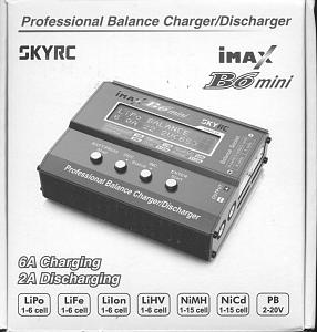

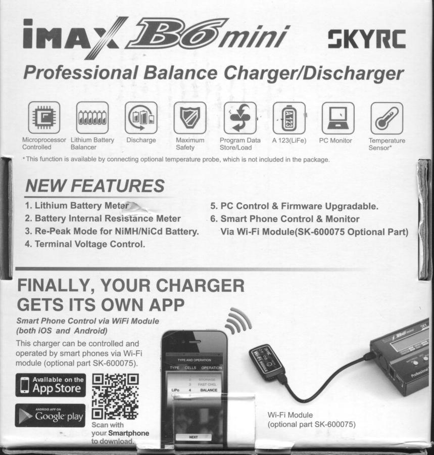

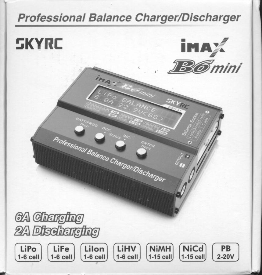

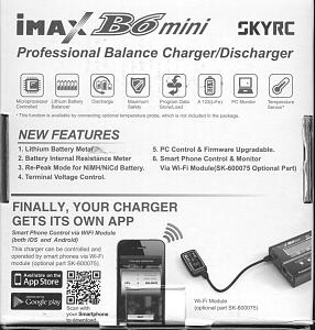

          It is important that you get a name brand smart charger with USB-C PC link. The smart comes from the charger's software. I use a SkyRC iMAX B6mini. My cheap version SkyRC may have been discontinued, but later version can be had for not much more. It is one of the best investment that allows you to monitor the condition and status of your battery packs and very fast charging.
          Click image for larger version  Name:	skyrcb61.jpg Views:	0 Size:	86.9 KB ID:	412586 Click image for larger version  Name:	skyrcb62.jpg Views:	0 Size:	109.9 KB ID:	412587
          Avoid off-brand iMAX B6 chargers which often comes with non-functioning software. The SkyRC iMAX B6mini is at the low end of quality smart charger, but more than adequate for RC tank use. If you want fancy charger, the sky is the limit.

            Surprise! Surprise! You can still buy the original SkyRC iMAX B6mini at very good price from BangGood. This SkyRC charger supports relatively high charge current (e.g. 3.0 amp at 7.4 volts for 2S Li-Ion) in a small package. It is very important to have the cooling fan that this SkyRC one does. I connect it to my desktop Windows10 PC for all setup, programming and battery status.

              I still would only charge li-ion at 1.75 amps to extend their life.
              • keilau
                • Mar 2021
                • 1815
                • Windy City
                It is a very prudent choice and exactly what I am doing with the charger.
                The Heng Long Tk7.0 MFU stops when the battery pack voltage drops below 6 volts. I set the charger to stop charging at 8.2 volts. The settings give the packs extra life cycle and still allow a full day's run using my DIY 2S26650 or 2S2P18650 packs. They are 5000mAh and 6500mAh respectively.

                  When I visited the banggood.com website recently, I found more than half a dozen of the off-brand iMAX B6 chargers​ at half the price of the original SkyRC iMAX B6mini. They have one thing in common, no PC connection for monitoring charging and battery status. Those are dumb chargers with no intelligence built in. Not recommended.
