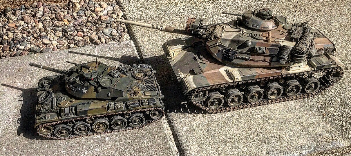

            #25

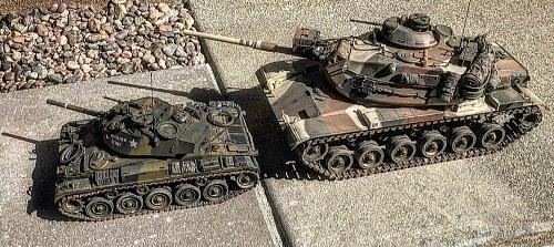

            Size comparison of M24 Chaffee to an M60 illustrates just how small the Chaffee is. Click image for larger version

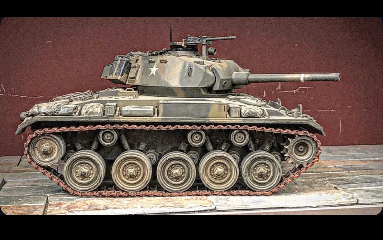

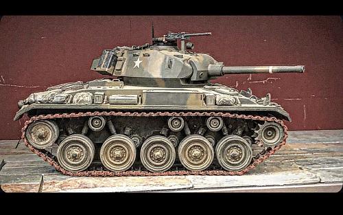

                    When you have it all opened up I would recommend going a few steps further since you are removing the side skirts and adding more torque to the torsion bars. This will lift the tank to a more accurate ride height and believe it or not it will smooth out the performance over rougher terrain. You will have to adjust the the Idler wheels for to compensate track tension for the added height but that is easy given it has adjustable idlers.
                    Mine with higher ride height after torsion bar adjustment.

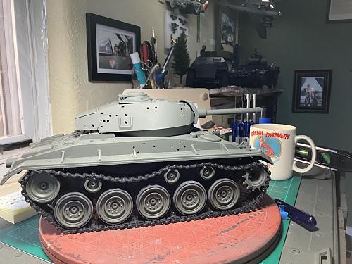

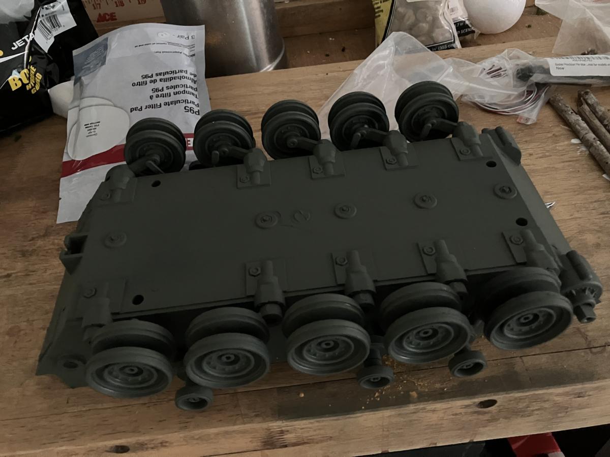

                          Idlers adjusted. Primer and base coat applied to lower hull. Question. I may be over thinking it but, how exactly do you adjust the torsion bars?

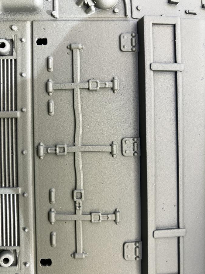

                              #34

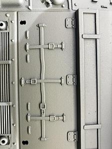

                              Click image for larger version  Name:	IMG_8472.jpg Views:	3 Size:	96.1 KB ID:	443715 Click image for larger version  Name:	m24chaffeedeck109.jpg Views:	4 Size:	72.9 KB ID:	443714
                              Hey guys. These look like straps. So far research hasn't turn up anything. Is this a cargo tie-down area? Thanks.

                                #35
                                Depends on when the Chaffee was in use. I would guess that early production used this location for the pioneer tools. I've also seen them mounted in a pioneer toolkit frame mounted on the tank's side skirts.

                                  #36
                                  Thanks Tank. That makes sense. Not much clearance to begin with. This is an easy set up to duplicate.

                                    #37

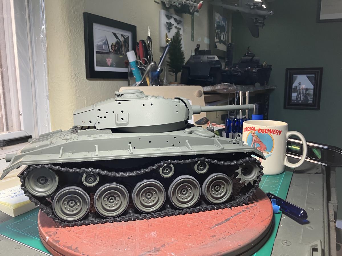

                                    Torsion bars adjusted. It was interesting as I made it more of a hassle than it was.

                                      Looks so much better with just a little more ride height👍👍.
                                      As I tell everyone working on tanks, it's only seems hard the first time you try and often not as hard as it sounds.

                                        #39
                                        Very true. I was concerned that I might twist the torsion bar too much and deform them. Turns out I had to "re-twist" as I adjusted in the wrong direction first. I did have a challenge with the torsion bar under the motors but got it sorted out. I may go for a darker paint and source out the 7.1. Thanks again for all the help.

                                          I forgot to mention you had to remove the gearbox to get to the torsion bars, but that is easy and fast. I went with the 7.1 in mine, much better driving dynamics than the TD 3.0.
