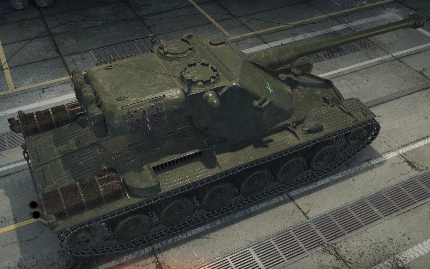

    And a conceptionalized pic of the completed tank:

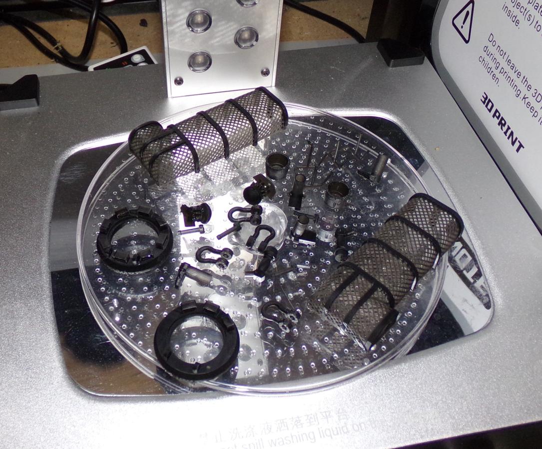

    Parts fresh from the resin curing station.

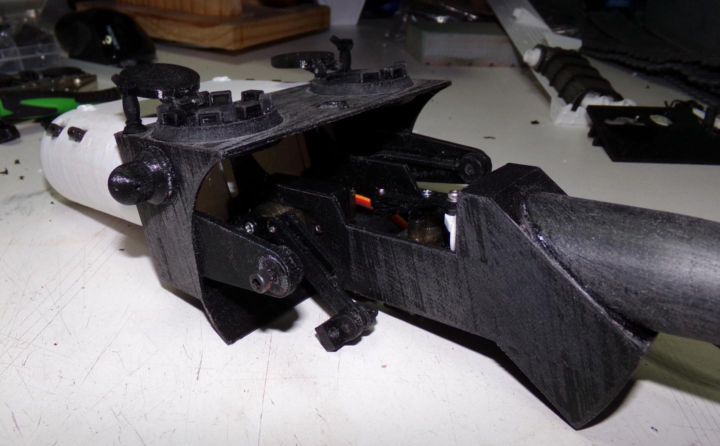

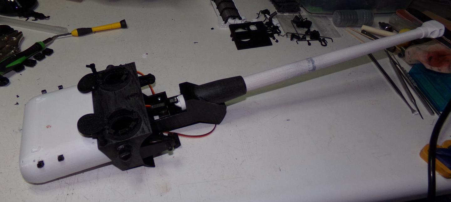

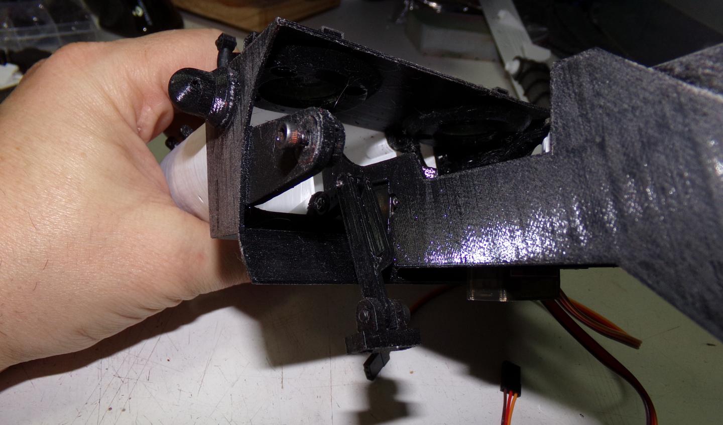

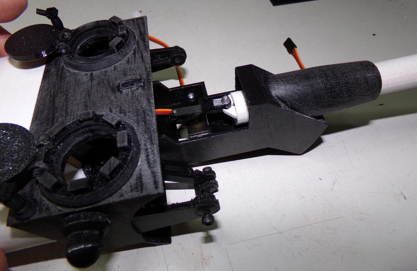

    Elevation arm and servo installed.

    Recoil servo and hatches mounted.

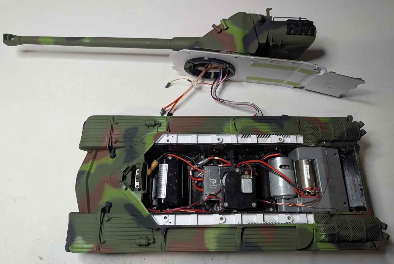

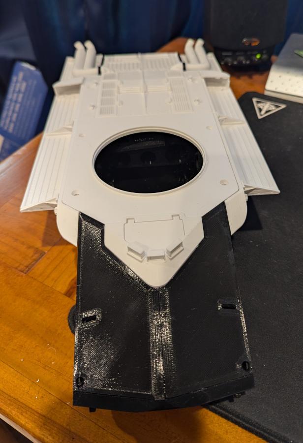

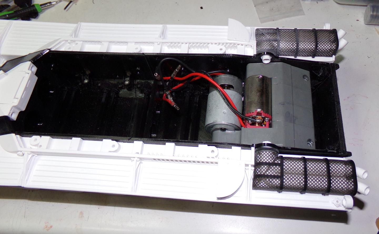

    Gearbox dry fit. I had to remove the rear brace as it didn't fit with the gearbox. The gearbox is an exact fit, no room on either side so I'd say the rear brace isn't needed.

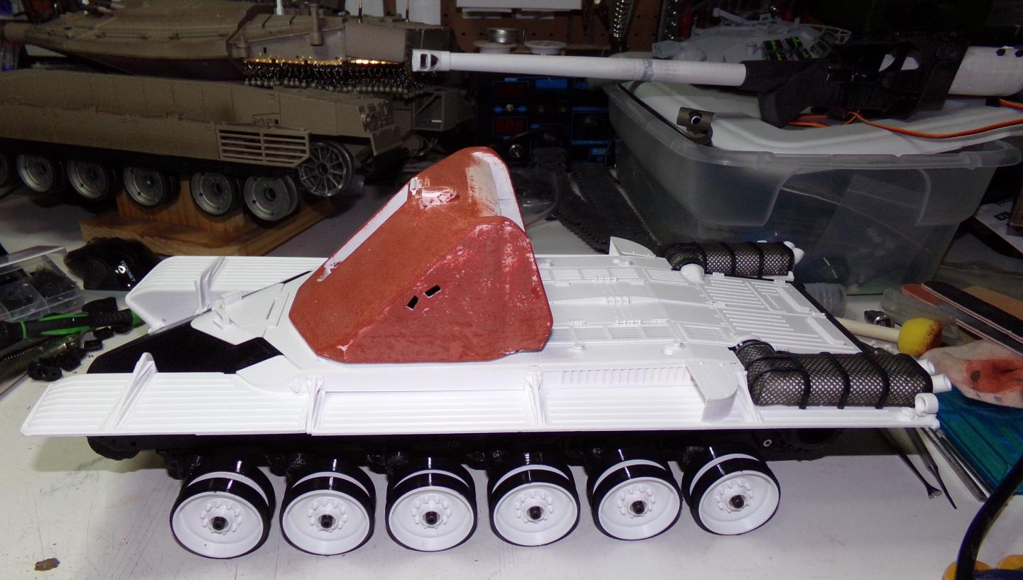

    Road wheels, suspension, exhaust covers, and front fenders installed. Road wheels were modified to accept bearings. Also started texturing the turret. I haven't permanently attached the turret halves yet as the servos need to be adjusted and a apple mount needs to be mounted in the loader's hatch. Can't really adjust the servos once the two parts are mated together and it's a bit of a pain to put them together and take them apart repeatedly.

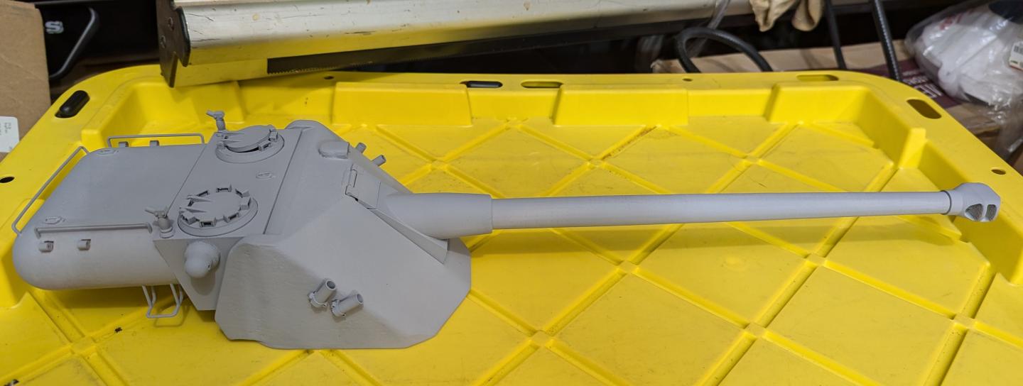

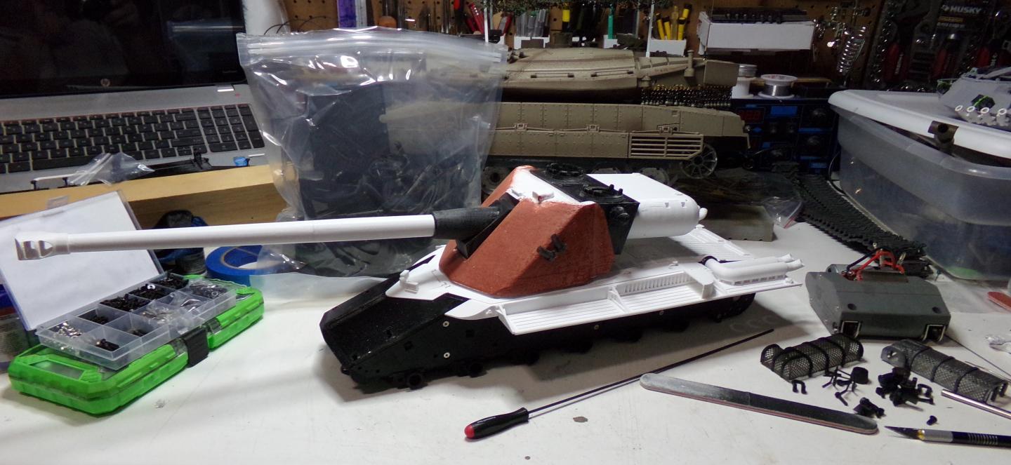

    Got the cast texture finished the turret, got all of the internals wired up/tested, added all the small details, and shot a coat of primer on it. Still needs to touch up work, but the project is progressing. The gun is 130mm so the flash LED and the IR LED both fit in the barrel. There is a battle unit mount in the gunner’s hatch.

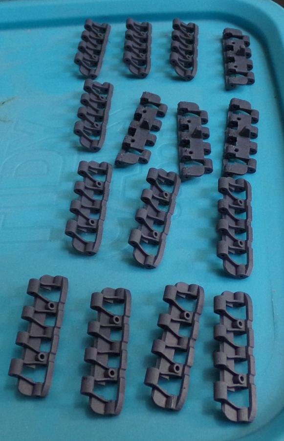

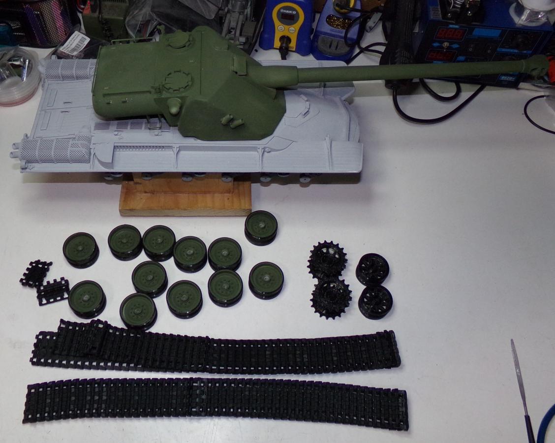

    More progress. Got the tracks all resin printed. Trying out some Sunlu Toughness resin. Seems to give the tracks pretty good tensile strength while still remaining flexible. I tried all kinds of different materials for the tracks and they were all really brittle. The tracks have some thin parts that always seemed to break. I guess we will see how they hold up.
    After assembling them I've got some black Mr. Surfacer on them. The turret and road wheels have been base coated. The hull is just about ready for base coat also after filling some screw holes it will be good to go for camo.

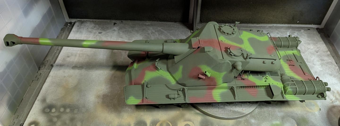

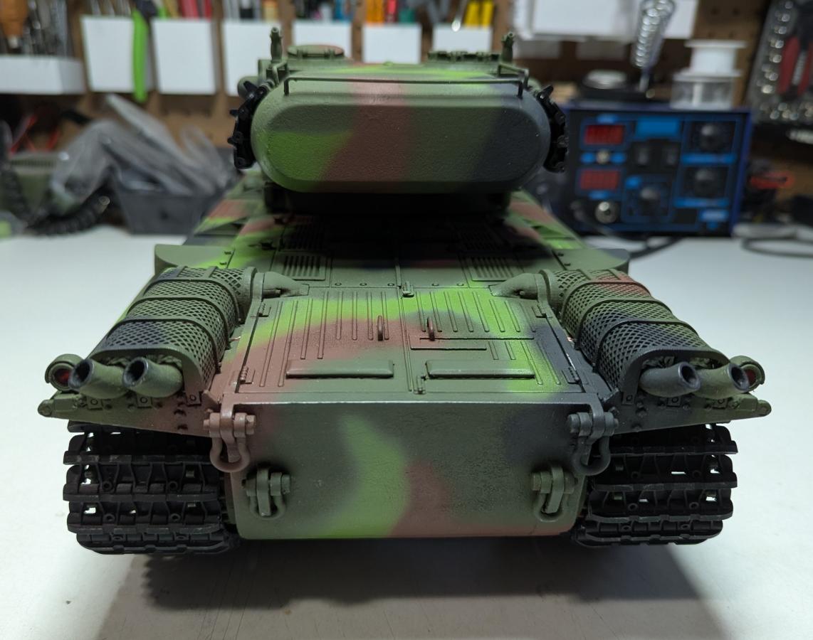

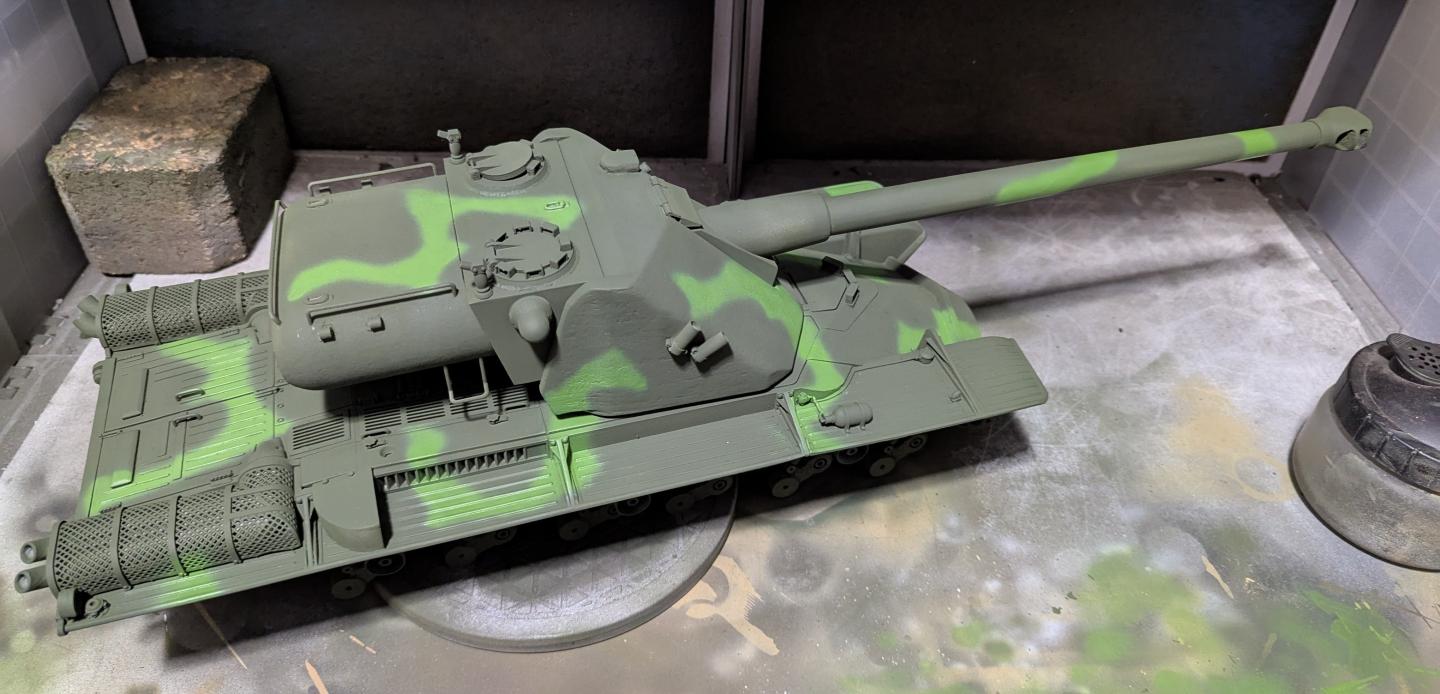

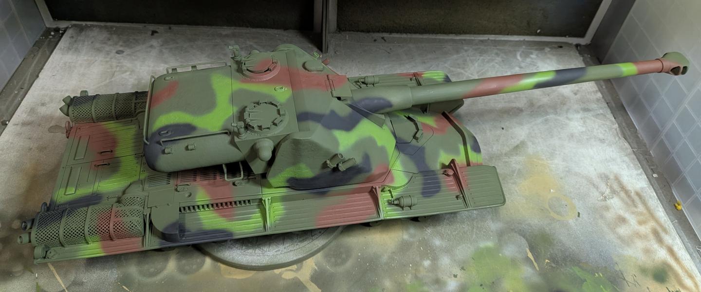

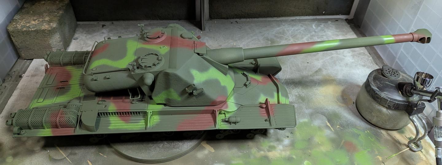

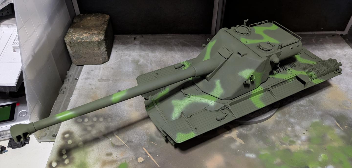

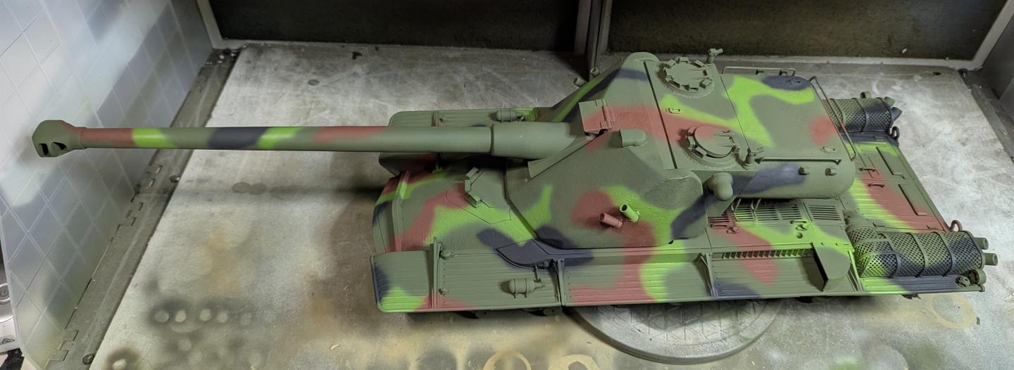

      I wasn’t completely sure how I was going to paint the Kran. The Kran was a 1950s project so it precedes the modern M90 splinter camo by like 30 years. Trying to find examples of 1950 era Swedish camo isn't easy. I have found some tanks from around that time that look like the modern NATO OD, black and brown hues. I decided to go with that with some light green added in for good measure.
      And the camo going on the tank in stages.
      Click image for larger version  Name:	Drf2gab.jpg Views:	0 Size:	111.0 KB ID:	416084
      Click image for larger version  Name:	ihyHlKW.jpg Views:	0 Size:	123.2 KB ID:	416085
      Brown added:
      Click image for larger version  Name:	QAxt5xf.jpg Views:	0 Size:	102.5 KB ID:	416086
      Click image for larger version  Name:	xgC59WN.jpg Views:	0 Size:	91.4 KB ID:	416087
      Next the black:
      Click image for larger version  Name:	e73MfbT.jpg Views:	0 Size:	106.9 KB ID:	416088
      Click image for larger version  Name:	1K9DEnO.jpg Views:	0 Size:	94.1 KB ID:	416089
      Continued in post 4…

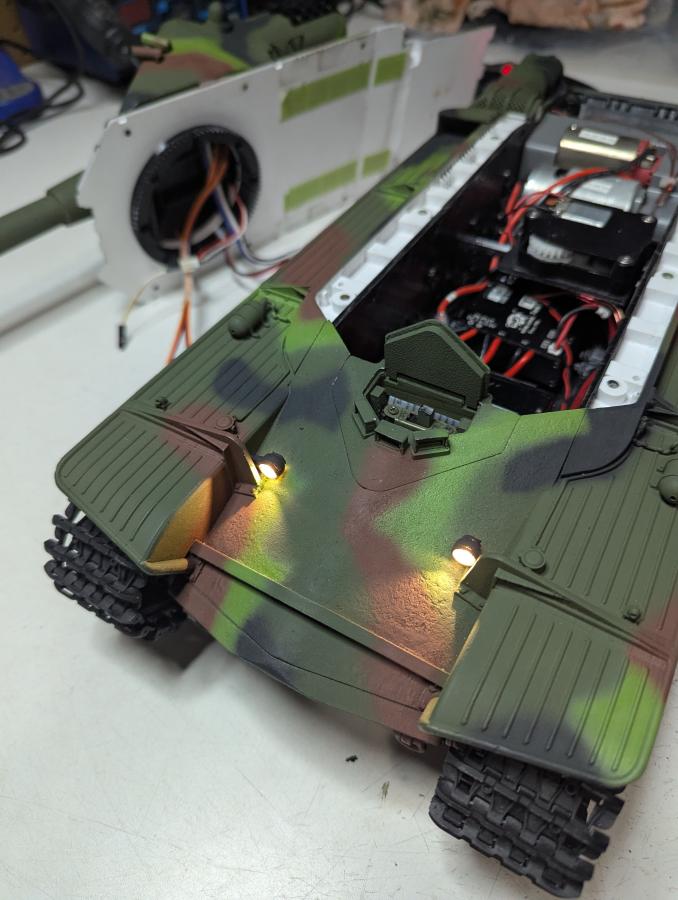

        Got the LED headlights and tail lights wired up this weekend. I used the flat nosed 5mm variety so they don't have that round end pointing out. The flat nosed LEDs look like they have lenses on them.

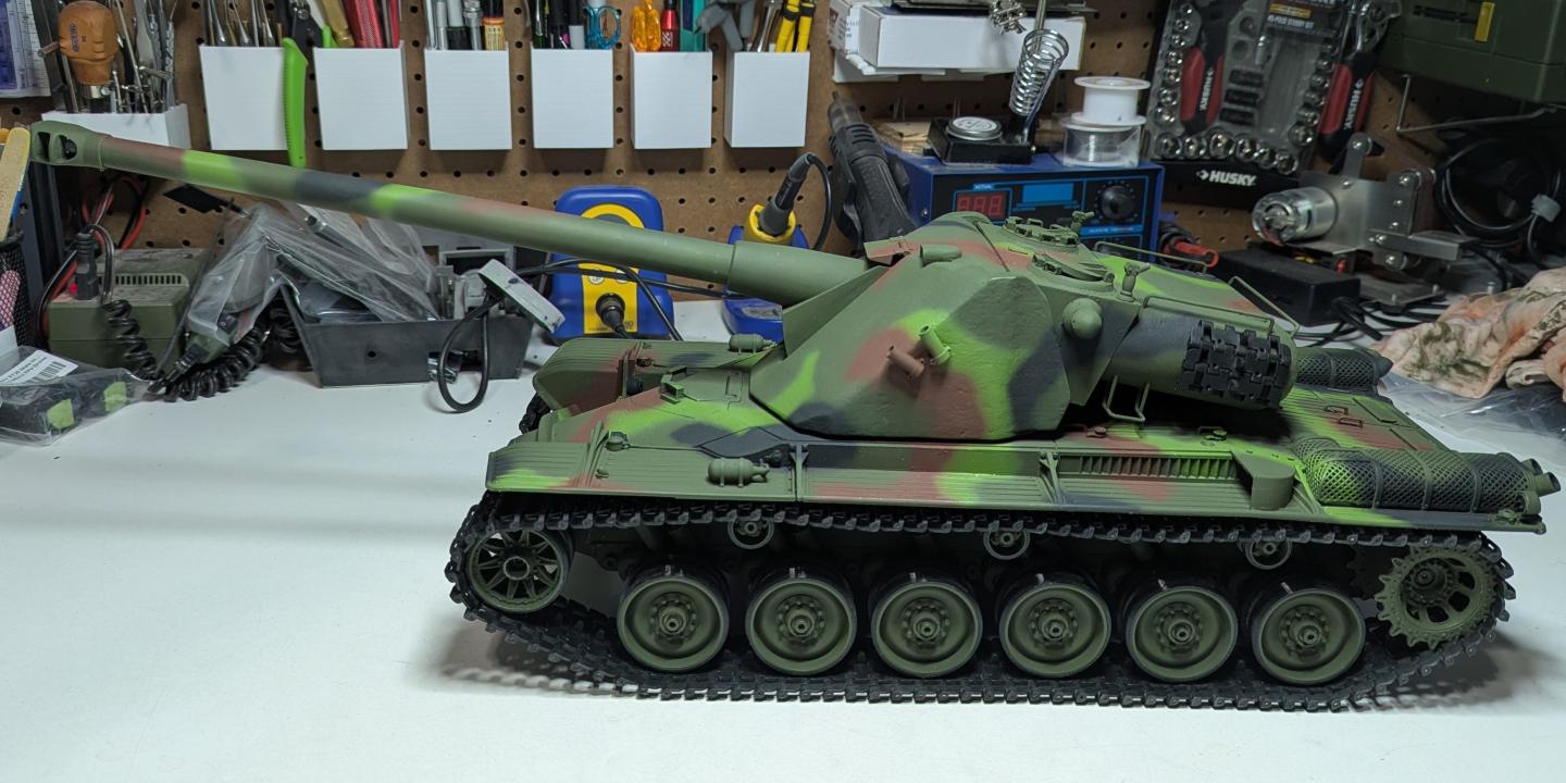

        You can see how the oscillating turret can elevate and depress:

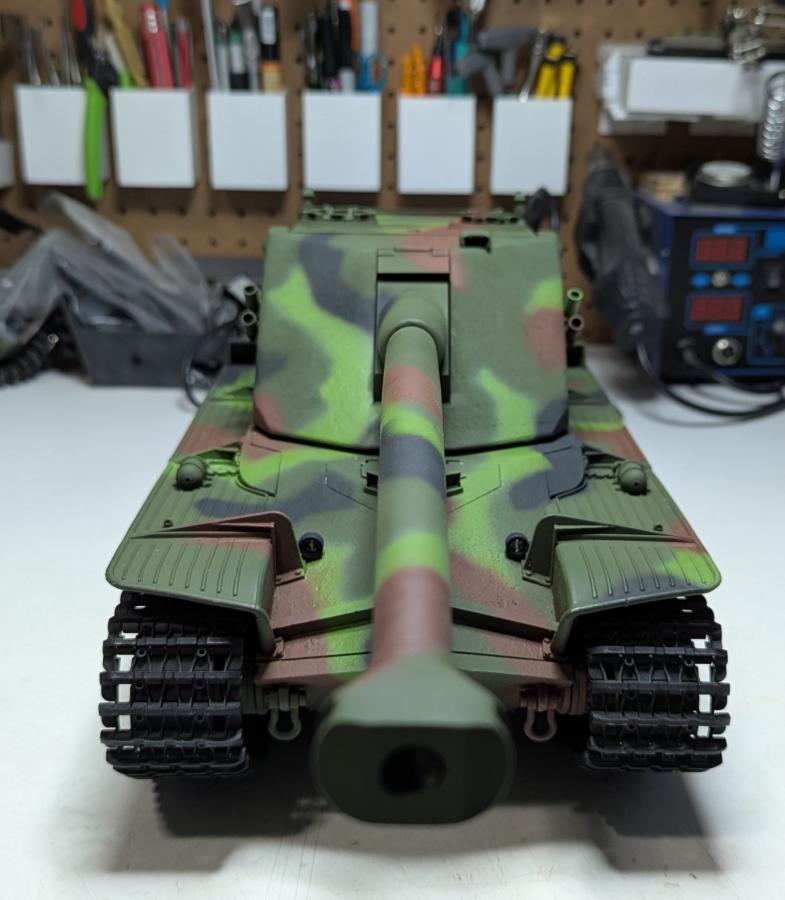

        It's getting close to being finished. I need to do some airbrush touch ups at this point and some mild weathering.

        I had it running under it's own power using a HL 7.1 system. As you can see, the on/off switch is under the driver's hatch. The gearbox is the plastic dual drive type, but the tank is pretty light so it seems to work well. It was cheap ($65.00 USD plus shipping) so I'm giving it a shot. I did have to shorten the drive shafts and adjust the flats on the shaft to fit the sprocket backspacing. There is a small Taigen speaker as there isn't much room inside the hull for a larger one. It's stuck up in the nose of the hull. Hoping to post a video of it running this week.

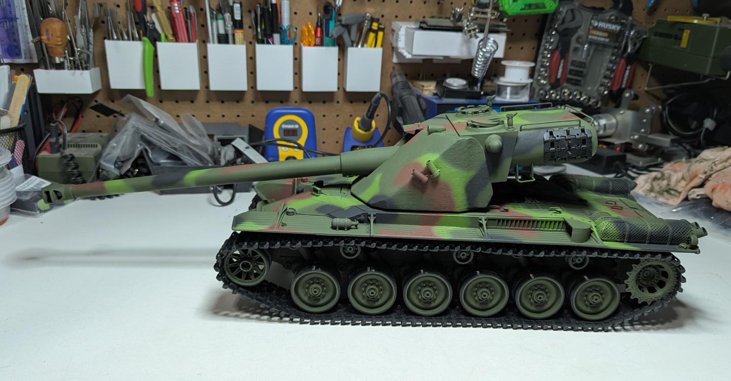

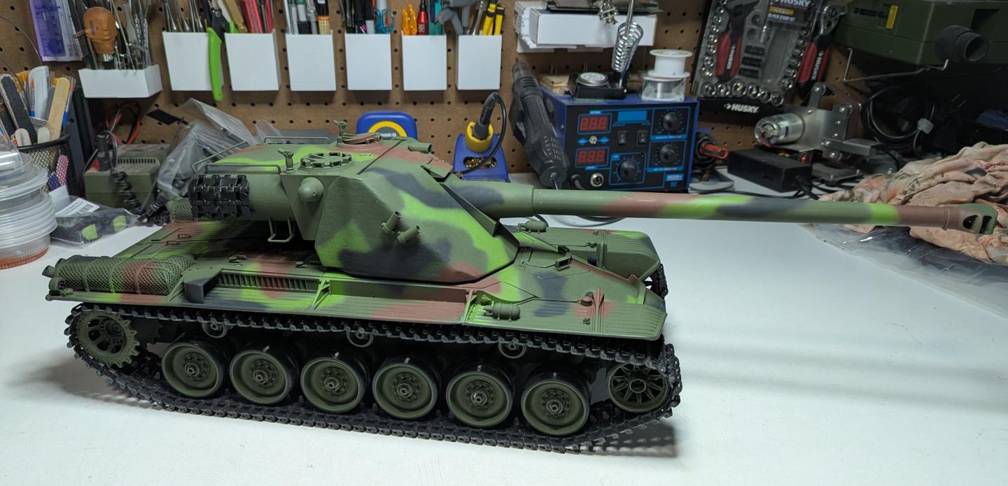

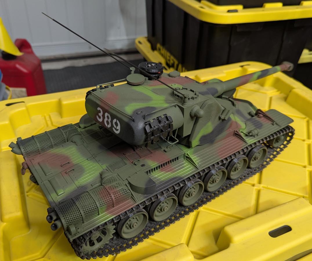

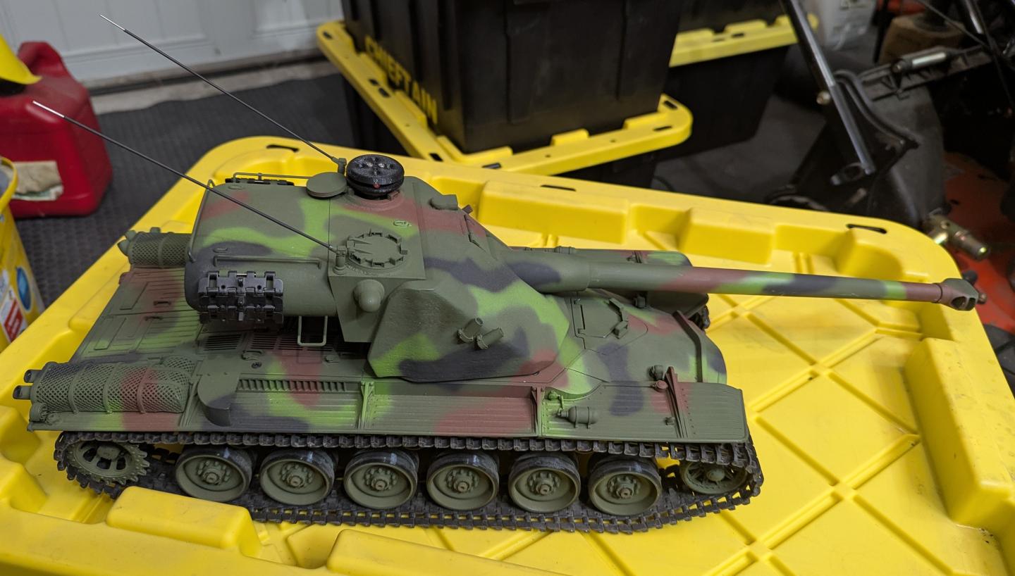

                    Well I beat the crap out of the Kranvagn today on the battlefield and it performed really well. I hit a building by accident and another user ended up on the same frequency as my tank. All of a sudden it shot forward and smacked right into an Abrams. Both incidents produced no damage. The tracks held up REALLY well. Some of the pins did start walking out after running the tank for about a half hour, but the tracks stayed in place without walking off. The Sunlu Toughness resin seems to have held up to the stresses of the battle. I will have to go back through and re CA the pins, but over all it battled great.
                    Added a tank number and some antennas.
                    Is a tank ever really done? ​
