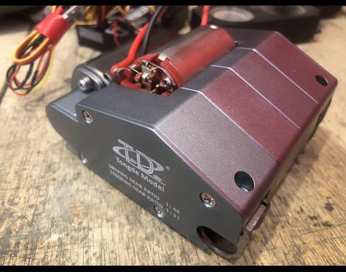

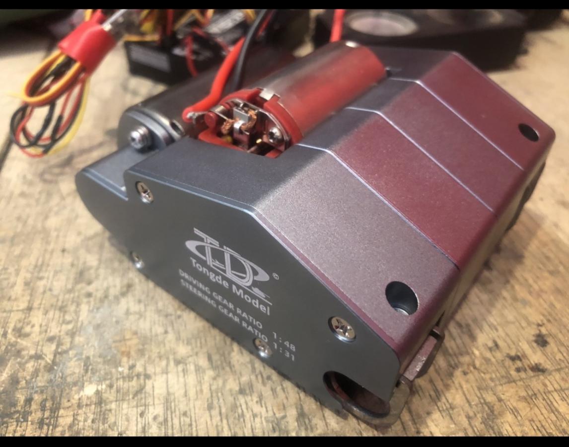

        Look at a "dual current drive" gearbox/transmission. Your 7.0 control system can run one with no problem. I run them in my M60s, super smooth and quiet. Only downside is cost they are not cheap.
        The one shown below is by TongDe but there are others by DKLMRC and Henglong.

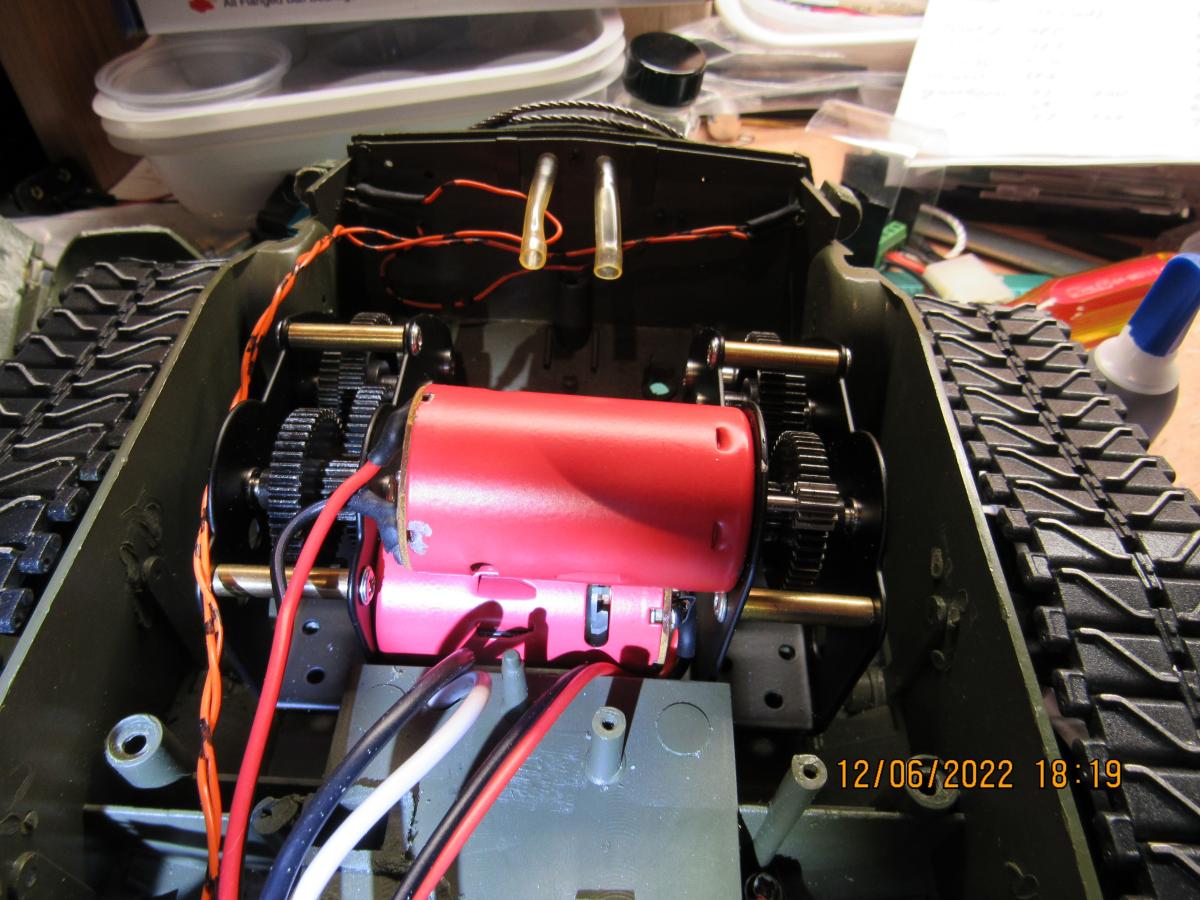

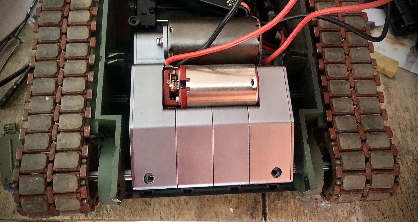

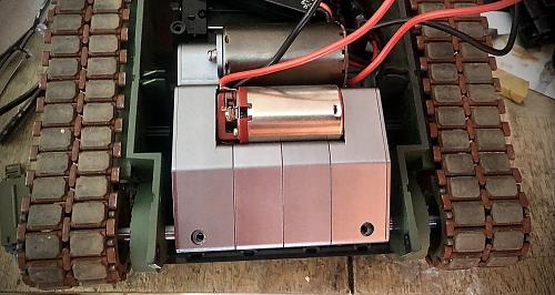

            The T-34/85 is a medium battle tank. The 1/16 scale Heng Long is kind of light weight and the inside of the chassis is very crowded. There is no need and no room for a motor shaft bearing. You can see how close is the gearbox to the chassis side wall. It is always good to get a high quality gearbox where the motor shaft is sturdy. Metal track and metal road wheel are necessary to have the optimal total chassis weight.​

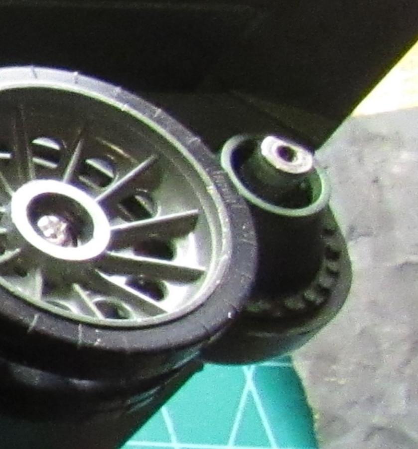

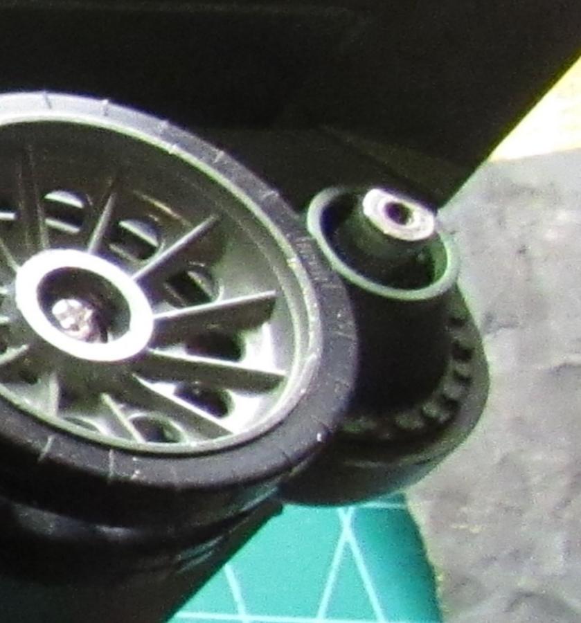

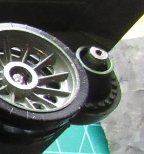

              What gearboxes are those? My T-34 has the metal tracks, idlers, drive sprockets, suspension arms, and steel gearboxes. I have added some weight to the front of the chassis using adhesive wheel balancing weights, still seems too light for how firm the suspension is.

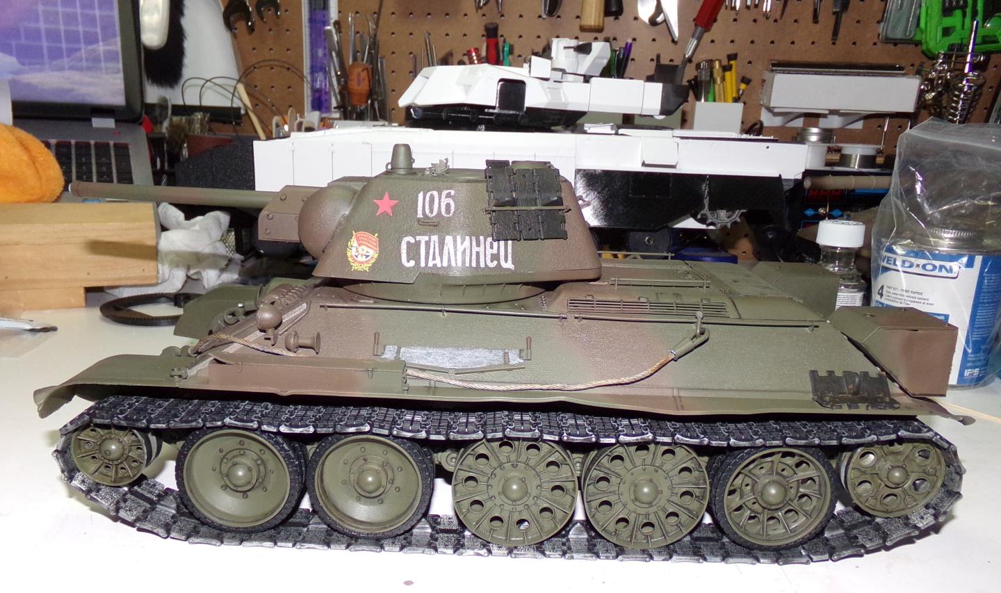

              Also, about track tension. I have idler arms clocked so they are pointing at the first set of road wheels, track return isn't laying on the top of the road wheels but is fairly slack. with the idler that far back, it kind of looks odd from the side. Should I add the two included track links per side and move the idler arms forward?
              • tank_me
                • Feb 2022
                • 1197
                T34 tracks run well with some slack, but moving the idler forward away from the road wheels is where is should be. The idler should be slightly higher than the roadwheels. The Heng Long version of the T34 tends to sit a little high and some have put shims in the suspension arms to lower the tank.

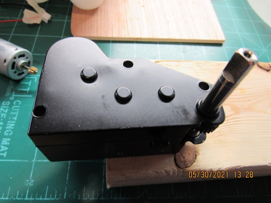

                  I usually avoid Heng Long metal upgrade parts and gearbox due to the poor quality. I use Heng Xin and Torro ball bearings gearbox on my tanks. I was always super careful about the alignment of the gearbox at a perfect 90 degrees between the tank axle and the drive axle. If the user sees a visible wobbling of the drive axle, the gearbox is severely mis-installed.
                  While Heng Xin gearbox is my preferred gearbox for most HL tanks. But installing a Heng Xin on the T34 is a real challenge and requires modification to the T34 chassis. You may consider the Torro series 2 ball bearing gearbox. The pictures below are from my HL Pershing installation.
                  Click image for larger version  Name:	IMG_5004.jpg Views:	0 Size:	127.2 KB ID:	417444 Click image for larger version  Name:	IMG_5005.jpg Views:	0 Size:	188.6 KB ID:	417443 Click image for larger version  Name:	IMG_5123.jpg Views:	0 Size:	143.3 KB ID:	417445
                  The Heng Xin gearbox uses a thick mounting plate and a 2-D mounting process making it more secure and allows for fine tuning of alignment. But that process makes it more difficult to use on smaller HL tank chassis such as the Pershing or the T34.

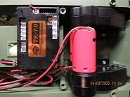

                    Red motors were delivered today, just got back inside from the first run with them. You weren't kidding, this thing is kind of a hot rod now! Probably going to default to 70% mode for the most part. When I had the tank apart to install the motors I also switched the battery connector from the tamiya plug to an xt60 so I could use a 5200mah 80c 2s lipo. Also added a low voltage alarm.

                      Thanks for the advice, I added the extra track links and adjusted the idler. Looks better, drives great.
