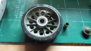

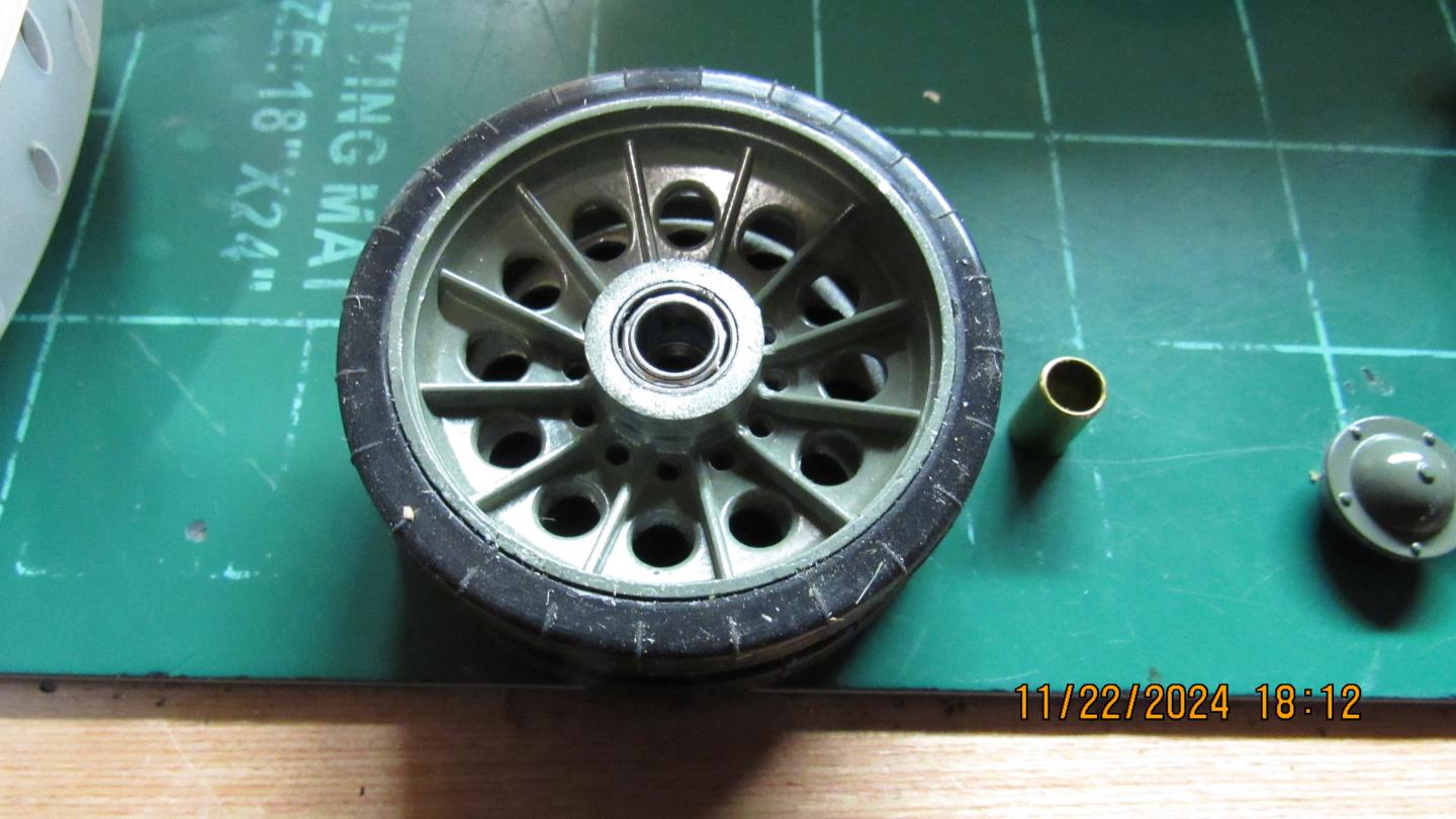

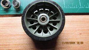

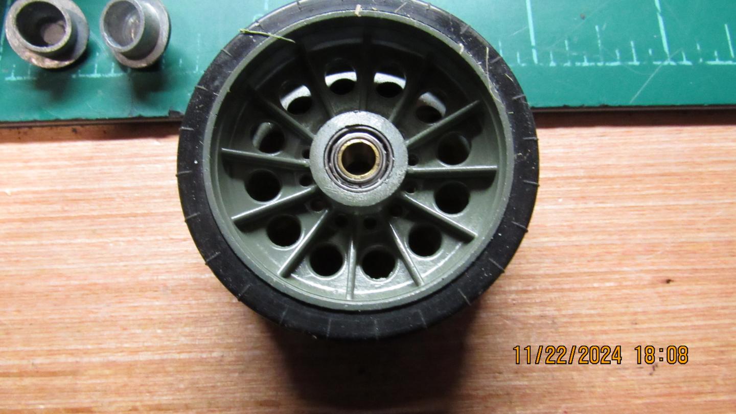

        Yes, the Mato wheels come with the copper sleeve to make up the difference between the O.D. of the heng long arms and the ID of the mato bearings. It works ok.
        Click image for larger version  Name:	IMG_5415.jpg Views:	0 Size:	123.5 KB ID:	417613 Click image for larger version  Name:	IMG_5413.jpg Views:	0 Size:	129.7 KB ID:	417614
        On the Merkava and the Leo 2A6, I used sticky back copper foil for that purpose. They are not as good as the Mato metal sleeves.
