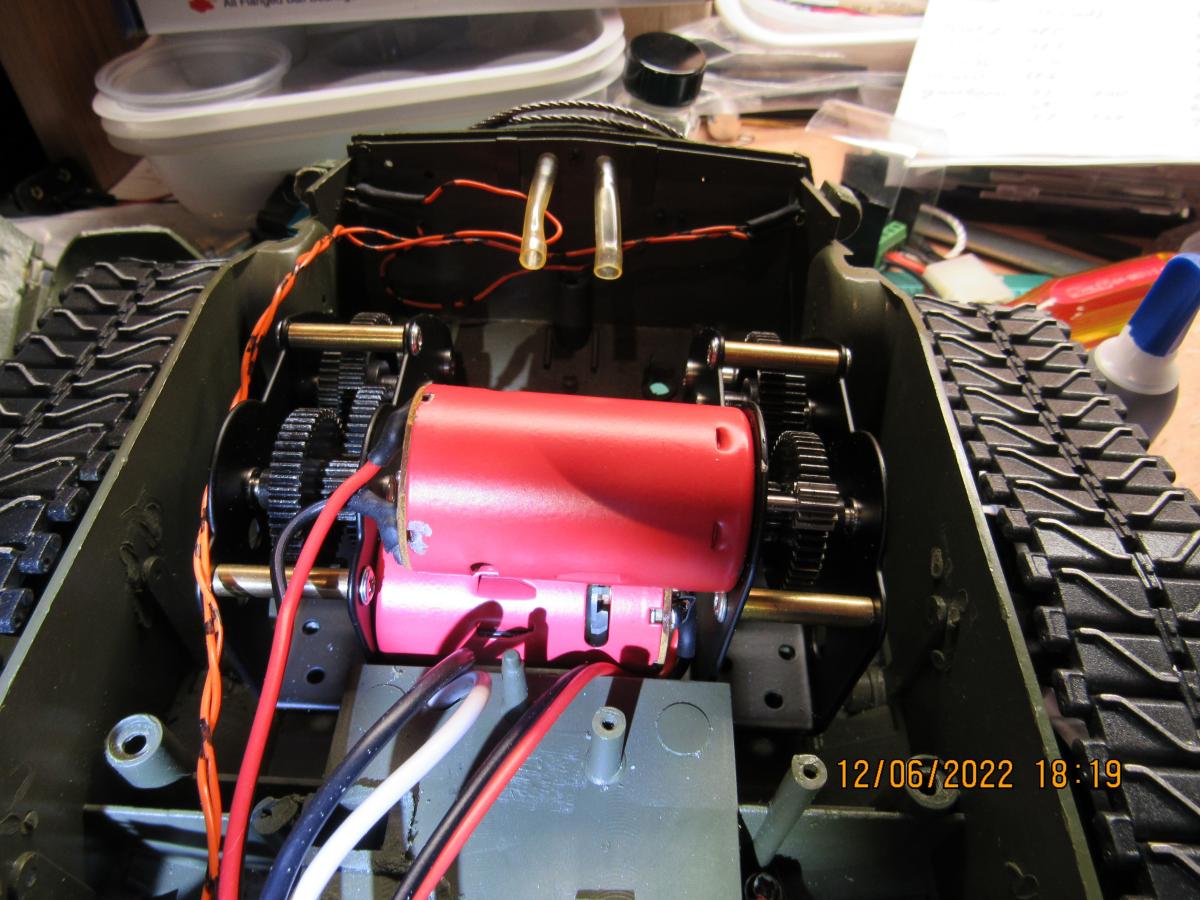

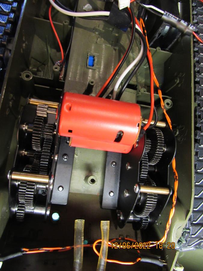

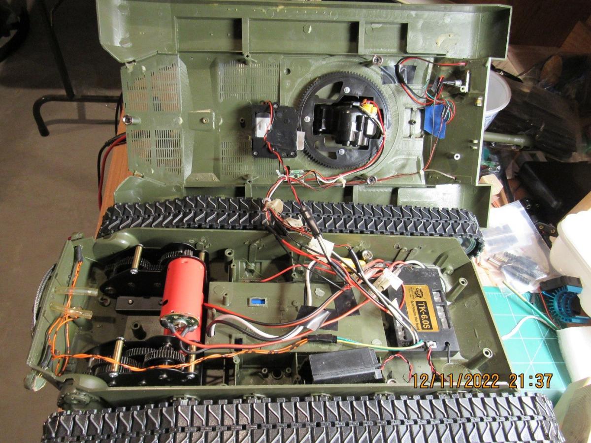

    Based on your description, you may have missed out on the critical upgrades on the drive chain. I do not have a HL Walker Bulldog, so these suggestions may be necessary, but not necessarily sufficient upgrades for improving the driving quality of your RC tank.
    1. HL uses level 2 (out of 4 levels) gearbox on their professional version tanks. It is steel gears with sleeve bearings and the alignment are not very good. I use Torro level 2 ball bearing gearbox which is much better aligned and quieter. While at it, you may consider using the 390 motors. If the 390 scale speed is too fast for your taste, you can scale it back using the MFU.
    2. Replace the HL metal track with better quality tracks. Mato makes one for the Walker Bulldog, but I don't know how much an improvement it is over the HL.
    3. Add a motor drive ball bearing.
    Below is pictures of my Pershing installation.
ID:	418111 Click image for larger version
ID:	418112 Click image for larger version

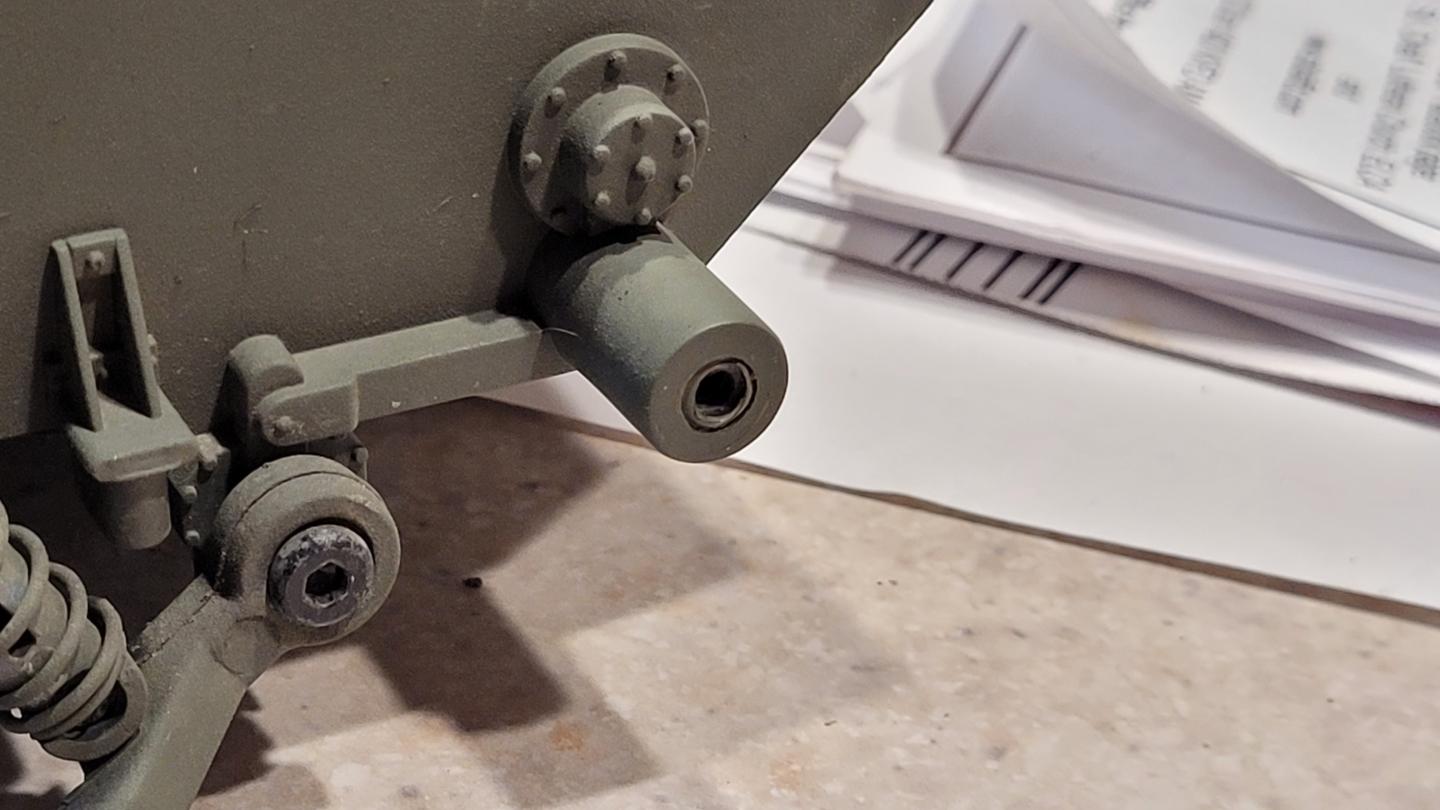

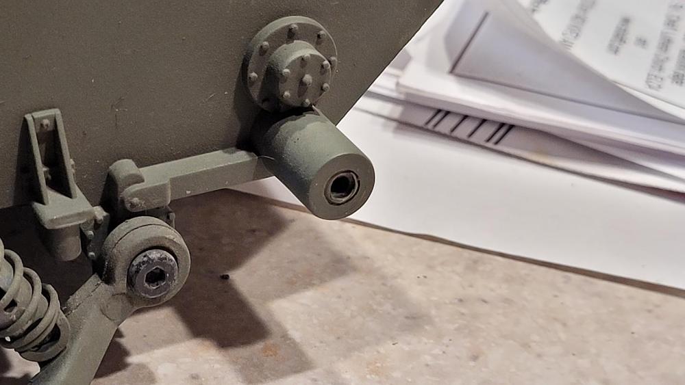

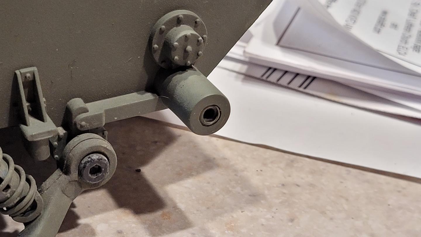

              to clarify, this is the area being discussed, correct?
              • tank_me
                • Feb 2022
                • 1197
                Yes. Some people have had that plastic boss snap off where the idler mounts.
                • Roaming Gnome
                  • Aug 2024
                  • 141
                  I can't find any signs of cracks or stress on mine, but at the very least it looks like something I could bust off with one of my famous curb checks. I have had problems with the rear axle support, I installed bearings, had to ream out the collar a bit for them to fit,. and both cracked, I've never been able to find a metal replacement support, some I've glued the tar out if and reinforced with a couple zip ties, it's held, and you never see it.
                  • DavidN
                    • May 2021
                    • 3203
                    • Los Angeles, CA
                    Yes! That part where the the screw from the idler would be screwed in. The two tanks that suffered the breaks were a bit old though.
