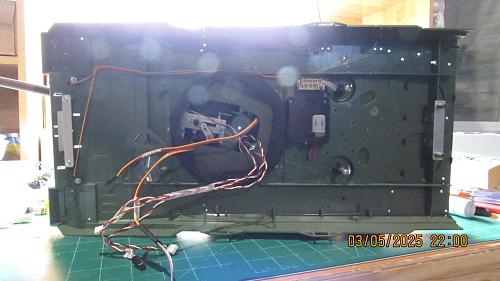

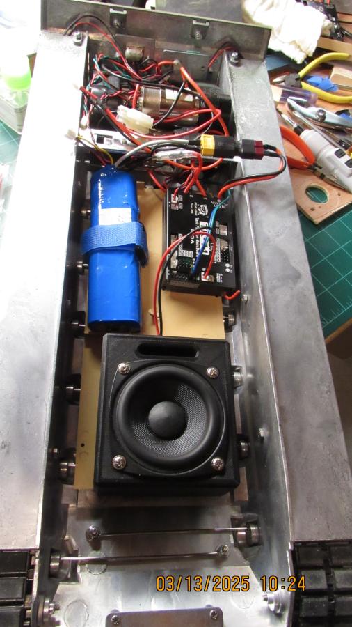

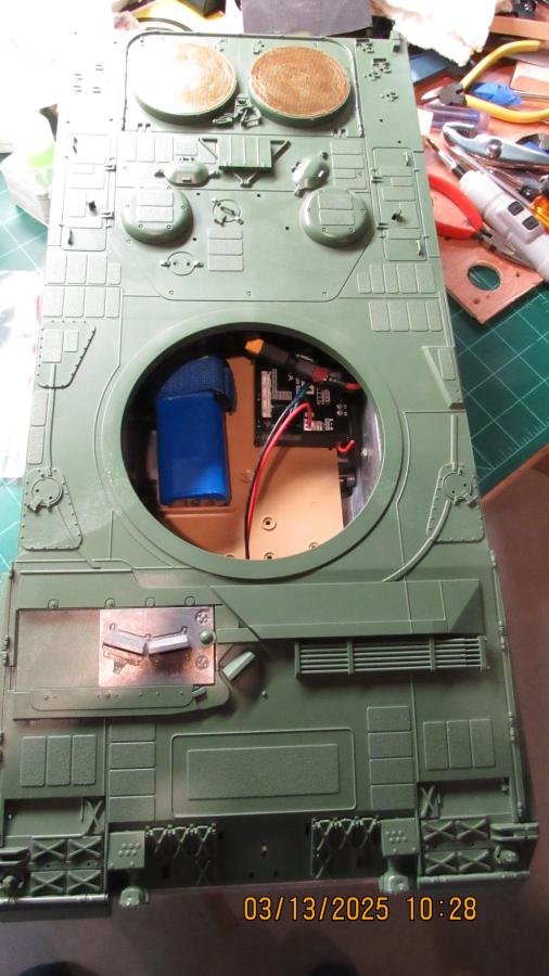

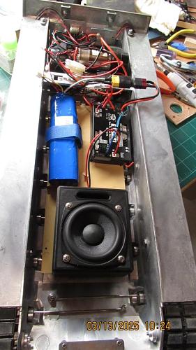

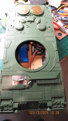

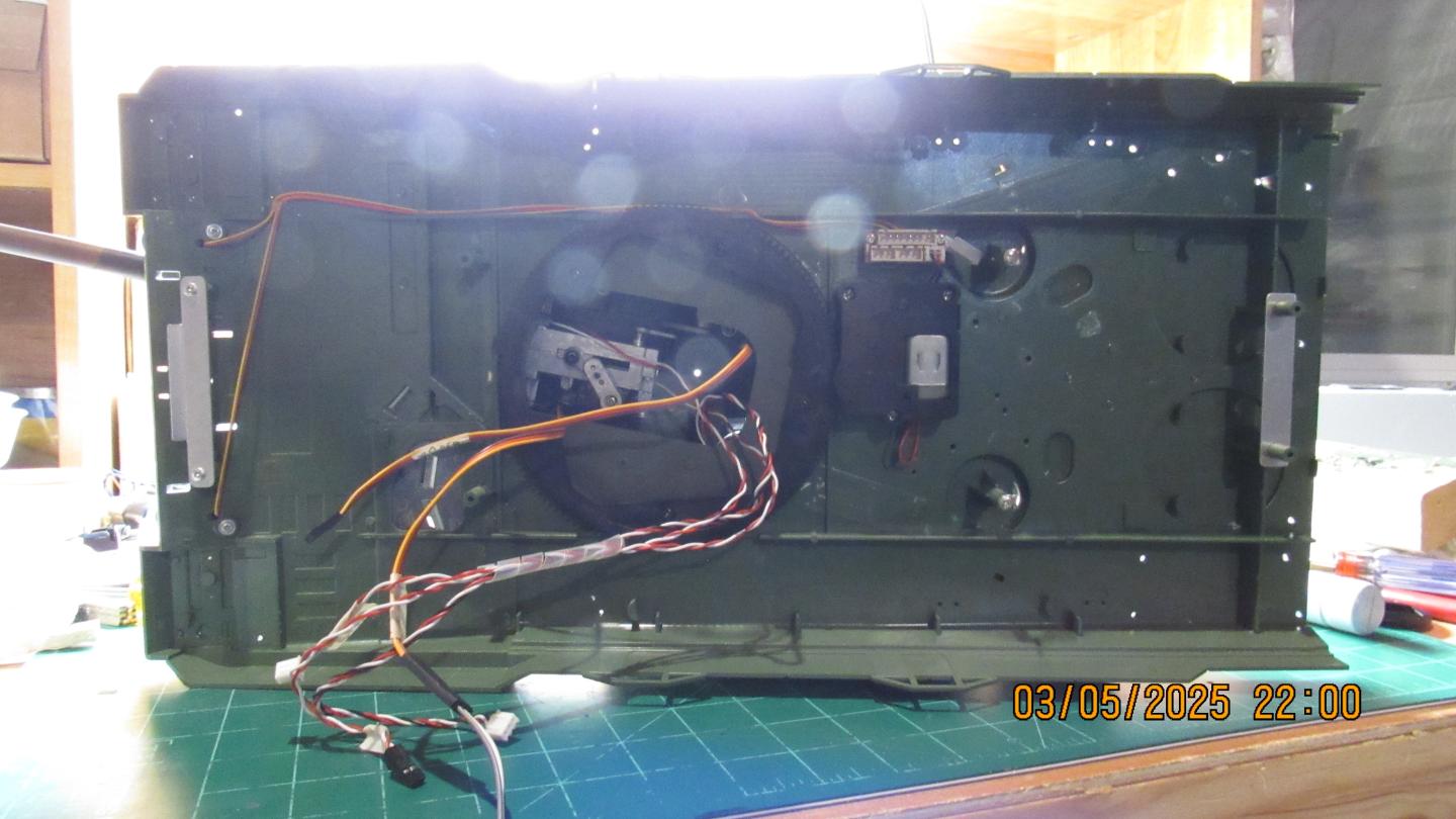

    For the past 2 weeks, I test fit the Torro upper chassis to the lower metal chassis. Attach small parts to the upper chassis and tried to find way to improve the wobbling suspension arms. I had a major set back on Sunday. The HL TK-7.1 MFU stoped working. It refused to come online.
    This is the second failed HL TK-7.1 MFU in 7 months. The first HL TK-7.1 MFU lasted only a few days. I don't remember any HL MFU failure until the 7.1. I am reluctant to buy another 7.1 MFU for its reliability issue. Returning to 7.0 means giving up on servo recoil and servo elevation. Your comment will be greatly appreciated.
    The 7.1 is twice as expensive as the 7.0. It has a very nice metal case while the 7.0 case is plastic.​ If you are a HL TK-7.1 MFU, how long have you had it?
