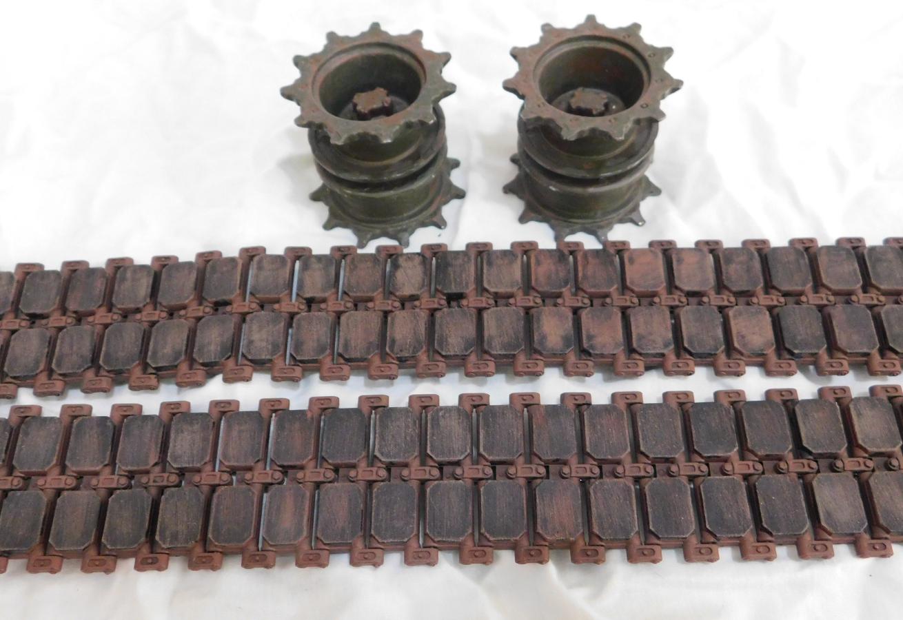

    I have a quick question, that since the professional edition of the M1A2 Abrams Battle Tank Heng Long features unpainted all-metal tracks and running gear externally, how am I suppose to get those tracks and gear painted? Is that look strange without paint, why can't the Heng Long painted those parts instead leaving them unpainted?

    Use this to corrode them to a perfect grey.

      Presumably they're unpainted so the buyer who paid more for them can show them off. I agree with Evan's suggestion about the Perma Blue. It'll take the better part of a bottle to do one set. I pour the liquid in a pan or dish and drag the tracks (off the tank!) through, following the bottle directions. As far as the wheels, I use an etching primer spray and then paint them. Just one problem doing this, that is to match the wheel paint you use to the rest of the tank. My solution is to repaint the whole tank. That way too, if you need to touch it up, you already have the base paint!

        Make sure to do the chemical plating outdoor. The fume is very toxic.
        For smaller scale static model kit tank tracks using softer metal, chemical blackening of the track is a preferred approch. I found out the hard way that the stronger metal in 1/16 scale RC tank is not a good candidate for chemical blackening. I have not found a good approach to do the blackening at home yet. For now, I buy the black metal track from Mato instead.

              Perma Blue is actually a chemical process that etches metal, and turns out gray to black depending on how long you apply it. It's originally meant to touch up gun surfaces, which are in most cases black nowadays.

                The Heng Long metal tracks, replicate, real modern tracks, in the same way as I replicate the king of Scotland. The raised parts should be rubber, and the remaining parts should be grey/brown. If you paint, or blue the tracks, they will never look right as the paint will wear off the contact area, which would be black rubber. You are better off with plastic tracks and painting them well.
