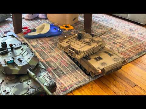

    Hi, does anyone know where I can purchase a faster turret motor?
    I have a Heng Long Abrams with the 7.0 MFU. The stock turret rotation motor is painfully slow. I purchased a 7.0 Leopard 2 for my son and the turret rotation motor is significantly faster.
    Later, I tried out the CS metal rotation motor from DKLMRC, which is a nice improvement over the stock motor, but still nowhere near as fast or smooth as my son's Leopard 2's stock motor. Does anyone know where I can purchase another stock turret rotation motor like in the Leopard 2?
    I've attached a video for comparison between the two stock motors.
    Thanks!

    The turret rotation on the HL Abrams is very close to real time rotation of a acual Abrams tank.
    The turret rotation on the Leopard is WAY too fast in comparision to a real Leopard tank.
    If you are looking to have your tanks have operation as close as possible to the real thing, you need to slow down the HL Leopard turret rotation IMHO.

      Oh I see, thank you for the information! I don't know too much about real tanks. Unfortunately, I can't really slow his down since it seems like I can't change the speed on the stock 7.0 mfu. I've tried the commands printed on the manual and it doesn't really seem to do anything. Also if I did he'd be upset, he like being able to one-up me when we do IR being able to quickly swing his turret around haha.

        You replace the rotation unit in either tank to match the other.

          There are two faster rotation units for modern tanks. The gray one that comes in the Merkava is faster and much quieter. You may be able to find it for a better price than that, but with all the tariff stuff, who knows.
          Then there is a different one that is metal that I have on my Abrams as the other one wasn't around when I bought it. It is a metal unit where the drive motor hangs down from the gearbox, but I haven't really seen them for sale in a while so I don't even know if they make them anymore.

                  Yup, that is what I'm looking for. The one from the leopard to put into the abrams would be cool.

                    Thank you for the link! That grey rotation unit is exactly what my son's leopard has in it. But you're right, with tariffs, it may not be worth it at the time being.
