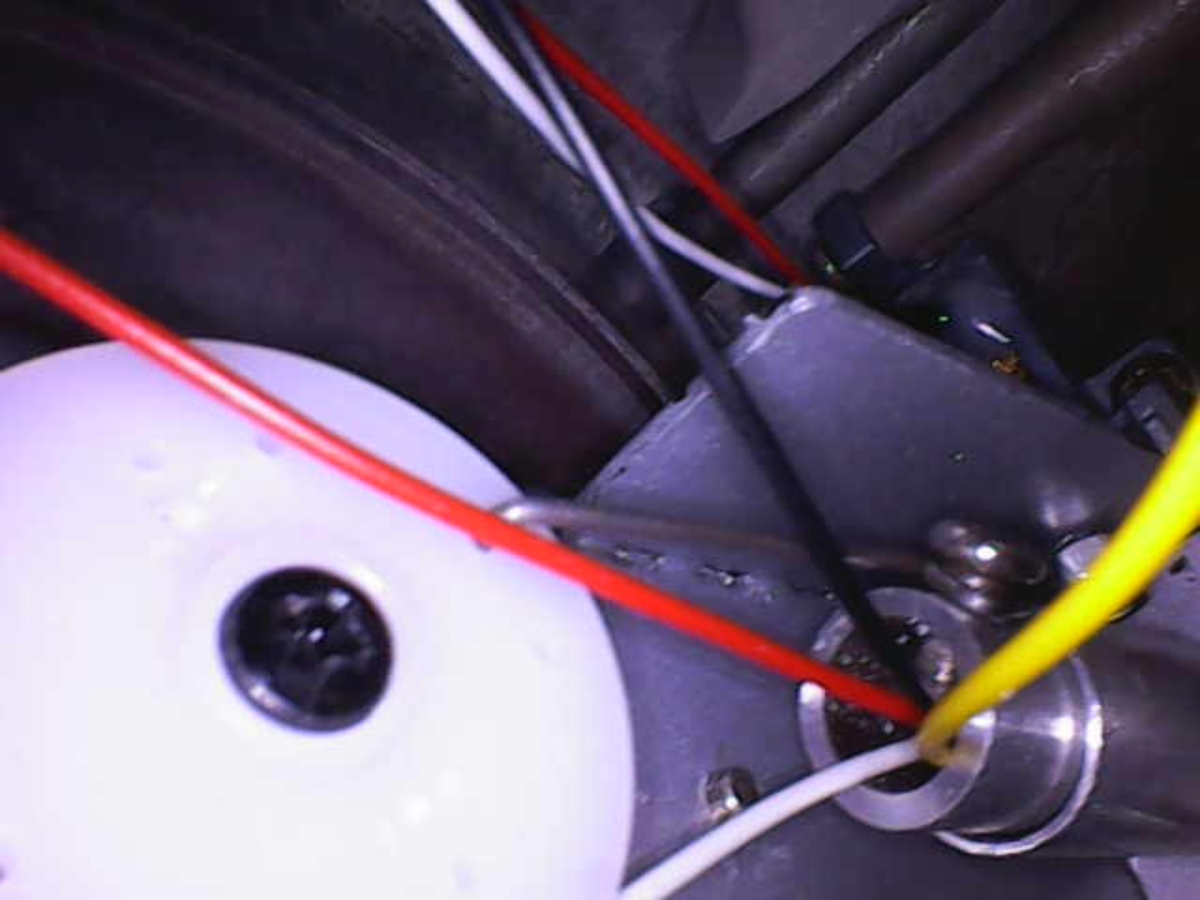

            So it turns out a previous poster was correct on the location of the IR emitter on the Stugg III. It is located in that dimple above the cannon on the mantlet and Mato did indeed paint over it. When I initially looked at that and did a little paint scraping it seemed like metal underneath so I stopped but this has been driving me nuts so I did some more aggressive scraping and lo and behold there was the IR emitter bulb. It's working better now, with my range indoors probably about 15-20 feet. That still seems kind of limited but at least I now know where it is located.

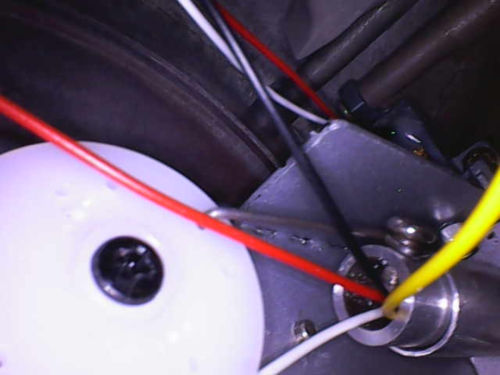

            On the M4 Sherman, I am pretty sure the wiring from the IR emitter leads to the cannon, see the photo I've posted below. This tank has a limited range (2-3 feet max) and when I tape over the cannon barrel opposing tanks receive no hits, remove the tape, and an opposing tank will receive a hit from the M4 Sherman.
            I am pretty sure the M36 destroyer also has this same setup. The wires from the J1 socket seem to disappear into the cannon barrel, and an iPhone video shows the cannon flash LED followed by another brief flash that I am thinking is the IR signal. This tank has the best IR range, and can score hits on opposing tanks at a distance of at least 30-40 feet.
            Is it possible they jammed 2 LEDs into the barrel of the Sherman and the M36, or is this an LED that has dual wavelengths in the IR range and visible spectrum ?

              Never seen an LED with a visible and IR combination. An RGB (red, green, blue) LED has more than just two legs on it. There is a positive leg for each color and a common ground leg. In order to do a multiple LED package with visible and IR, I would assume it would have to be the same and would have 3 legs, one for the visible +, one for the IR +, and a ground leg.
              I have on occasion jammed two LEDs in a barrel if the bore of the barrel is large enough like on my SU-152 or my Kranvagn.

                Did you place the LEDs on top of one another or one behind the other ? In the Sherman I have it almost looks like they are behind one another.
