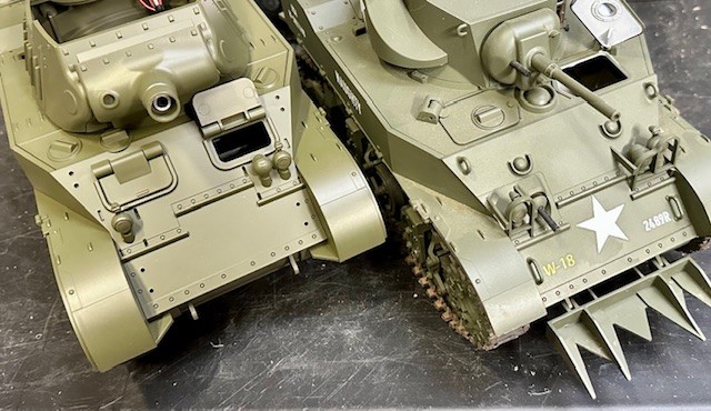

    This arrived today, wrapped together with my Coolbank Crusader. Even though it was ordered at a different time, they both arrived in LA at the same time and was forwarded by a single courier.

    Did my 2 minute test OOB. Everything works fine. I re-bound it to my M5 Stuart's transmitter, a matter of 30 seconds to read how and a button press.
    The chassis runs and sounds identically to the M5 Stuart, of course. The gun recoil happens in the open turret, the chamber and dampers are what recoil. It's nice that they didn't just plop a different turret on the M5 hull, that would have occasioned some outrage!. The main difference is in the crew hatches in the front.

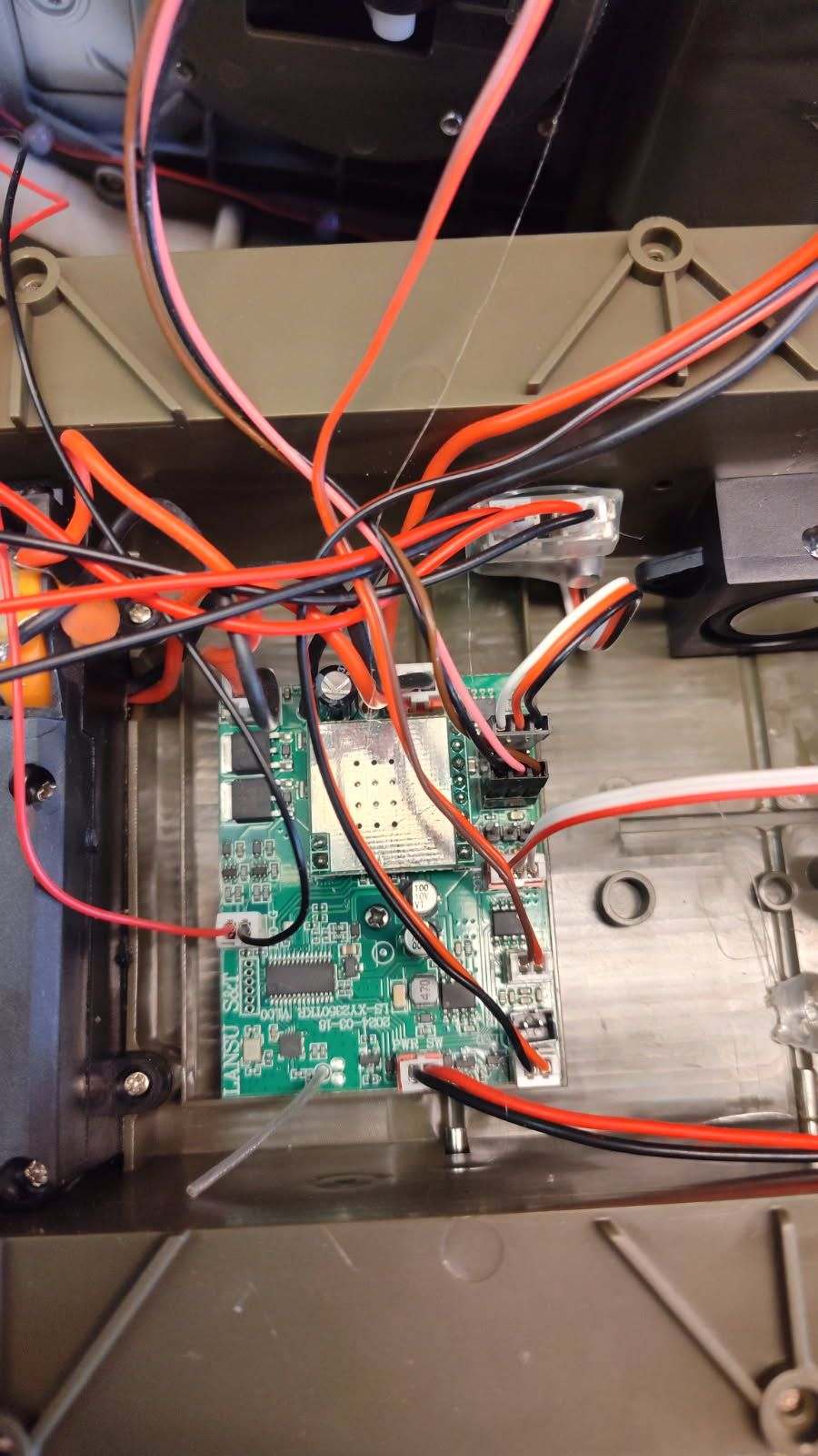

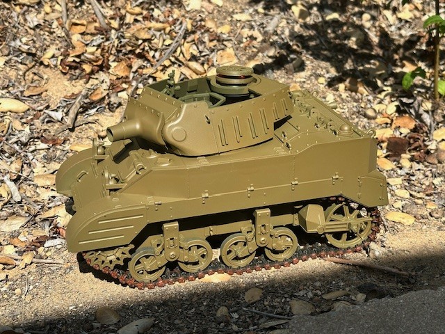

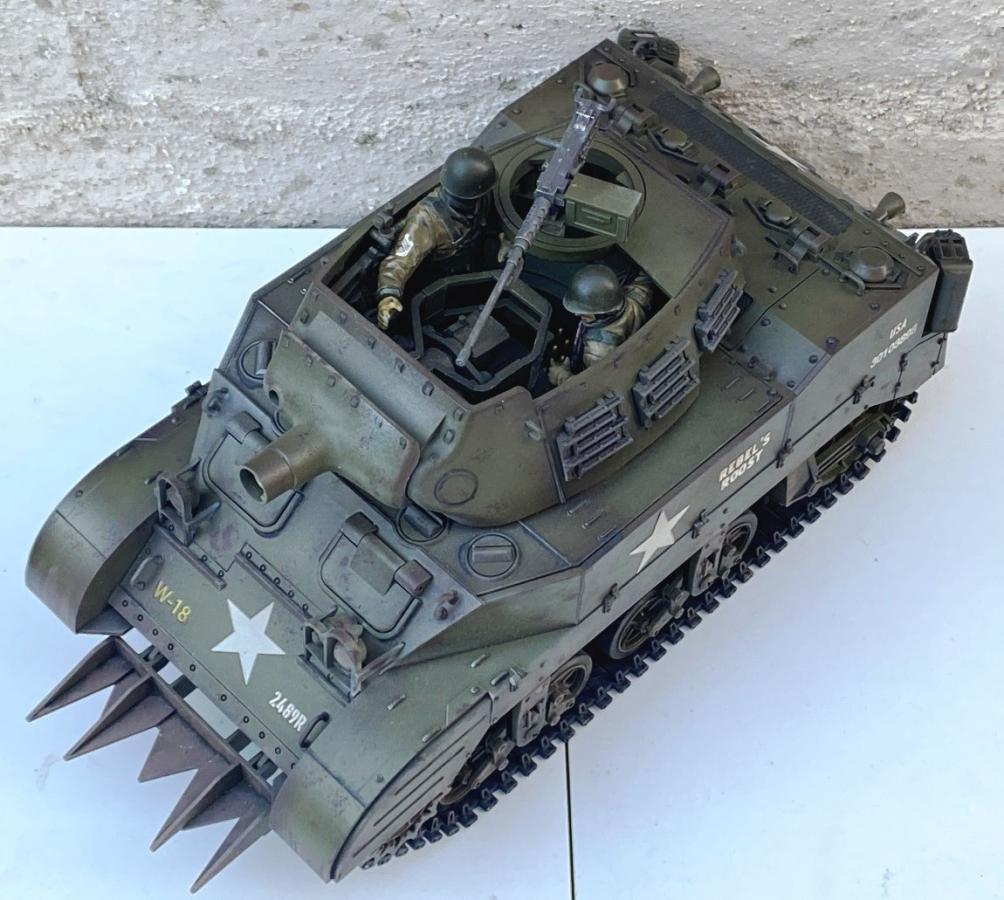

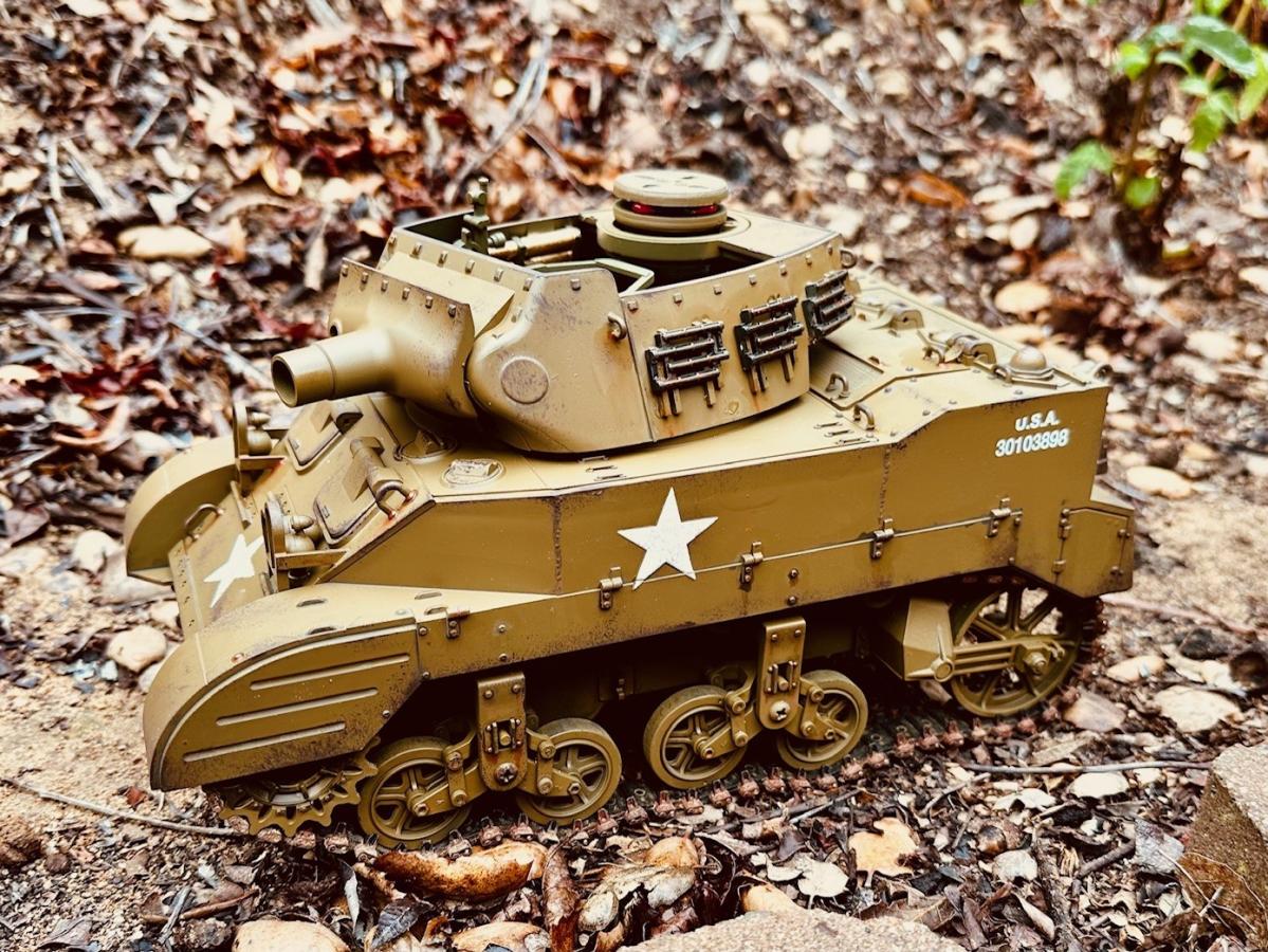

                          I FINALLY got around to the M8 project. It's installed with a Heng Long 7.1 board, high power IR emitter & LegoDEI IR receiver. There's a lot of rewiring required since Coolbank's setup uses auxiliary pc boards. Also, the elevation servo has only two wires! Rather than trying to make it work with the HL board, I replaced the servo itself. It's a common size. For those contemplating this conversion, an interesting observation. HL's dual current mode works fine. It's still a jackrabbit, but the steering is infinitely better than stock. Very precise and subtle. Another benefit is that the elevation servo doesn't return to middle position once the control stick is released, something not found in some other brands. One quirk I found. The barrel recoil is accomplished with a micro linear servo, like those found in micro r/c airplanes. It still has three wires, and once the plug is replaced the HL boards treats it like a regular servo. Anyway, it's functionally battle ready. It's off to the workbench for detailing. I painted it Field Drab, not necessarily authentic but it will blend in on our arid battleground. I've seen that color on artwork displaying tanks in the Italian campaign.
                          • SoCalBobS
                            • 2754
                            • Southern California
                            After touch-ups:
                            Click image for larger version  Name:	M8 Scott 04.jpg Views:	0 Size:	243.8 KB ID:	439645
                            (Also posted in photo gallery.)

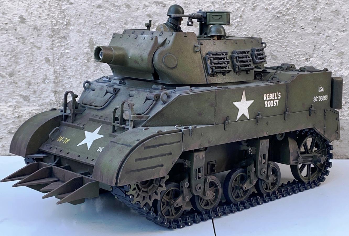

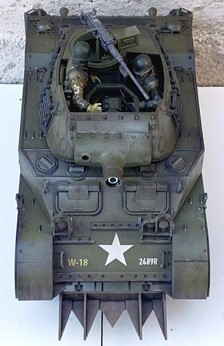

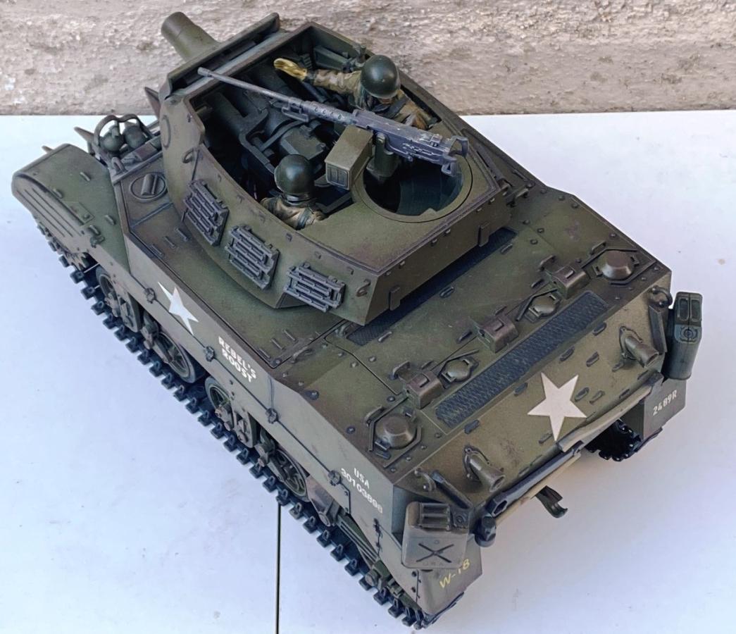

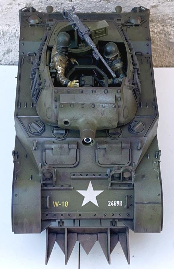

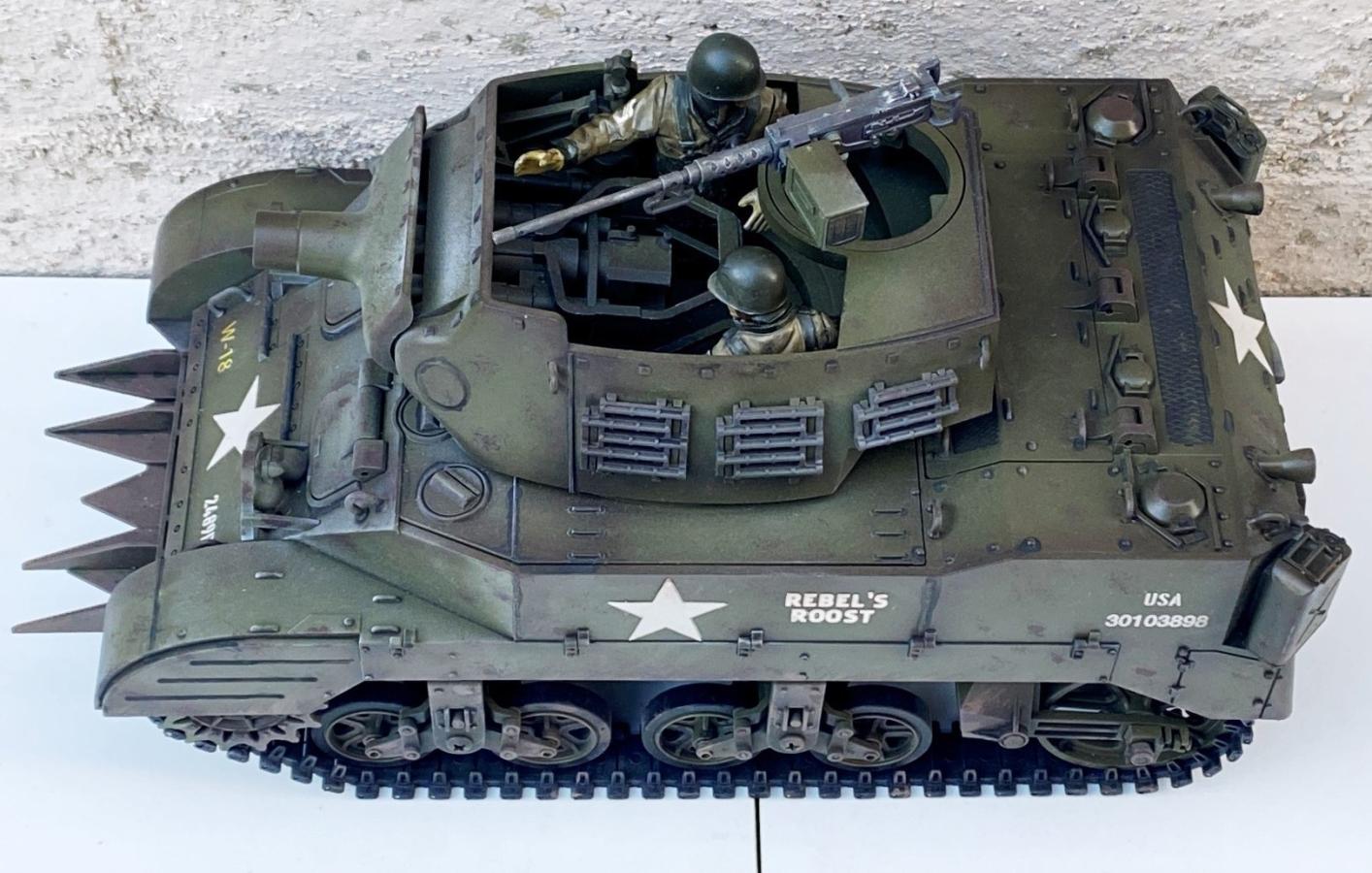

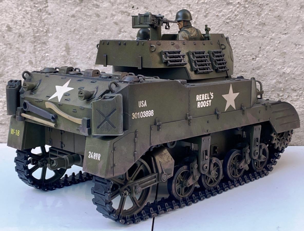

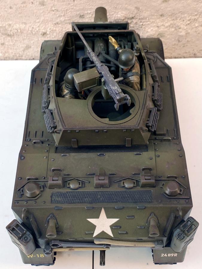

                              With the 10 US tank crews I painted a couple days ago, I was able to add 2 of them onto my M8 so they could operate the gun, heheh!
