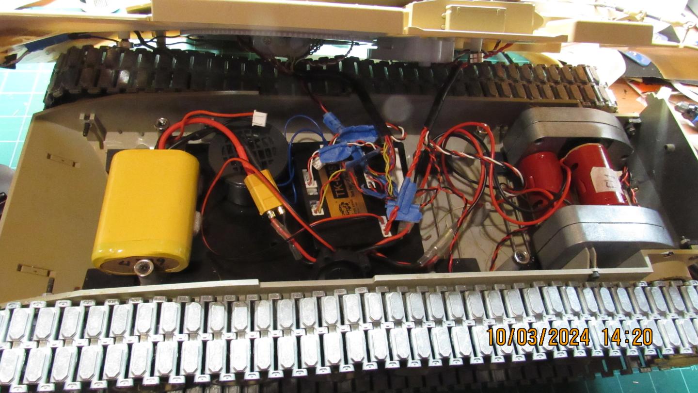

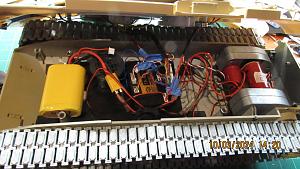

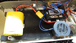

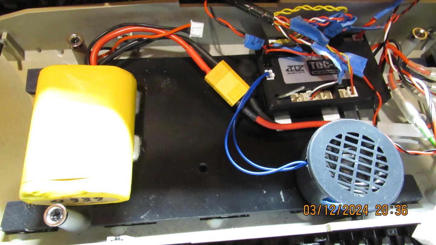

    The charge port picture is in page 2. The instructions and warning about the Tongde m1a2 battery are in page 4 and 5. Tongde use a very poor quality and low capacity battery with NO built-in protection. Do not charge without supervision to avoid overheating and fire.
    I have the Tongde Patton M60A1. I open the tank and replace the battery pack with a larger capacity one that has built-in protection circuit. I magnetized the lower and upper chassis to allow charging outside of the tank.
