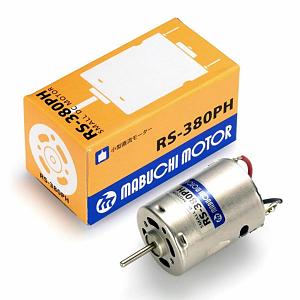

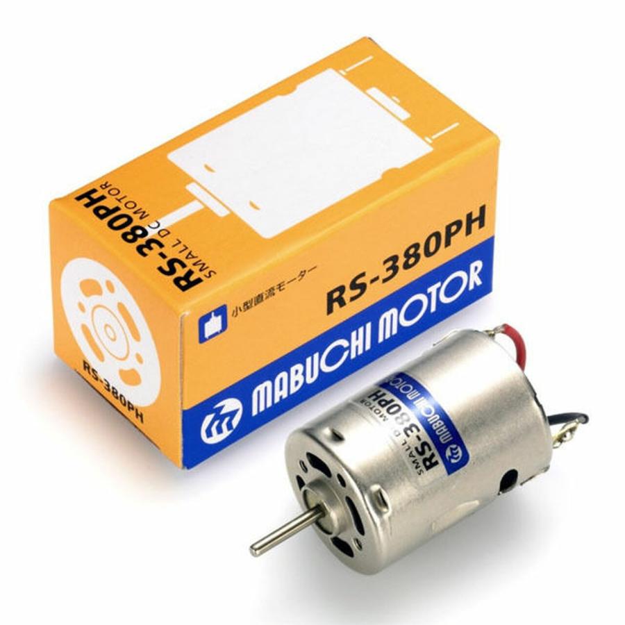

      The major difference among gearboxes is NOT the gear material (plastic vs metal). It is the bearings of the gear axles. Higher quality gearbox uses ball bearings on the gear axle. It is quieter, less vibration and wear. It generates less frictional heat in the gearbox, thus draws much less current from the MFU/ESC. This description applies to the Heng Xin, Mato, Taigen/Torro metal gearbox and only the top end Heng Long metal gearbox (-4 version)
      It is also important to pair the gearbox with genuine Mabuchi 380 or high end 390 motor with ball bearings axle. The Tamiya standard 380 is Mabuchi motor. These motors heat up a lot less than the grey 380 motor that comes with the Heng Long gearbox.

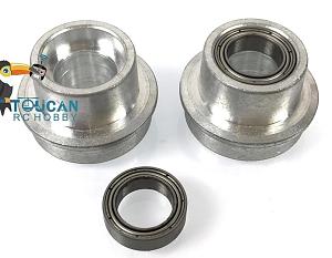

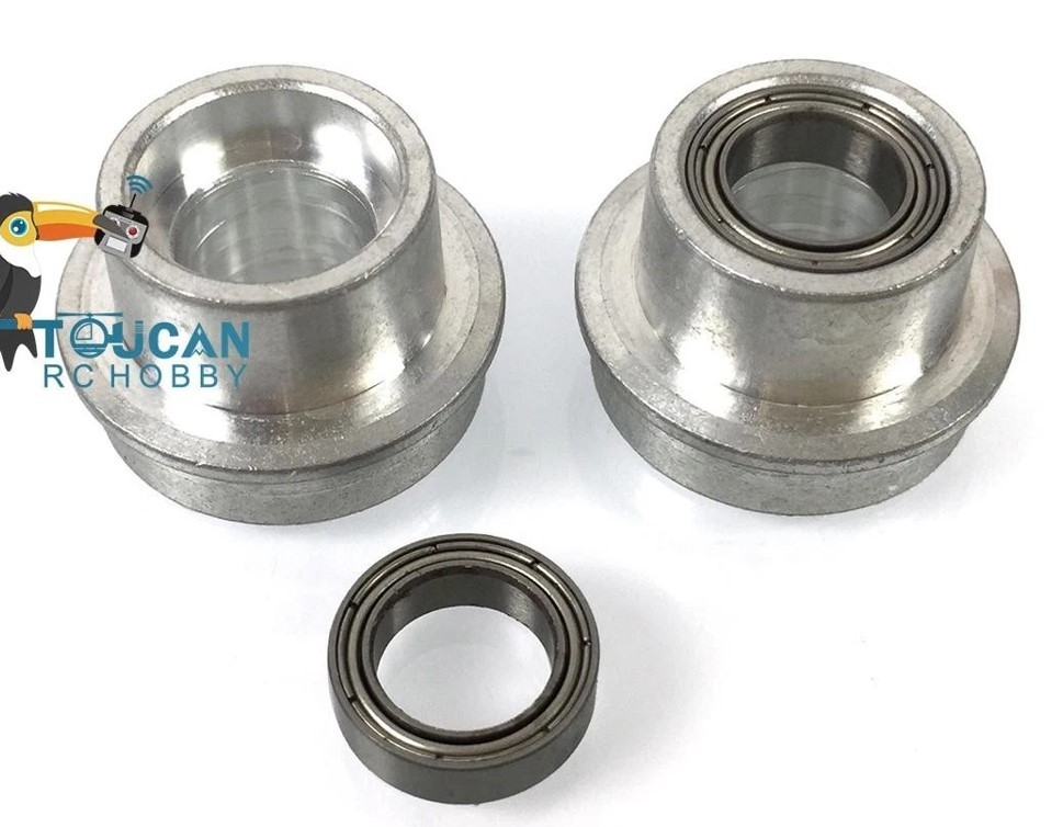

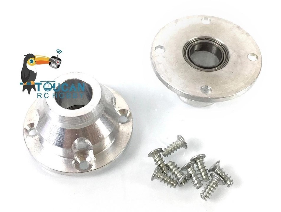

        It's a system, gears, bearing'ed shafts (not just the output), the motor and, yes the output shaft of both the gear box and the tank chassis itself. I run just HL tanks and use their plain metal geared gear boxes which have bushings but I add a bearing to the output shaft on the chassis.
        • keilau
          • Mar 2021
          • 1844
          • Windy City
          The drive shaft bearing is a very good way to refine the gearbox alignment to the motion vector. You can install the bearing with or without the metal housing. I prefer the metal bearing housing which reinforces the plastic chassis. The bearing does not affect the characteristic of the gearbox. Below is the gearbox output shaft ball bearing housing for the Heng Long Abrams and HL Leopard.
          Click image for larger version  Name:	outputshaftbearinghouse.jpg Views:	0 Size:	116.1 KB ID:	432162 Click image for larger version  Name:	driveshaftbearinghouse2.jpg Views:	0 Size:	89.3 KB ID:	432232
