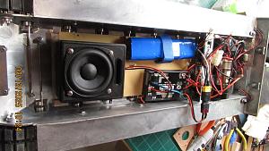

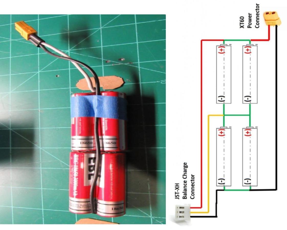

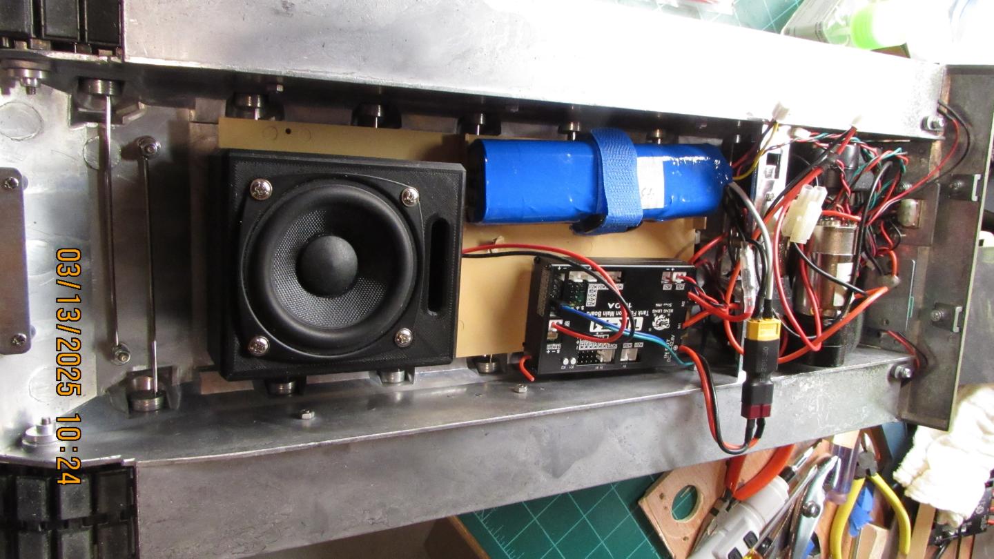

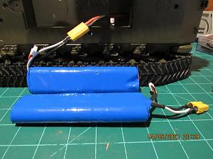

    I prefer to use a single 2S2P Lithium Ion pack. It is easier to install and to charge. I build my own pack using high quality protected Li-Ion cells. Total cost is less than $20 plus elbow grease. I have a mini spot welder making the job very easy. The pictures below show battery pack in original HengLong Leo and Torro Leo.
    Click image for larger version  Name:	2S2Pschematics2.jpg Views:	0 Size:	85.4 KB ID:	433507 Click image for larger version  Name:	IMG_4961.jpg Views:	0 Size:	161.9 KB ID:	433506 Click image for larger version  Name:	IMG_5487.jpg Views:	0 Size:	157.1 KB ID:	433508
    It is very important to have a smart charger. 1/16 RC tank uses only 2 small motors. The battery pack needs only low current charging capacity, but the balance charging is absolutely necessary. If you connect multiple battery packs in parallel and they are not equally charged, it can lead to a run-off and small fire.

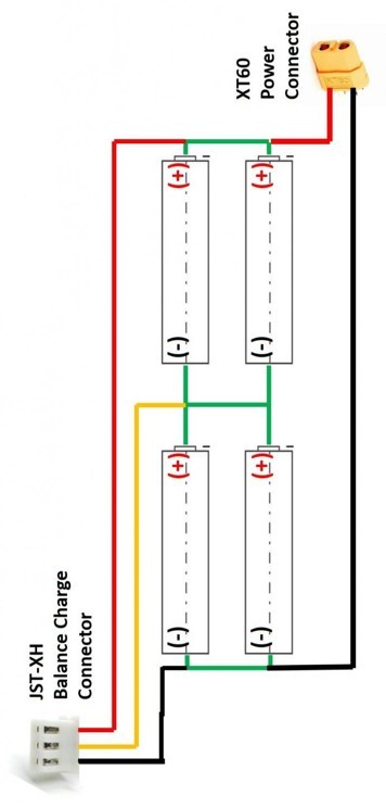

        The balance circuit is an integral part of the Li-Ion battery pack. The smart charger uses it to assure equal charge to all the individual cells. I discourage connecting separate packs in parrallel for the danger of potential fire harsh.
        Click image for larger version  Name:	2S2Pschematics.jpg Views:	0 Size:	34.8 KB ID:	433579
        If you want longer run time, purchase a high quality 2S2P pack is the only way to go.

          There is no "balance circuit" there. The balance circuitry is on the battery charger side and through the balance tab.
            You are right that the balance circuit is on the charger side. However, you need to wire the battery pack in a certain way to connect to the balance circuit. If not, the individual cells in the pack will not be charged equally.

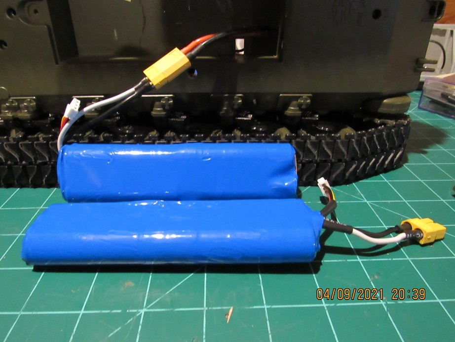

                      Dual 3500 mah admiral batteries in Abrams being charged by two chargers via battery balancers with one battery disconnected from tank during charging then connect both batteries to the tank when operational
                        I strongly recommend you to invest in a intelligent balance charger. It charges your Li-Ion pack fast and record the charge results such as final voltage, mAh and individual cell voltage too. You can download the SkyRC software to monitor the charging progress and pack temperature too.
                        There are many knock-off of the iMAX B6 charger from China at a fraction of the price. Those cheap imitation do not have functioning software and should be avoided.
