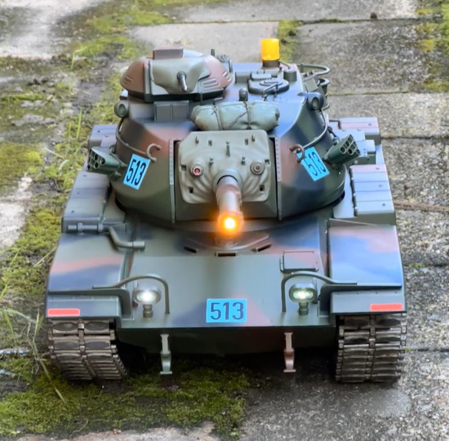

    Depends on your intended use. Those of us who conduct battles using IR emitters and receivers prefer to place the emitter in the barrel, which makes it visually easier to aim. Some place the emitter elsewhere, usually in the mantlet, and place a flash unit in the barrel. Also, there are flash and smoke units that flash the light and blow out smoke when the gun is fired. A flash reveals your position when you shoot if the enemy can see down the barrel. Helps a little to balance battles.
Name:	Space Bradley 06.jpg
    If all you are striving for is static or display realism, none of the above is necessary of course.
